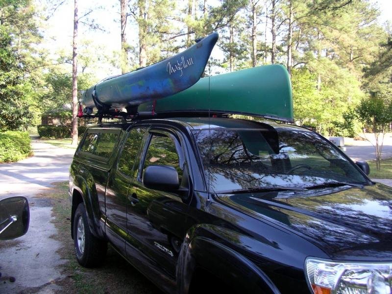

    Boats (kayaks* and canoes), bicycles, sometimes lumber or plumbing stuff, I've had furniture up there, an awning, a Yakima cargo box when needed, surf rods, etc.
    Old picture before most mods:

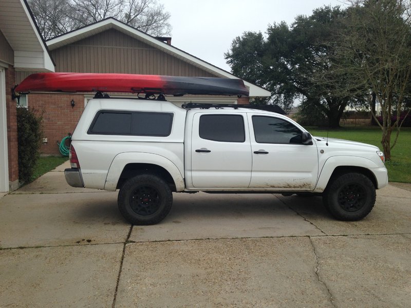

    Yeah you can install a rack system fairly easily on a cap that doesn't have one as OP said. As for me, this s a pretty regular occurrence in the non winter months:

    Bajatacoma -
    I'm looking for a kayak mount just like yours and just doing research on what kind of topper and components I'd need. Can you give me the specs on what I would need to mount something like this? Will your system fit any size kayak? I think mine is a bit wider than what you have. Thanks!

    I've got the Yakima tracks with the older round bars. I use the Hullyrollers* on the rear and the Mako saddles on the front and straps from NRS. Brake and bow lines are just nylon rope. I’ve been out of the country for a couple of years now but I was mostly paddling my touring boat so the setup worked well for the sea kayak since it's about 17' long; it works ok for my recreational boat and more meh, for the whitewater boat (although it's a higher volume creek boat so it's bigger and fatter than say a freestyle/playboat). I've got some J hooks (can't remember the brand) for the whitewater boat or when I want to carry two boats at once although before I got them I usually just put some foam pipe insulation on the bars and strapped the second boat down. The canoe I just slide onto the bars. I have Strap Caps on the bar ends which I’d recommend if you get round bars.
    When I bought my rack, I knew I wanted more real estate than the width of the shell so I got the 66" bars. They allow me to get a Space Booster cargo box on the passenger side, a boat in the middle and a Viper bike tray on the driver’s side if I want. I can also hang stuff off of them like a solar shower. It’s pretty easy to mix and match stuff depending on what you want to carry. Note that the rubber on the Hulley Rollers wears out after being in the sun for a couple of years and it gets sticky and starts coming off; the plastic coating on the bars eventually cracks as well. When I replace my bars I may get the next longer size bars then cut them to whatever size I decide I like; I'd like to get the new Core aero bars but that'd require four new bases so that ain't happening. If you get any of the steel bars they are supposedly galvanized but I’d still recommend painting the inside of them when they’re new as my first set of Yakimas and my Thules both rusted inside (I had Thules on my VW camper); I taped off one end, poured some extra Rustoleum oil based paint I had in then taped off the other end and rolled them around before dumping the excess paint out and allowing them to dry. Maybe I’m just being OCD here. On the downside, I got hit by a car last summer and have to have more ortho surgery on one of my shoulders so my paddling days may well be over. :(
    *Hullyrollers kinda suck on round bars as they will rotate if you don't get them really snug. Looks like they have new systems now instead of the Hullys and the Makos.
