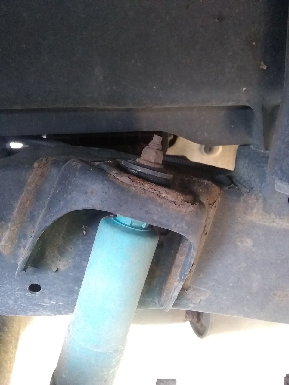

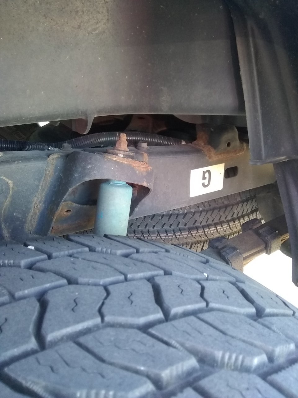

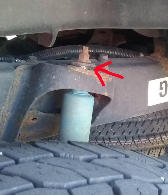

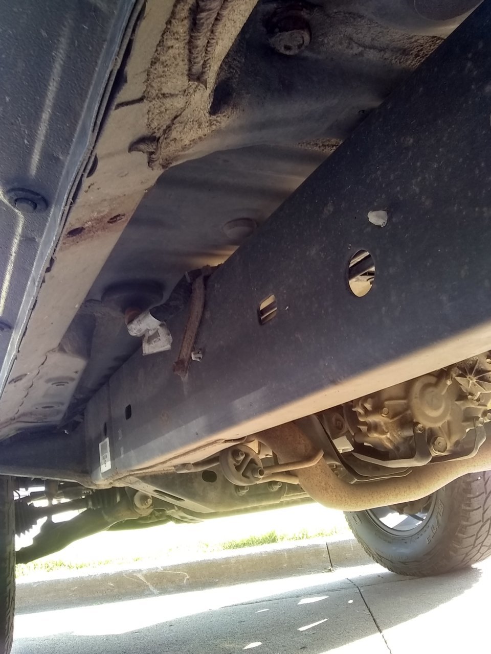

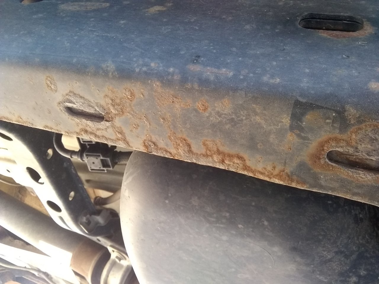

    IMG_20190604_181222220.jpg IMG_20190604_181303346.jpg IMG_20190604_181236744_HDR.jpg IMG_20190604_181341164.jpg IMG_20190604_181429804.jpg Went out and looked at it, took some pictures. Some cosmetic issues, interior didn't look too bad besides the broken switch trim.

    Is the shock bushing missing here? If so, it must to be banging.

    No, the bushing was there, just smushed down.

    The frame is beyond surface rust as some of the metal has already flaked.
    Walk away.

    That truck has been abused during it's ownership, I would expect a truck with 80K in much better condition if I'm going to shell out $24k. It likely has been offroaded and has front and rear bumper damage which are seen cosmetically along with uneven gaps with the body. The unseen frame rust concerns me. A simple shock replacement would be a nightmare. Cigarette burns on the driver seat and truck just seems unkept cosmetically inside and out. I can only assume the maintenance schedule matches the lack of care with the rest of the truck. I would pass OP.
