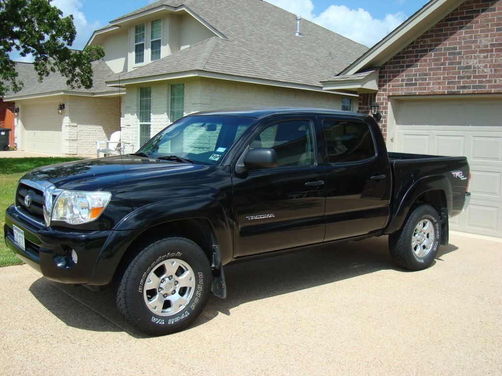

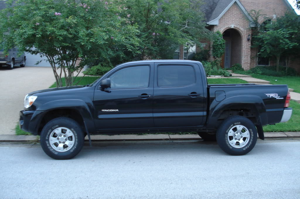

    My truck rides better, IMO, now with the upgraded suspension.
    I've never measured the ride before and after, but it is indeed higher.
    Before:
    After:

    Nice, Thanks for the pictures.. looks like it needs bigger tires.. :) That is basically all I am looking for.. Now if I can confirm the AAL works with the TSB springs in back, I am good to go. Your 5100's are set to 1.75 and go up to 2.5...?
    I am guessing you do NOT have the TSB back end?
