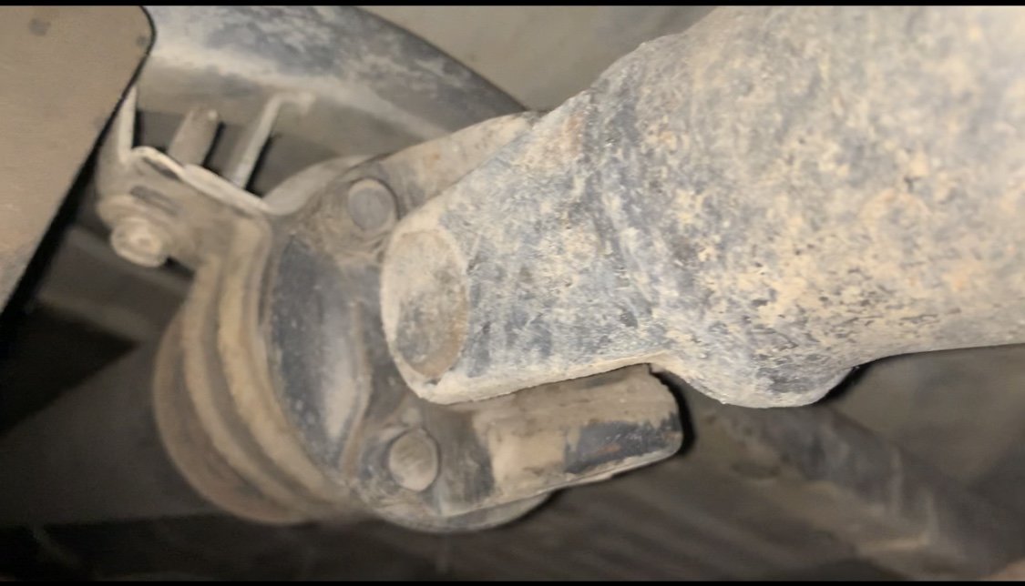

    so basically, the bracket seen in pic..i would remove both bolts, lower down the drive shaft, spin carrier 180 degrees, and bolt it back in? thats all to it?
