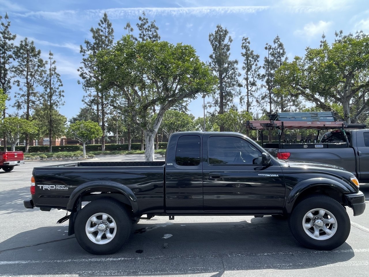

    kit was already ordered and the front was installed but couldn’t do back since the u bolts were not long enough for the new leaf springs.
    Side note: After installing the suspension the lift was very minimal. Less than 2” from what it was before. I was hoping to run 285/ 75 /16 but i don’t think I’ll clear em

    How it stands now with the front installed and rear untouched.

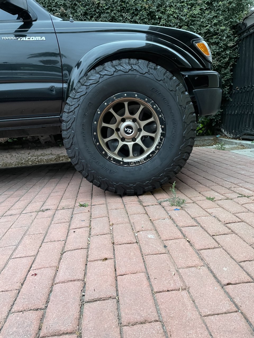

    Wheels I want to install, but waiting for the lug nuts since my currents did fit these wheels

    Yeah, 880's are for . Interesting 4wheelparts sold that to you as a 2" lift... You'd get closer to that if that is a 4cyl.
    But even still, 2" isn't enough to get 33's not to rub without some fender modifications.
    Also, you sure the rear is stock? Even after the coil install, it still looks lower than the rear. That might just be the angle of the pic, though...
