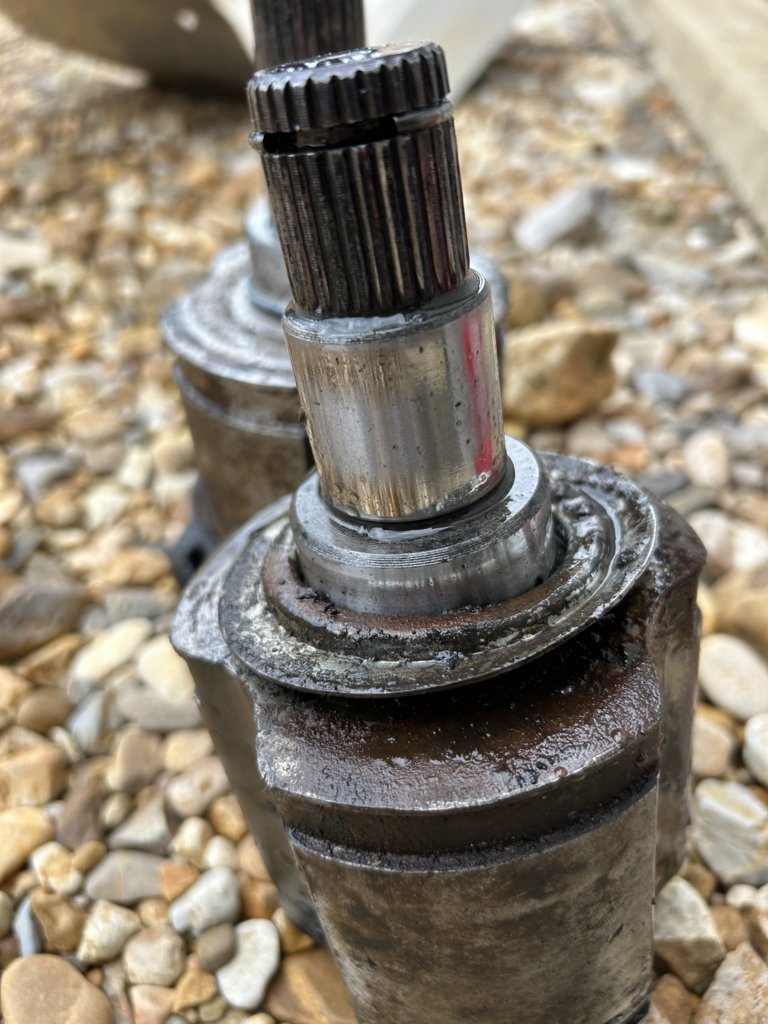

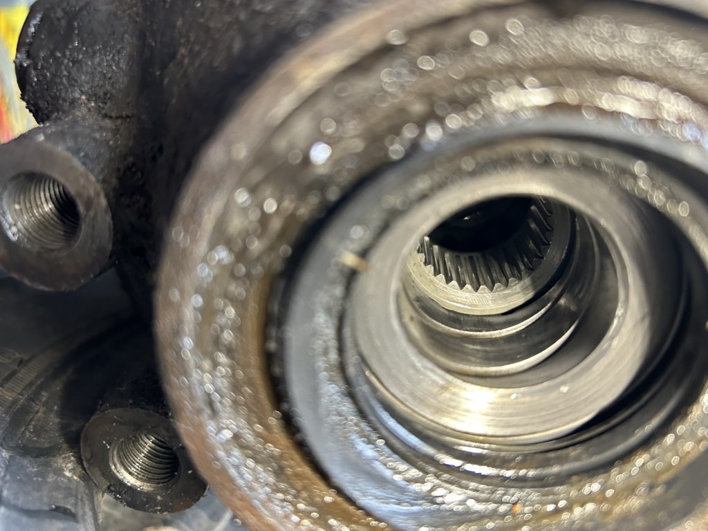

    IMG_4618.jpgHere is a photo of mine and it doesnt look like a needle bearing. I don’t remember groves being in the east coast bushing.
    so it looks like I got a front differential thats not a tacoma and is full time. Well that ain’t good.
    here is the end of cv axle.
