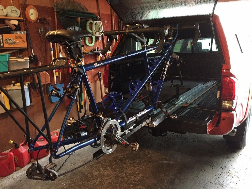

    Slide out Tandem Bike Rack.

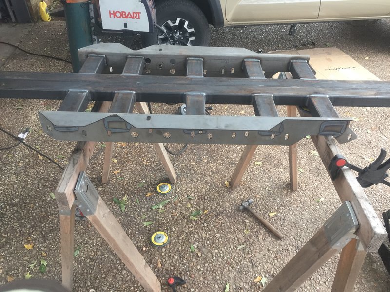

    I drew up some frame plates for mine to bolt on. They also have mounts that tie into the front cab mount. The flanges on the bottom of the frame extend tears the center of the truck so that I can tie them together after I get my exhaust rerouted. Working on a skid plate system that completely covers the under belly from the front of the frame to the rear axle. The sliders will be the mounting surface fro the plate between the t-case skid and fuel tank skid. I am going to be mounting my compressor and air tank in that void hense the extra skid. Here is a shot of the frame plates during fabrication. Mine wound up with nine 1/2" grade 8 bolts attaching each slider.

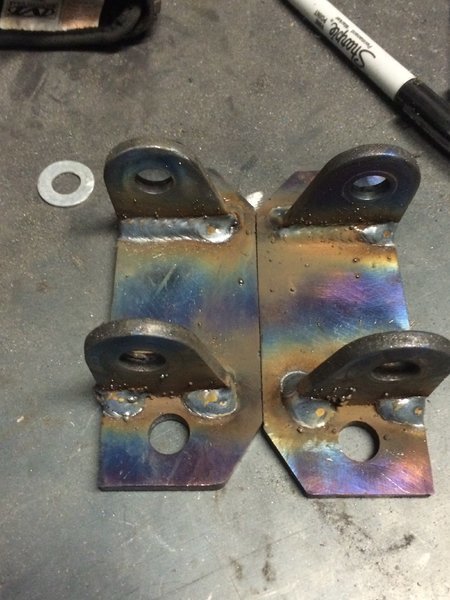

    Not a tacoma and not built by myself. But I wanted my pops to teach me how to weld so learned helping him fab this bed

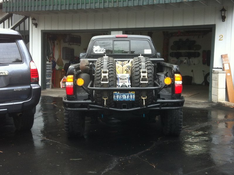

    Bedcage with dual vertical spares and solid mount for floor jack:

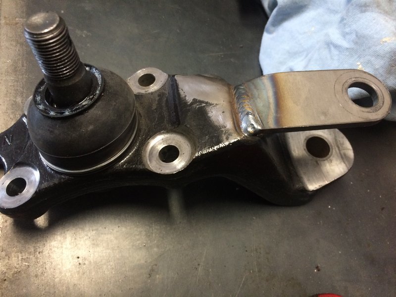

    Double sheered heim joint to replace outer TRE:

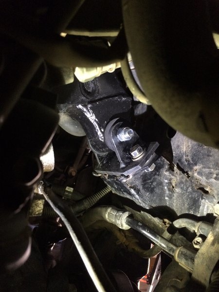

    Engine mounts:
