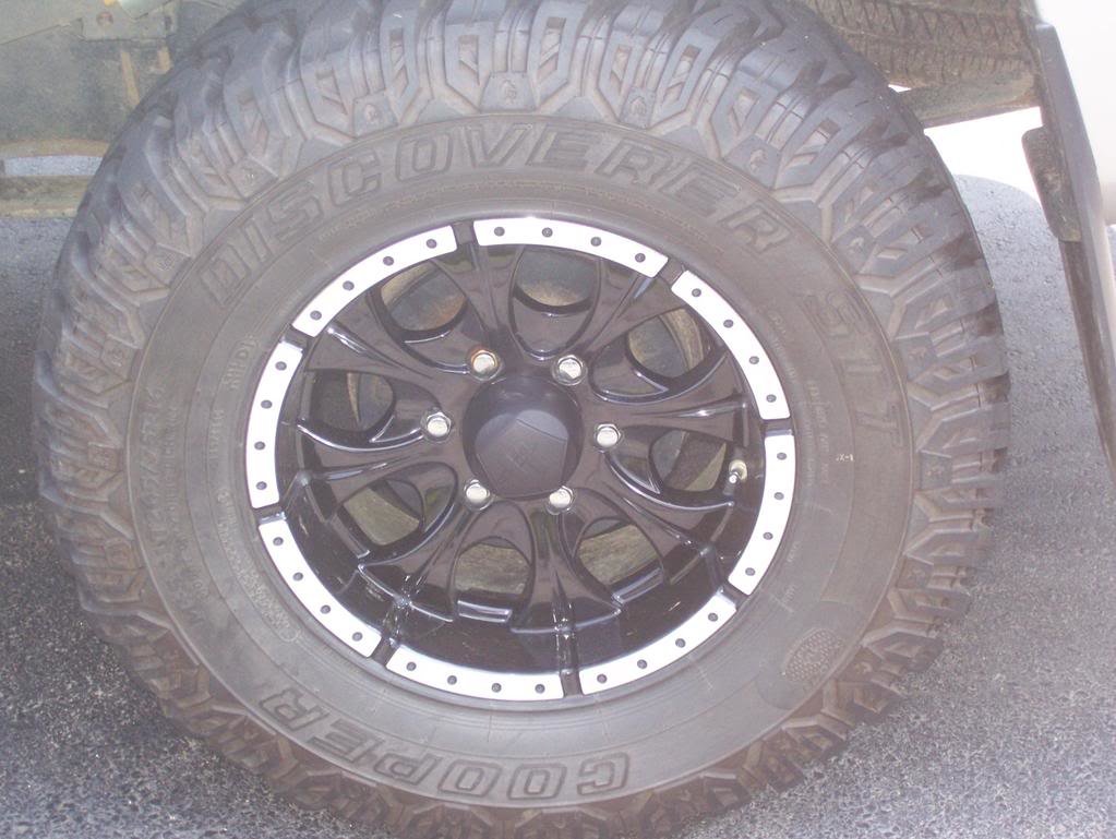

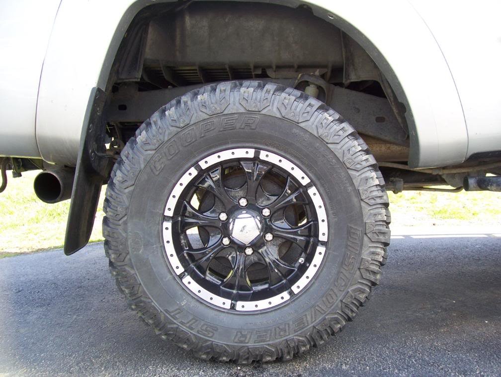

    I painted the center caps Black today.
    BEFORE
    AFTER

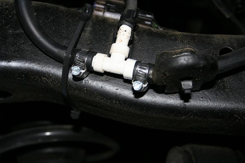

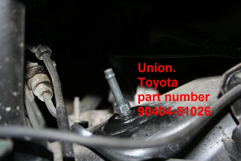

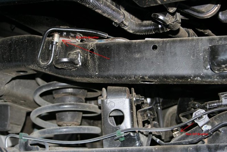

    Did the rear diff/locker mod today.
    Now this is on a FJ Cruiser so your Tacoma rear axle will look different.
    With the TRD 3rd member with the E-Locker you should have another breather going to that. I picked up the "Union" from Toyota today (part number 90404-51026). I then hit up NAPA and picked up some 1/4" hose and a 1/4"x1/4"x1/8" "T" to connect the diff breather and e-locker breather to the one hose and run it up.
