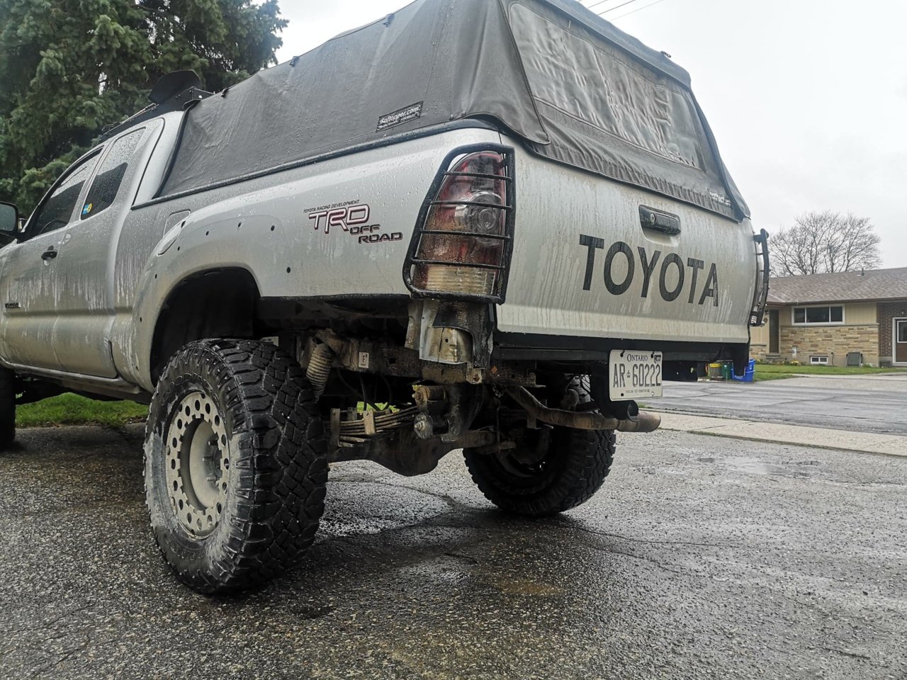

    Bought another softopper and prepped the rear for a HC

    You can run it bumperless??? I’ve been wanting to prepare it for HC but I thought pigs would pick on me lmao

    Actually I'm not too sure on if it's allowed or not, I'm only driving like this for a couple days.

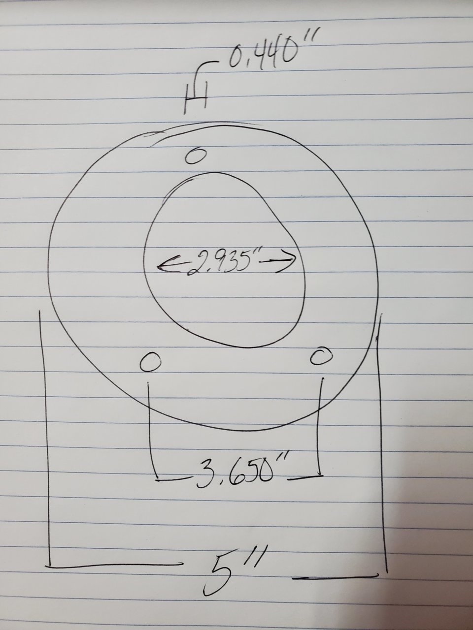

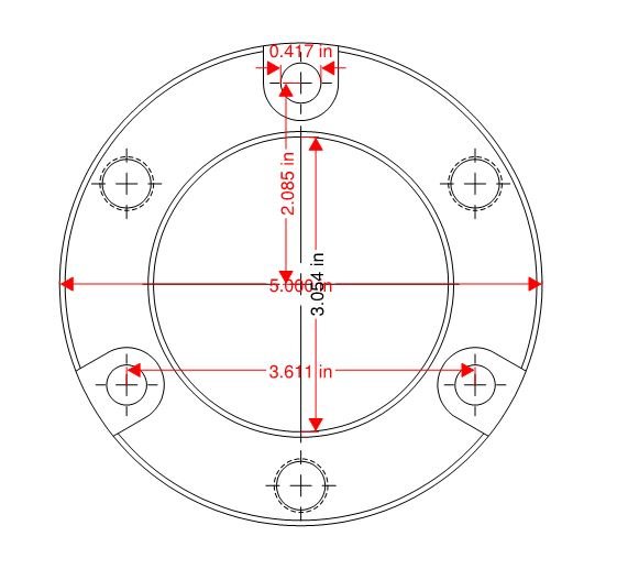

    Hell yeah thank you very much
    I did some blue beaming, this is what I got

    Those dimensions look a little different than mine. Your drawing is a LOT more professional looking than mine though lol. I took the dimensions off of a very cheap Chinese made spacer with a micrometer, a spacer that was well over 5" in outside diameter, and I had to grind the outside diameter because of it.

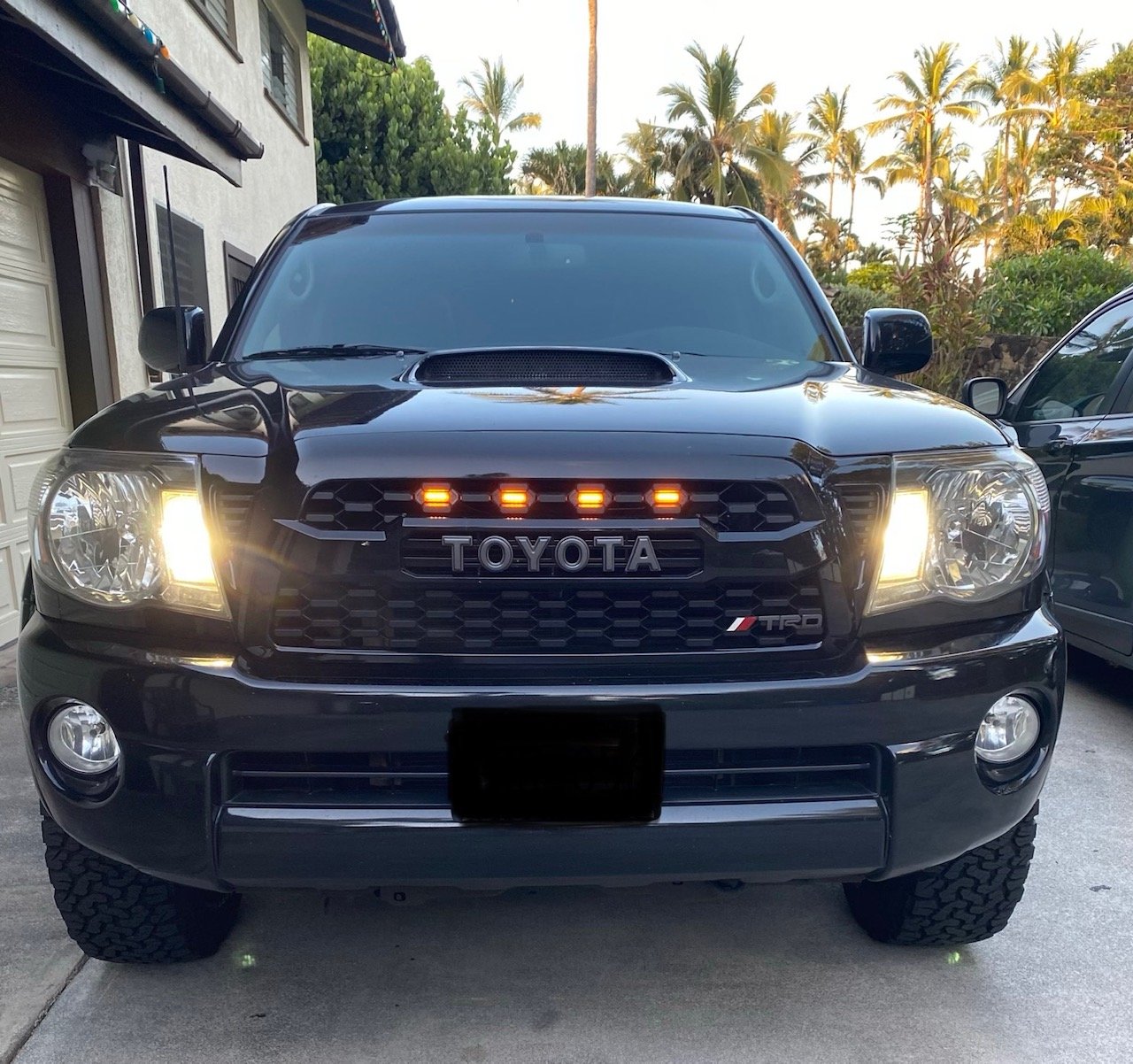

    Link for grill
