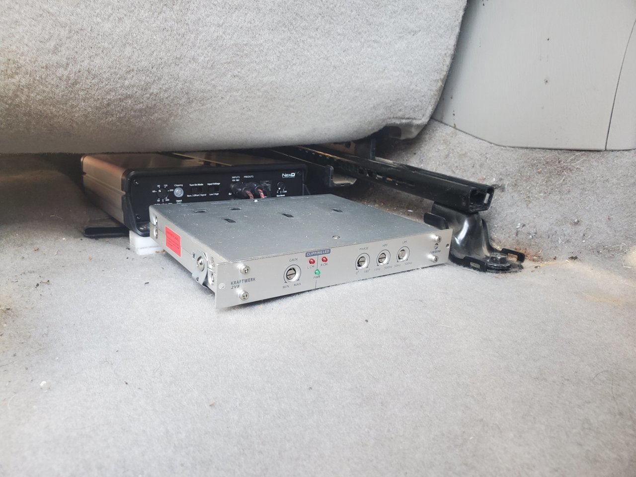

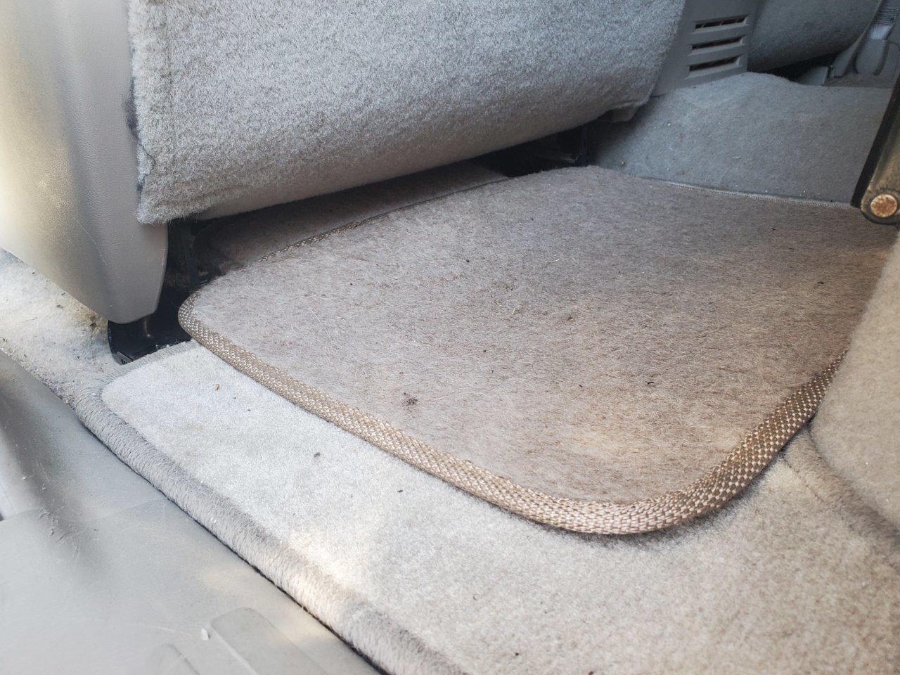

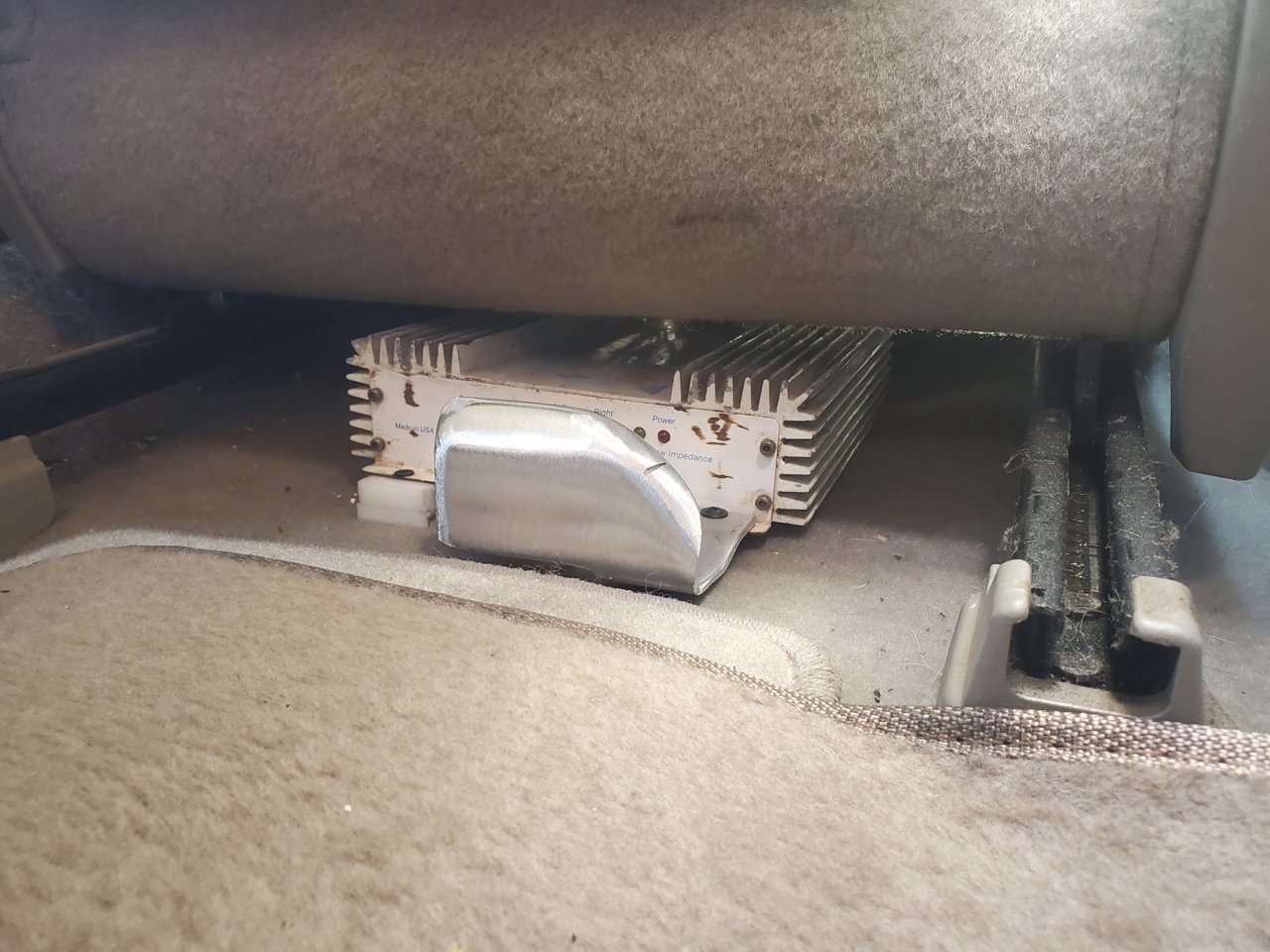

    The other day I ran all of the wiring for my stereo system (not much to show there). Today I installed the amps and the preamp. I'm waiting for more parts before the head unit can go in. I have about another week to wait.

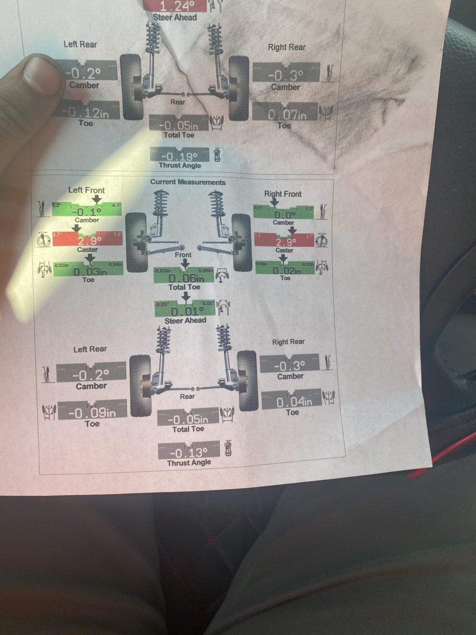

    yes this is high caster. It made ride a bit better mine is not going to be great as mine was in a front end collision therefore I think there is something there still affecting my steering a frame issue I think

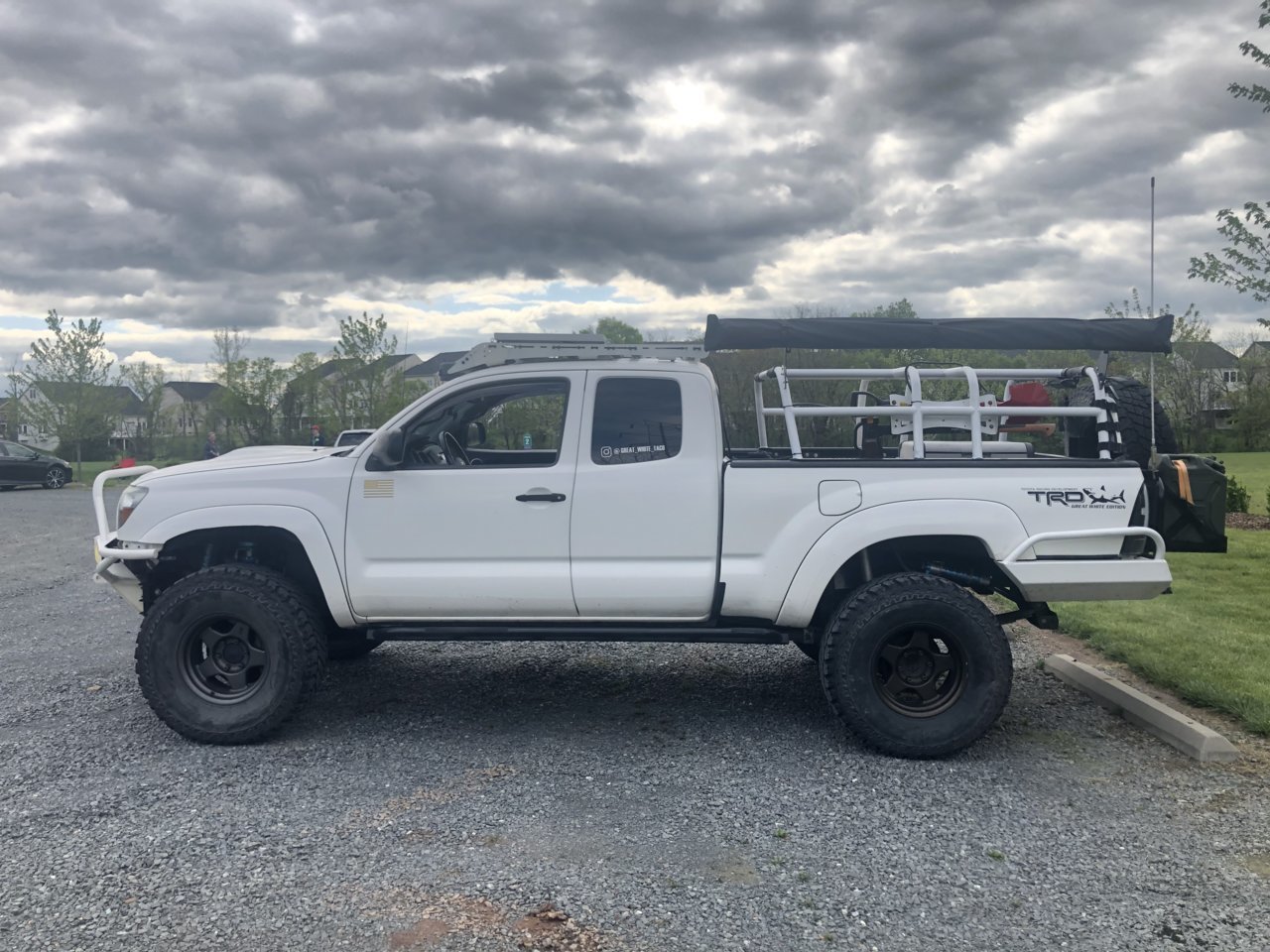

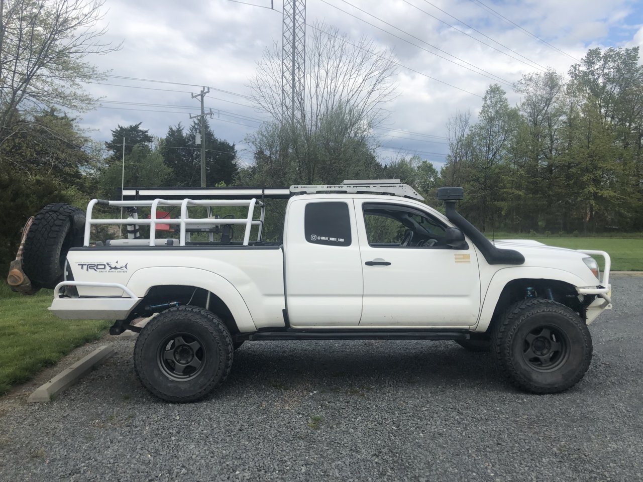

    And then I got my RTT back on

    Which RTT is that pls?

    FSR A49

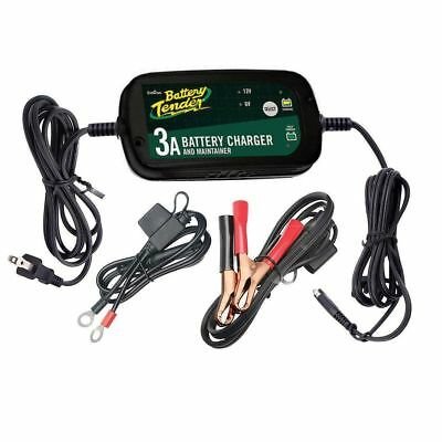

    Not sure how many of you are not driving your Tacos... but here is a mod that everyone should look into for their vehicles that are sitting during this time...
    Left a light on my 2015 Tacoma the other day and killed the battery enough so it wouldn't start... added a pigtail and set the charger on it task... overnight and it started like a champ after it was fully charged.
    I have a couple of these https://www.costco.com/battery-tender-power-plus-3-amp-charger.product.100241973.html and a few extra pigtails attached to the (Tacoma, Raptor, Avalanche, Edge and my generator). and they work great! Cheaper at Costco than anywhere else. Highly recommended.
    Well worth it....and won't overcharge (Battery Maintainer)

    CTEK is probably better and doesn't cost much more

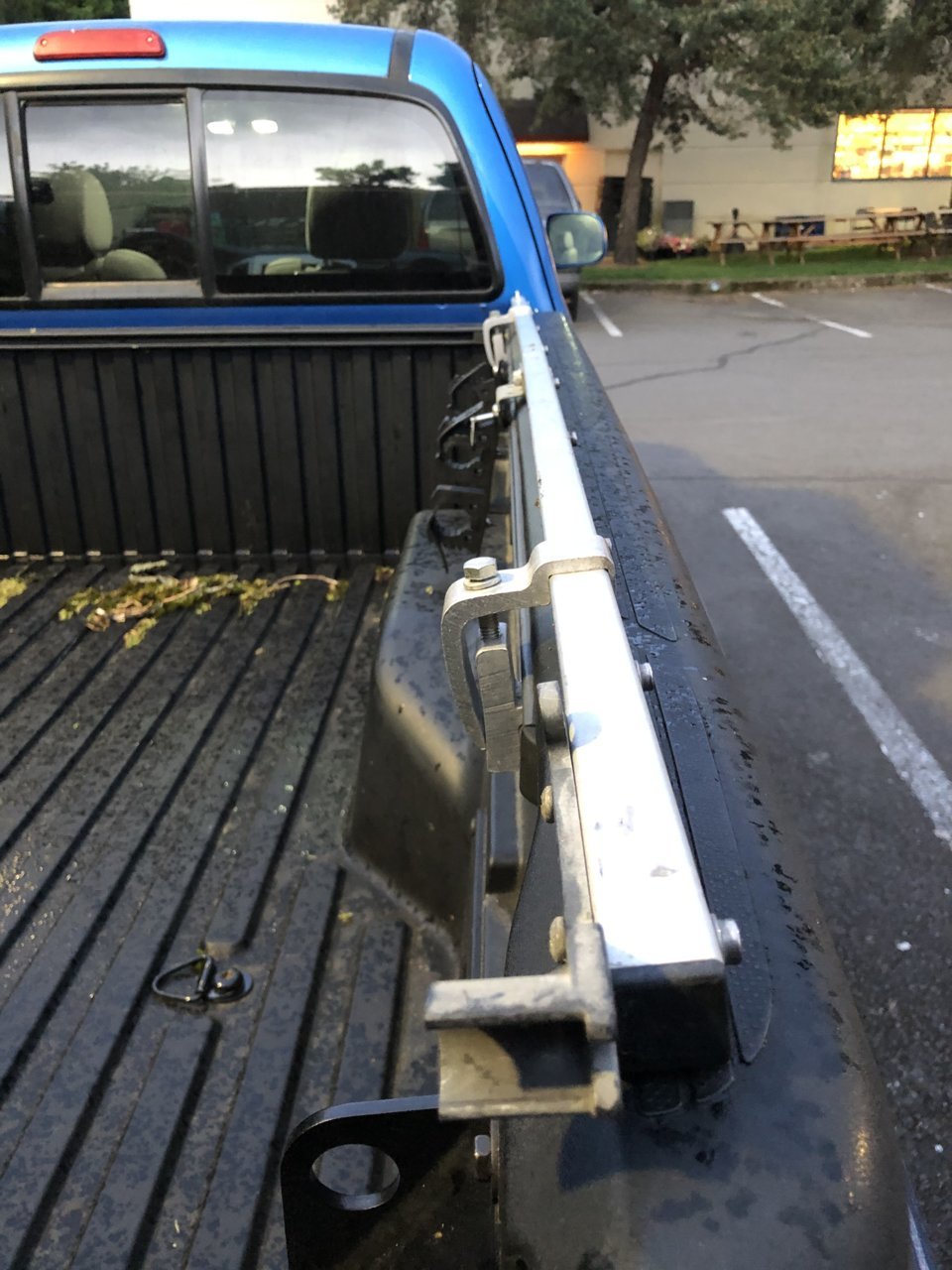

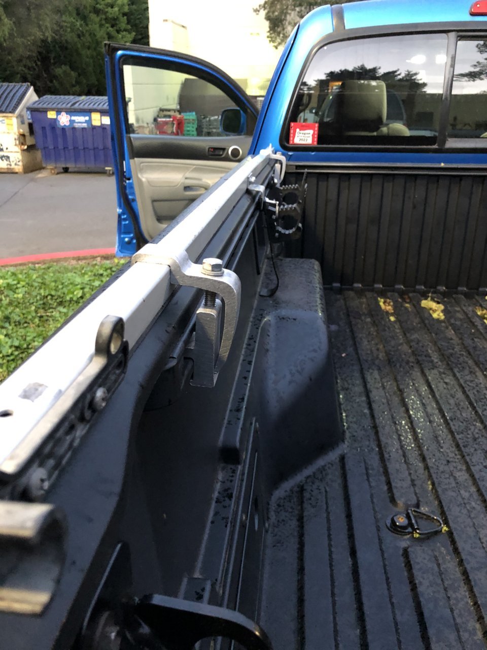

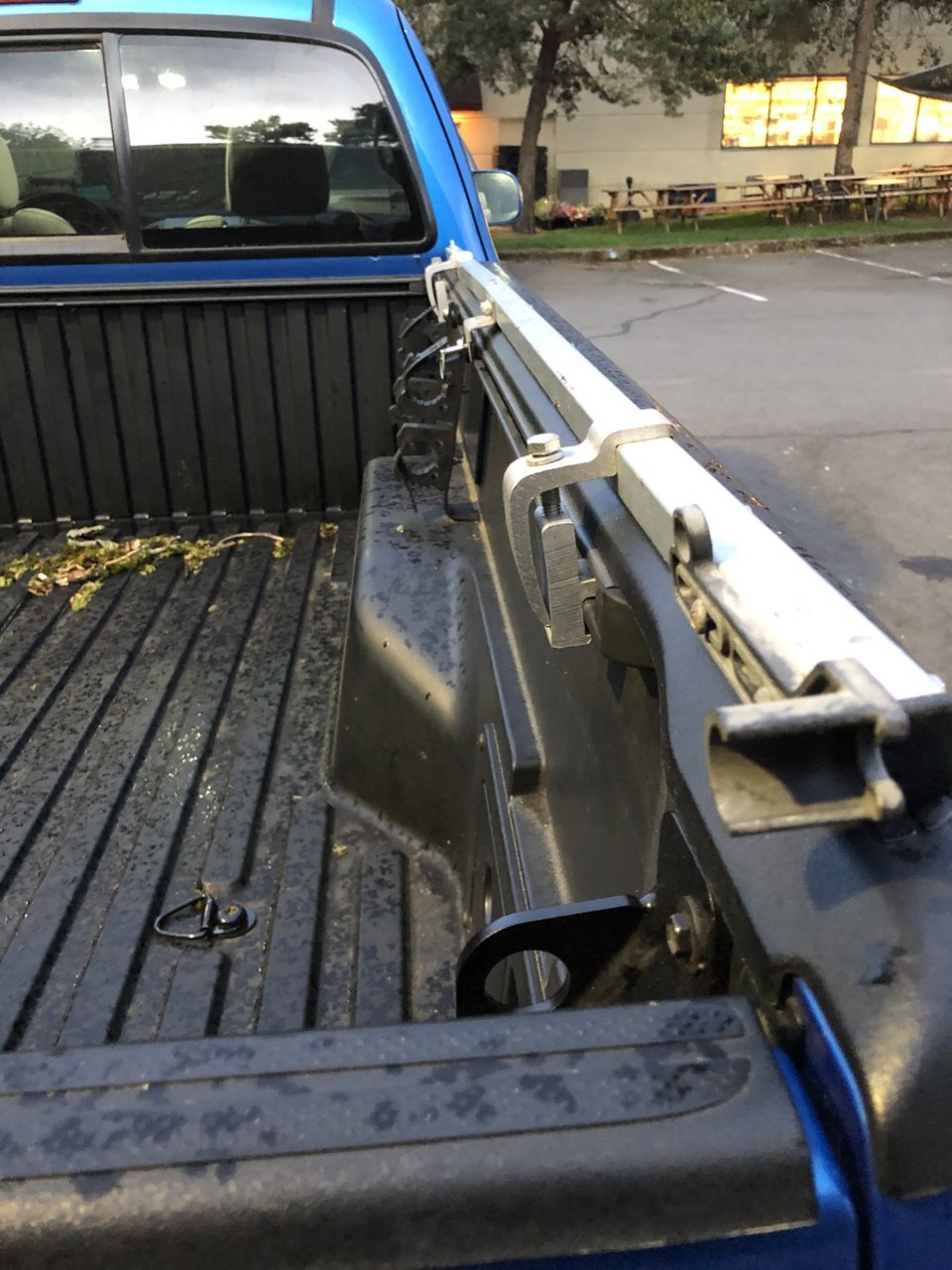

    Sorry, not something I did but more so just reaching out for help. I recently got a nice used softopper, and am in the process of putting it on the truck.
    But I think I may have messed it up?
    The rails are slightly angled into the bed. Are they supposed to be like that or did I mess up? Anyone have a similar experience?
    Pics of the rails currently.
    [​IMG][​IMG][​IMG]

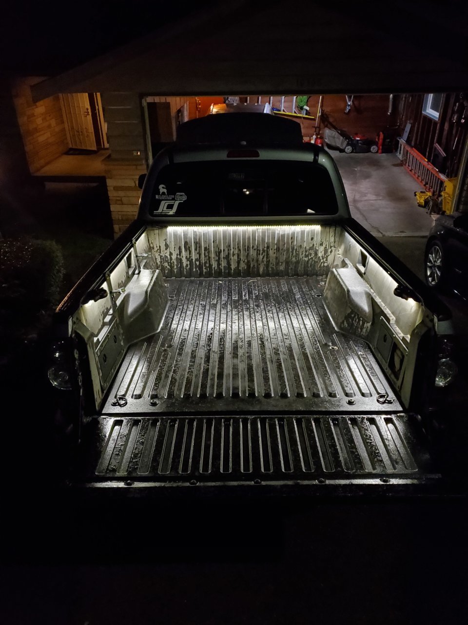

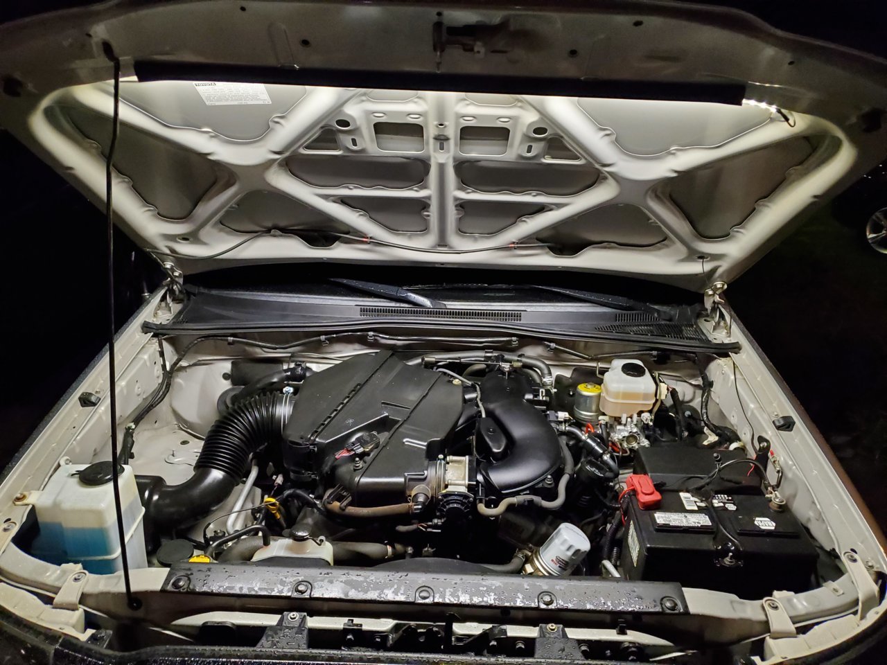

    Woo! I installed some Matt Gecko LEDs today. I saw them posted here a few days ago and popped on them. Quick shipping and an easy install (even for a beginner like me). This was my first unsurpervised wiring adventure. It went well, but took about 3 hrs to set up and run the wires for both sets. I'm really happy with the install and the extra light! Starting raining on me during clean up, perfect timing!

    It is hard to tell from the picture but it looks even if you measure from the inside of the bed. If you are looking towards the outside of the rails then the top of the bed is tapered in and will appear uneven. At least it does when I have my tonneau cover on.

    Since the bed rails have tapered sides, it's really easy for the Softopper square tube frame to get sucked down to the taper like yours has. I make sure to line the square tube frame right at the edge of the taper so that it sits on the flattest, inner-most point. I usually start at the front of the bed, line it up, then take my impact driver and quickly snug down the pinch clamp bolt while holding it there so it doesn't slip down the taper. Then I move to the back of the bed, hold it on the flat spot and snug down the pinch clamp bolt. That way, I get it mounted flat and square right where I want it.

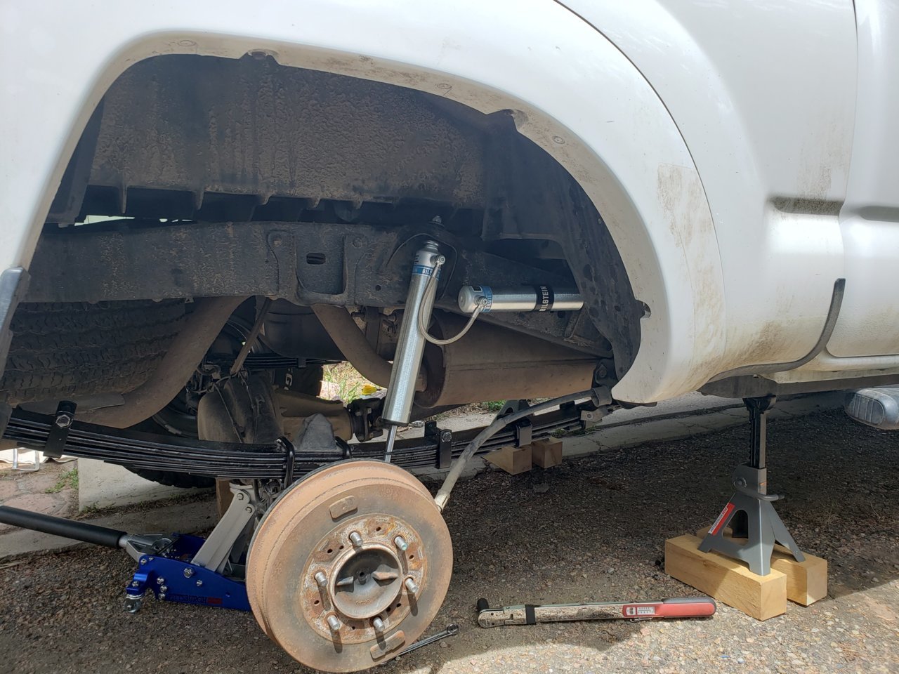

    Put in 6112's on 3/2, 5160's in the back, Icon 3-leaf AAL, and a leaf pack from a 2019 yesterday. Really glad I bought the new leaf pack, found it on Craigslist for 60 bucks and was so worth it. Cant imagine trying to cut those retaining clips off with the leaves still on the truck. Extra leaf pack gave me extra time to clean up the leaves and paint everything without having to have the truck torn apart.

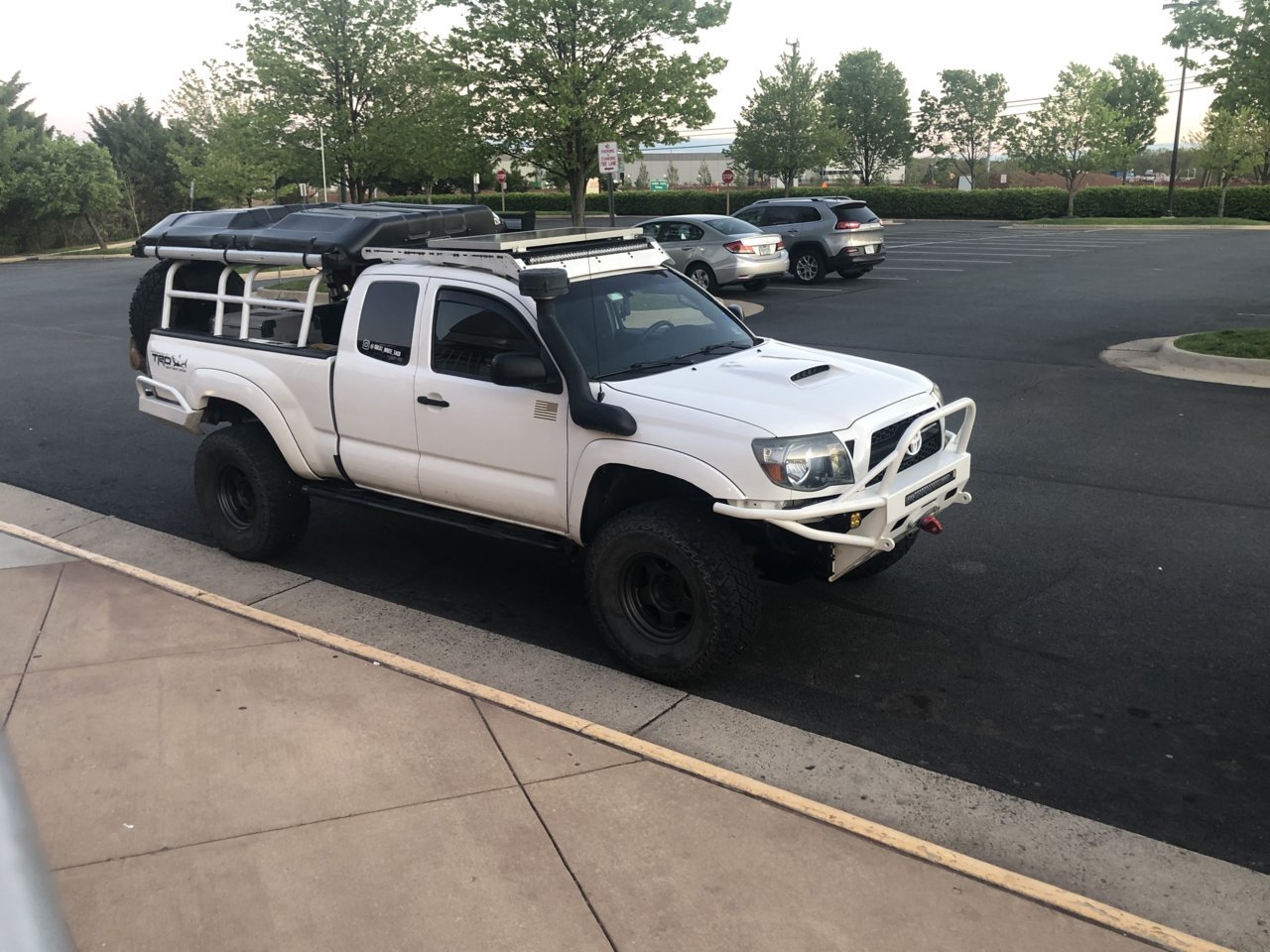

    This is it open
