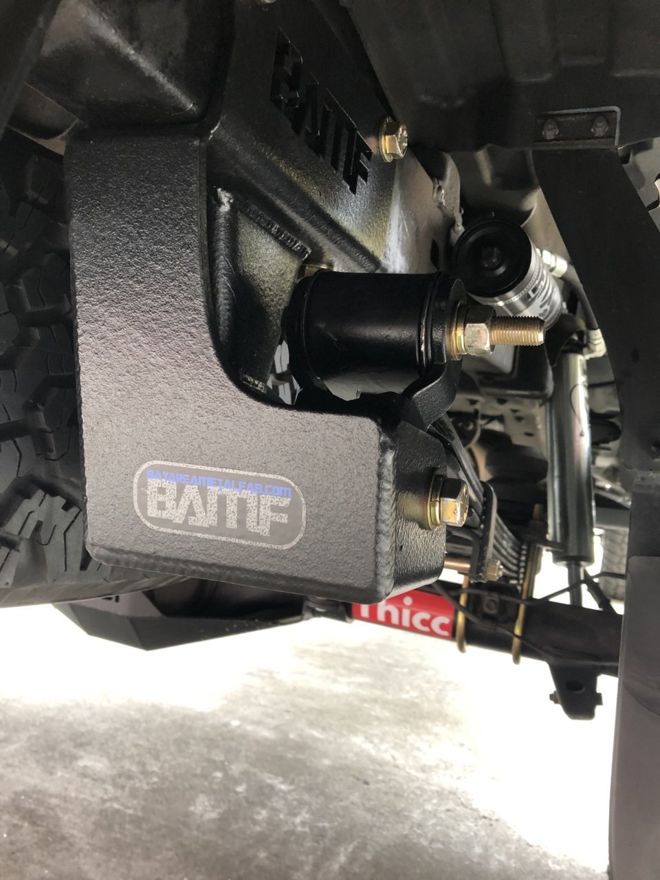

    Extremely tempted. How do you like them so far?

    Installed on Saturday. On road, definitely noticeable as the rear end of the truck feels more planted and stable. I can feel the suspension doing its job. Hoping to get an off road test in the coming weeks. You won't regret it. Only part that sucks is the removal of the oem hangers.

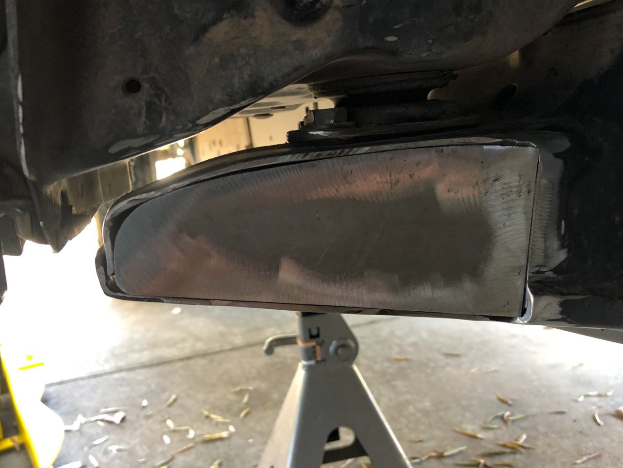

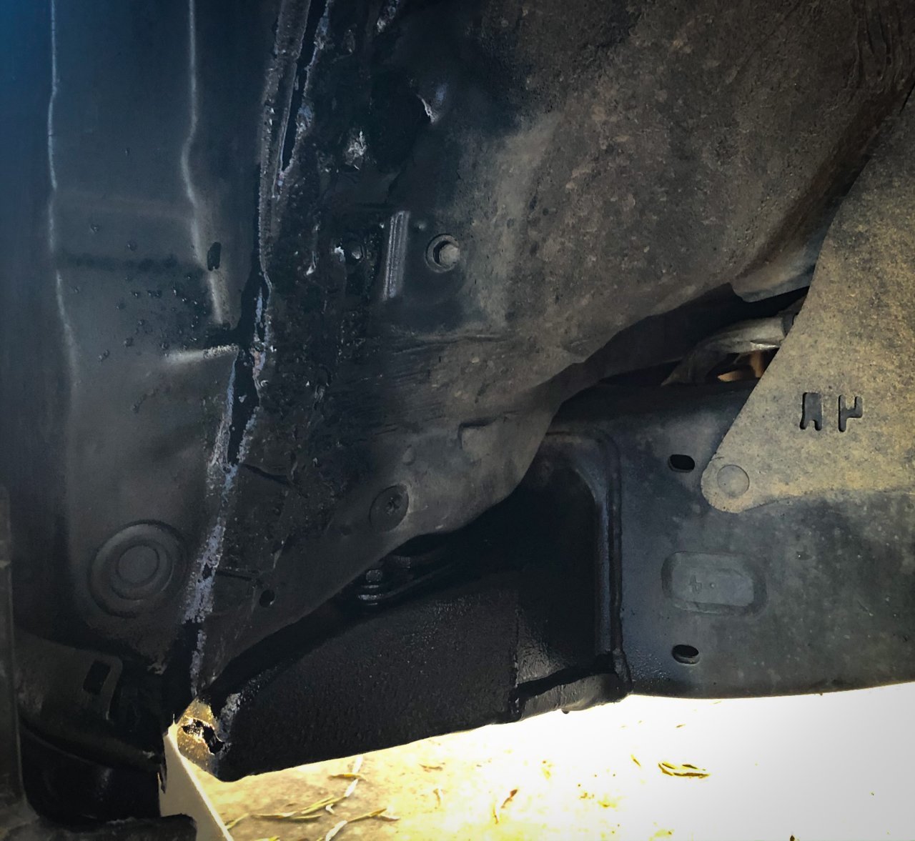

    I did my CMC and Pinch weld today. I highly recommend the BAMF CMC plates they work great!

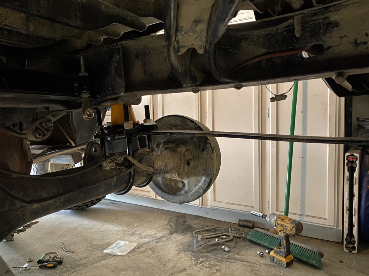

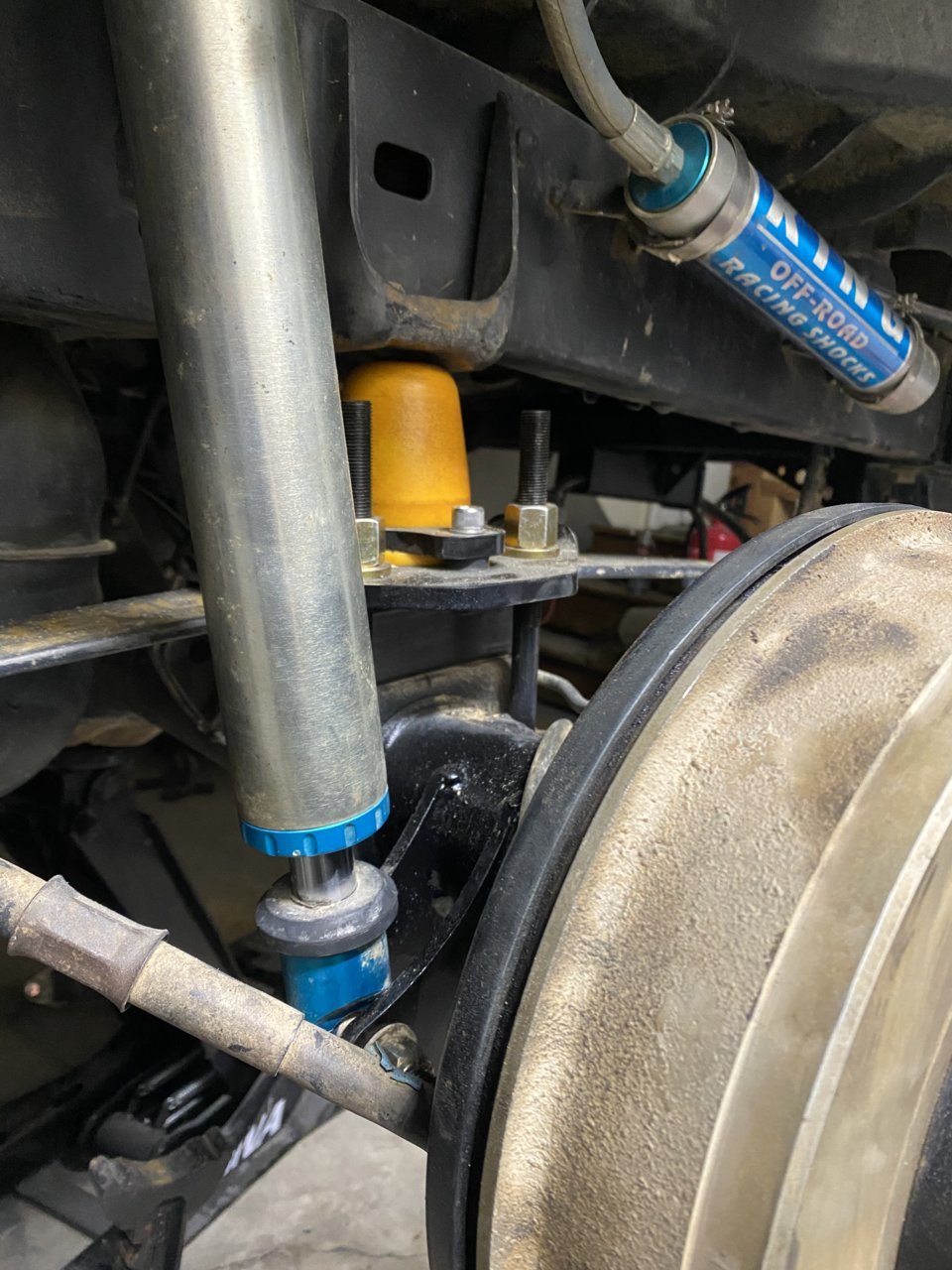

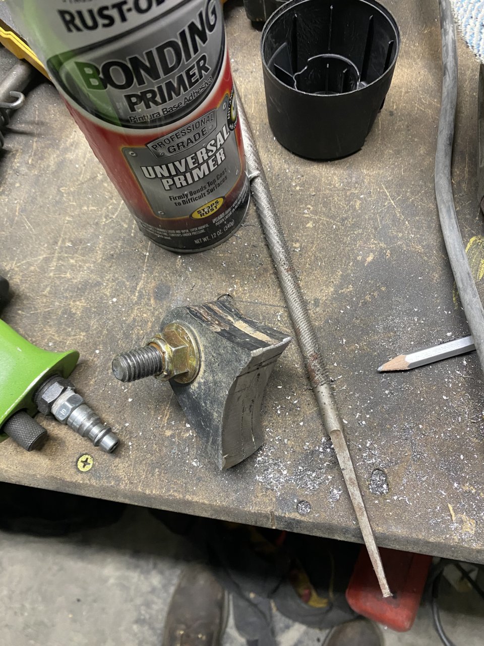

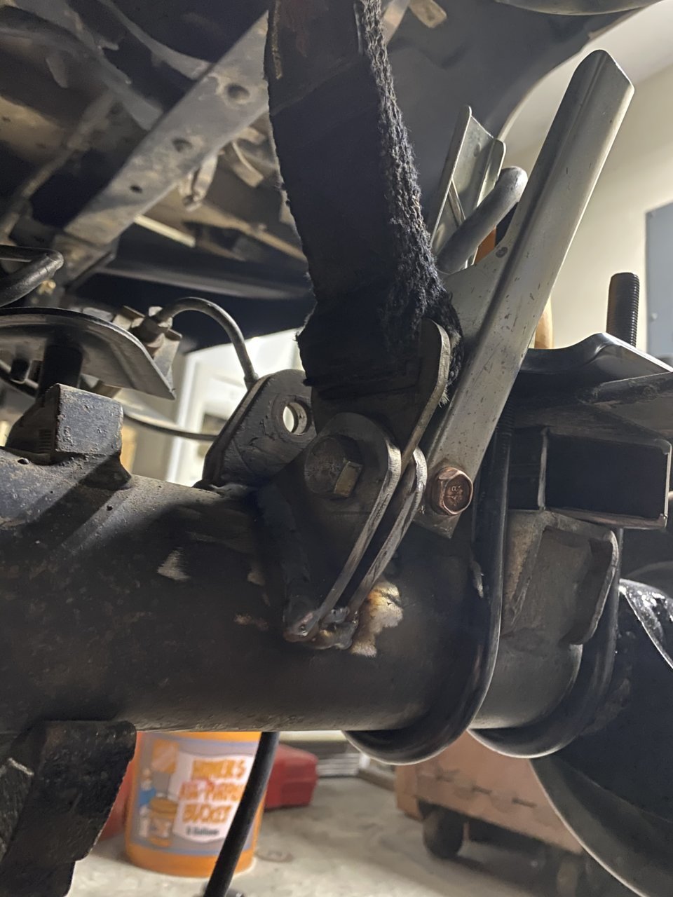

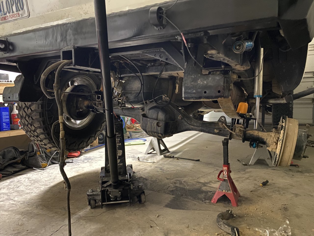

    Yesterday I cut off my lower shock mounts and broke down my leaf pack so I could articulate it in the garage. I wanted to gain some up travel back. When I did this I learned that my recently re-done limit strap mounts contacted each other before bump stops engaged. So I got crafty and reused my old shock mounts to make the beefiest limit strap tabs ever. Now there’s no clearance issues.

    How the heck did you manage to get such a perfect fit? Pretty precise there lol. Mine was all sorts of jacked up and I had to just roll with the punches :oops:

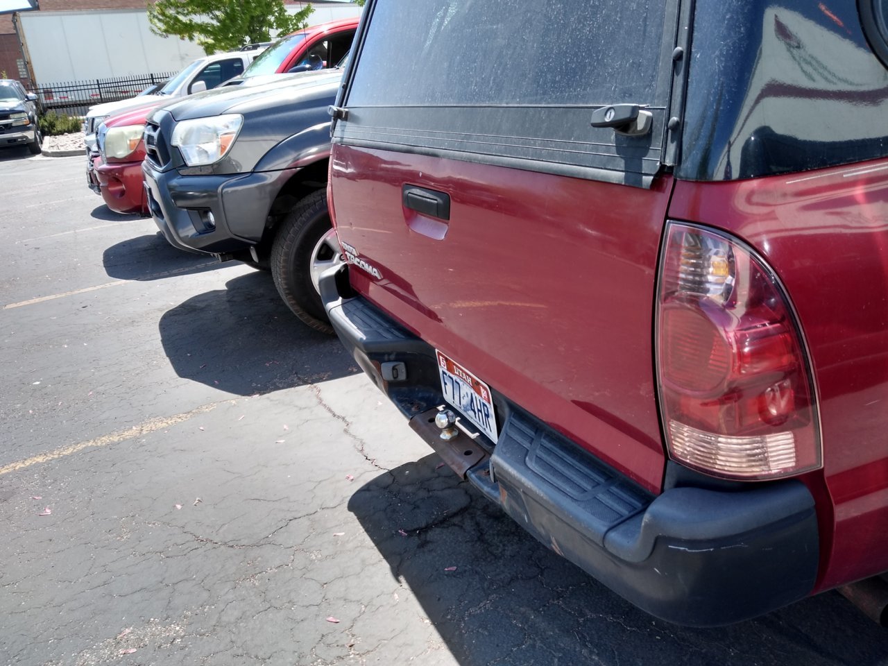

    I used to think that my shell was MGM, but parked next to this guy, now I'm not so sure.
