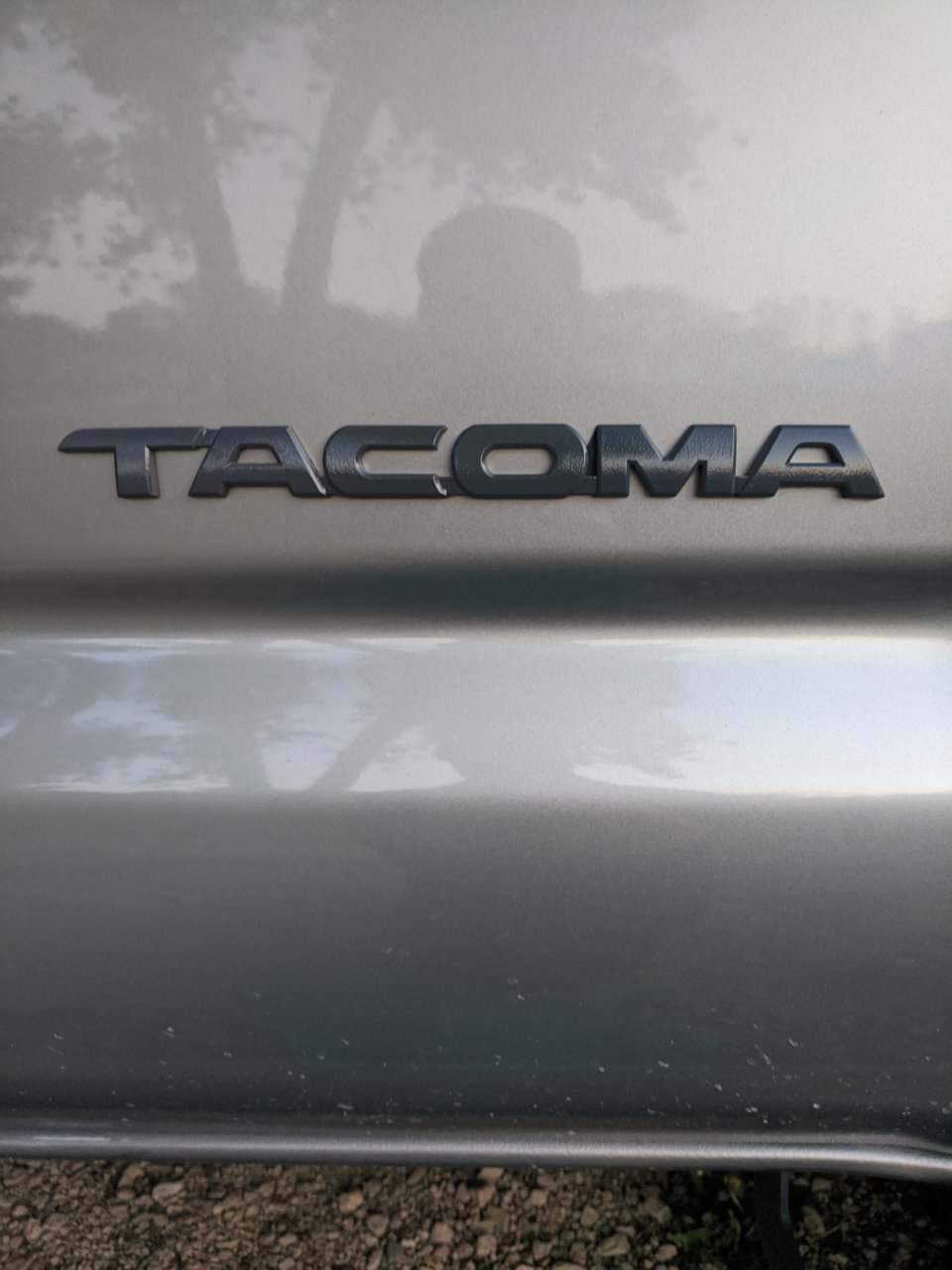

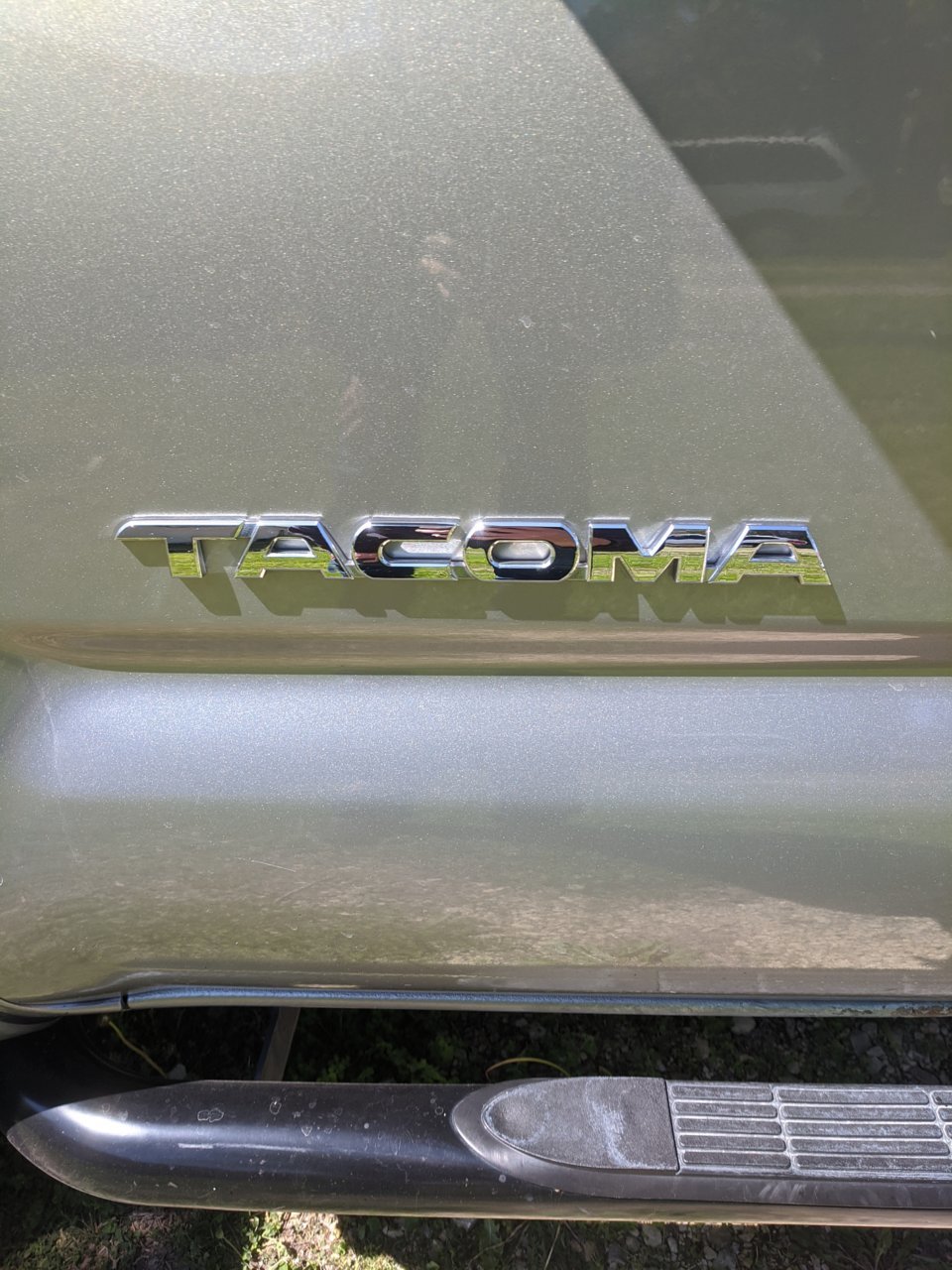

    The first coat will really soak in after you wash it with dawn. You might go ahead and hit it with a second coat once its dry. The stuff is expensive, but I have never used a better product.
    I would probably power wash it too, if you have one. Good Luck:headbang:

    Only garden hose unfortunately. I'll just scrub it good.

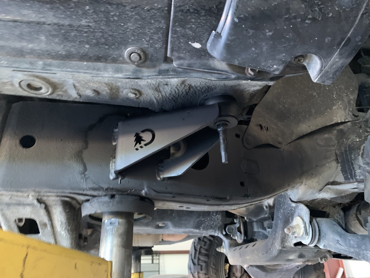

    Installed front superbumps last night.
    Still need to install new gas tank straps, replacement SPC upper ball joints, and EL095R rear leaf springs. I have the parts, but not much of the time lol.

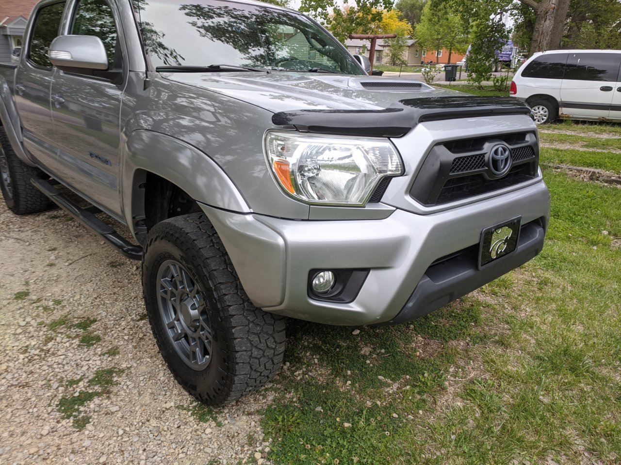

    Looks good! Also Go Cats! I miss the hell out of Manhattan.

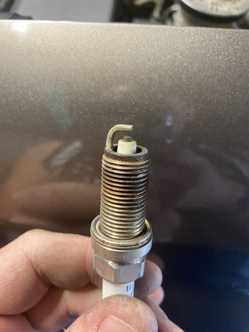

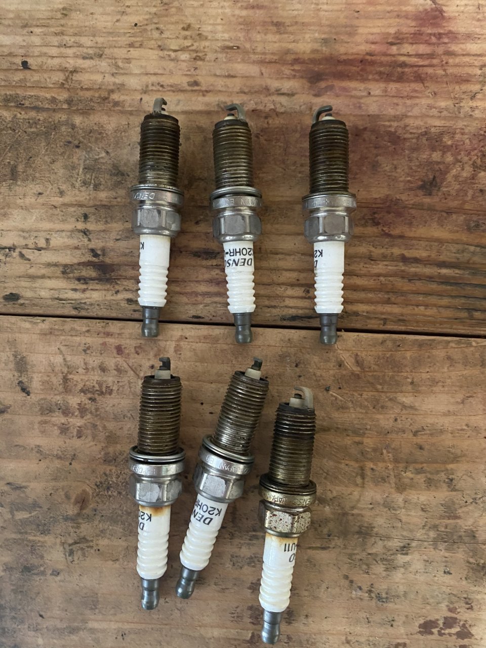

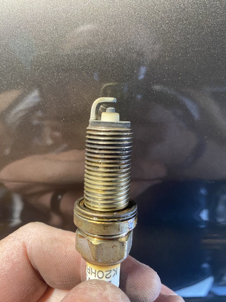

    Changed out the plugs on my truck for the first time since I’ve owned it. Looks like they have been replaced at least once since all of them were Denso. Didn’t look too bad for an unknown amount of mileage. They have over 30k on them at the very least. Gap was around .050” seemed high unless that just due to normal wear on the electrode. I gapped the new plugs at .040”

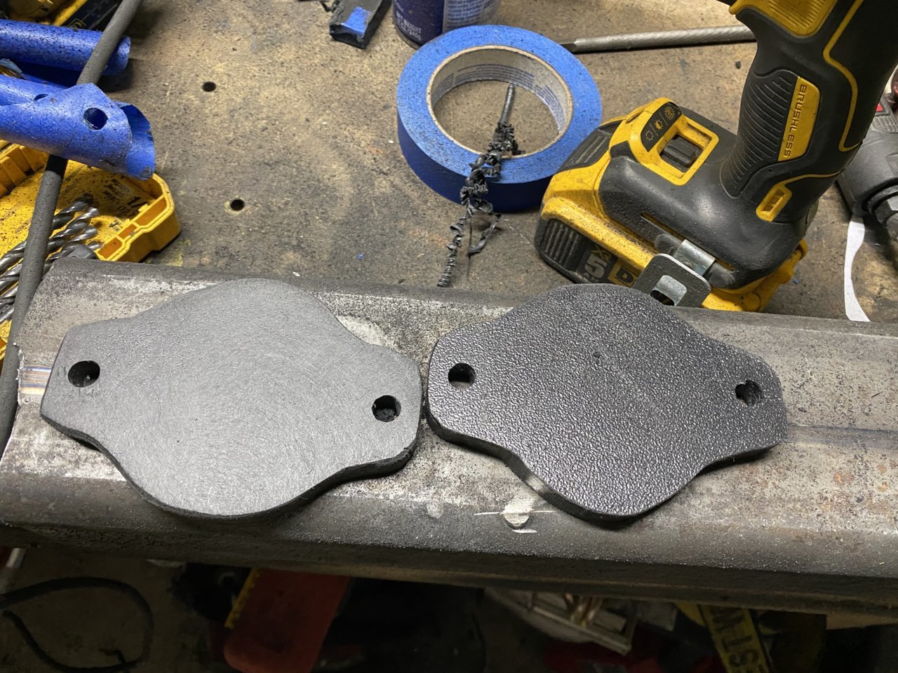

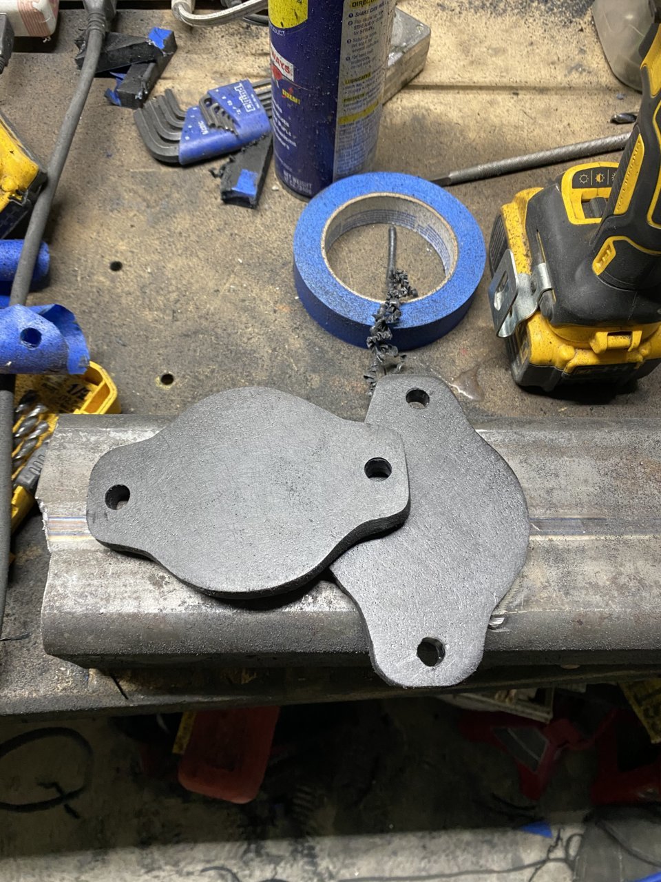

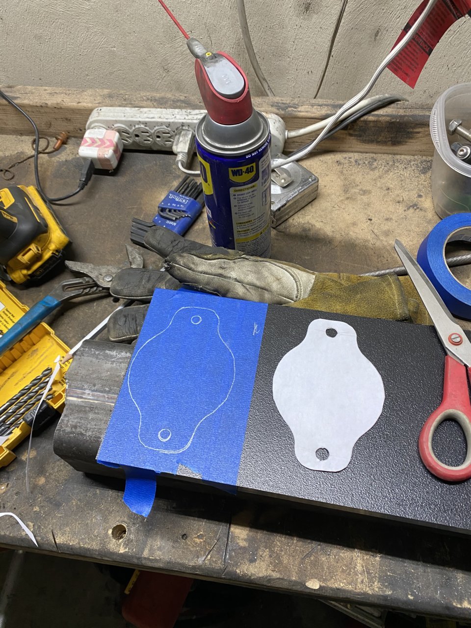

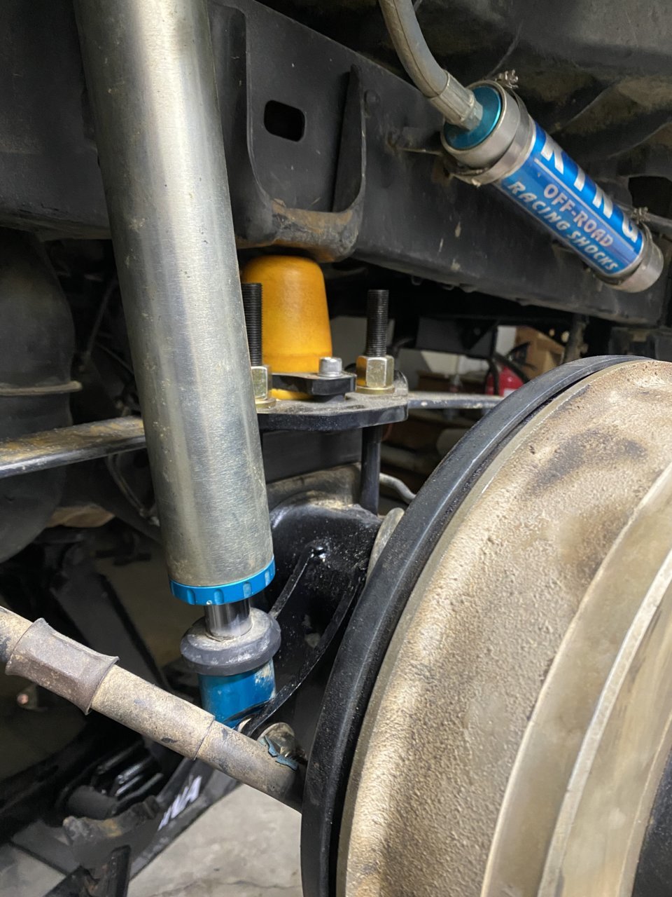

    I made some 1/2" bump stop spacers for the rear that will sandwich between the u bolt flip plate and the bump stop itself. Just wanted a little extra margin of error to protect my shocks in the case of a hard bottom out. Just need to get some longer hardware and will bolt them on. These are for the archive garage bumps and flip plate.

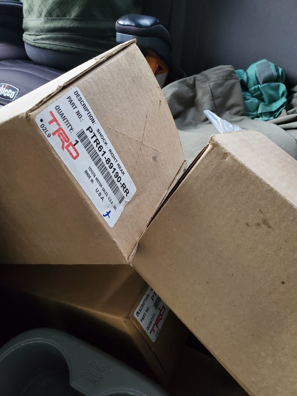

    Couldn't pass up a deal on a brand new set of TRD Pro shocks and coilovers.

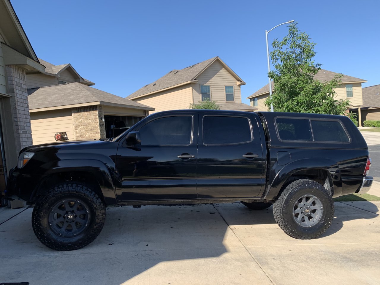

    Trimmed a little more off the rears today. Pretty happy with how it sits now
