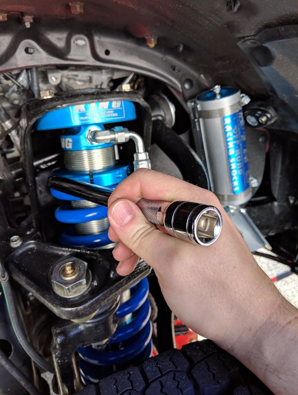

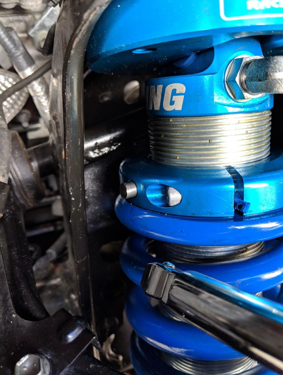

    That’s where the short one comes into play. I slip it in between the tower and the shock and put it in the hole. Then tap it with a hammer to get it to rotate a little. Then use the long tool for the rest of the rotation.

    Nice! I gotta make one of those. I think I just marred up my top ring right when I installed them

    Like this, except I welded the piece of punch into a 10mm. It does fuck up that one hole a little since it is aluminum after all, but it doesn’t bother me. I don’t recall the size of punch off the top of my head. I think 5/16.

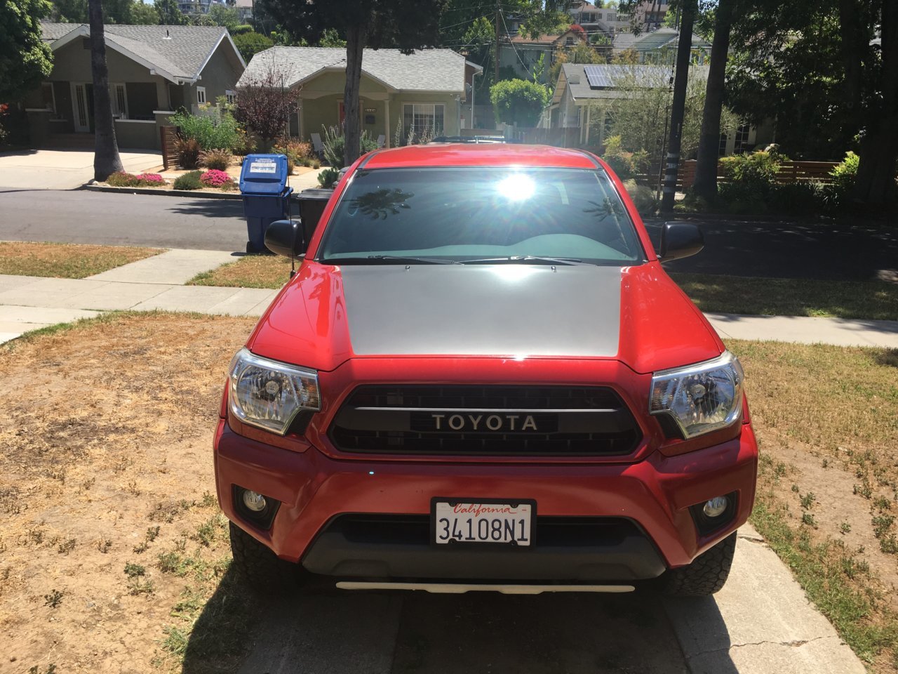

    My buddy helped me, he's pretty good at it, and I'm really not. It's surprisingly difficult until you have the right touch. I love that I did it. Muted the red a little, and added protection for when I put surf boards on the rack so salt water isn't getting everywhere. Everyone is always concerned that wrapping the roof in black is going to cause the cab to get really hot... I haven't noticed any increase in heat at all.

    Probably haven’t noticed since red is the second worst color for heat absorption. Great look though. Makes it stand out.

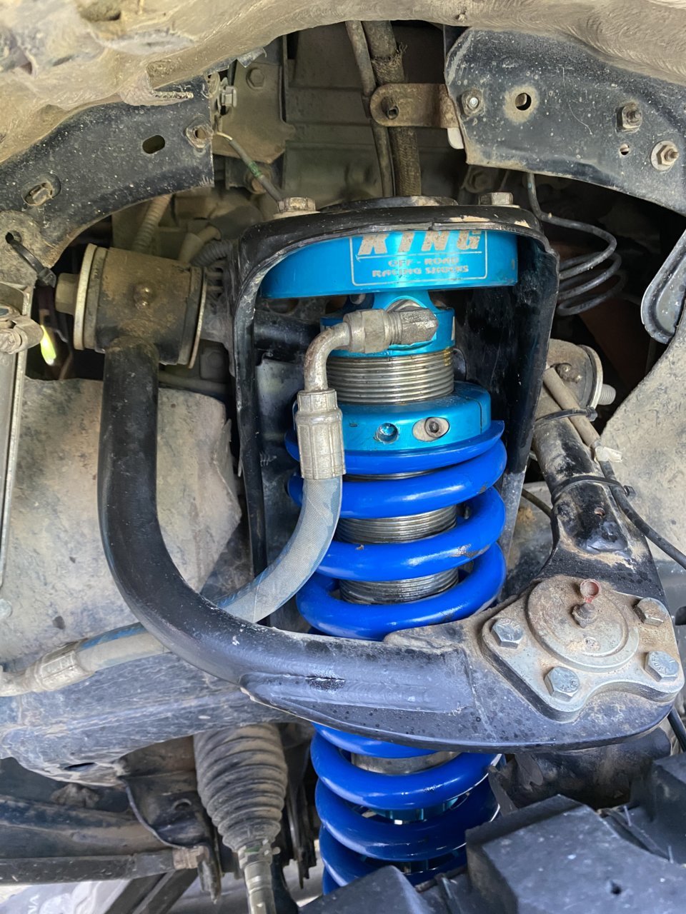

    How're those delta joints doing for you? I have the regular uniball UCA's but have the DJ retrofit kit ready to install whenever the original uniballs start to wear too much.

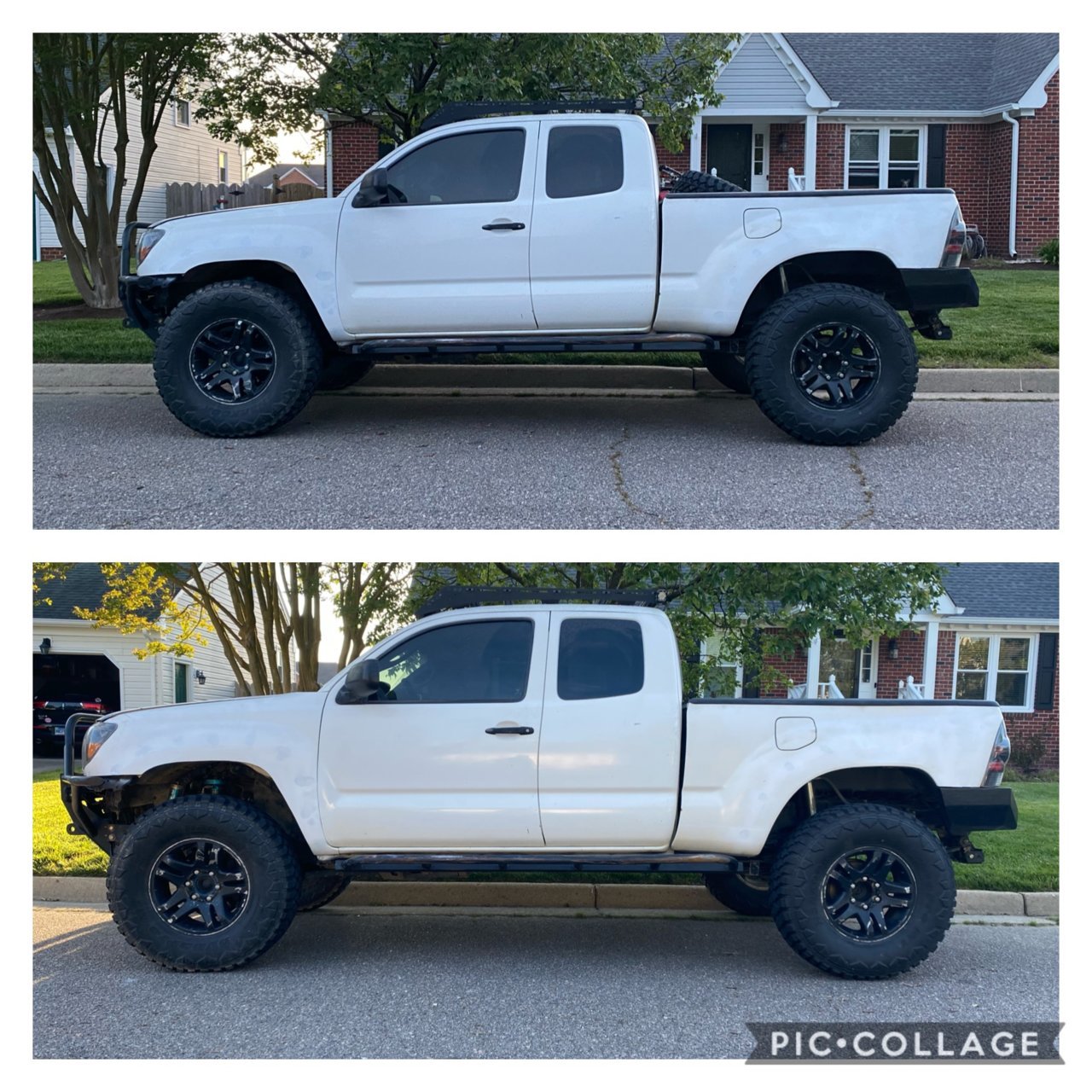

    How much did you end up raising the front?
  14. May 15, 2020 at 7:02 AM
    EatSleepTacos
    Mar 24, 2015
    #151688
    59,838
    Randy
    West Valley, AZ
    2017 4Runner
    I’m not sure, I didn’t measure. Approx 2”

    Have you driven it since raising the front? Any alignment issues?
  16. May 15, 2020 at 7:12 AM
    EatSleepTacos
    Mar 24, 2015
    #151688
    59,838
    Randy
    West Valley, AZ
    2017 4Runner
    When I installed the new coils I had no preload on, so the front was stock height. Then I raised it back up a bit. My alignment is all fuckered so I will do that when I install the Alignment cam delete bolts.
