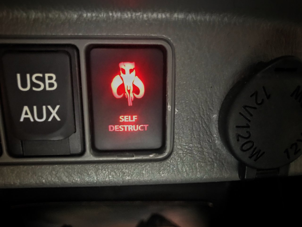

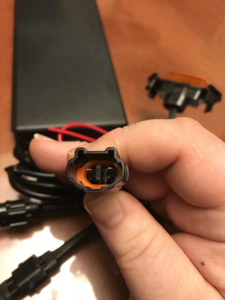

    Finally installed my bed lights I received as a Christmas gift a couple years back. Got sick of doing electrical mods around that time. Also added a self destruct switch that may or may not turn the bed lights on and off.

    Where'd you get the switch?

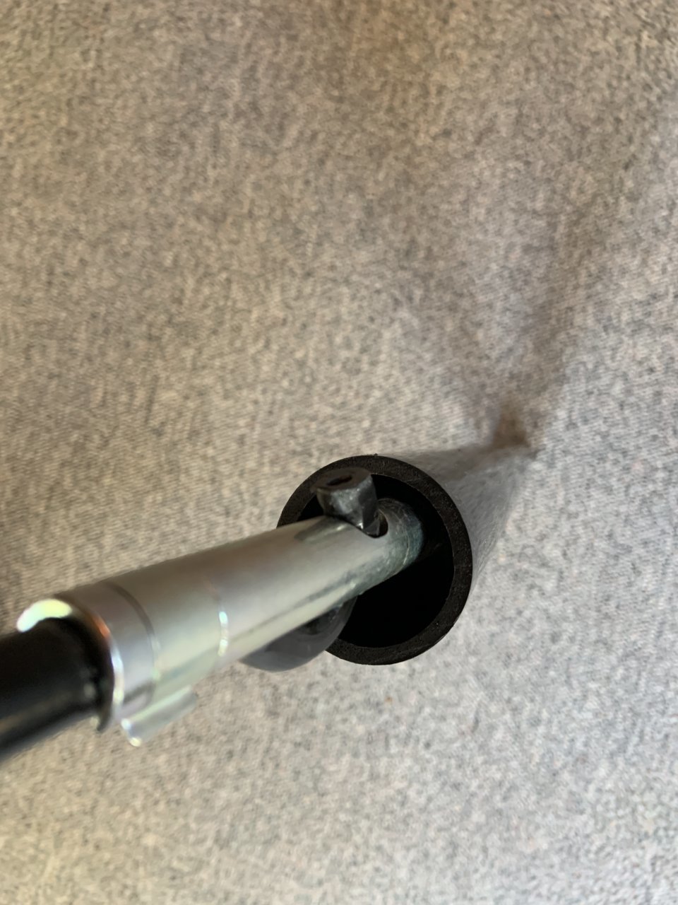

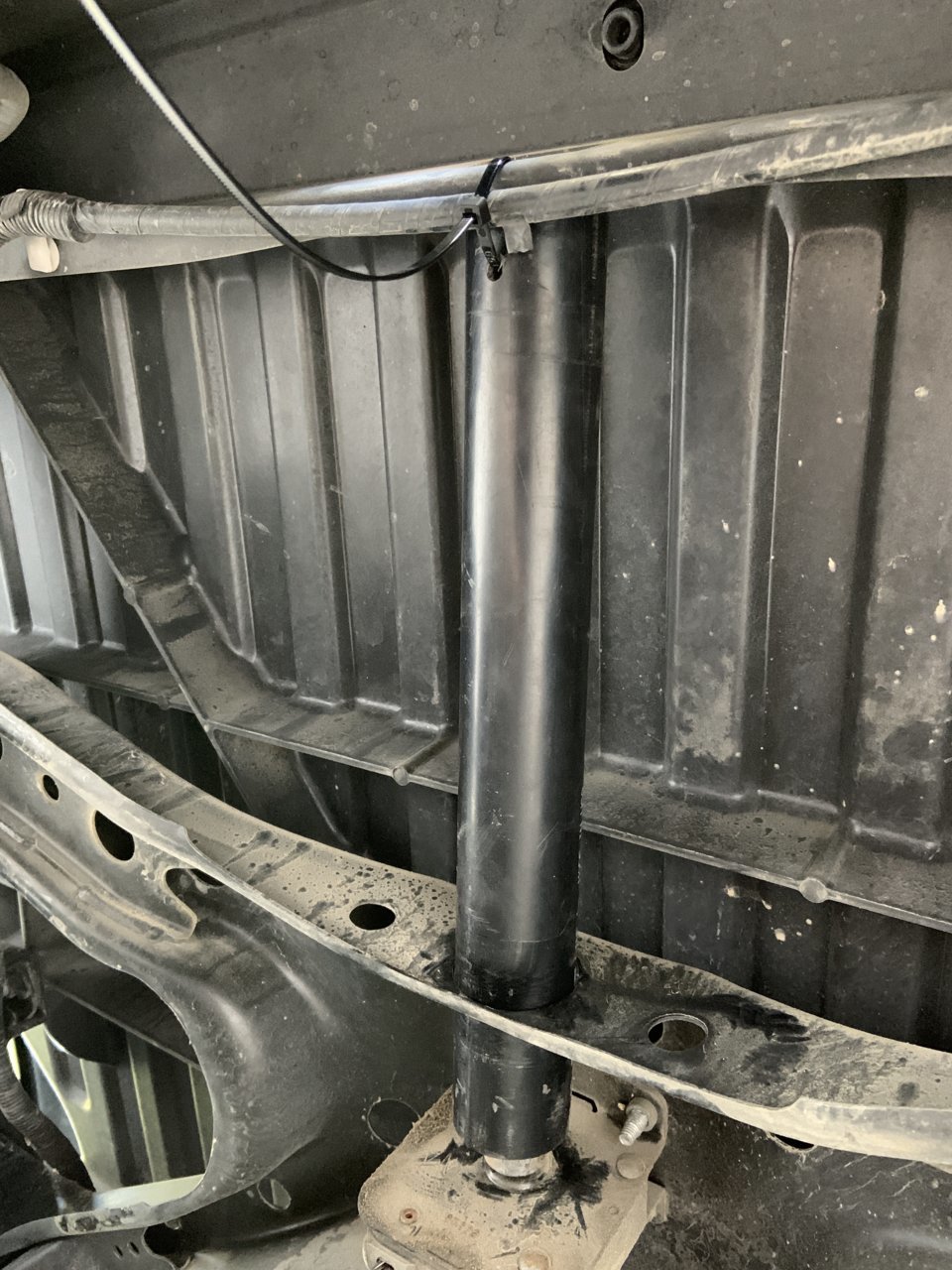

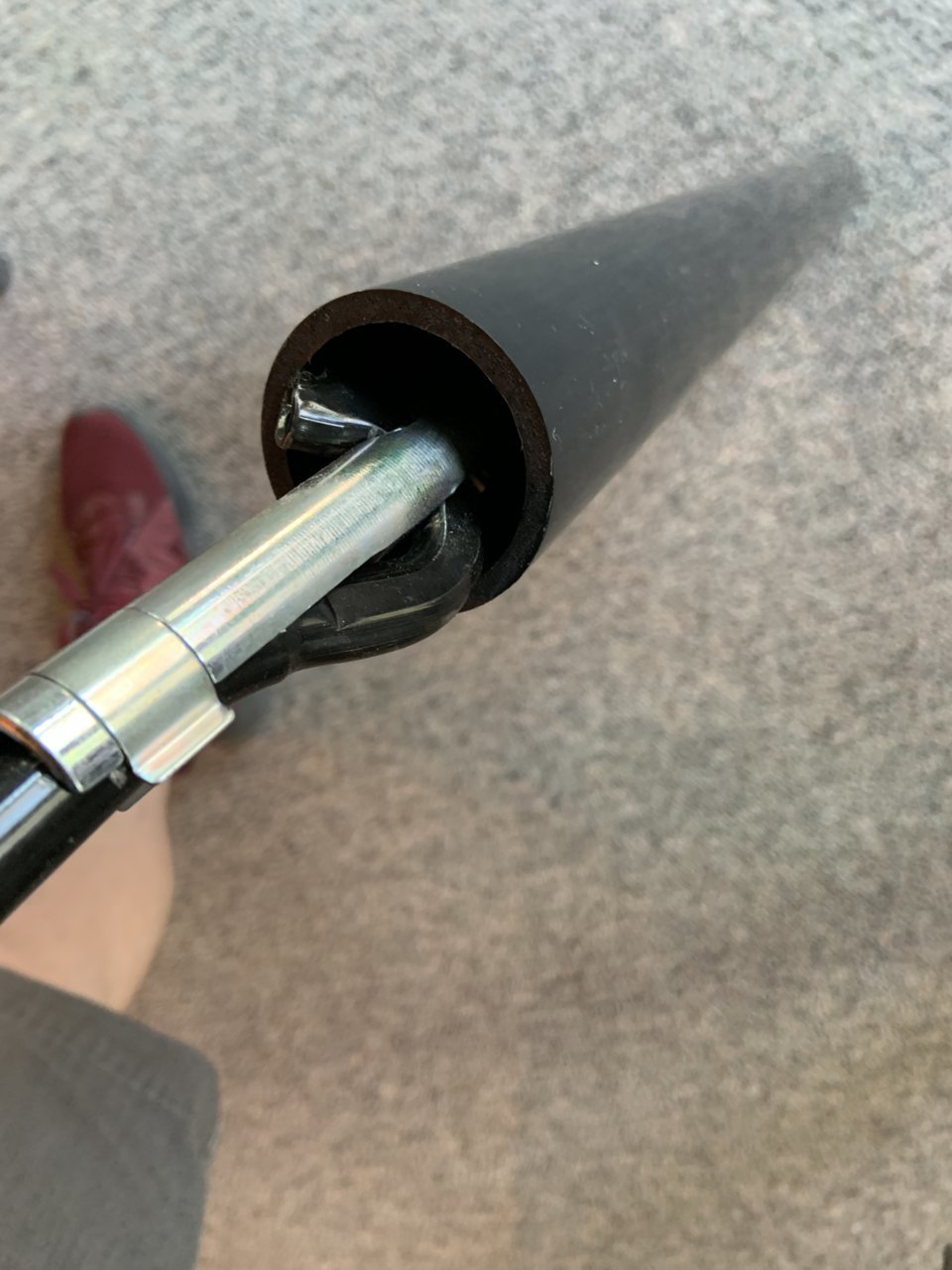

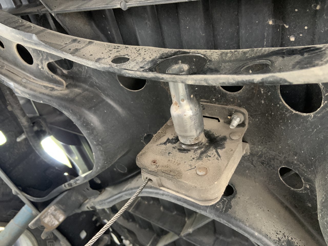

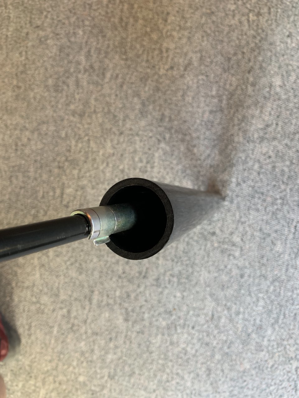

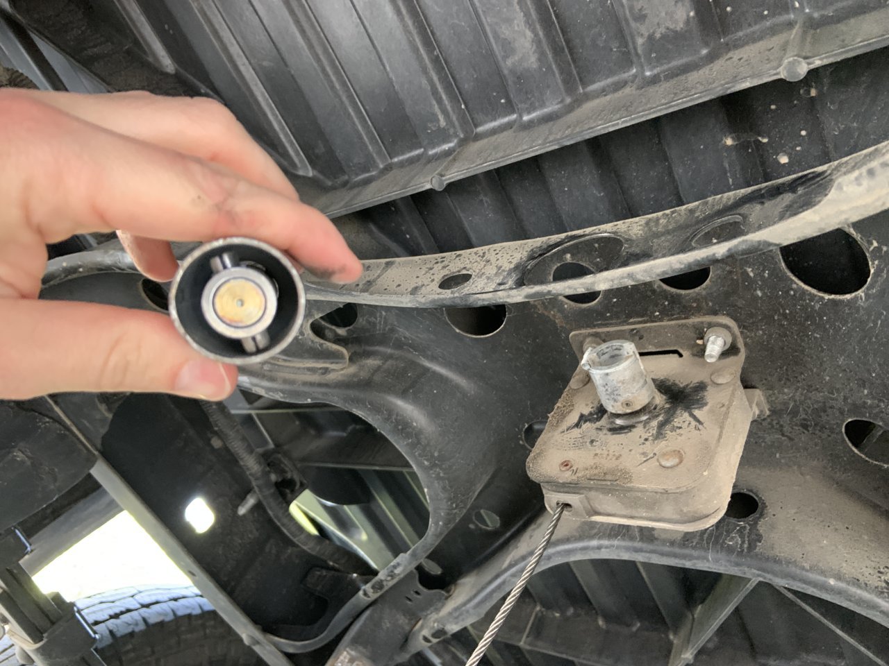

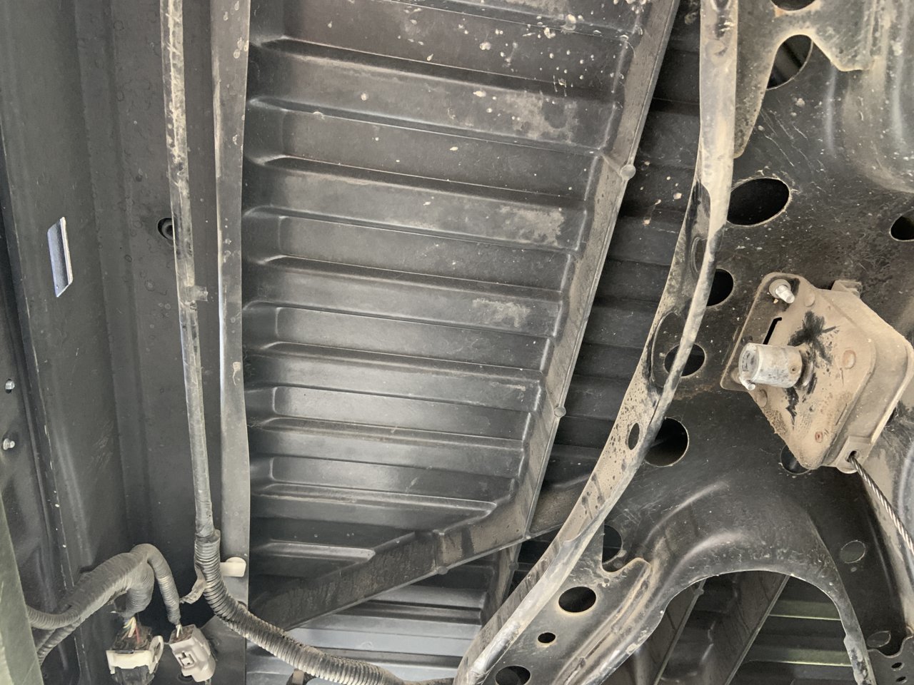

    Well I did the easier to change the spare upgrade when trying to put the key in. I will kind of make this into a write up to help anyone else out and be as detailed as possible.
    Context: Got a nail in the tire and used the experience to teach the GF how to change a tire. Little did I know that getting the key into the socket was harder than any other process I have done on a vehicle before. Another member posted this trick on there and I was impressed so did it myself.
    Step 1: Get your tools and lower the spare.
    Step 2: Take an 1.5" diameter PVC pipe and cut it 14 long"
    Step 3: Drill a hole large enough for a zip tie to fit through about 1.5" from the end on either end BUT NOT BOTH.
    Step 4: Put the pipe in the holes as shown with the zip tie hole side towards the rear bumper.
    Step 5: Zip tie the tube onto the metal frame hole as shown to prevent it from coming loose
    Step 6: Grind down part of the metal key as shown to make it fit down the tube.
    Disclaimers: I am not sure if you could get a slightly larger tube to fit and prevent grinding the metal down a little bit. I had it laying around the house so I didn't try anything larger.
    No metal was harmed during the making of this post

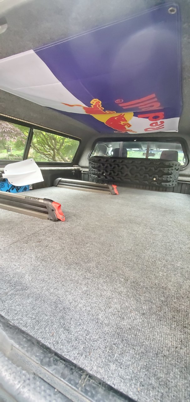

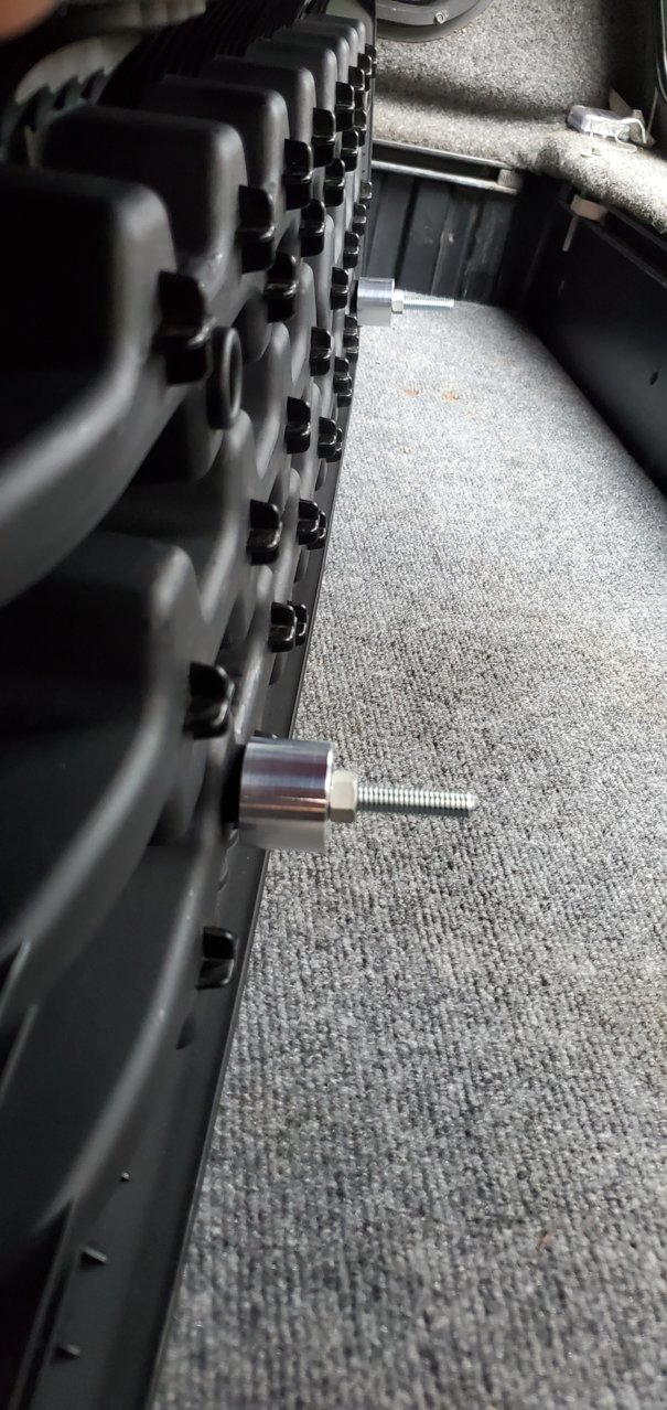

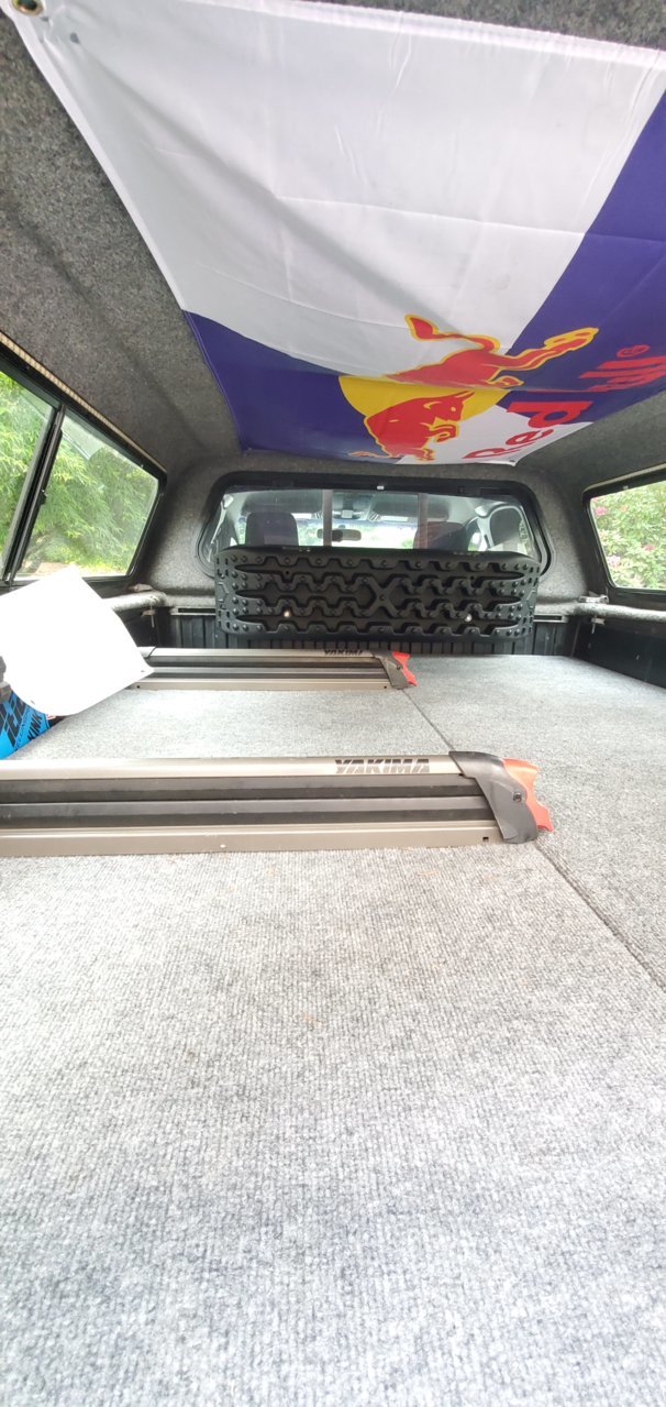

    Had my dad machine me out some more spacers so I could mount my traction boards up. Not sure how I like them in the back of the bed, it honestly doesn't block much view. I had them mounted on the opposite side of my shovel but they leaned up against the window so I moved them just incase the window would end up breaking. Now I have that side to mount a hi lift or something else.

    Kuddos to not completely annihilating the plastic around the button when you removed the blank :bowdown:

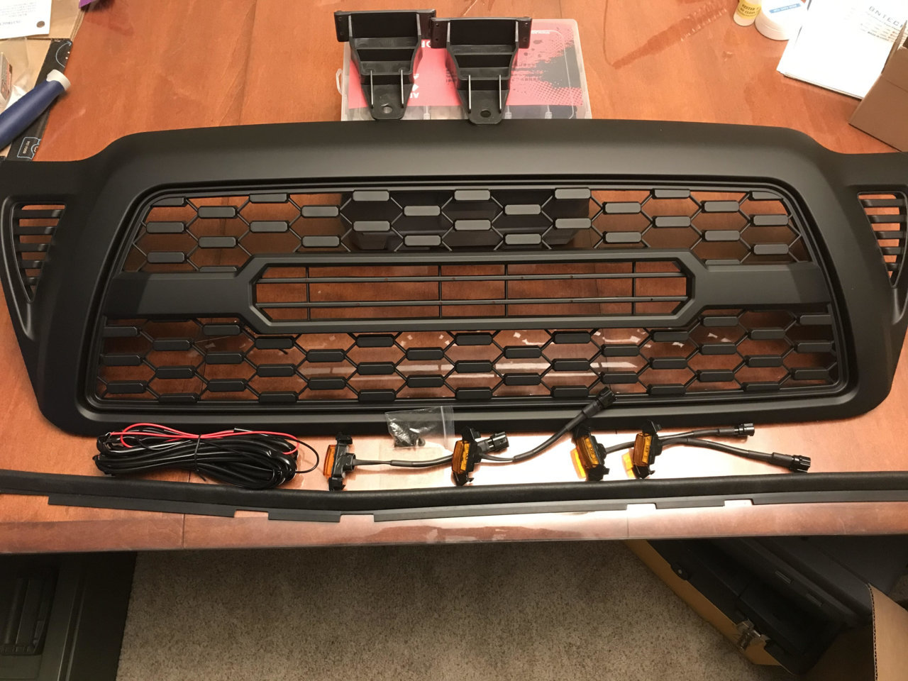

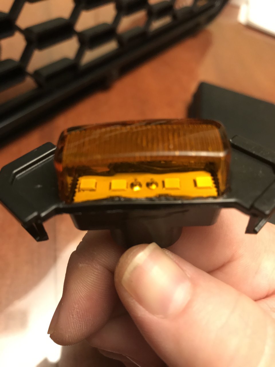

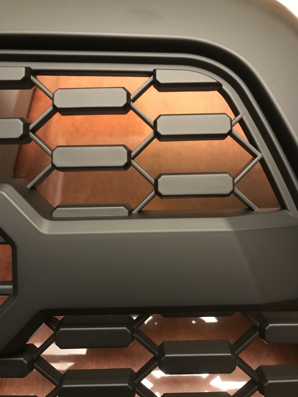

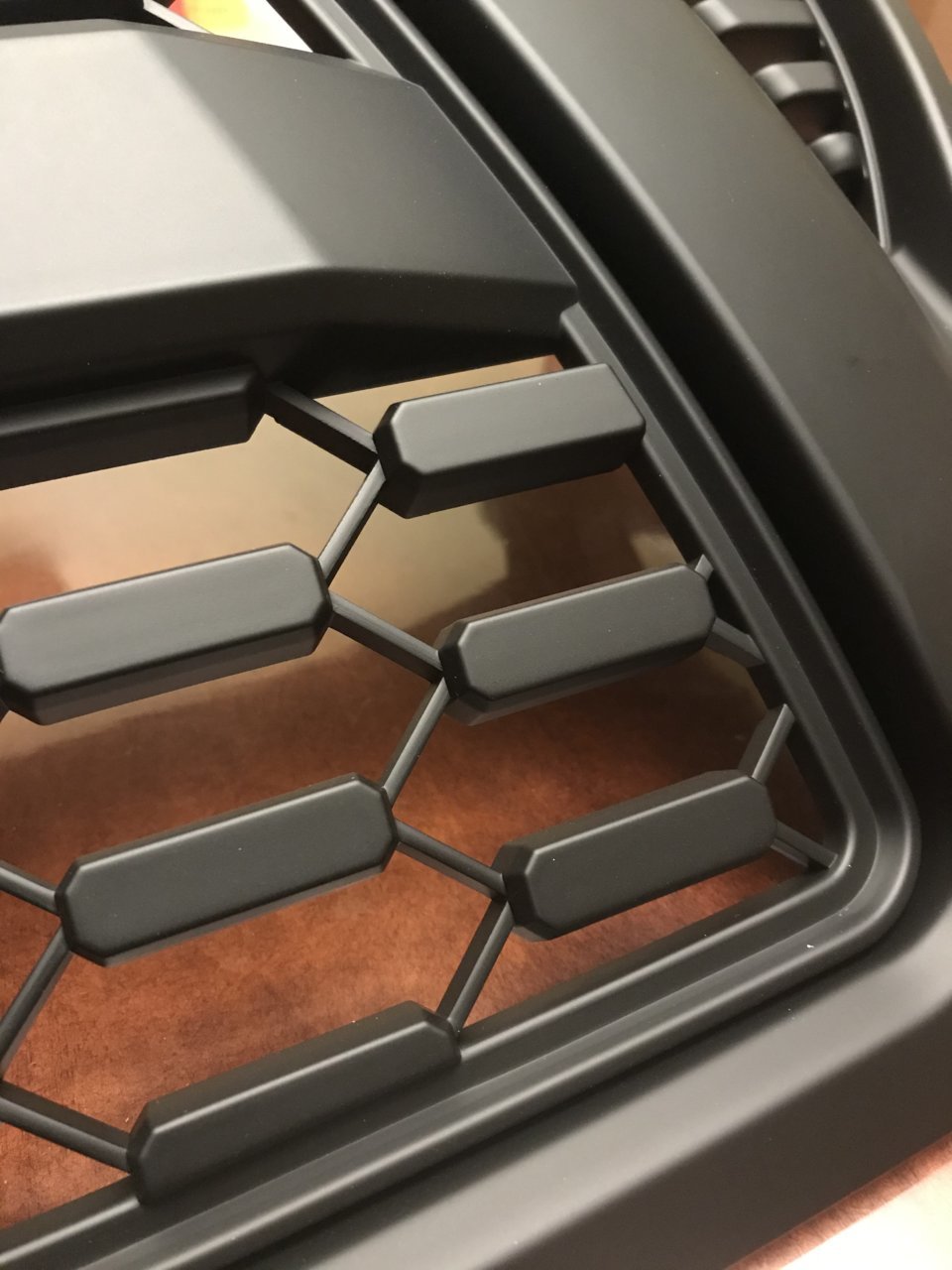

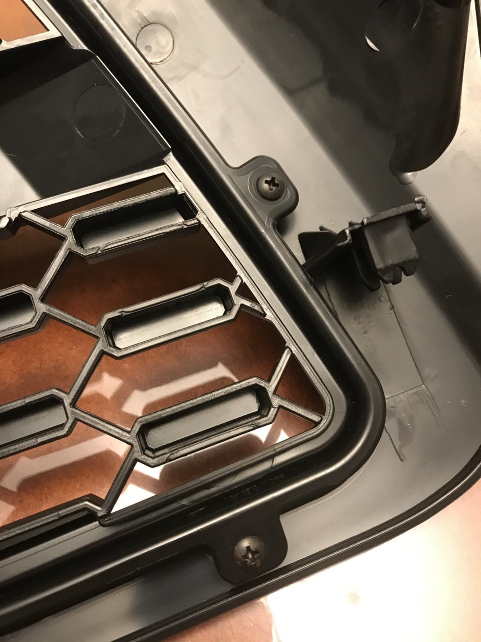

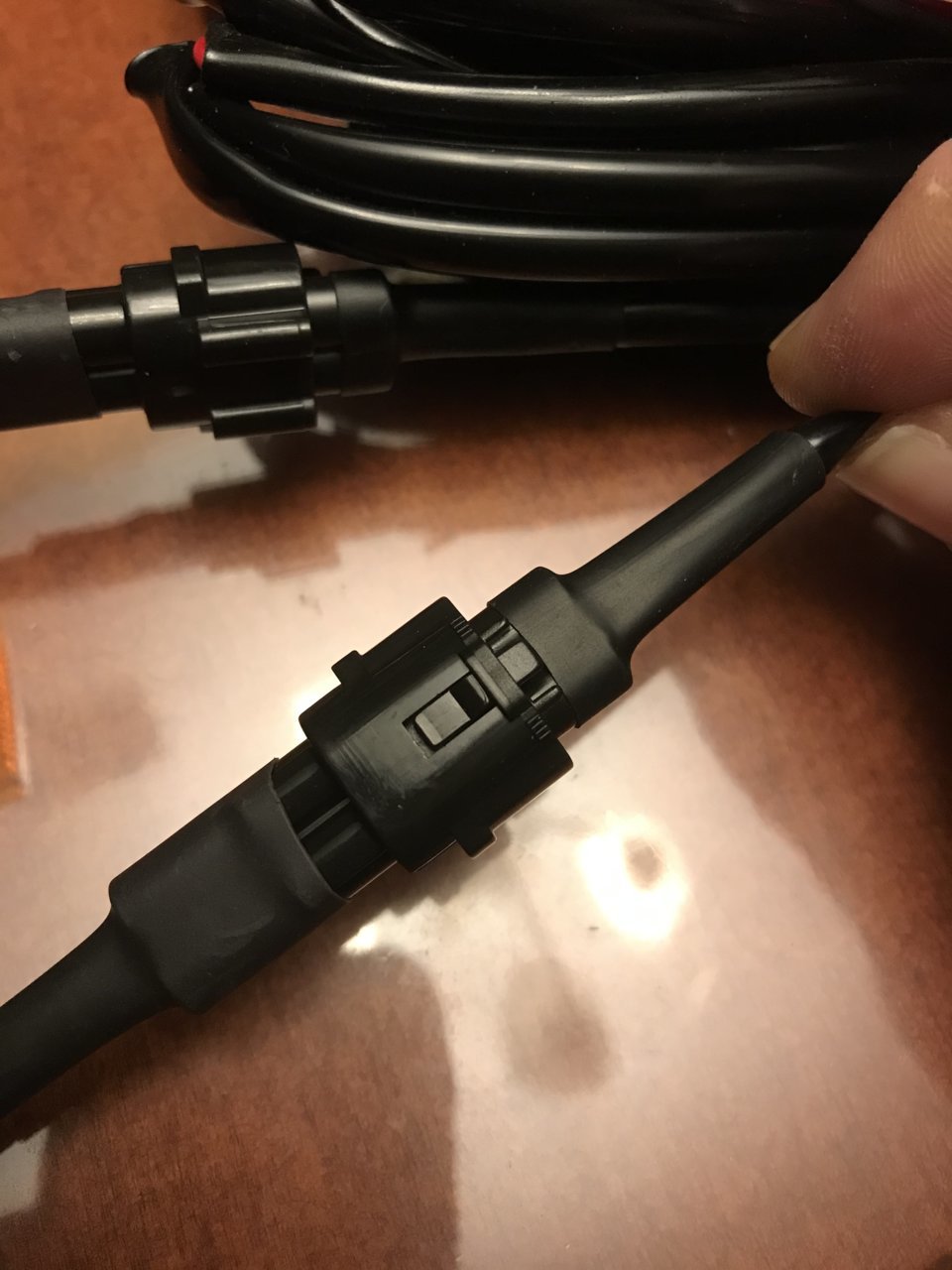

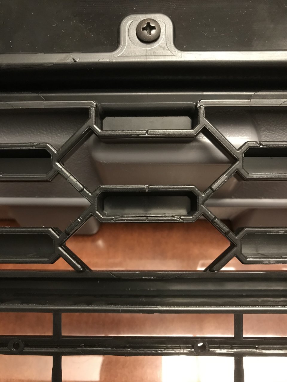

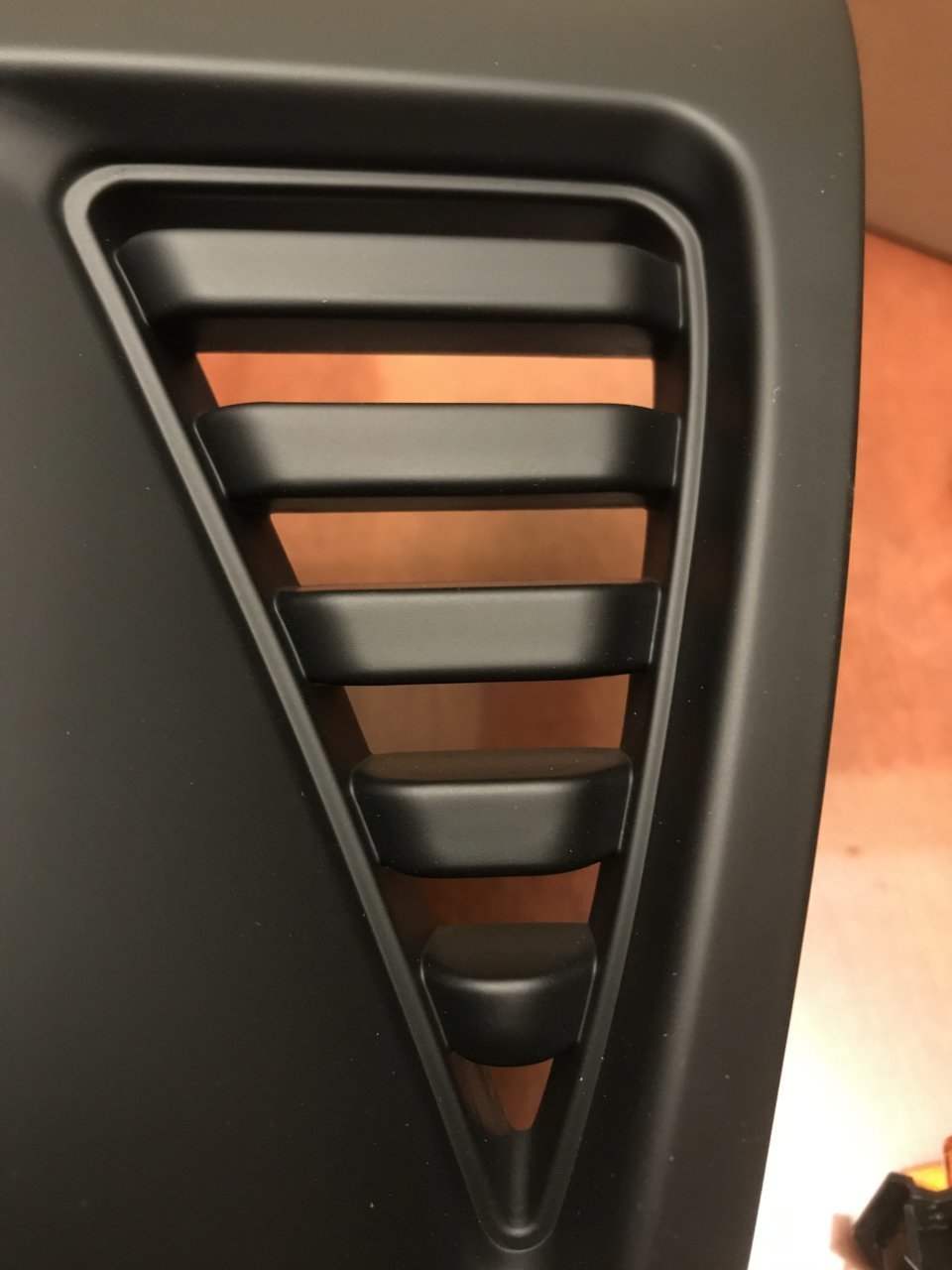

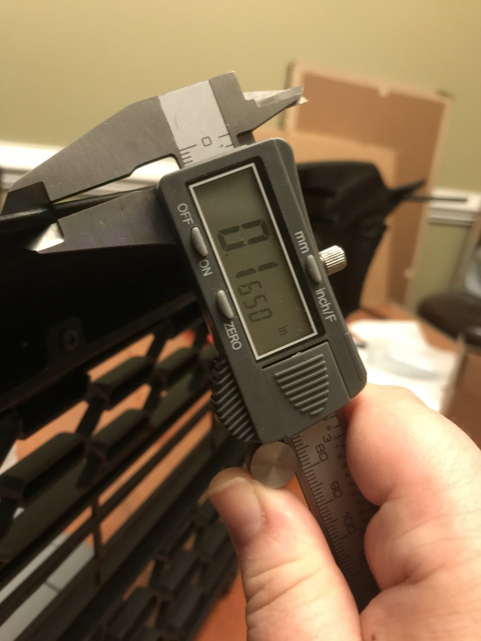

    To me, it doesn't seem flimsy at all. It says ABS but it feels like it's probably fiber-reinforced. The mounts feel like standard ABS. Overall Great quality control, I found very little flashing. Good customer service. They answered all my questions. They have a warehouse in New Jersey, so shipping of the grille only took about 1 week. They didn't have the TOYOTA letters in stock so they are shipping those from China.
    offroad part ABS plastic black refit grille offroad part for 2005-2011 toyo tacoma trd
    https://www.alibaba.com/product-det...detail-ta-bn-b.0.0.afc62fc2Ql16AO&bypass=true
    Company: Danyang City Danbei Town Huoqilin Auto Accessories Factory
    Here are some close ups to give you a better feel for the quality:

    I like this grill , especially the center piece I've seen others where they curve never liked that

    I have been looking for a new grille for a while. I'm glad I finally found something I like. Now let's hope I don't f* up the paint! lol

    Thanks man. Looks really clean, even on the back. Good find.

    I love that grille! And I want one! Any advice on the shipping cost? Seems a bit excessive...
