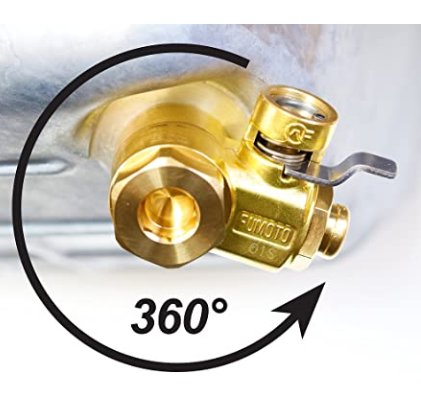

    This valve model is the F103S. It definitely looks like it’s hanging down far, especially compared to the stock drain plug. I’m not too worried about it right now because I’m in Germany and they don’t allow off-roading. The closest thing I can get is driving on forest roads to my hunting area. When I get back to the states I will have to re-evaluate.

    Quality front skid plate will solve that problem. Most are cut for oil change access anyway. I wouldn't go offroading with the exposed Fumoto valve.

    The SX is the 90° one isn't it? Spins 360?

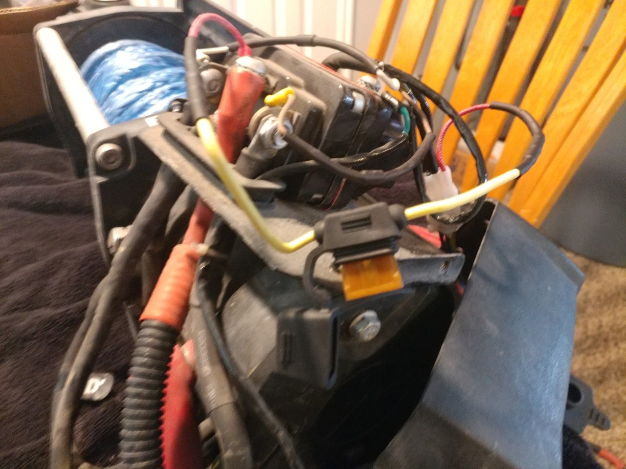

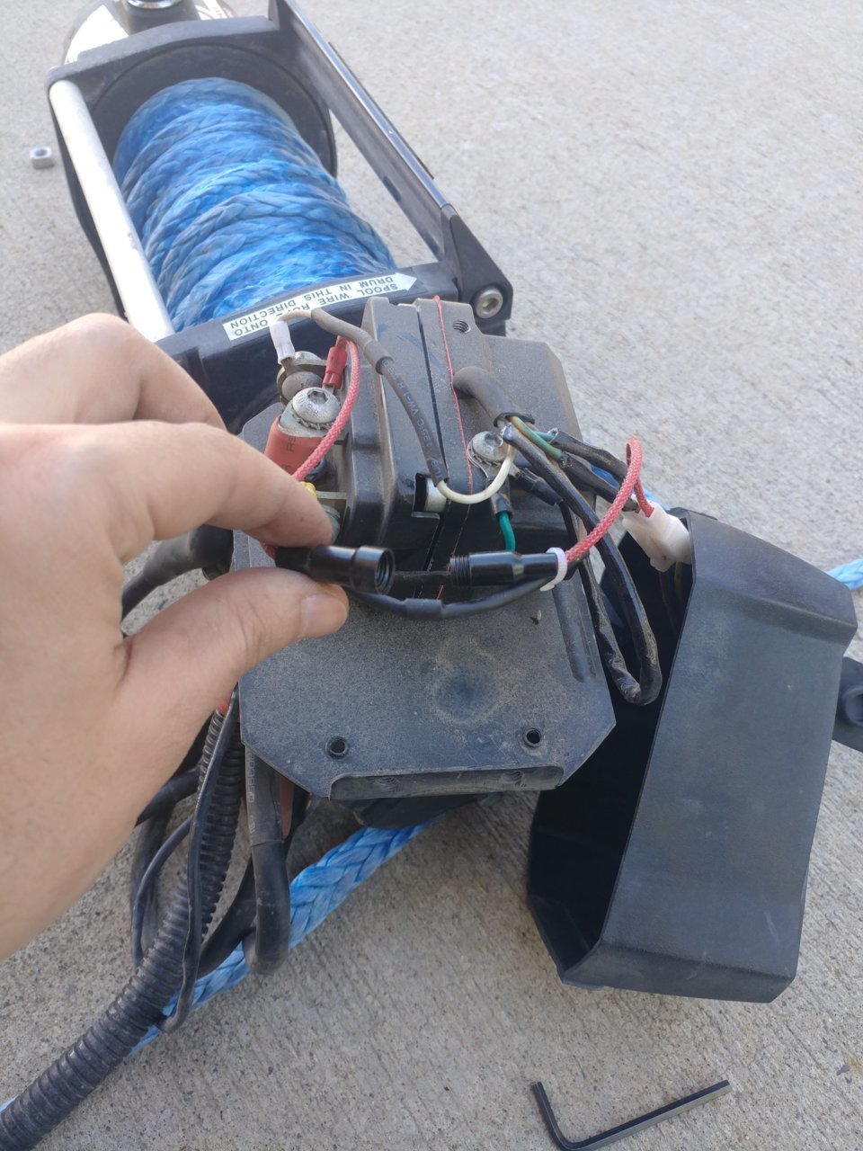

    Well blew a fuse on my smittybilt winch in the controller box. So had to remove the winch to be able to get to it. Then could not find a small enough fuse to fit in the housing. So cut it out and replaced with a proper easily replaceable fuse that matches the rest of the truck.

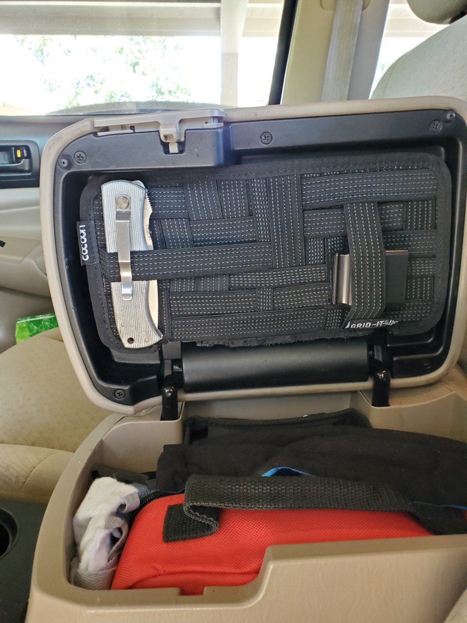

    Here's a link to a great writeup that was recently posted: https://www.tacomaworld.com/posts/23418707/
    You have to carve out or Dremel two cutouts for the hinges to clear. I also had to trim about a 1/4 off the bottom of the grid in order to get it to fit inside the armrest cover.
    I first sliced through and trimmed back the cloth seam along the bottom edge of the grid to expose the plastic "base." Be careful not to cut the stitching otherwise everything, including the elastic bands, gets unraveled. The cloth seam is some sort of rayon or other synthetic fiber that immediately starts fraying so i used a butane lighter to burn off and seal the edges. Be careful not to set the whole thing on fire or to burn the stitching that holds the elastic bands in place.
    Once I had the plastic "base" exposed, I used a steel cutting bit shaped like a Christmas tree to remove small sections until I got it to fit and the cover to close. One final once-over with the butane lighter to seal the edges and i was ready to Velcro it into place.
    Take the time to remove the inside section of the armrest cover (only 5 screws) since that will make it much easier to work on.
    My armrest (2007 taco) flips up and then stays up while I dig through whatever I'm looking for. The Grid adds some weight to the armrest and if you try to add too much other stuff to it, it will become too heavy to stay open when you flip it open. That's my only gripe so far.
    Take your time and I doubt you'll have any problems.

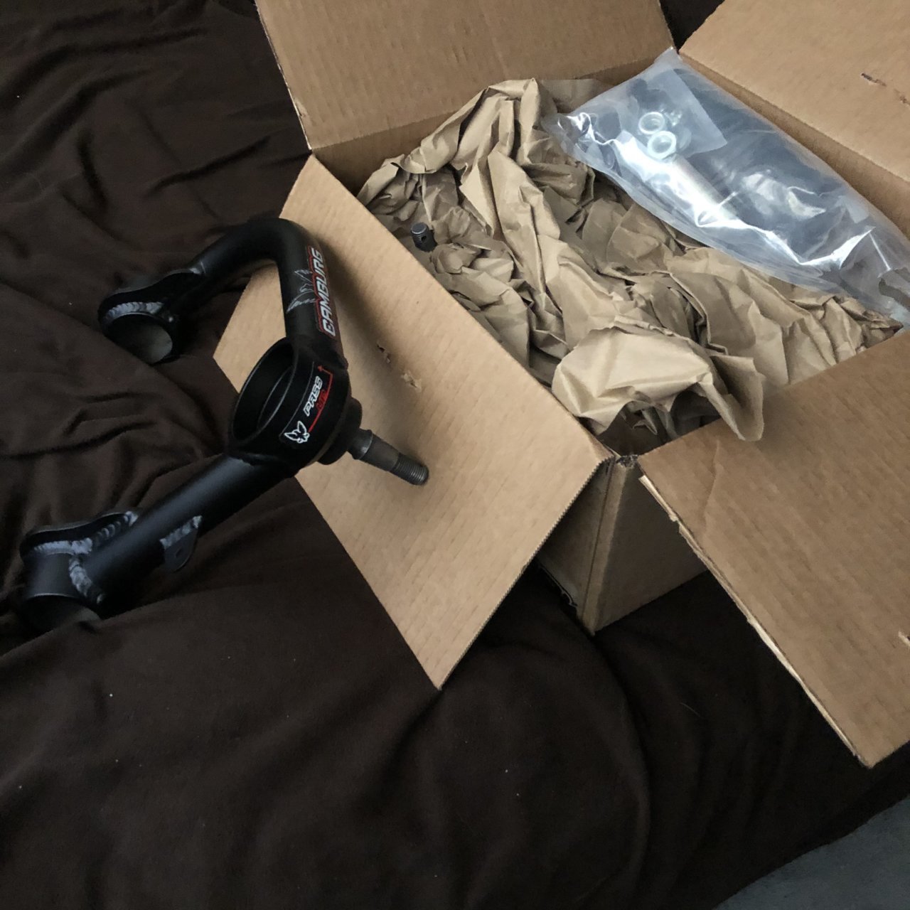

    Just picked up new upper control arms Probably an install next week :)
