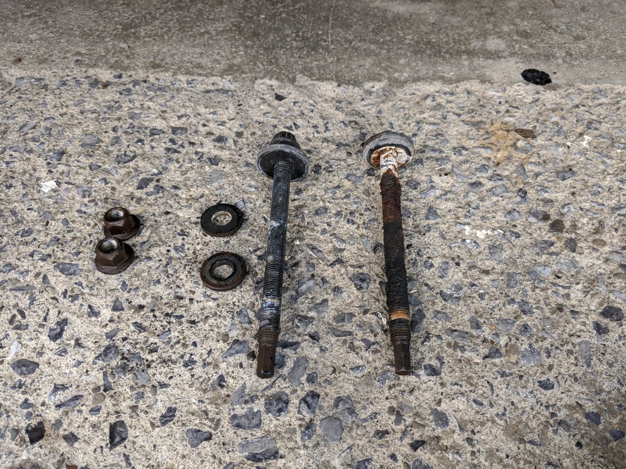

    Too many to list.
    Prepping for radiator mount bushing. My guess is the one of these bushings is bad. Can you tell which?

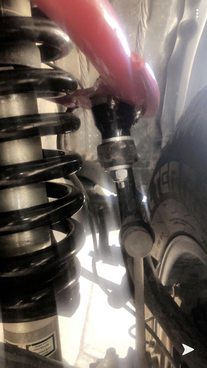

    Installed my JBA uppers yesterday along with some OME 886 coils and i think i screwed up. Every video i’ve watched and write up i've read about installing the ucas shows only a washer between the ball joint and the knuckle. I have one there but mine came with 2 so i figured it went between the nut and the knuckle but every video says otherwise. Anyone with JBA’s that can clarify?

    I would say no, since you don't appear to have full thread engagement with the extra washer. I have the JBA arms also and only have the one washer.

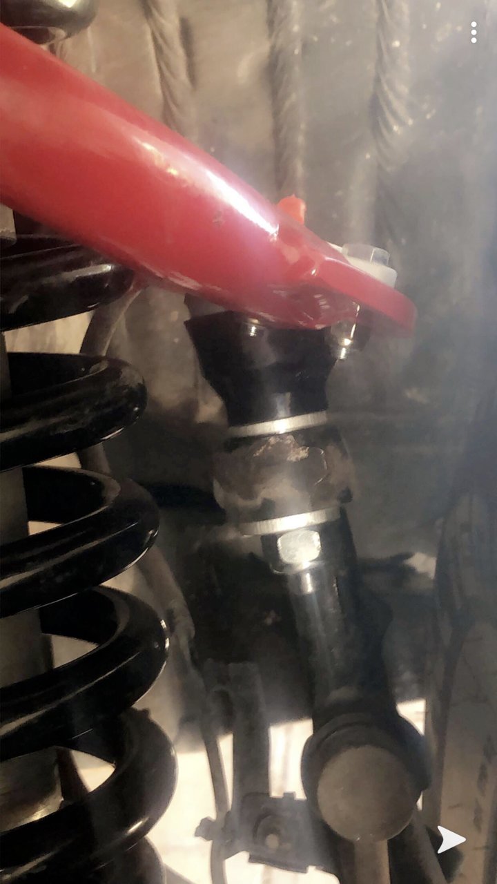

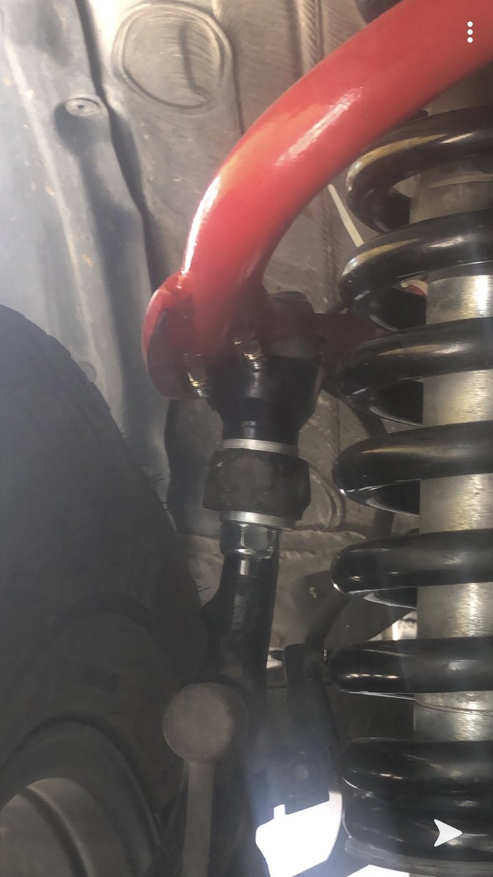

    2007 4x4 Double Cab
    I thought so, so where does the other washer go? Also the passenger side upper ball joint seems to have more of an angle than driver side, should i worry about that? 1st pic is passenger side and 2nd is driver side.709707EB-EDC3-4811-9D8E-87C10EEB74D6.jpg9FE210D1-4D60-4605-9B23-D79CAAFC7264.jpg
