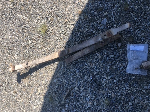

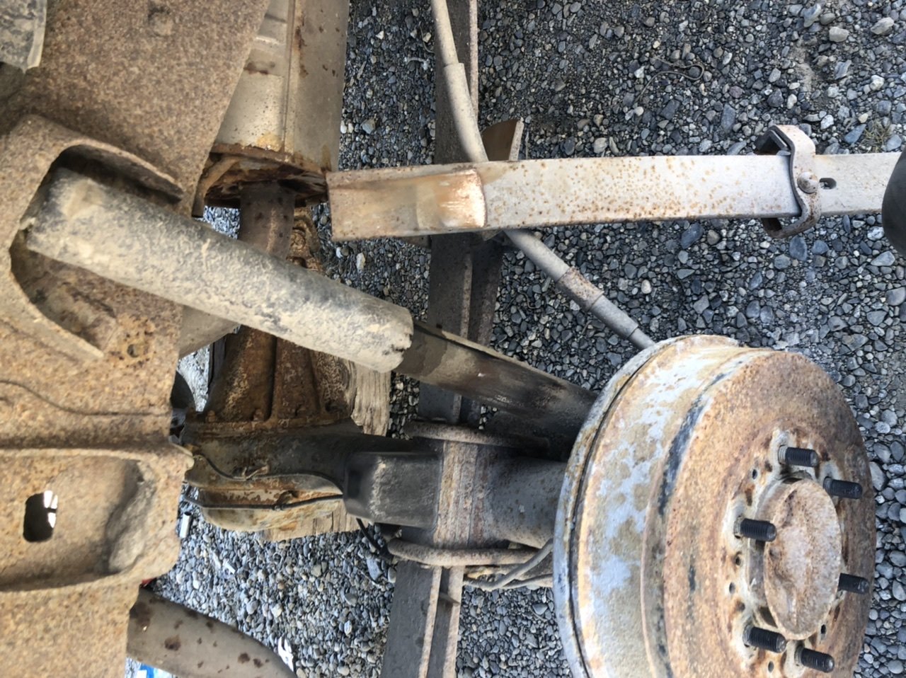

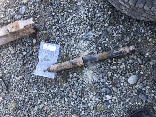

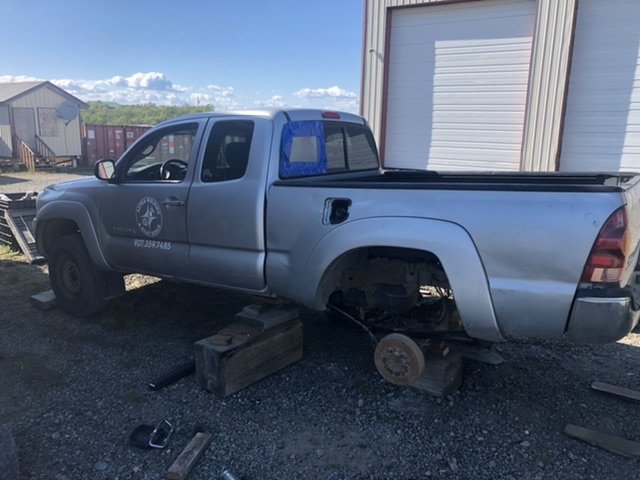

    So here's pictures from the other days rear suspension change. Mind you this is my beater work truck up in alaska that i drive maybe a month a year (also just got it last year for $3000 bucks with 70k miles on it). But i didn't even bother taking most the bolts out i just cut them all out and then the driverside leaf. The driverside shock was just chillin in there with no top bushing or washer and the passenger side leaf was broken into three pieces, also that shock was completely blown. Swapped in some oe leafs with new shackles and then used my old ome nitrochargers that came off my truck from home when i went LT. so for like $600 bucks i took what was a truck that was falling apart and made it pretty decent again! Now i just need to get the front swapped sometime this week!

    oh and before anyone says, the blocks where way less sketchy then they look, We put 30k lb boats on them and on this gravel where more stable than any jack stand would be.

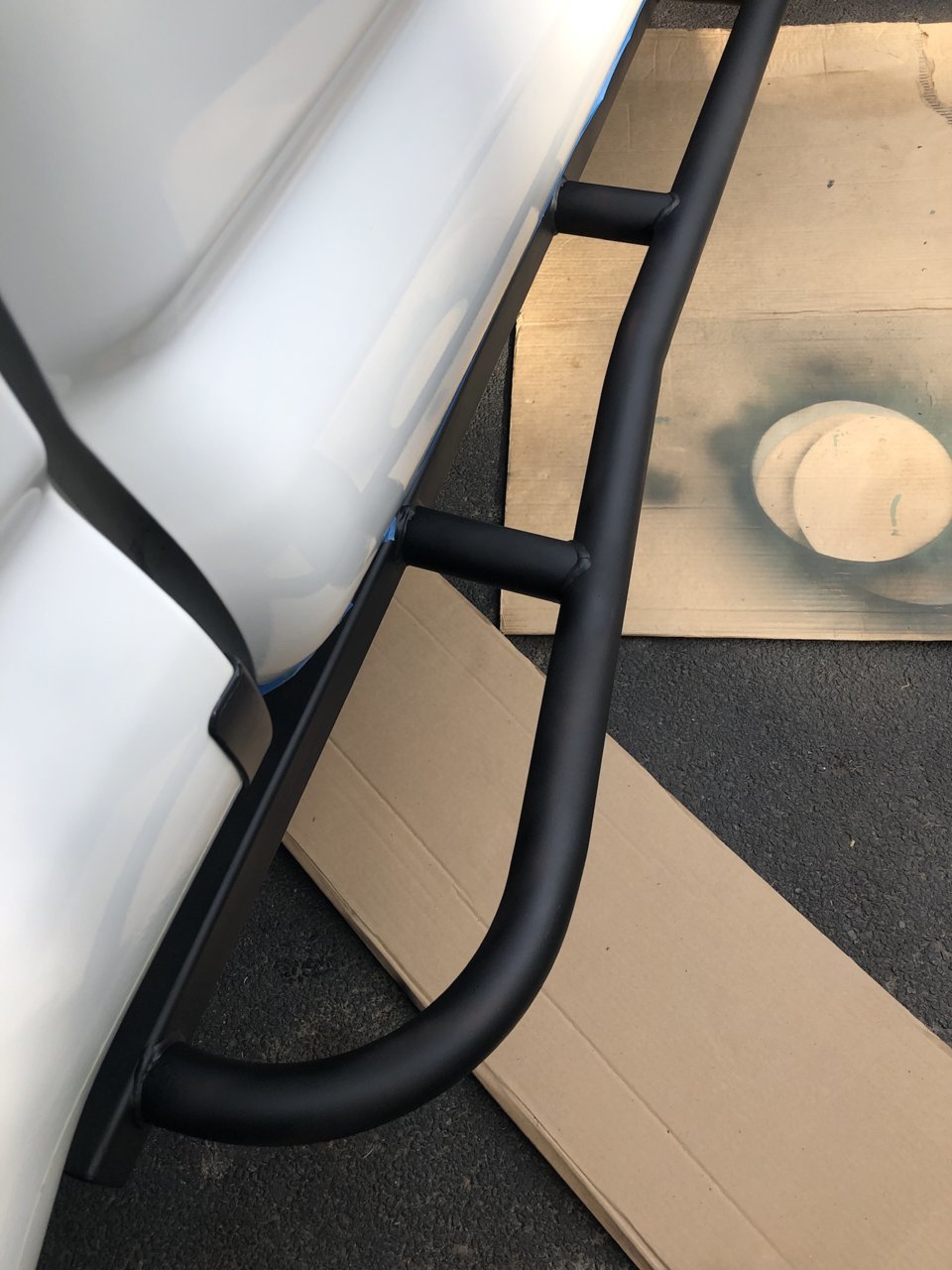

    Cleaned up sliders and primed and bed lined
