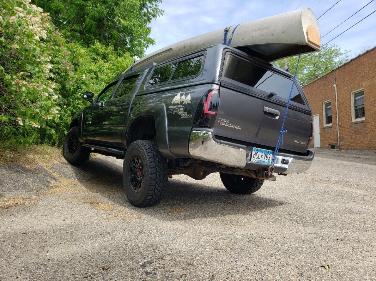

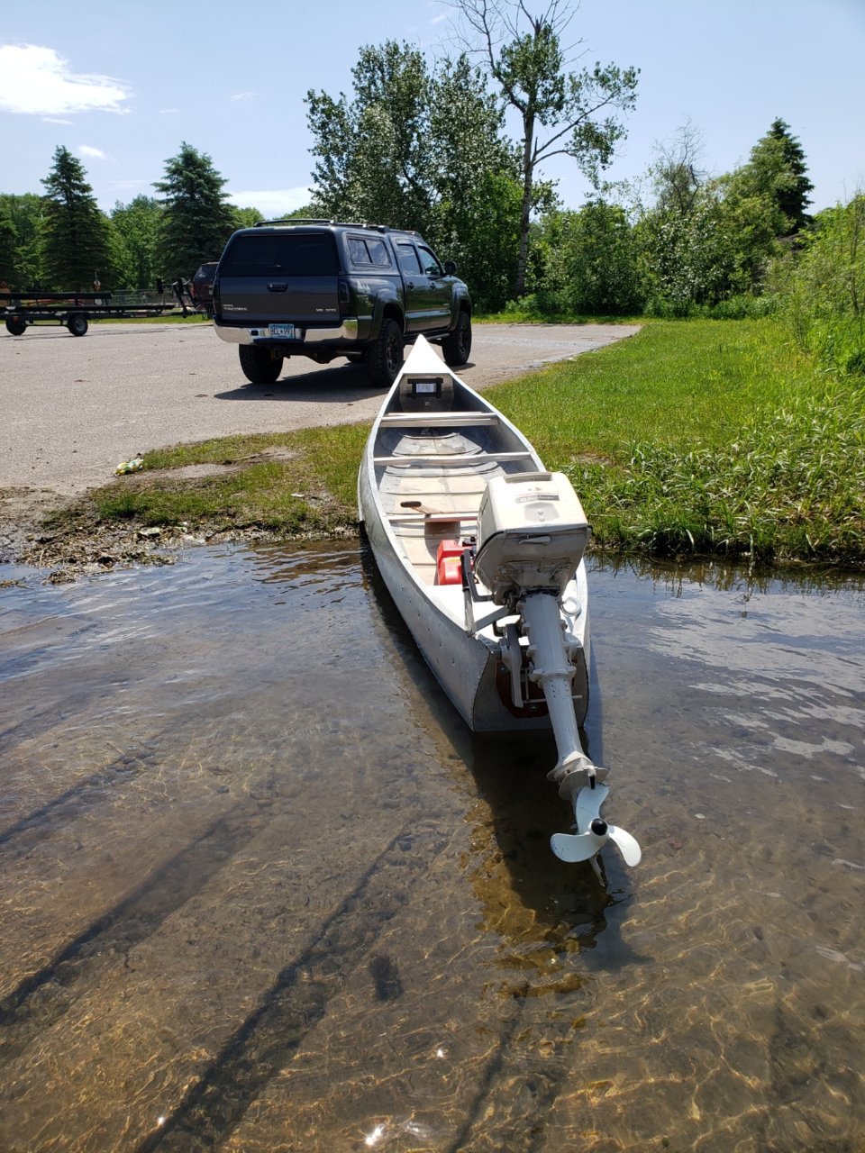

    just make sure the canoe can handle it. Mine will take a 5ph max and it does sink the rear end a little with the motor, gas and me in it now. no weight in the front would be a lot of fun to open it up.:bikewhoops:

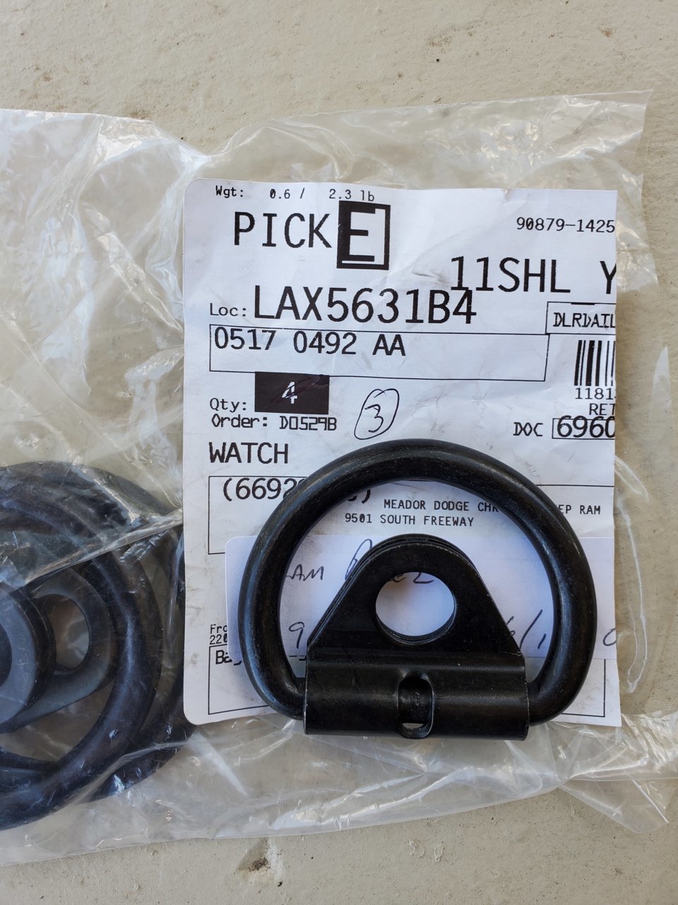

    I installed these designed for a Dodge van: https://www.meadorpartsonline.com/oem-parts/mopar-ring-retainer-ring-5170492aa
    They're extra heavy duty and don't flop around and rattle like some of the cheaper ones.
    I ended up using my Dremel to cut a "D" shaped piece off the washer and mounted the rings under the washer. I never thought of grinding the threads but I guess either method will work.

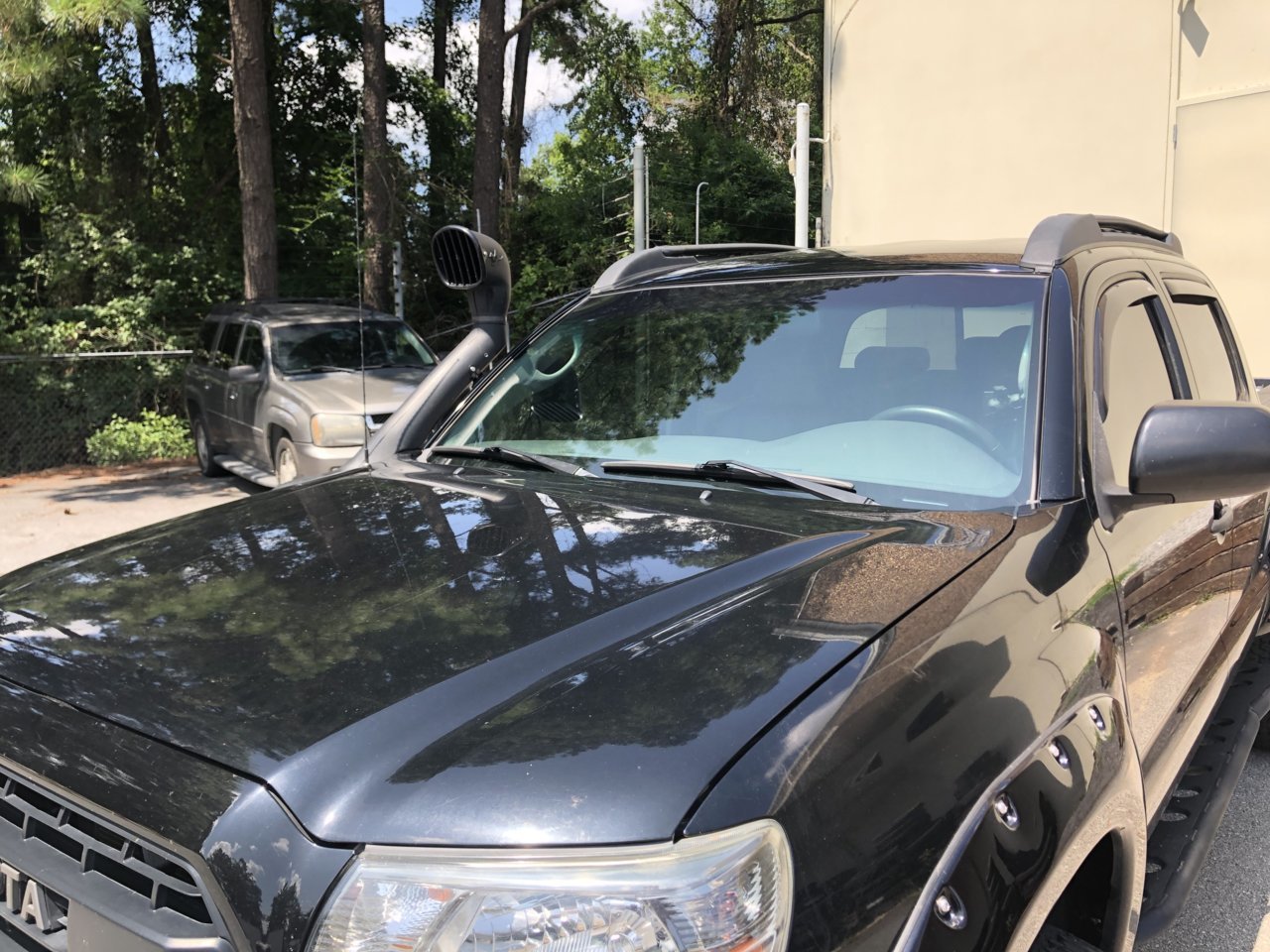

    New windshield, had to take my ditch lights off and it looks naked without them

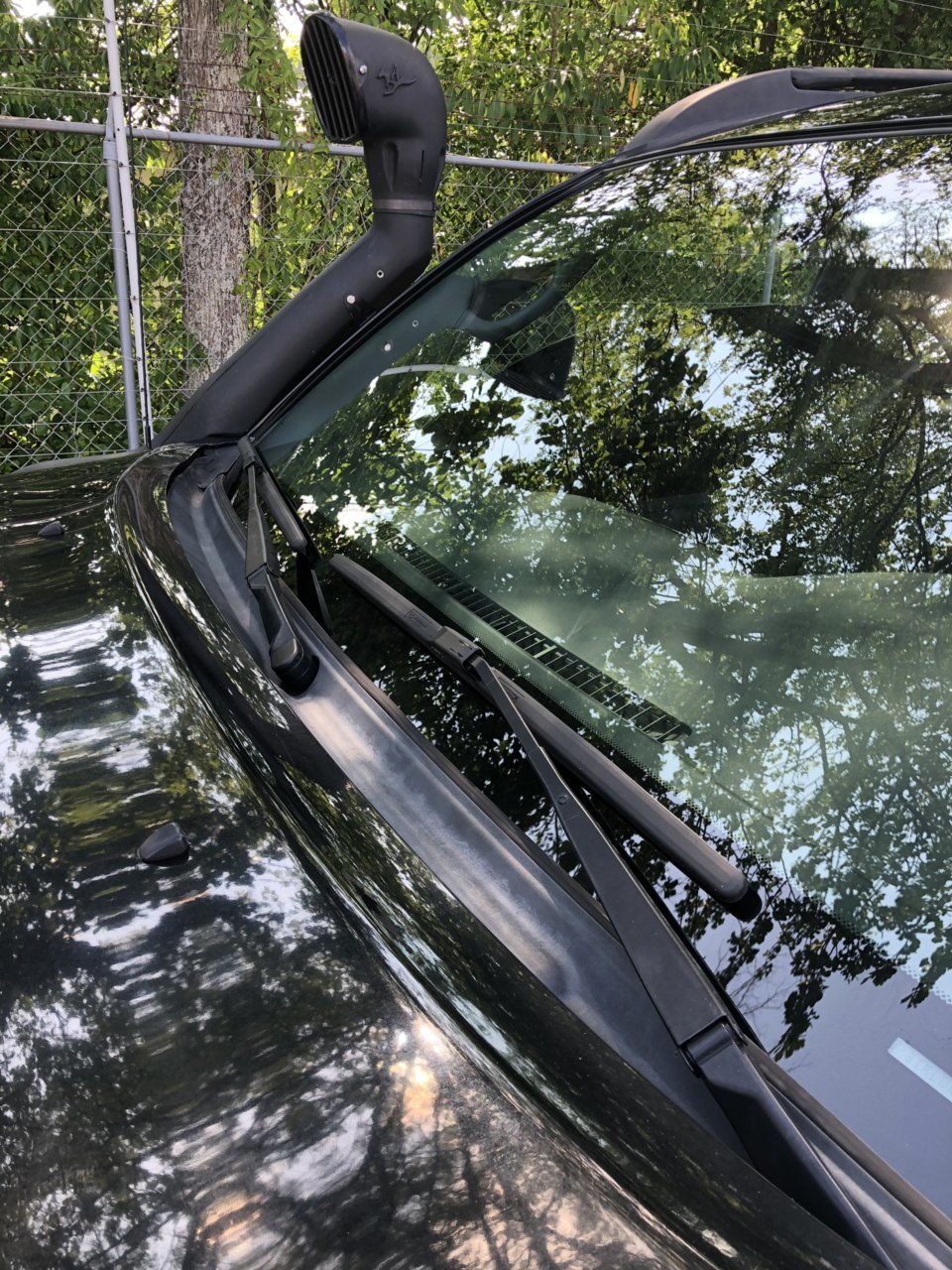

    Yea the dude was worried about the snorkel too, asking if I could easily take it off...I told him that wasn't gonna happen. Luckily I can pull off my lights and brackets in like 10 minutes.
    Ended up still needed to get a second truck to the mobile install and place it by hand because the swing arm thing they use comes over the passenger side (snorkel...)

    Oh yea, and just put new wipers on to compliment the new glass :thumbsup:

    OK. Just finished installing 4 bed D-rings (see link below), AKA the "Dodge Mod."
    Here's a breakdown of getting the washer off the bolt:
    1. You can use a Dremel with a cutting wheel to cut a slice of the washer so the d-ring fits underneath. Takes about 5 min per bolt. I did one of the bolts like this and didn't like it so I ended up filing down the retaining threads so I could i could mount the d-ring on top of the washer instead of underneath it. OR....
    2. Use a Dremel with a grinding tip. Time: about 1 min per bolt and you'll probably need more than one Dremel tip. OR...
    3. Use a bench-mounted grinding wheel. Time: less than 30 seconds per bolt - by far the easiest method! OR...
    4. Put the bolt in a vise and use a hand file. Time: about 5 minutes per bolt.
    BTW, the D-rings in the link below already have a 1/2" hole so there's no drilling. Believe me, these rings are better than any thing you'll find on Amazon.
    Hope this helps!
