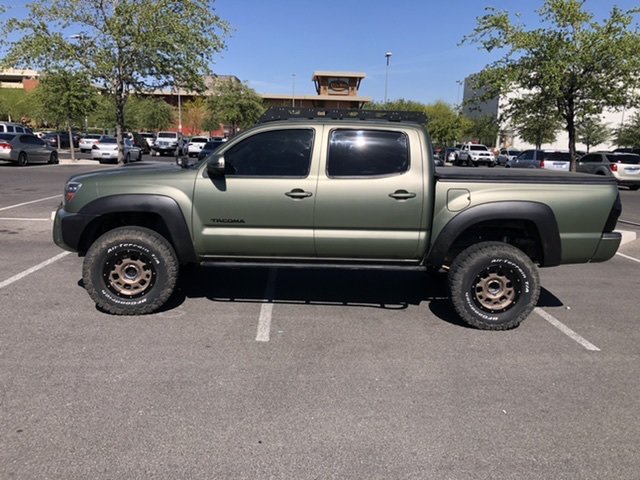

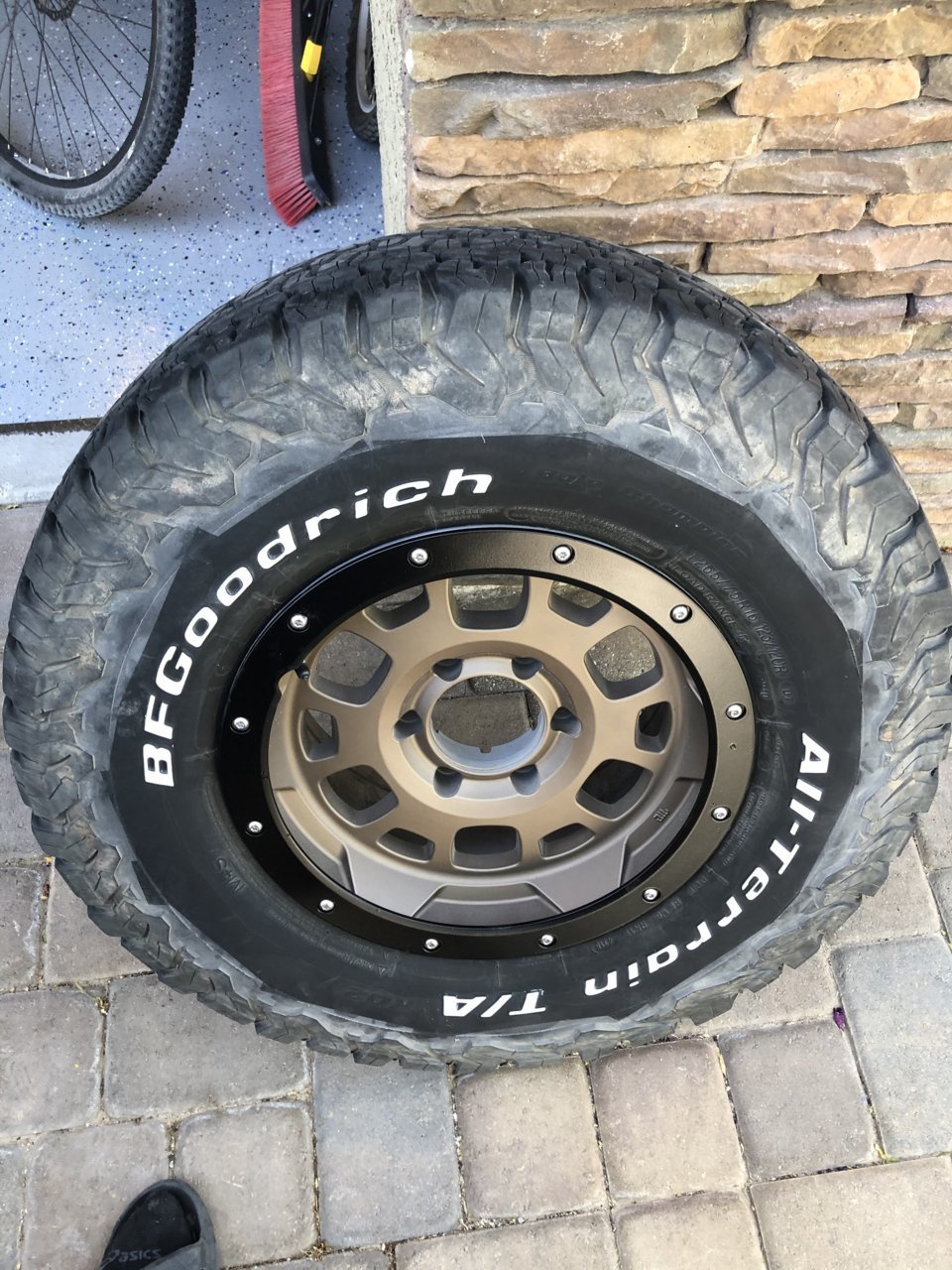

    Changed oil, painted wheels and fake bead lock rings. Installed wheelers off-road super bumps up front. Wrapped center caps (not pictured) awaiting custom cut TRD logos for them.

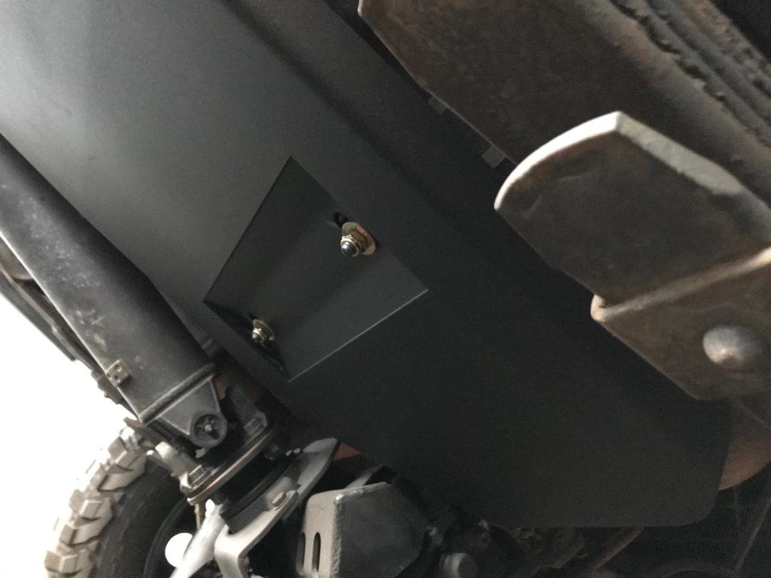

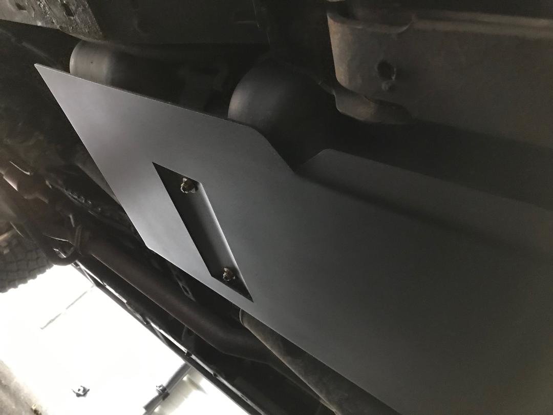

    feels good to have a little more between my gas tank and what ever then the OEM tin....RCI skid plate...

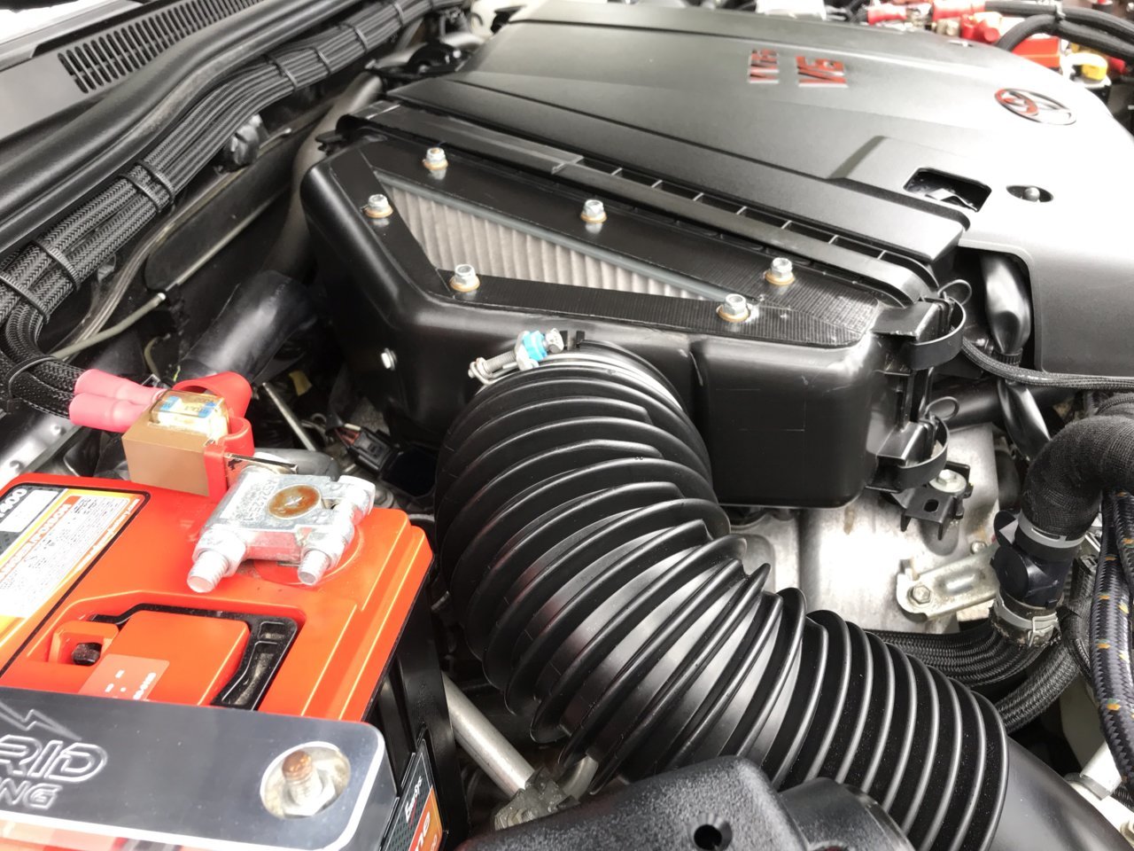

    Who makes this?

    I did,its very simple, dont have any write up etc....there'sa much nicer one posted a long time back, gentleman has much more of a shop then I do...
    just cut out ur window with a jig saw,
    I used 1/8" plexi for the window, sealed with forma gasket
    couple of bolts to hold it all together
