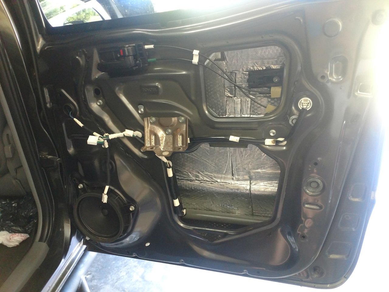

    Just finished DIY ditch light brackets lol does the job!

    I used NOICO RED 150 mil to cover the outer part of the skin. eBay $29 for 18 square feet
    I used NOICO 80 mil (silver stuff) on all the interior of the skin. Amazon $32.99 for 18 square feet
    For sound deadening you don't need 100% coverage but I wanted it because I wanted to insulate the truck from the hot coastal sun.

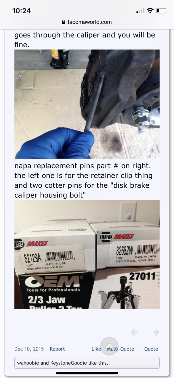

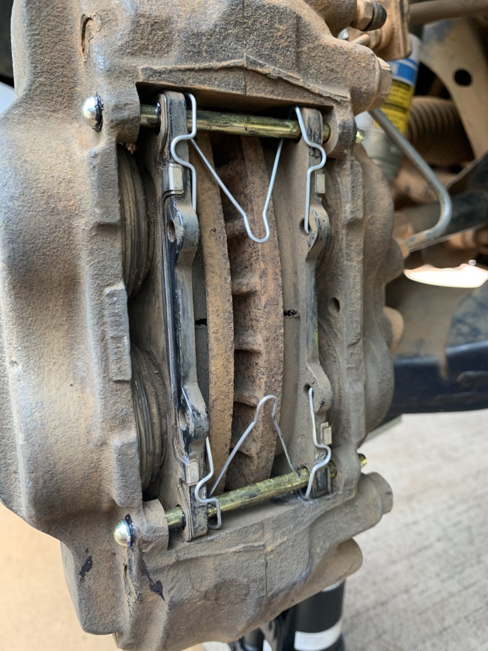

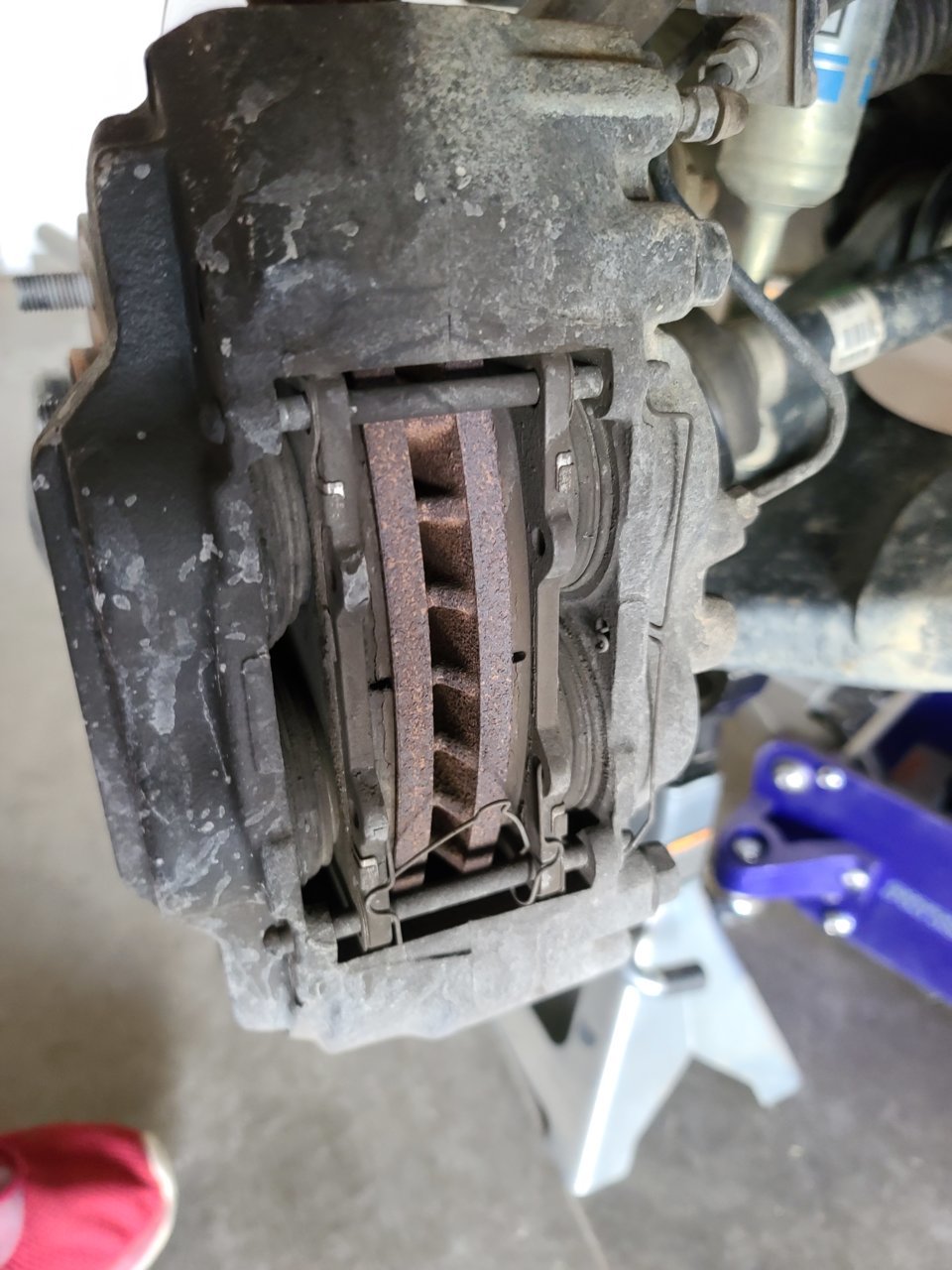

    Is that the loud clack noise that I hear when I pull up to my parking spot, put it in reverse, and hear one or two clack sounds from the front? I figured it was brakes, but not something easy to remedy.
  5. Jun 24, 2020 at 3:18 AM
    Island Cruiser
    Island Cruiser TVita
    May 20, 2012
    #79166
    3,937
    Kauai
    Baja
    That’s exactly it. You can replicate that sound just by fiddling with the brake pad. It’s crazy how loud it is just by doing that

    Well hell! Thanks for helping me solve a large annoyance that has been with me forever. I will look for those clips next time I’m at Napa.

    Dude I know how you feel. It was hella embarrassing when reversing into spots. I’ll try to see if I have the part number or a pic of it at least

    Here’s a couple screenshots. Sorry for the lack of credit to that member lol

    You’re a gentleman and a scholar! Thank you so much!

    Oh ok - I thought you would have done that when you replaced the calipers so didn't think to suggest it. That's the simplest fix! For reference the brakes on my truck are strong but grabby - they bite hard right at the beginning of the pedal travel.
