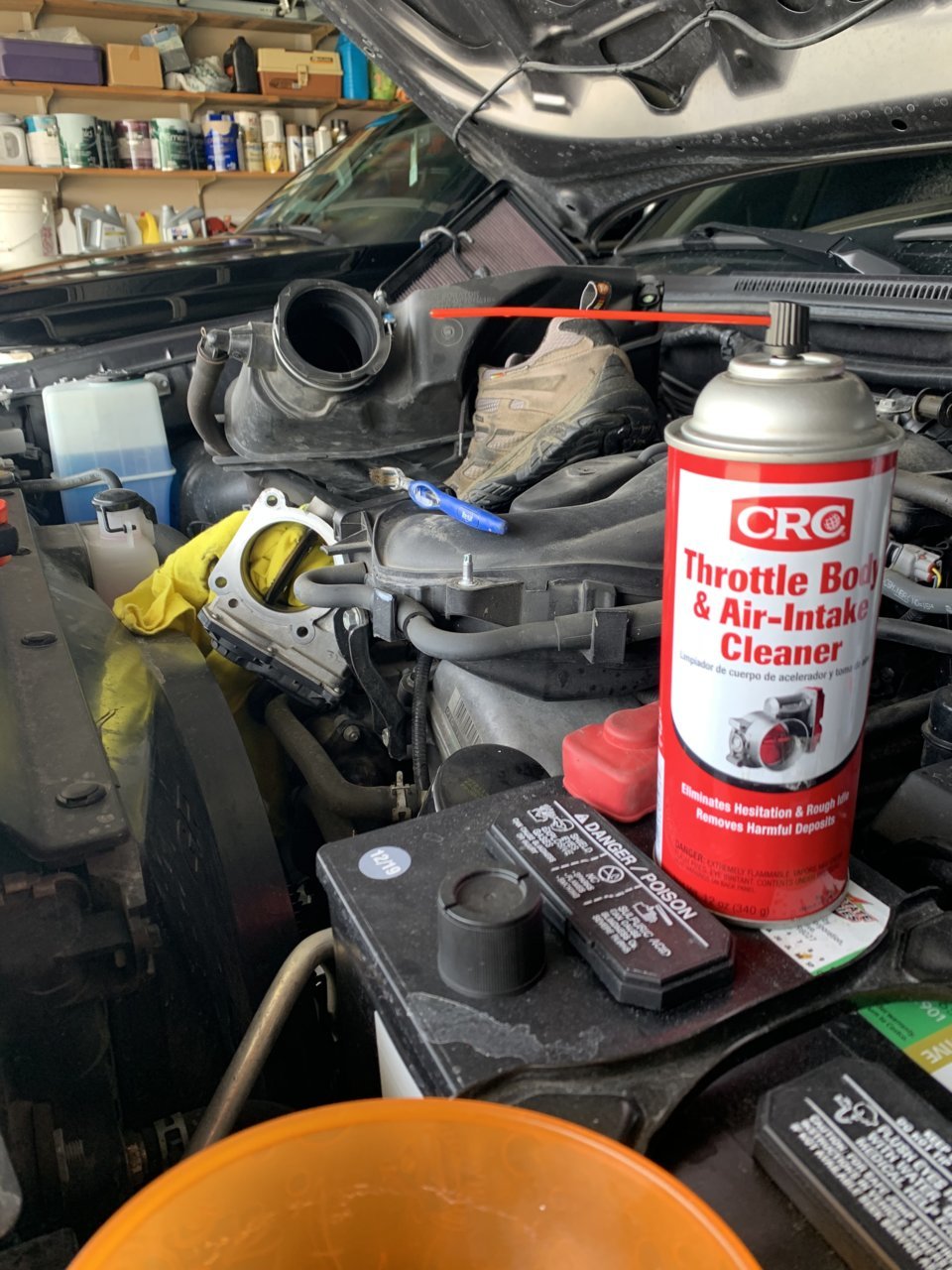

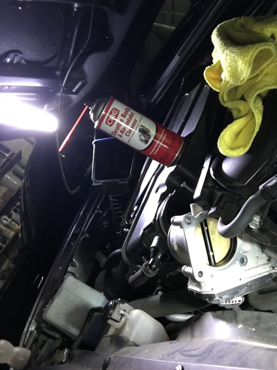

    I do not know the hot wire from the trac relay is for. That one is a first for me. But I do know about cleaning the MAF and throttle body. I clean mine every 15k miles. Here is a picture and its 10mm all the way through if I remember correctly. Other than the 2 clips that hold the air box shut. You just take it apart and put it back together. One product is in the picture, the other is in the link. I prefer the shoe wedge and old tooth brush method. I also bungee the air filter to keep it out of the way. I stuff a rag in the back side to keep the throttle body open and to catch over spray. This stuff is highly corrosive and you do not want to get it everywhere. And wear gloves if you live in California, LoL seriously though wear gloves if you have them.
    https://www.amazon.com/CRC-05610-Ma...ocphy=9016065&hvtargid=pla-568759644630&psc=1

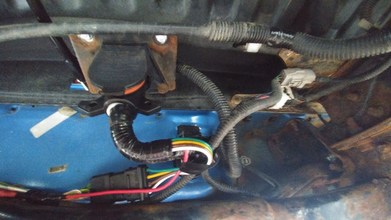

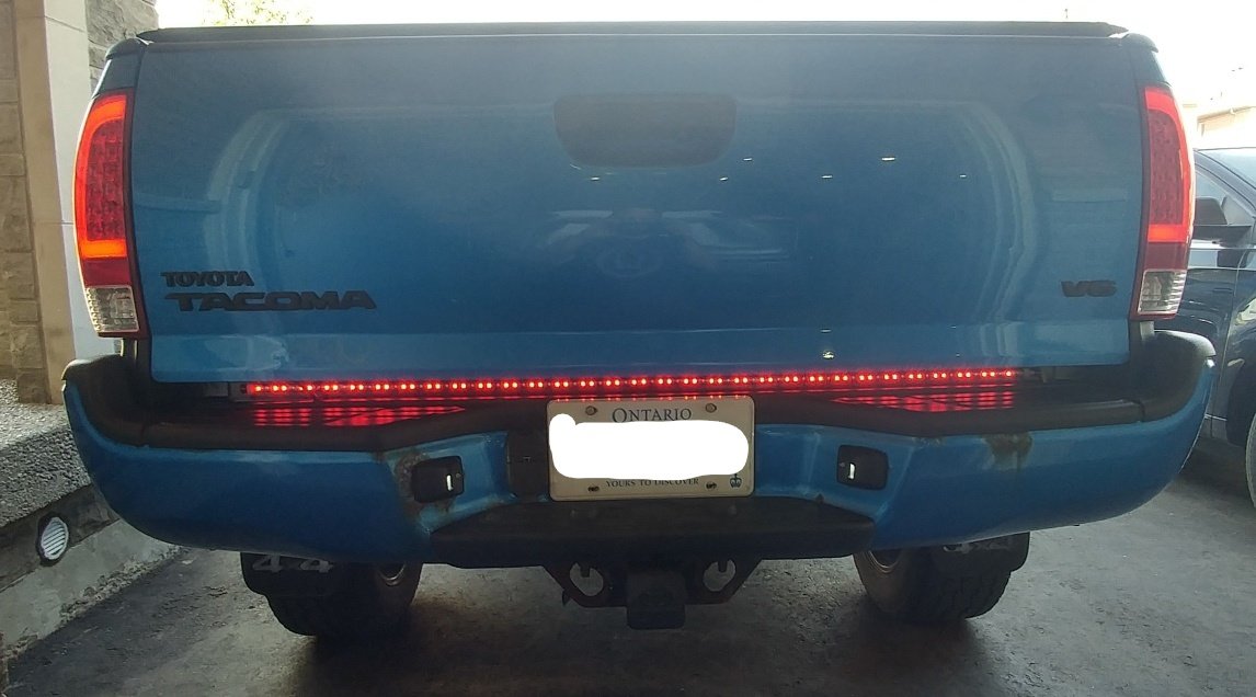

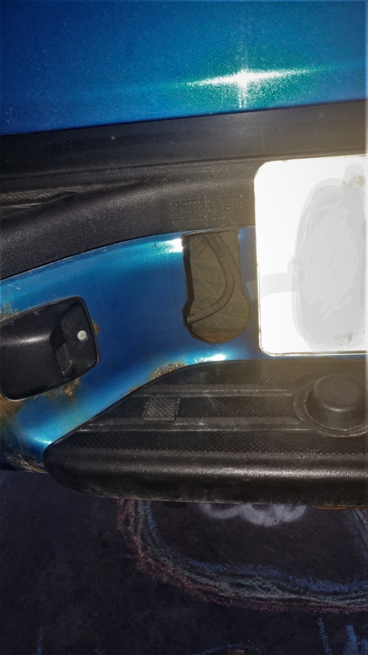

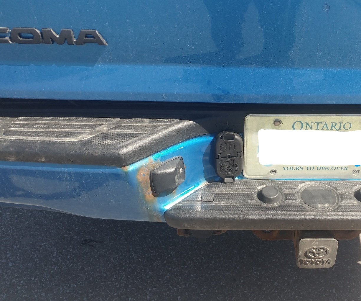

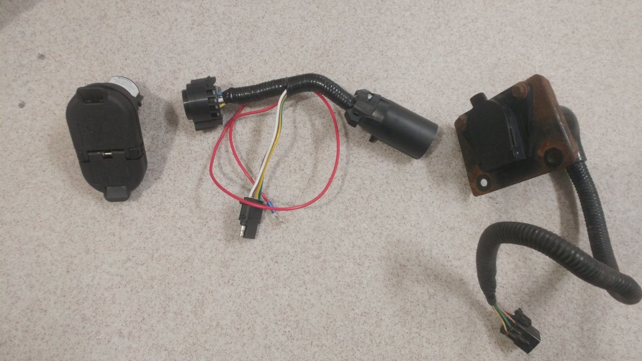

    I upgraded to the new style 7:4 pin and move it up in to the bumper.
    Relocated the factory 7 pin plug up under the bed and connected the two plugs with a custom jumper which included a connection for a led tailgate bar.

    what did you do to secure the OEM 7 pin and bracket under the bed like that? also the adapter harness plugs into the OEM 7 plug and then into the new 7/4?

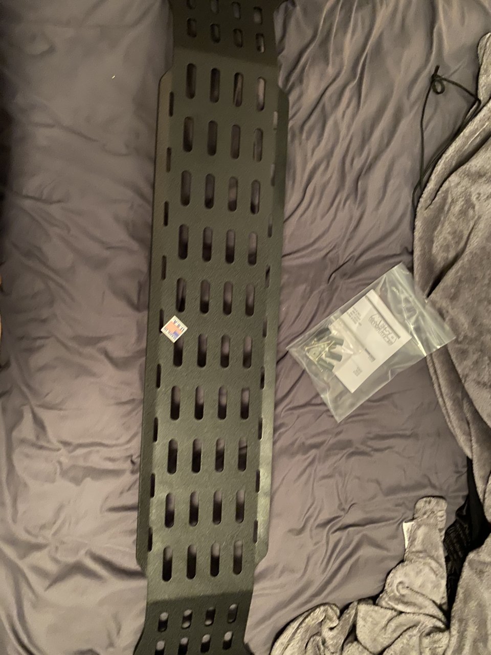

    Just a grocery getter
    Has to be installed but I want to put the bags on it first but my @MESO designs molle rack finally came

    I used self tapping screws to attach the OEM 7 pin to a cross member. Yes, it plugs into each. Everything is reversible this way ... well except for the hole in the bumper ... lol... I didn't want to cut up the $400 factory wiring harness, and I didn't want the LED bar plug to be visible. If any issues arise I can revert back to the OEM 7 pin.
