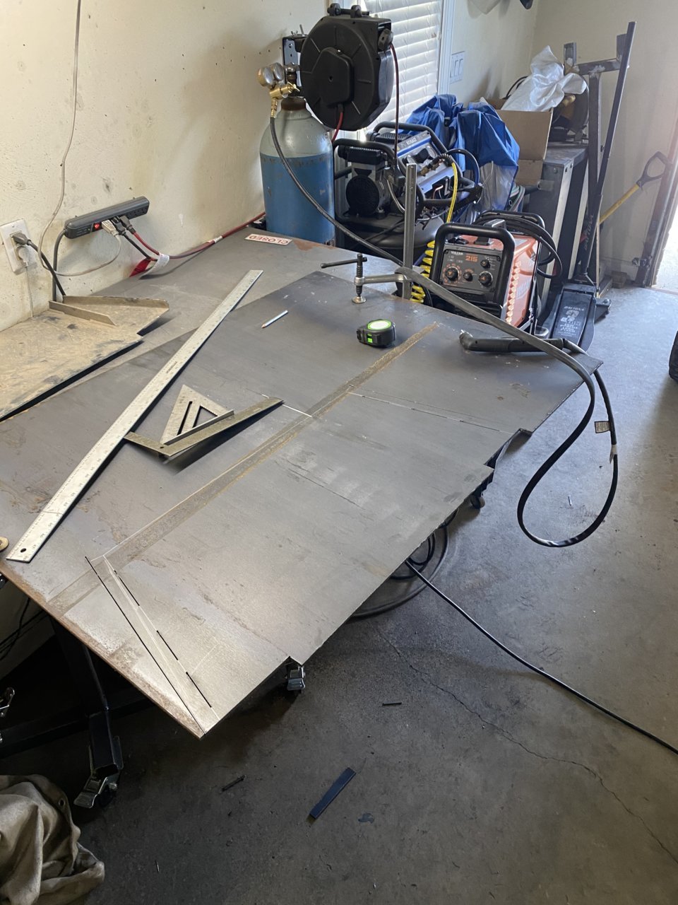

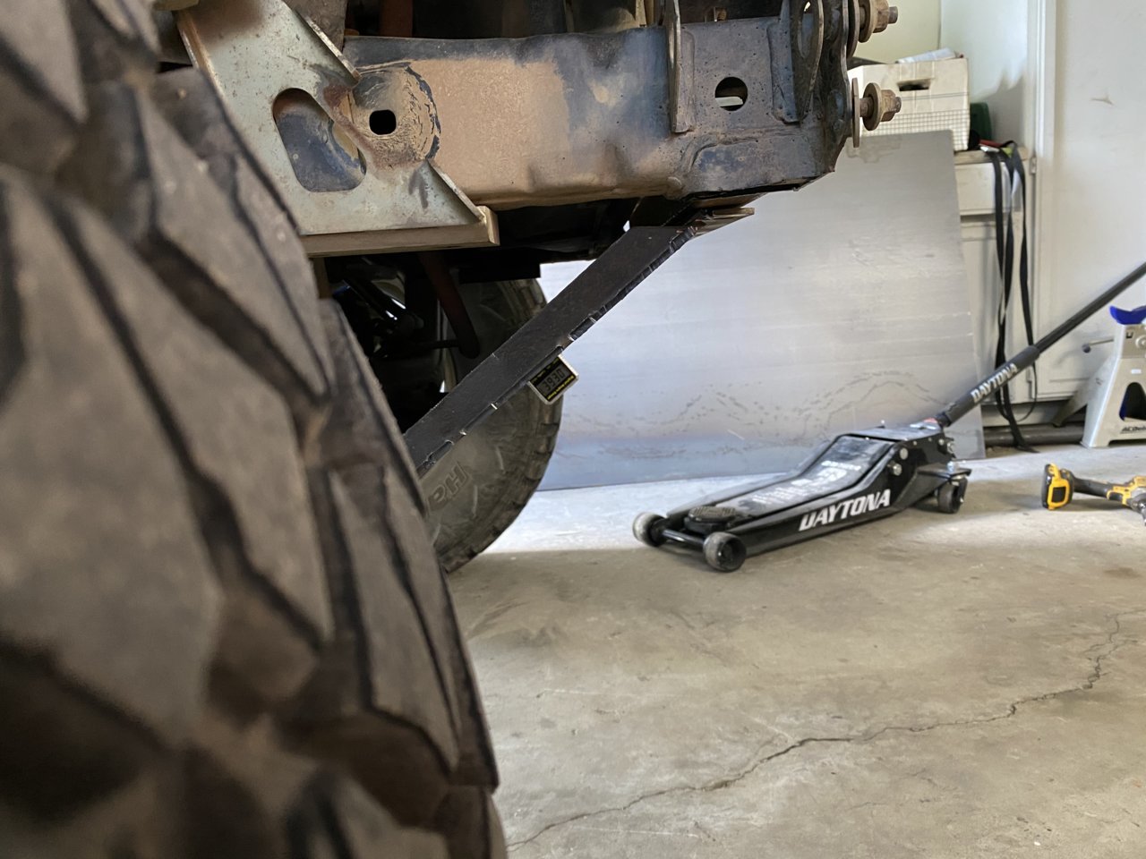

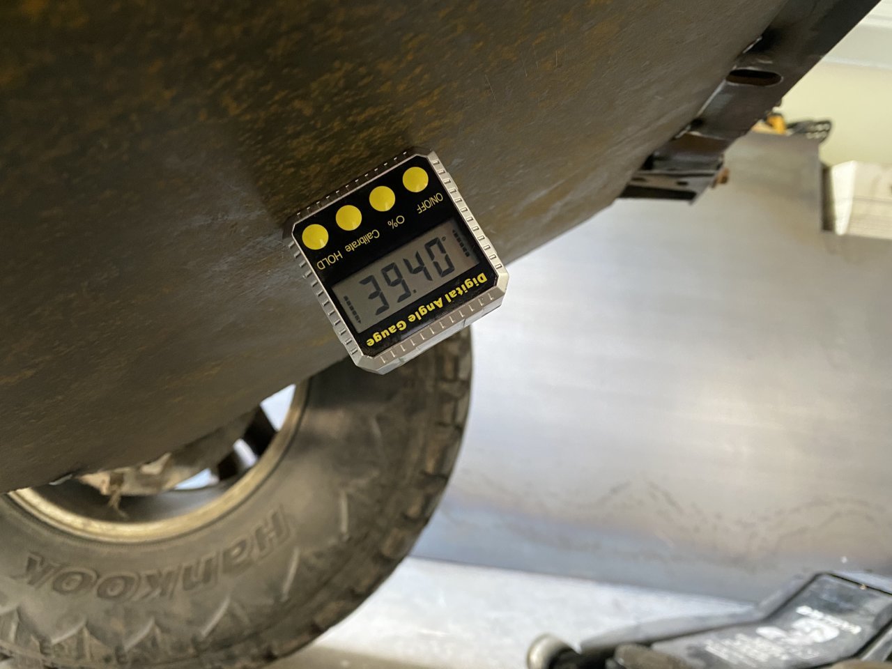

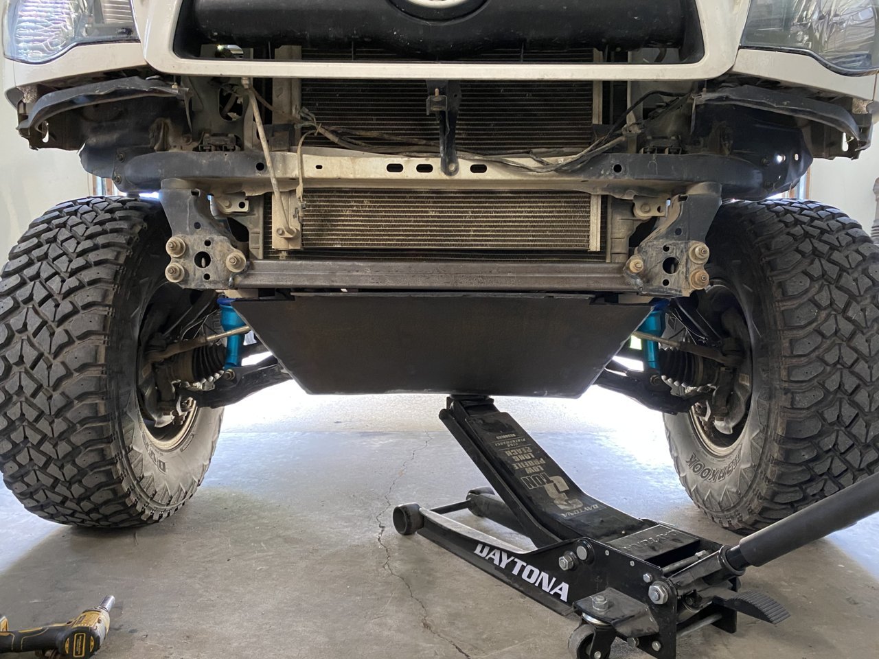

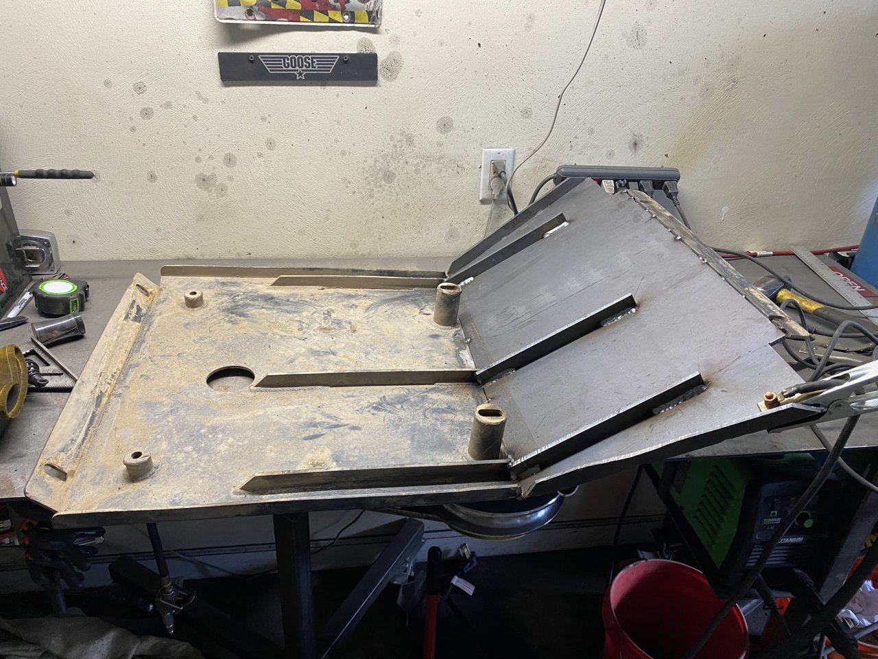

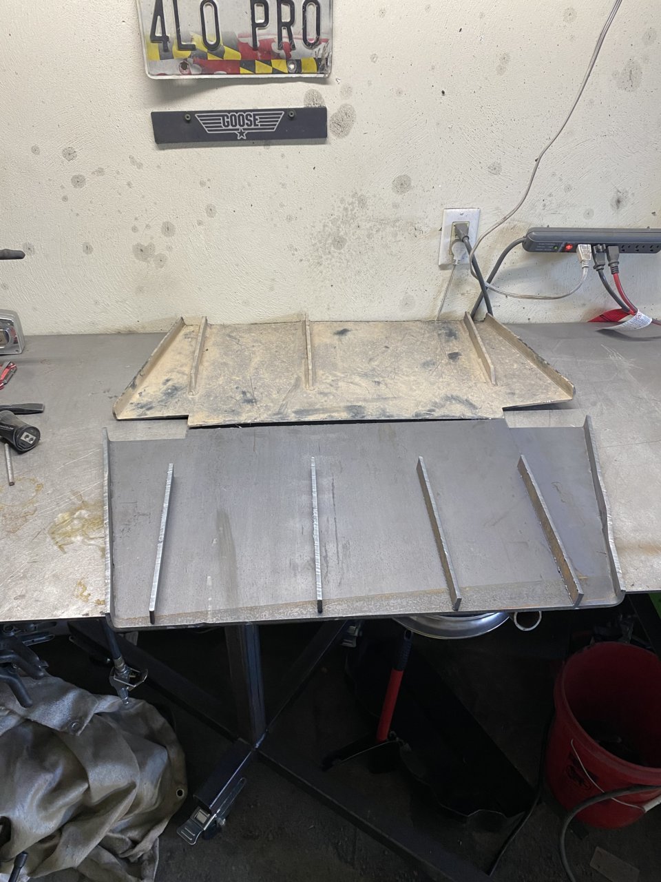

    Working on the skid as I type this. Letting it cool down a little after welding some, so I don’t pump too much heat into it.
    Gained 16° angle by raising it up the 4”. All I did was cut off the front, and remake it but 2” longer (and out of 1/4”). Made a huge difference.
    Edit: all done

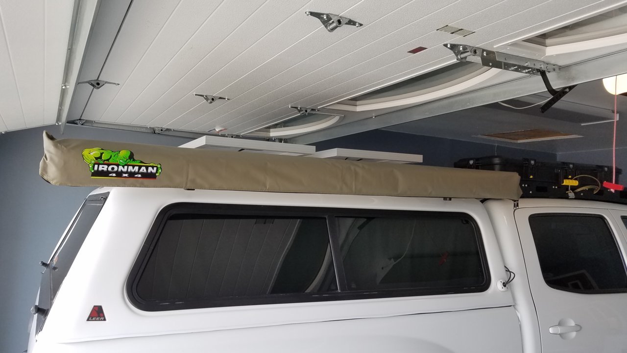

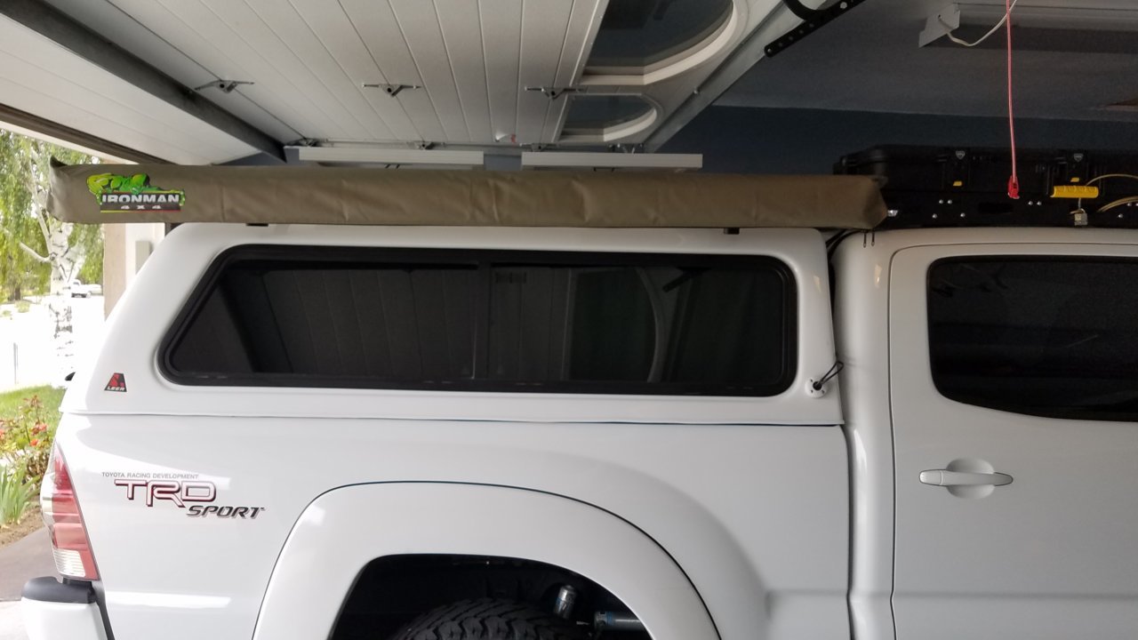

    Got my Ironman 4x4 awning today:

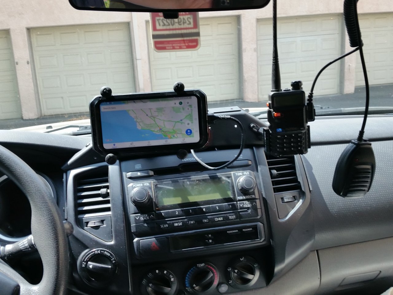

    I finally wrapped up my Expedition Essentials 2TPAM for my second gen. The install was a bit more challenging then I thought it would be, but it is a solid object. I was excited to take a photo of it with my phone and radio, when I realized my phone was my camera! Quick run back to the house and got this. 20200625_105120.jpg
    The people at Expedition Essentials were great to work with and I would recommend them.
    Beware, I told my wife about wanting a new Android head unit now, and her reply was, "Why? You phone is mounted in clear sight. Why would you need ANOTHER map?". My wife is way to smart for my own good.

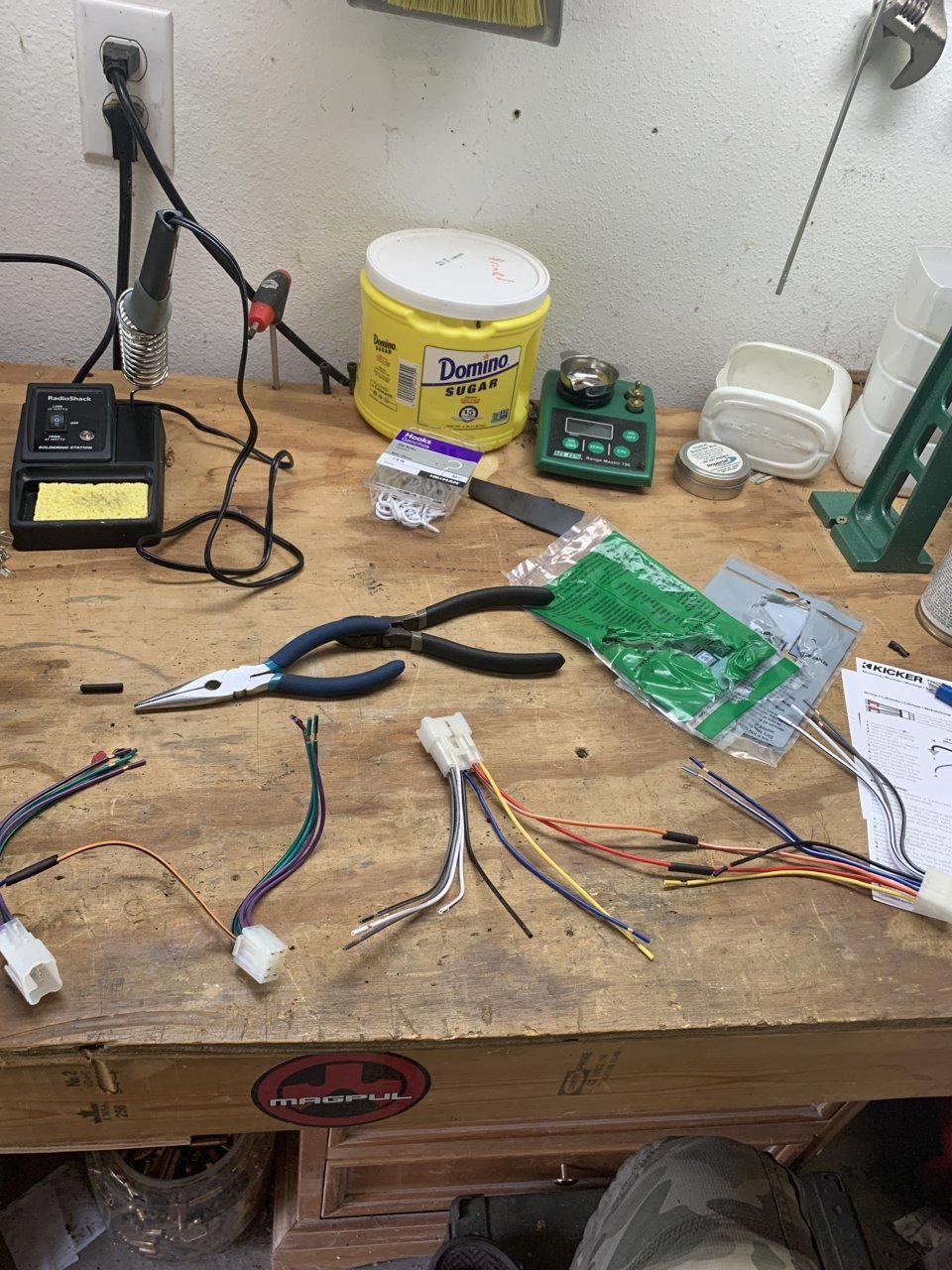

    Soldering in progress. Let’s see if this involves profanity or not. 50/50 odds.

    Easy work and much better than butt connectors. I really enjoy electrical work because i try to make it oem looking as possible w loom and tesa tape.

    The cursing starts when things don’t go to plan. Been soldering harnesses since Pope taught me in my teens.
    Right now I’m trying to figure out where in the dash I can stuff this amp. It’s small enough, just got to find it a home.

    Did you use your pre-existing skid & rewelded in place?

    Pretty much. I just redid the front portion. So I bolted the lower part onto the truck, held the new one in place and tacked it up. Then got it onto the workbench for welding

    Many years ago, i stuffed one of those small alpine amps above the glove box. It fits perfectly. The plastic is removable, check it out.
