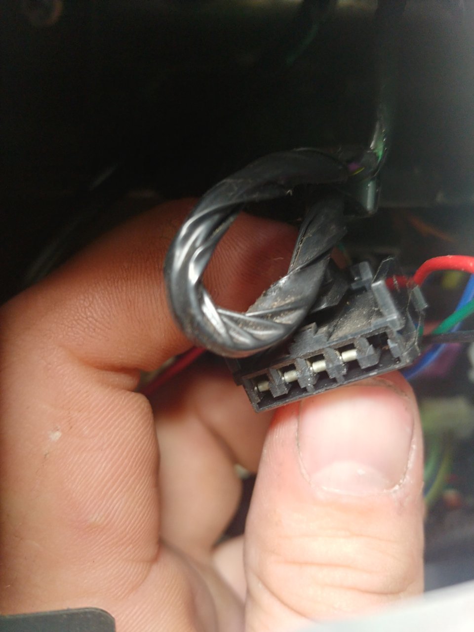

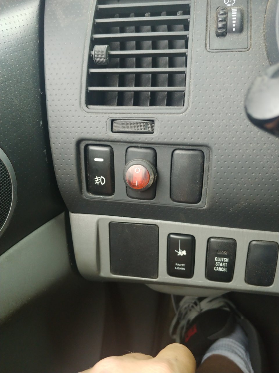

    Bought and installed a light bar today. 14 inches, cheapo.
    Also, what is this plug. Its attached to the top of the fusebox

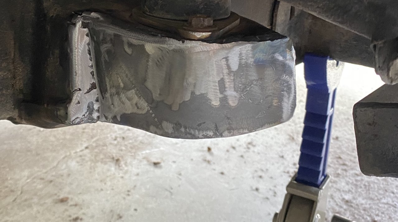

    I cut his cab mount wayyyy back to this for his future 35s and also built him this crossbar for his bamf hanfers. We had other stuff on the itinerary but ran out of time. I don’t normally like doing the cab mount like this (angling the face back) because it doesn’t look as clean, but he wanted maximum clearance, so that’s what I gave him.

    That bubble switch doesn't set well with me and I know you don't give a shoot! :D

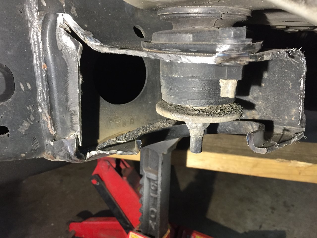

    Cut the whole end off the next time. I also remove the whole face back to the frame. It doesn't really need to be but makes a much smoother transition. When you cut the whole end off you can shape the end plate better. I weld on the face plates, tack the end cap on flat and hammer it around to shape it and taper it back. We all have our own way of doing these things but I found this easiest. So far
    I hadn't finished cutting this one back to the frame yet but you can see what gets removed from the end.
    everything gets tapered on the end but also angled back
    All 3/16 plate

    Going to be doing this while I have my front end torn apart this coming week, looks good!

    Looks great! It’s hard to tell from the angle but I did take the whole end off. I found a sawzal with quality blades makes short work of the end. Easier than getting in there with an angle grinder

    For 34's or 35's you pretty much have to remove that much.
    Oh, absolutely. Yeah the pick made it look like it was cut back at an angle. Either that or I just can't see that well LOL

    Haha me either honestly. I'll be ordering an actual light bar switch soon. I just did it so the button wouldn't be dangling around under my dash
