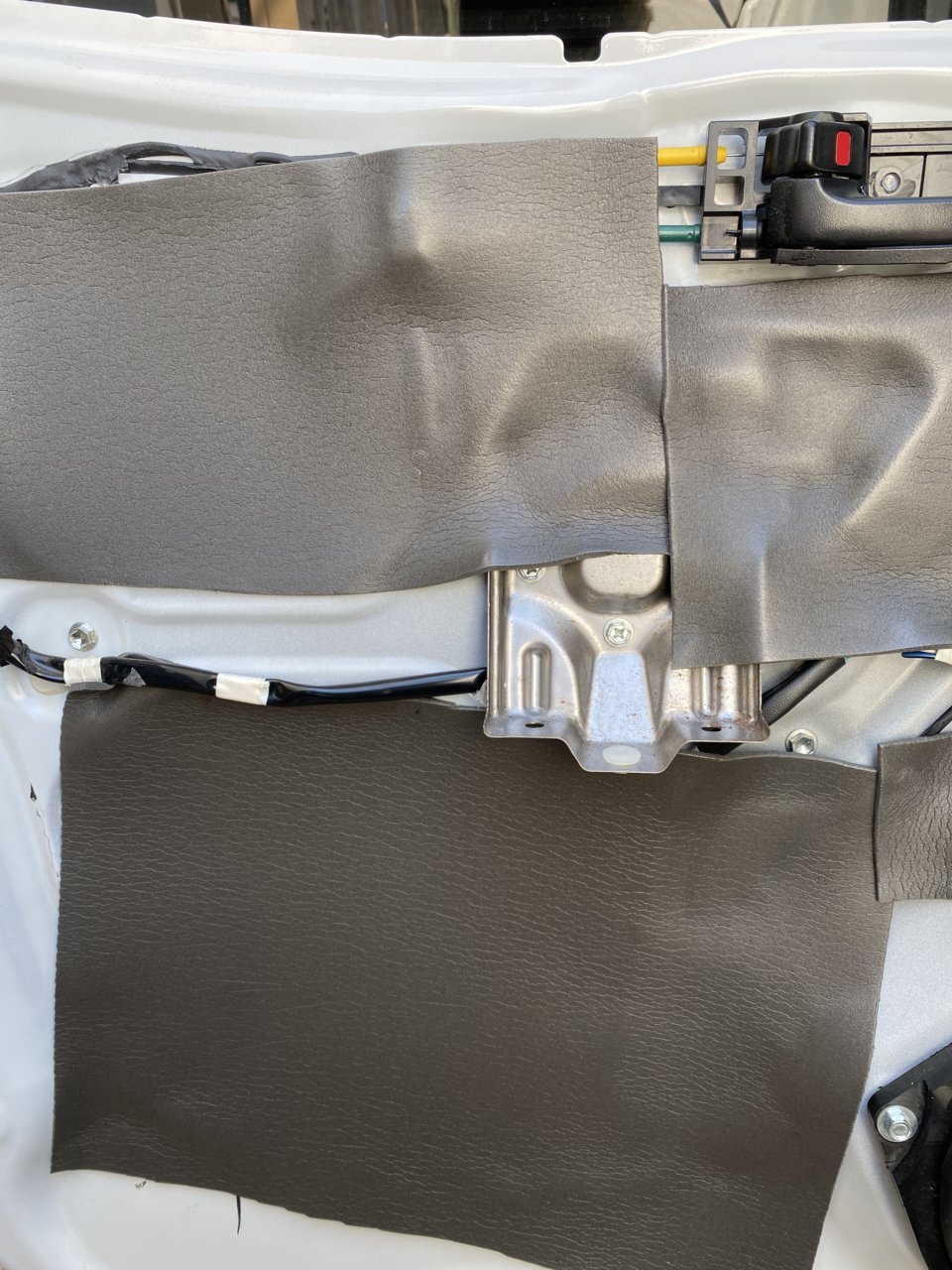

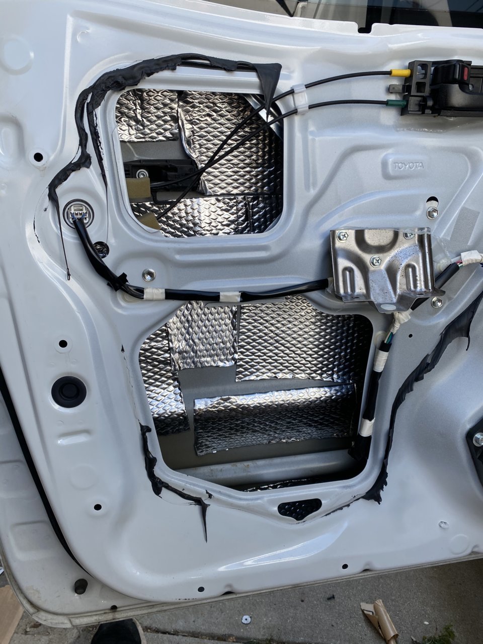

    Weather still didn’t want to agree with me so I said f**k it and decided to get some stuff done.

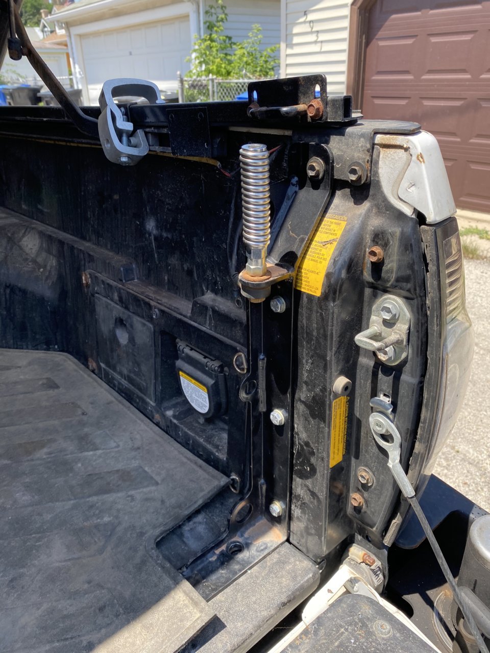

    I finally put in my total chaos bed stiffeners and moved the antenna mount
    I put the sound deadening inside the doors 80mil on the inside and 150 on the outside and there is a definite difference there
    I didn’t care to do it as neat as possible because no one will see it but I wanted to make sure I did enough that it was worth it and I love it. It’s also much cooler when I get in now so I’m glad I did both layers

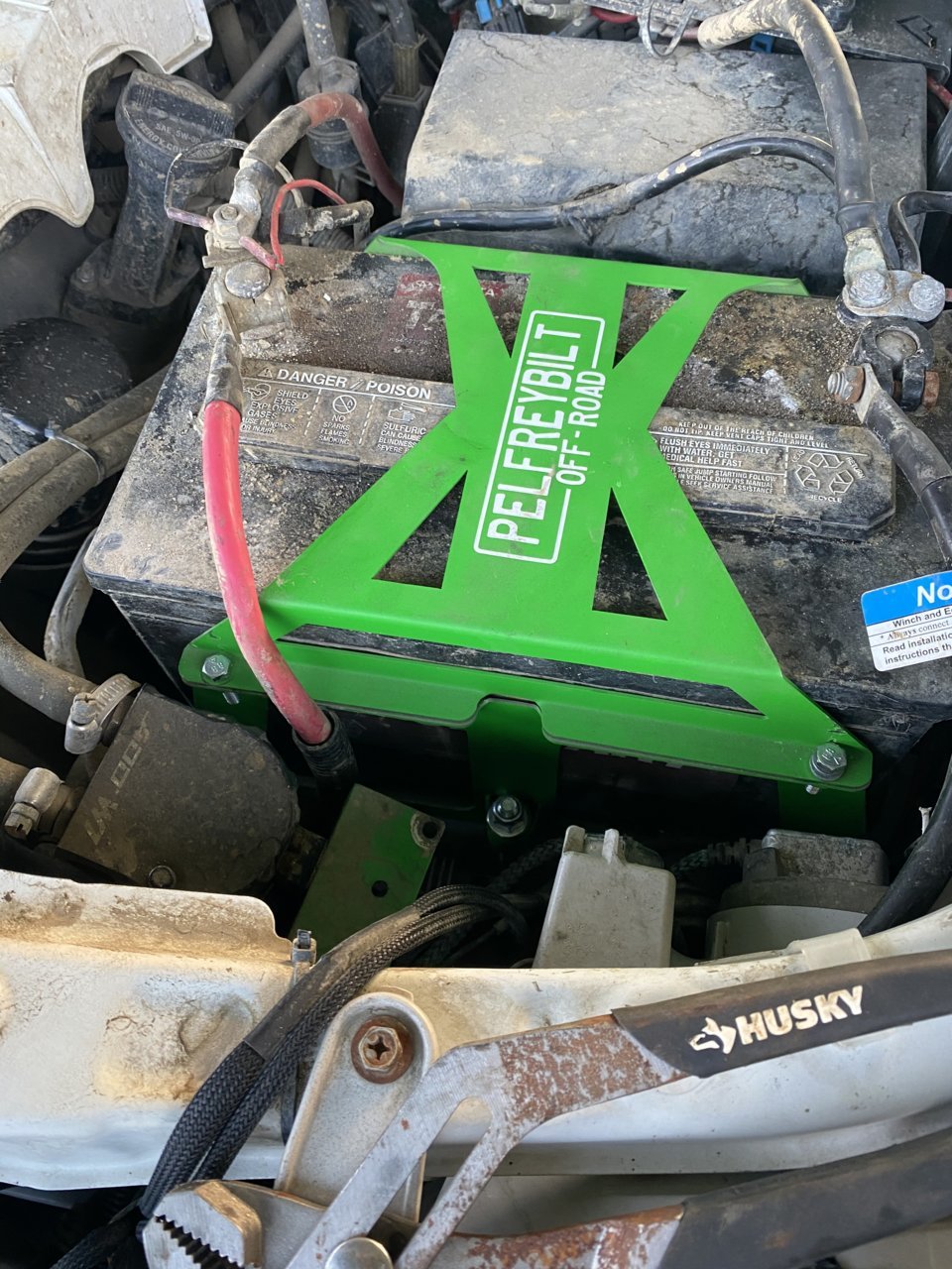

    I also installed my bankrupt armor battery tray (ignore the decal I did it a long time ago)
    Now I just need to grab my 31m deep cycle to put in it and figure out a new mounting spot for my oil catch can

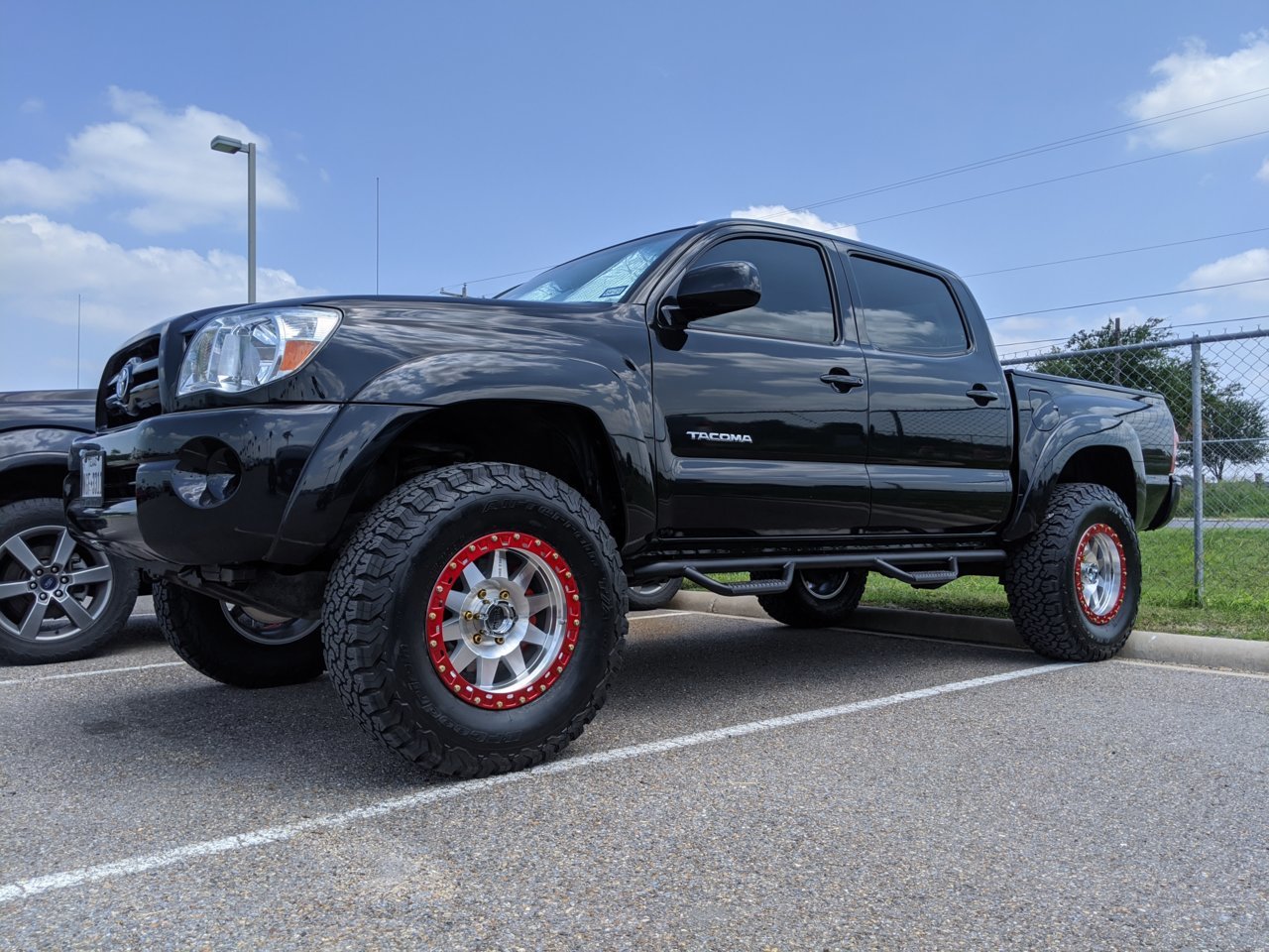

    In addition to sound it is also much cooler in my truck when its been sitting in the sun so I definitely have noticed a difference in both aspects. Just for the 4 doors i used one box 18 sq ft of noico 80 mil and half a roll of 36 sq ft 150 mil. Again thats with not taking preference to the prettiest application and making sure it was functional. total cost for the doors was maybe $75 i still have a lot left and plan on doing the floor as well. Roof is a huge maybe haha but i dont want to mess with the headliner.

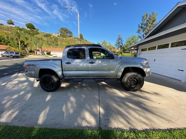

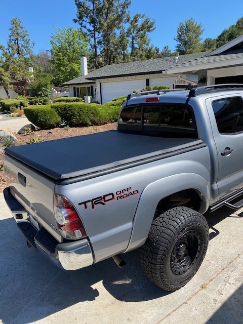

    Installed side steps, bed cover, roof rack, and wheel spacers.
    (I also wired my fog lights to run independently)

    Did you reinstall the clear plastic sheet (vapor/water barrier)? If so, any lessons learned? Thanks.

    I didnt. I used the 150 to cover as much of the holes as I could so we shall see Ive seen people reuse it but only when they just did inside the door and not where the vapor barrier is. I did both inside the door and the outside where the barrier used to be being sure to surround as much of the holes as I could.

    I've never thought too much about that inside of the door's vapor barrier before but I'd assume that the point of it is to not allow any water that goes down the glass is stopped (in theory) by that barrier and goes down to the bottom of the door where i'm guessing we have a weep hole....? Is that about right in thinking?

    I would paint it back black. Just my.02

    Yes that is the theory. I will be checking it after it rains or i get the truck washed to see what I am dealing with and determine from there how to move forward.

    You'll notice a huge difference with sound deadening material. The more surfaces that it's applied to the larger the difference. The idea is not to cover every square inch that can be covered, it's to stop the metal from vibrating which amplifies unwanted noise. Covering every inch is wasteful but to each their own.

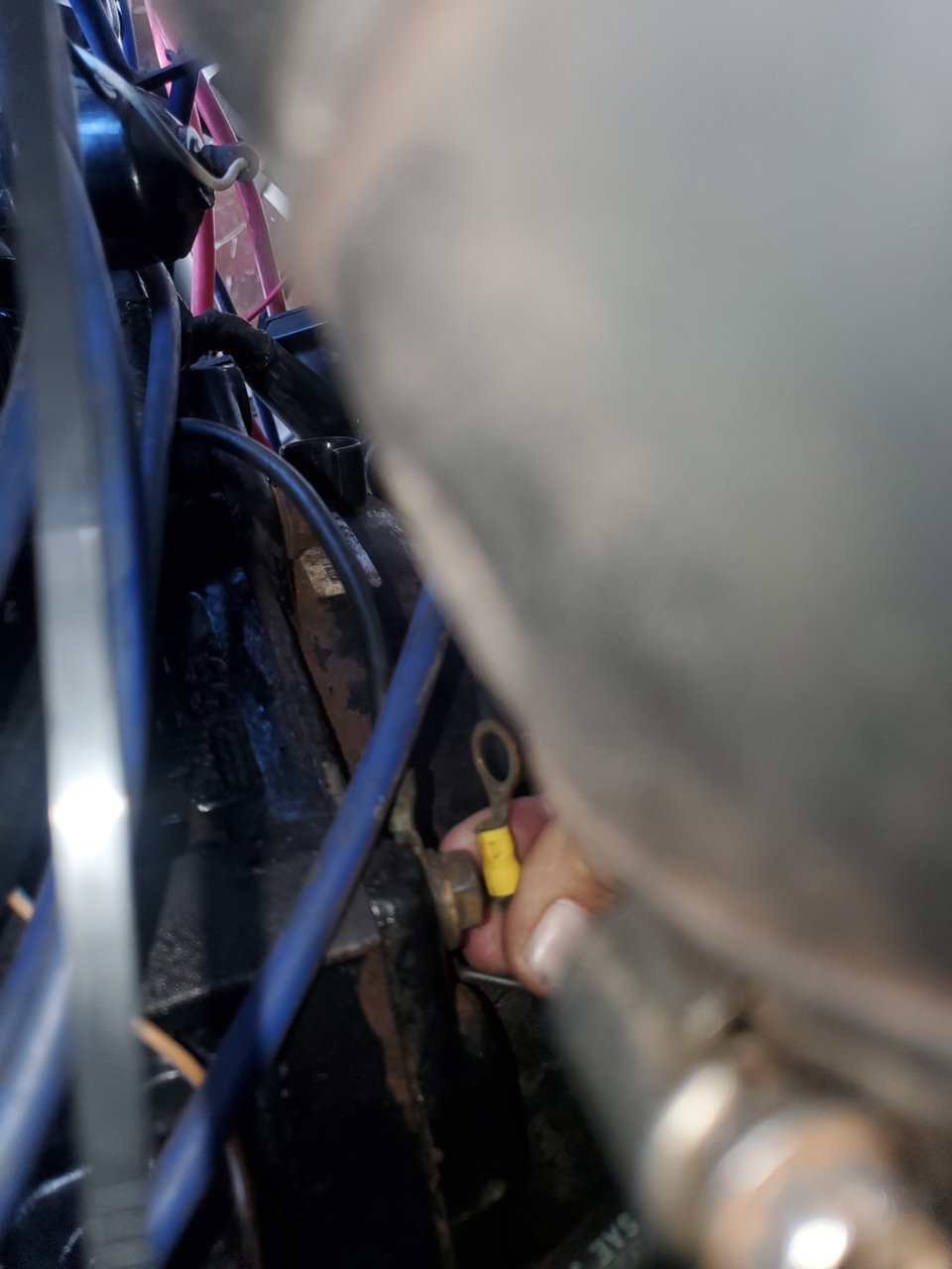

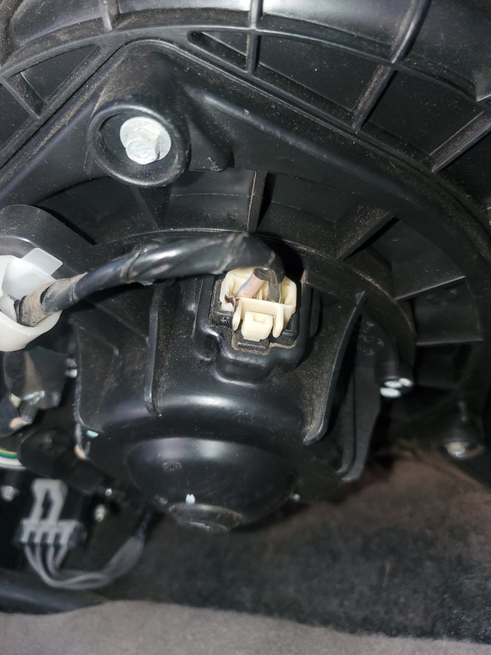

    On the way to work this morning I noticed that my trucks AC/heater blower motor speed was significantly reduced. Later I narrowed it down to a bad connection at the blower itself which is funny because for the last 2 days it's been acting weird I have been hitting the dash right below the heater control to make it work (lol). You can see the plug for the aftermarket blower motor resistor as well (all grey wires).
    I fixed that boats trim and tilt. The guy that installed the new engine missed a ground wire at the bellhousing bolt.
    And the boats trim and tilt "up" switch was no good so I just added a temporary switch under his dash so he could make his vacation with his boat.

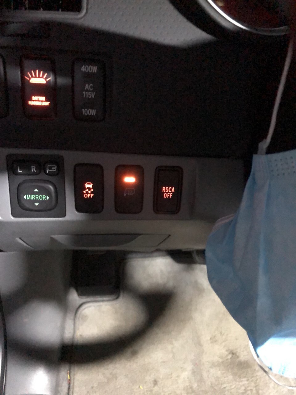

    @tbr3345 that switch has LED's inside it I believe. It'll be easy to dicifer, remove the switch and if it uses an actual bulb you'll see the bulbs socket from the outside of the switch, a round piece of plastic with a small flathead in it, if you don't see that then it's LED's.

    Enough to light up my swotches on door lol. Its bright but doesn't bother me. Its hidden behind steering wheel enough.

    They are LED's remember looking for the little bulbs with the slot for screwdriver so guess I will live with the green ligh. At least everything works. Next Mod. Get the house painted for my wife and widest the new driveway didn't plan well need about 24" more.

    There are a few threads on changing the switches colors of light emitted, find one of those threads and it'll tell you which LED's will work. I'm positive you're capable of the task.

    Were the amounts of sound deadening material you listed enough or did you need more? (i'm trying to order once...)
    and by chance do you know what that black adhesive is?
