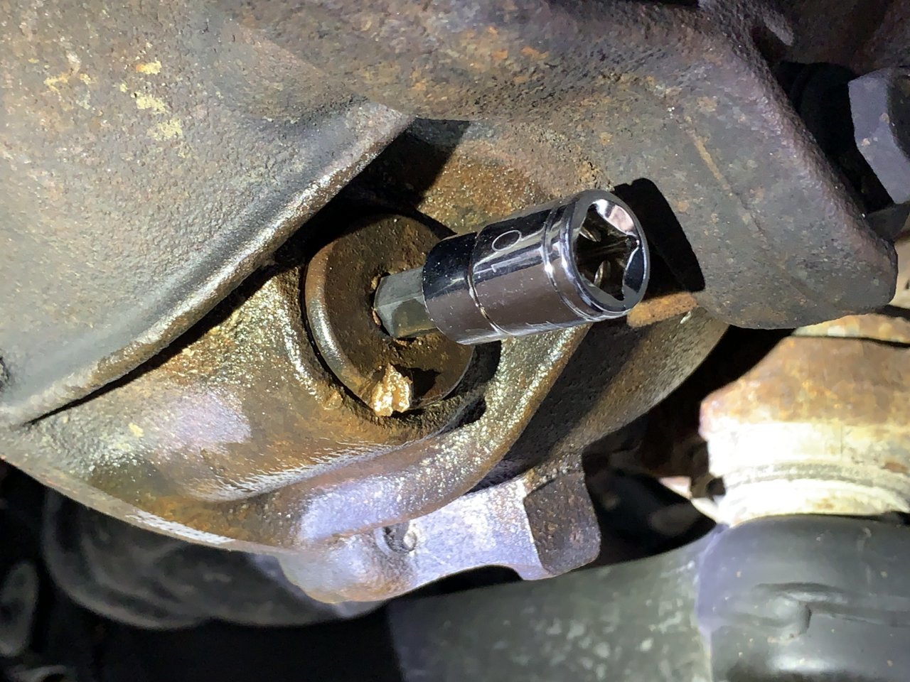

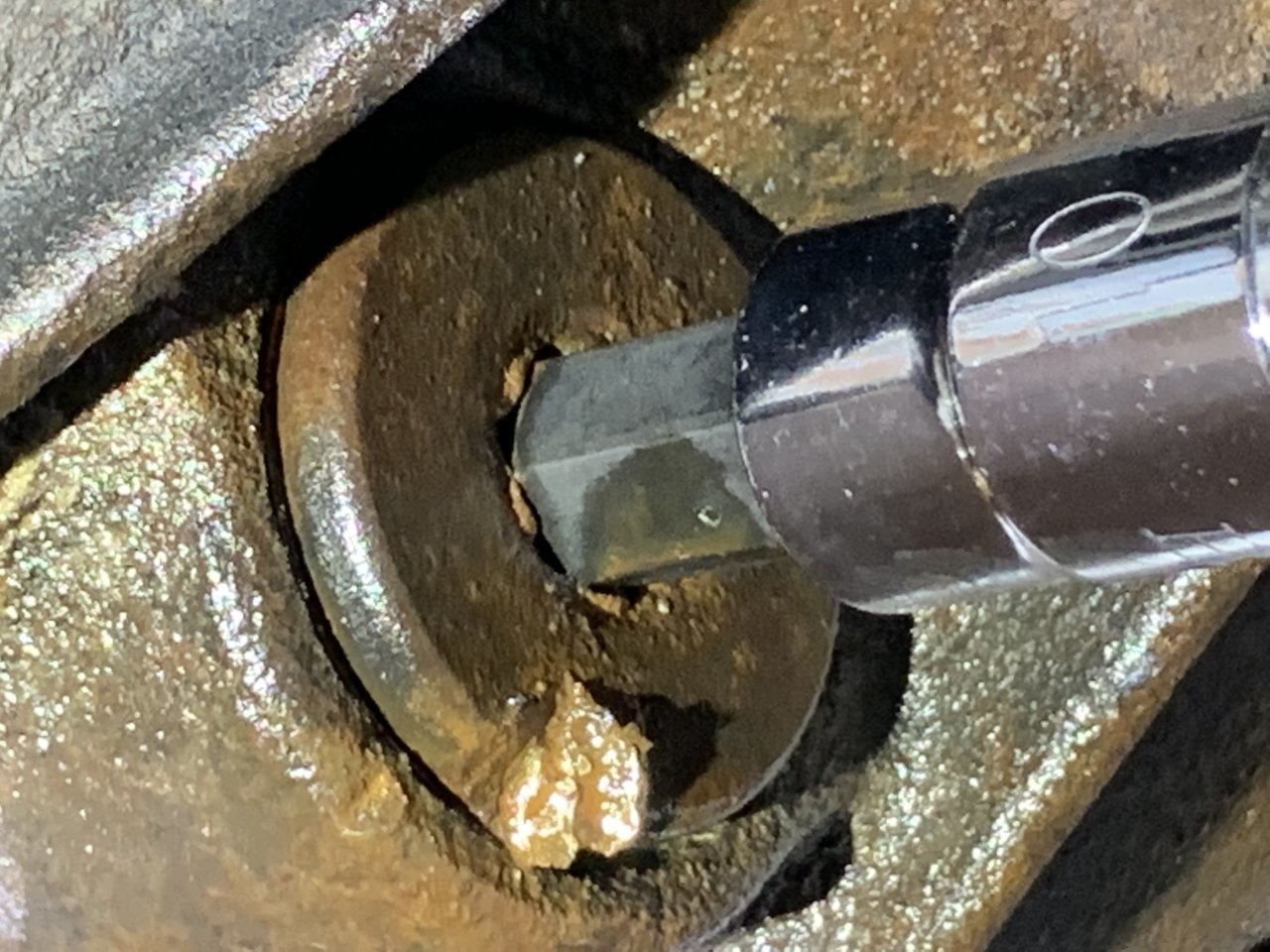

    I have not been as successful yet..... (I did not put the notch in the bolt, must have been the stealership the last time it was serviced -prior to the ADD actuator junking- and before I woke up to doing my own maintenance)
    I've soaked it in PB Blaster and hit it with a 1050HP electric torque gun.... the allen head has not stripped yet... and I have the big Star driver if it does.... but still nothing.....
    Let the suggestions start...

    If it were me, in this order, I would get a bigger breaker bar and go at it until it strips. Then I’d weld a nut on and try again. The heat from welding would help crack it free. Then an air chisel.

    I would heat it up , and use a big breaker bar, cross your fingers

    I would pick up some CRC freeze off,. Then a massive breaker bar. my impact wrench didn't work oddly Enough. Heat might have to be brought into it.

    +1 Heat the metal surrounding the bolt then use the freeze off as you apply the impact wrench. If you're quick enough, the bolt should be contracting while the hole is expanding.
    https://www.youtube.com/watch?v=7DC1dVDmusQ

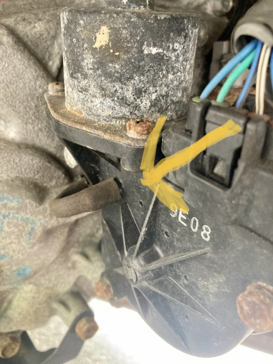

    Anyone know what this hose on the transfer case is?

    Good question, I don't know either but when I did my transfer case it was unplugged! So must not be THAT important
