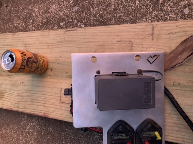

    I'd say very easy, and I've never installed a winch before this one. I did need an extra set of hands for one part, and that was to screw in the two upper mounting bolts while I held the winch in place, which my wife could do by hand without tools while standing right in front of the truck.
    The clutch handle end needed clocked, which was WAY easier than I woulda expected, even though the instructions are completely wrong that came with it. It said to remove two bolts and spin it... those two bolts wouldn't have done anything. Just removed the seven around the casing on the clutch side, spun it 90 degrees, screwed them back in. Done. Didn't have to pull it apart at all, just spin it in place.
    The winch control unit I mounted in the side position over the motor, and mounted it after mounting the winch. I say over the motor, but it's technically between the winch motor and the engine of the Tacoma, since the whole winch is mounted bottom/feet forward. Was a little tight, but not hard. I did not clock the motor, and the cables had plenty of length to get to the battery. To attach the wired remote, you need to pop the hood, but from there you have easy access down to the on-off switch and the cable connection. I have small hands and could reach through the front of the bumper to the on-off switch, but that would prolly be difficult for most normal sized men, lol.
    I didn't find it to be TOO much of a big deal on the freespool lever, but i also tested out using a small crescent wrench through the large hand hole on top of the bumper directly on the lever and it made it easy to disengage. Re-engaging isn't an issue, since the lever will be more easily accessible. If you have any more questions let me know!

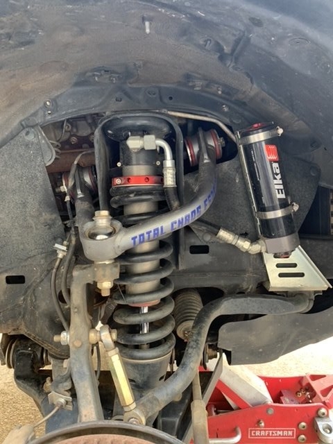

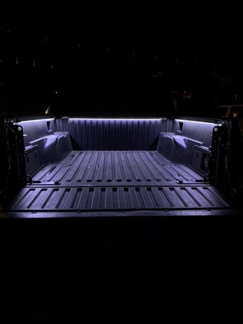

    Busy weekend. Installed my @mattgecko led kit finally. Not sure why I put this off so long. Very pleased with the results and can’t wait to use these. Going to make a huge difference when the family camps.

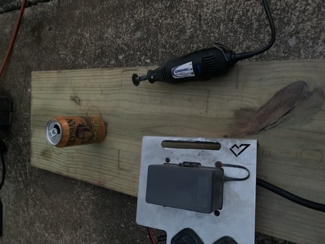

    Got frustrated with my aux fuse panel while wiring up my bed lights so I grabbed the dremel and cut an access slot to get to the bolts. Probably the most rewarding mod! Getting that panel out would cause me so much anxiety and frustration.
    Did the Subaru tweeter mod. Super simple and amazing the difference in sound. Again, not sure why I waited so long to do this.
    Washed the truck and lubed the Total Choas UCAs and rotated the tires.

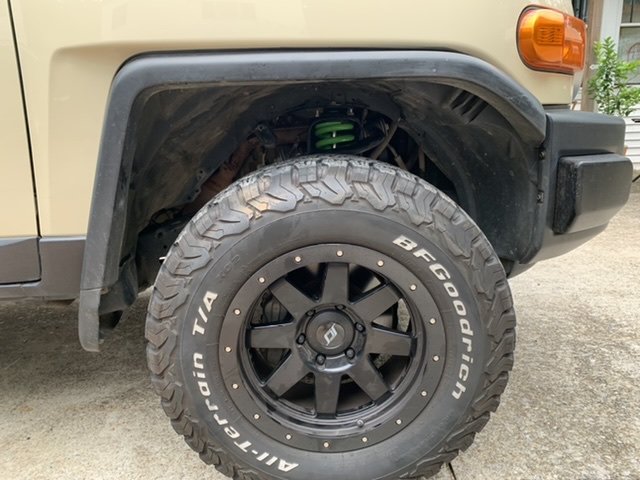

    Also, not Tacoma stuff but wrapped up an IronMan4x4 foam cell pro install on the FJ and replaced the sway bar bushings on the front and rear with some Whiteline and Nolathane ones. That thing is practically Australian at this point! Also, swapped the stock camera for an aftermarket one but retained the factory position in the rear mounted spare. Finished it off by doing the power steering fluid flush and refill.

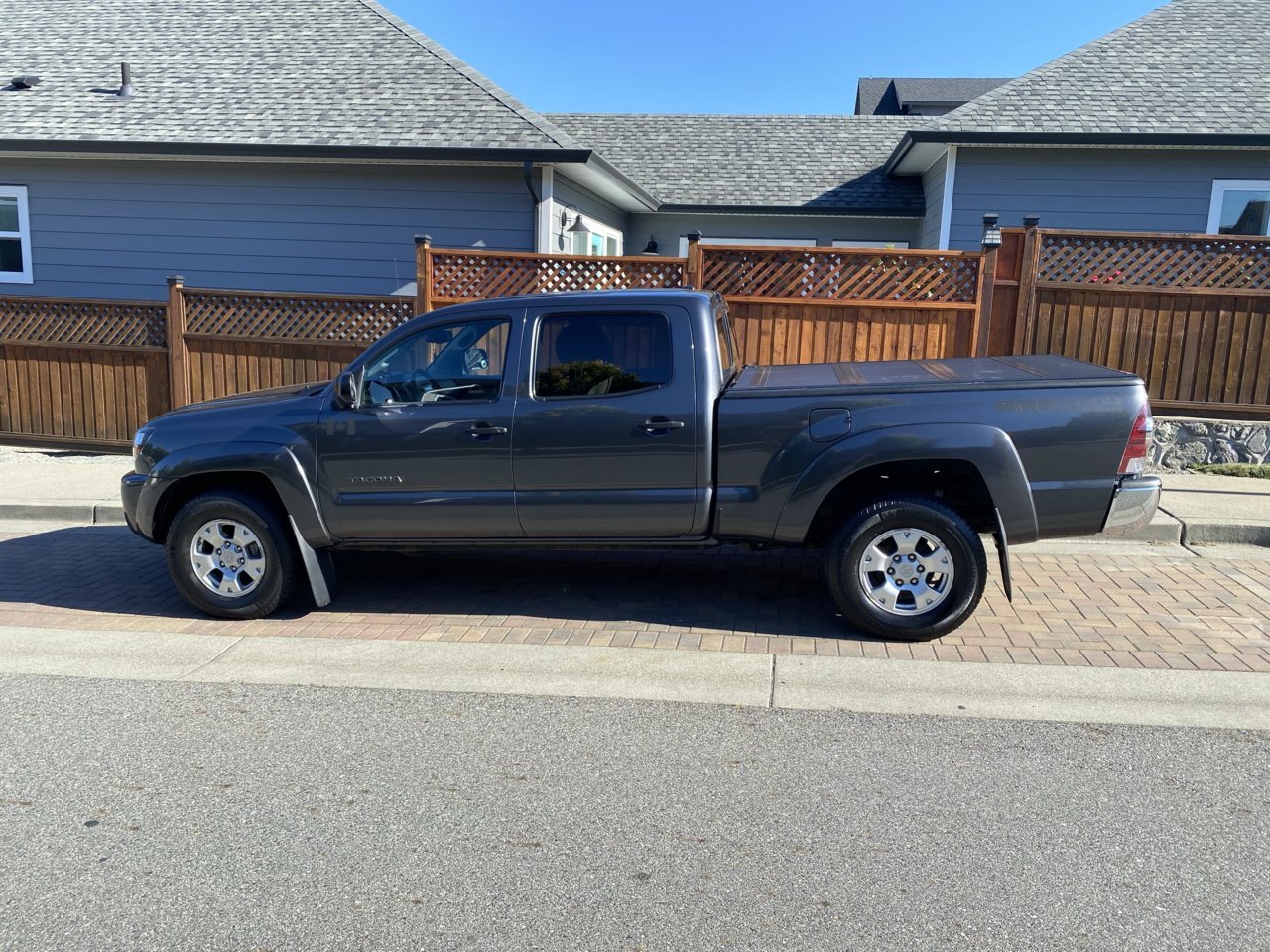

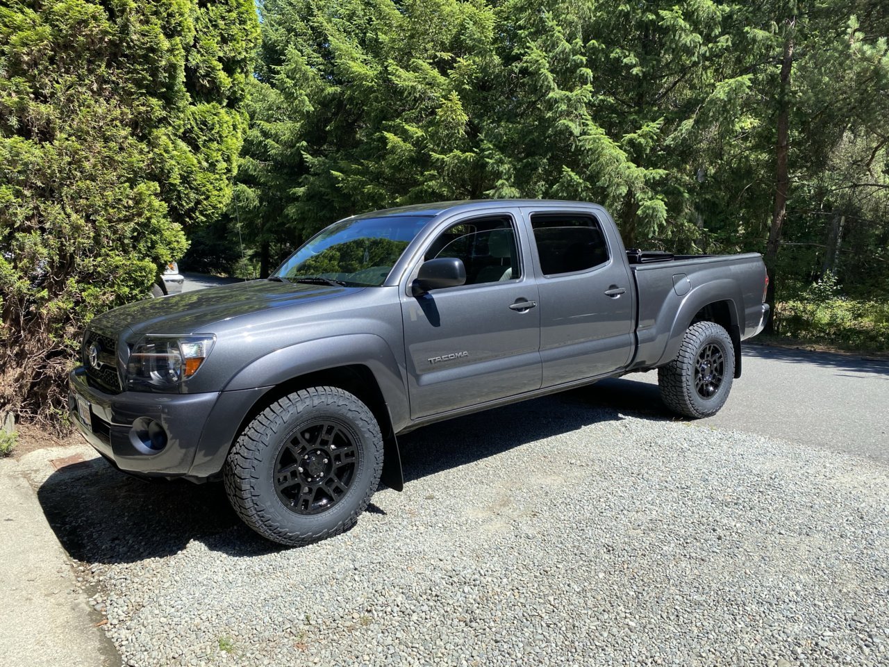

    Got rid of the old man rims and got some Falkens Wildpeak A/T3W (265/70/17) and ART Replica TRD rims (Like the Replika R213 but in gloss black)!
