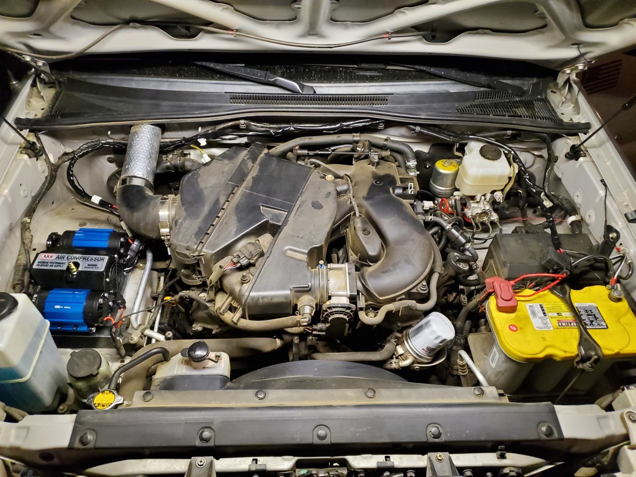

    I've got an ARB twin mounted under the hood on the left side.
    I just ran a hose to the tank and a hose to the quick connect from the tank.

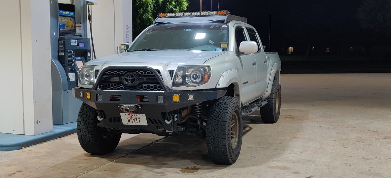

    Installed some squadron flush mounts, Cali raised dual led bar and Hooke road roof rack.
    Finishing up my new relay/fusebox to power it all.

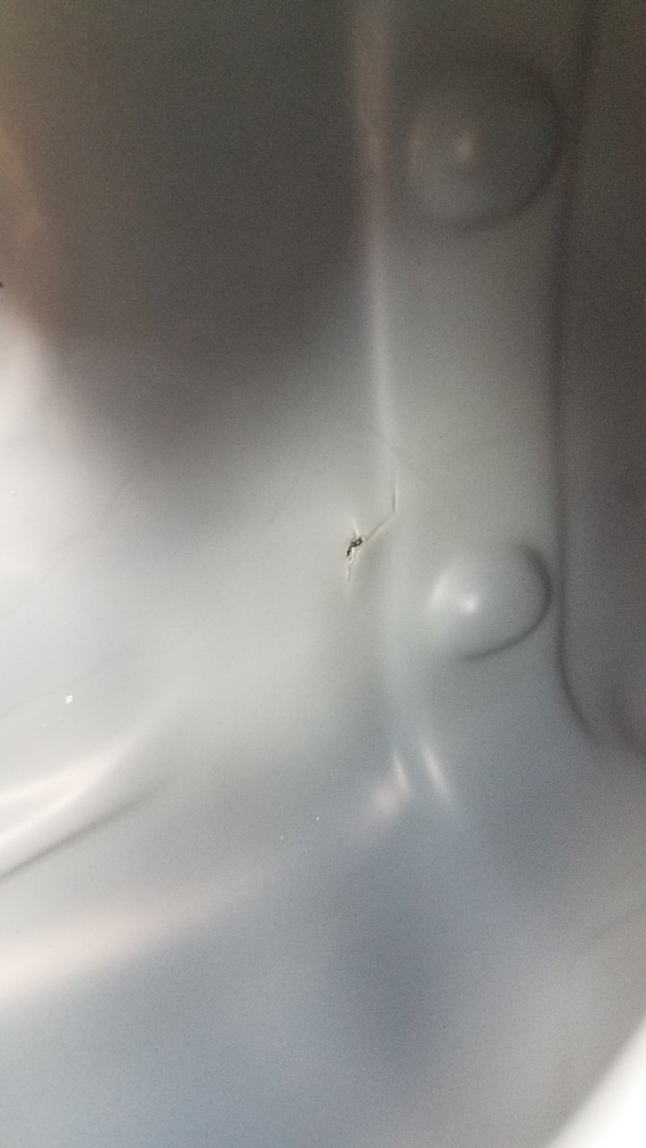

    Put a hole in my gas tank taking a stupid line on tin cup pass two weekends ago. Was able to patch it but didn't have a lot of faith in my patch so I found an ebay secondhand tank for $230. Changed out my fuel tank last night - so glad to have awesome neighbors to lend a hand. That is not a one person job!
    Saved about $800 vs going to the dealer so pretty happy about that. Does that mean I have $800 in mods?

    Got a pic of the damage to your old fuel tank?

    That's impressive because it's pretty hard to hit the tanks on these trucks. How did you patch it?

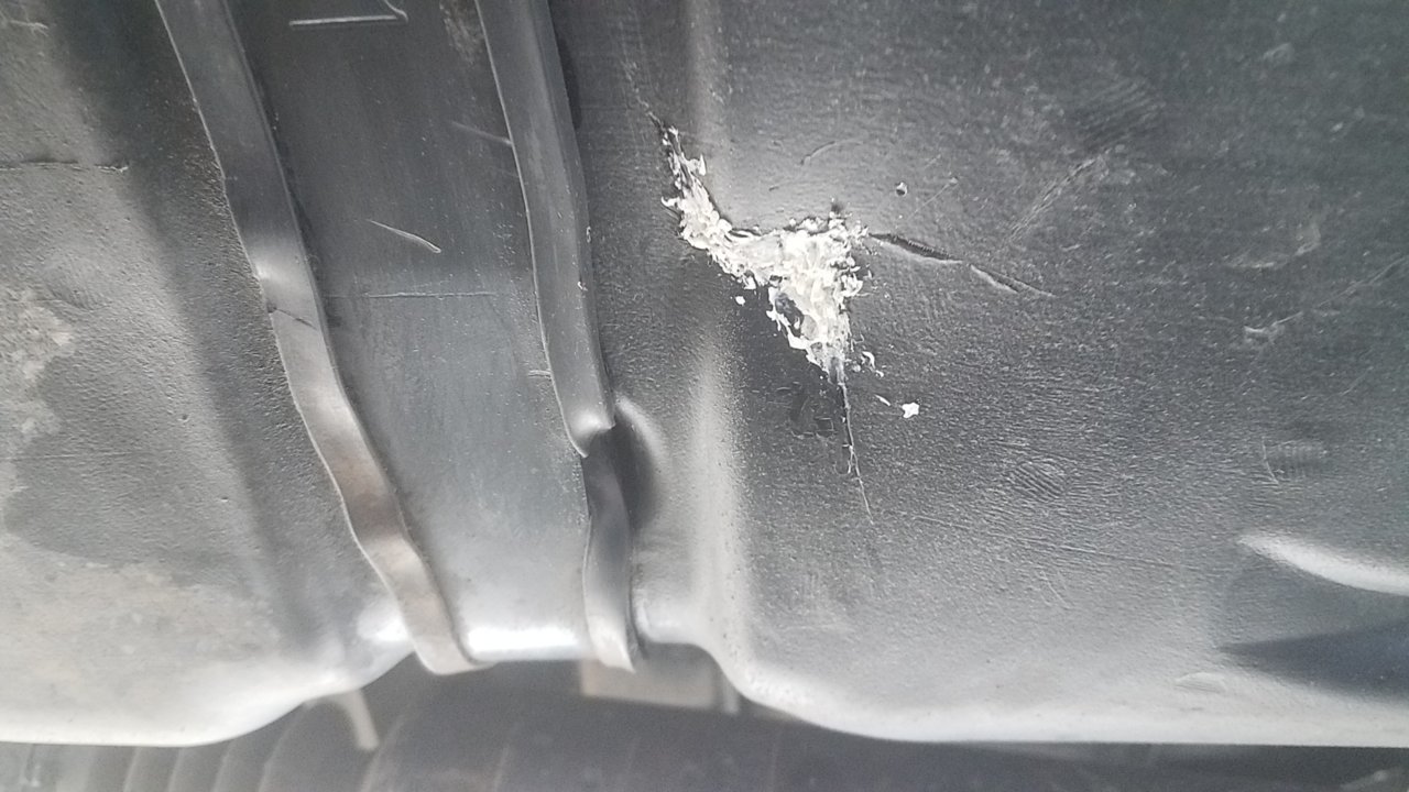

    I let the tank drain so the hole stopped weeping gas then welded plastic from an oil bottle over the hole. Covered with quiksteel epoxy. First picture is inside the tank, second is outside tank after my shitty weld pre epoxy.20200724_073919.jpg

    I have this as my fuel tank skid and it's been awesome. It's slick so when I do catch it on anything, it just slides right off. Definitely recommend.
    https://trailtoys.net/products/uhmw-gas-tank-skid-plates-2005-tacoma-dcsb-and-access-cab

    Thanks for the recommendation - definitely on the list! If I had an inch more ground clearance I think I would have cleared the rocks. Thinking a small lift and 32's as well.
