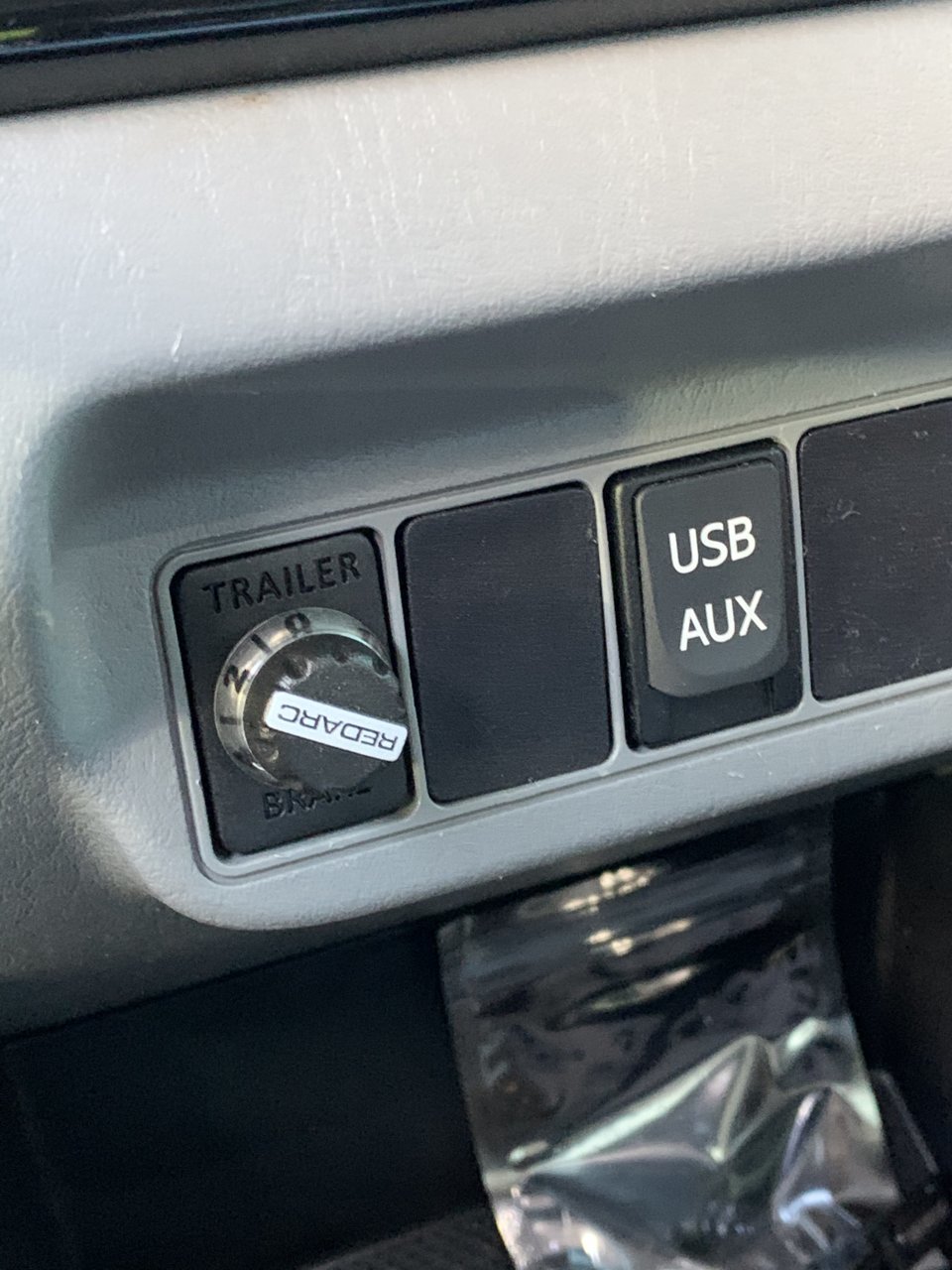

    Taco_koma
    Taco_koma Well-Known Member
    Aug 12, 2019
    #301955
    56
    Ben
    SE Michigan
    2012 Tacoma SR5
    So the Redarc number for the one mounted about the console (where i have it) is 331-TPSI-002. They also make ones for the left side of the steering wheel numbers (331-TPSI-001 & 331-TPSI-00) i believe one is universal and the other is direct fit.

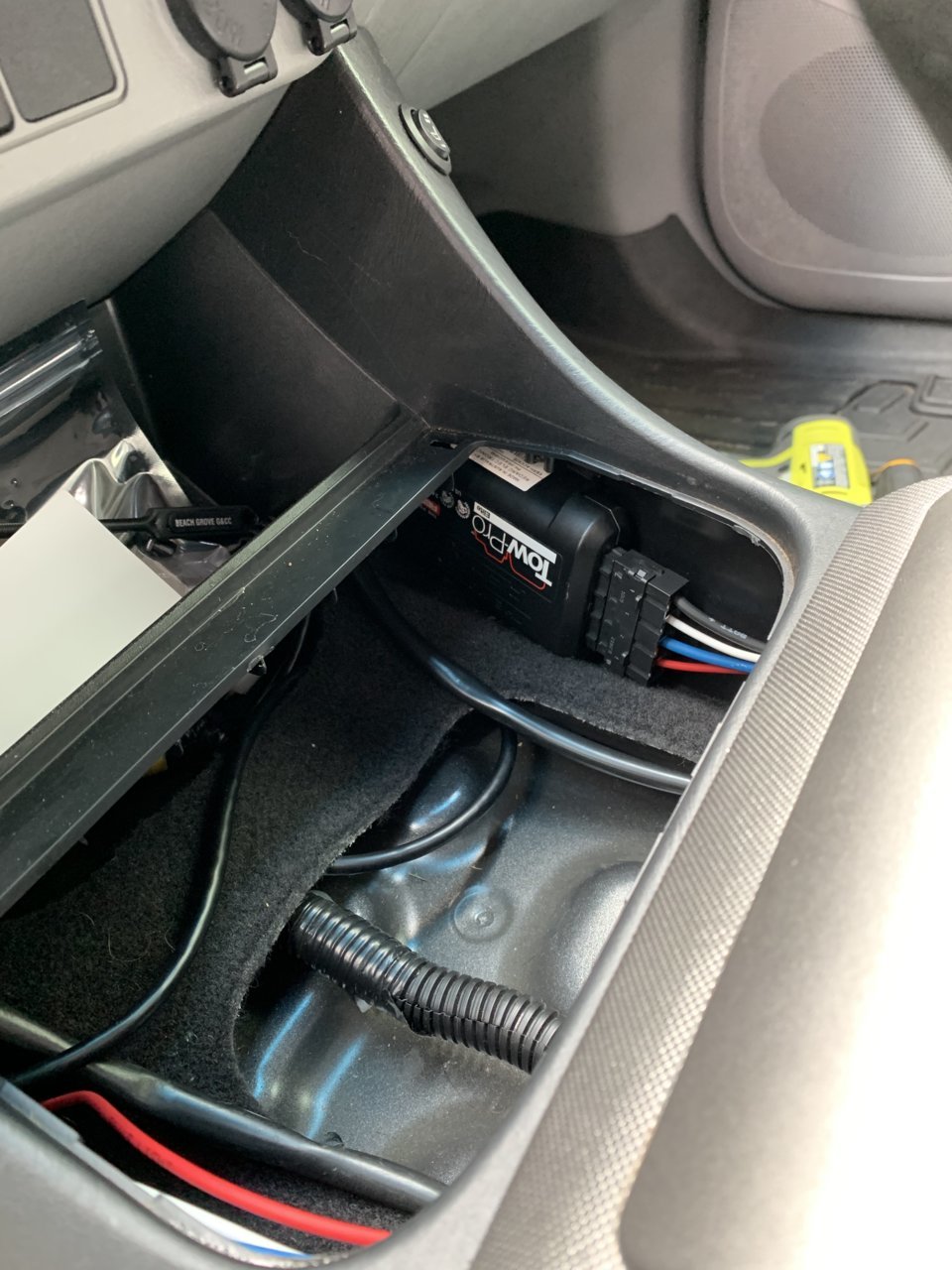

  4. Jul 28, 2020 at 8:43 AM
    Taco_koma
    Aug 12, 2019
    #301955
    56
    Ben
    SE Michigan
    2012 Tacoma SR5
    Thats the sensing module.
    These are the numbers i used from etrailer.
    Redarc Tow-Pro Elite Trailer Brake Controller-Item # 331-EBRH-ACCV2
    Tekonsha Custom Wiring Adapter- 3040-s
    Mounting Panel for Redarc Tow-Pro Elite Trailer Brake Controller Control Knob - #331-TPSI-002
    Kuntrykid[QUOTED] likes this.

  6. Jul 28, 2020 at 9:28 AM
    jproffer
    jproffer Well-Known Member
    Jul 9, 2018
    #258790
    628
    Jim
    Perryville, MO
    '15 MGM Sport DCLB, V6
    From reading some of the Q&A on Amazon, you push the button in to set the brakes, similar to moving the slider over on most controllers. Right?

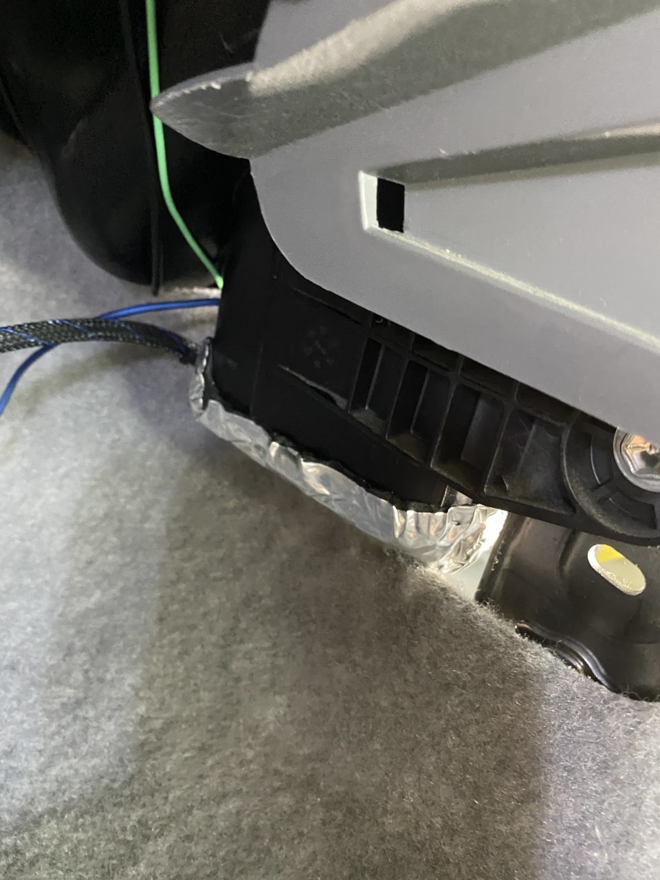

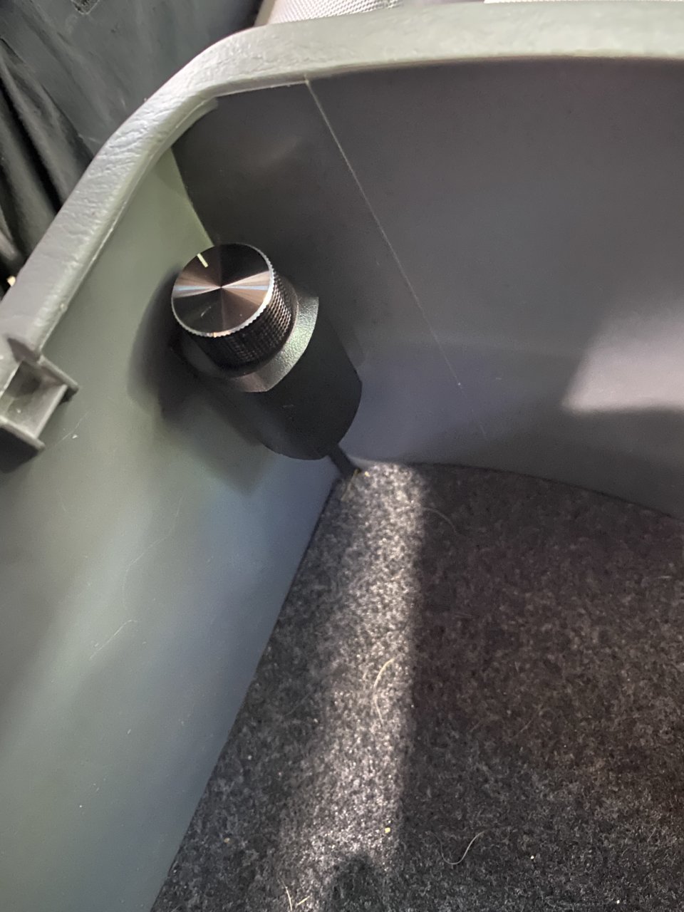

  12. Jul 28, 2020 at 2:12 PM
    jrlockman
    jrlockman Well-Known Member
    Jul 9, 2020
    #333956
    64
    John
    2011 White Double Cab TRD Sport
    None yet
    I installed a Sound Ordnance B-8PTD under the seat, definitely had to remove all the ducting to make room height wise for the amp/sub (both pieces up to the center console) but really glad I did, because now my air flow from the front ducts is way stronger, MORE AC! And I just covered the duct with sound deadening material to seal it up and then covered the metal floor where the ducting was with the material as well, turned out great!

  14. Jul 28, 2020 at 2:43 PM
    jrlockman
    Jul 9, 2020
    #333956
    64
    John
    None yet
    Good project today... Removed and cleaned all the door panels, then used the Noico Sound deadening material (big fan of this stuff, easy to work with and install, and cheap: https://www.amazon.com/gp/product/B00URUIKAK/ref=ppx_yo_dt_b_asin_title_o04_s02?ie=UTF8&psc=1 ) to line all the exterior metal doors, this was a huge improvement in sound quality and reducing road noise. And then I installed 4 new door speakers ( JL Audio C2-650X in rear doors and JL Audio C1-690x 6" X 9"s in the front) , and pulled driver seat and carpet up to run wiring for the Sound Ordnance B-8PTD under the seat... Good info here: I had looked for into all over these forums about if it would actually fit, and it does fit nicely under the seat without risers and sounds great but you do have to remove the two pieces of black ducting from the front console the goes along floor board and blows air into the back. I'm actually really glad I removed it too, because now the air flow from the front ducts is increased (More AC!).. Also make sure to position the amp/sub closer to the door than the center console as it will hit the occupancy sensor under the seat when the seat slides back and forth.Put amp gain knob inside center console, looks nice and clean. All in all I'm very happy with how all the sound turned out with the Sony XAV-AX7000 driving the door speakers and being able to get good base from such a small package under the seat is a bonus.
