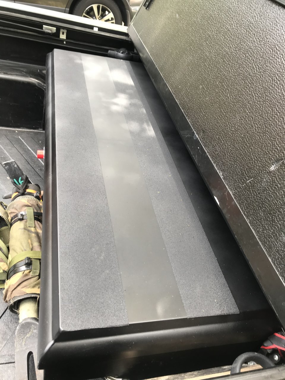

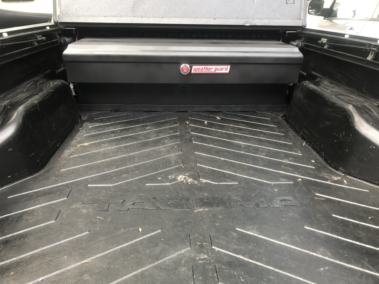

    I think it turned out pretty well. Added a couple nonskid strips to the top so the seating surface is less slippery.

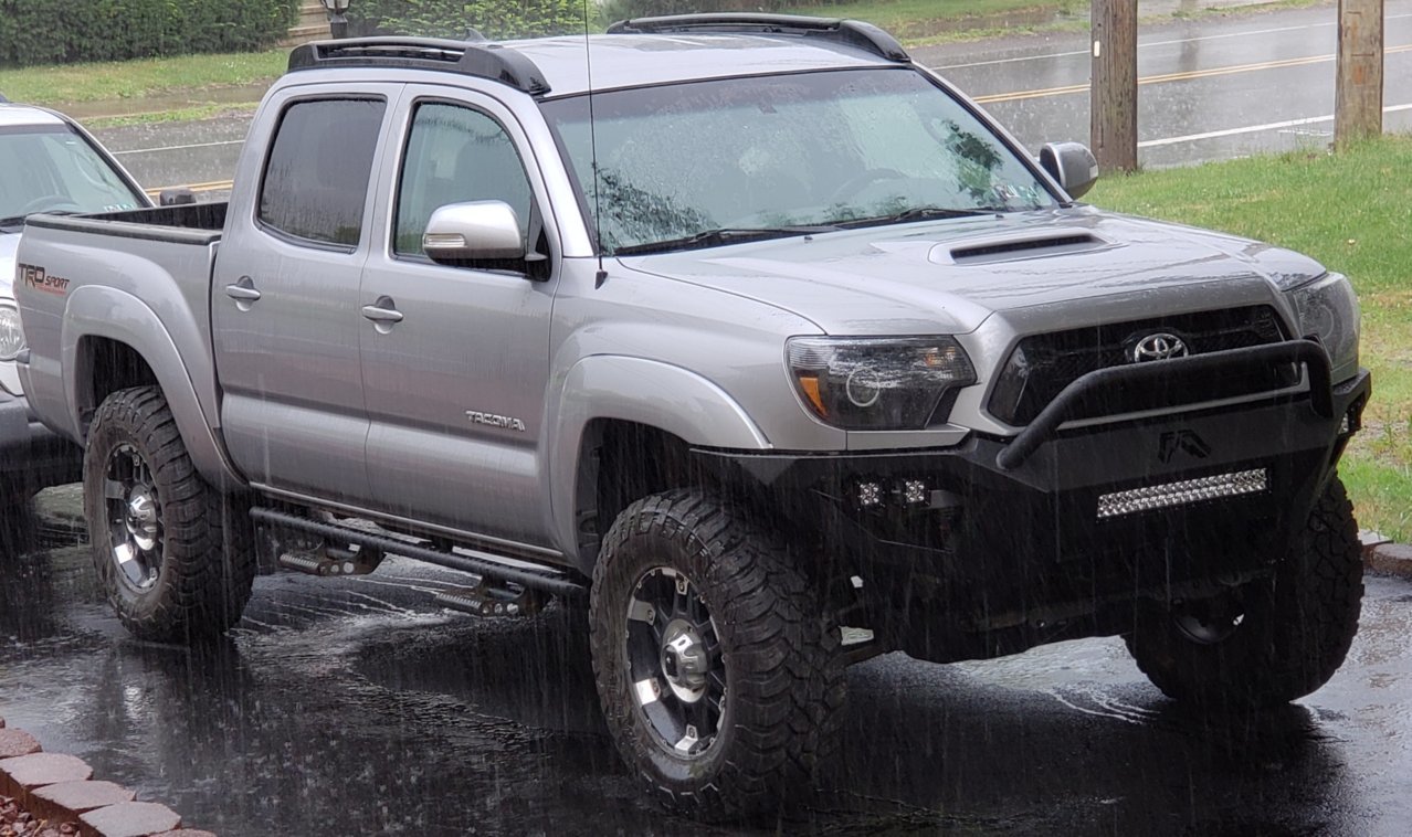

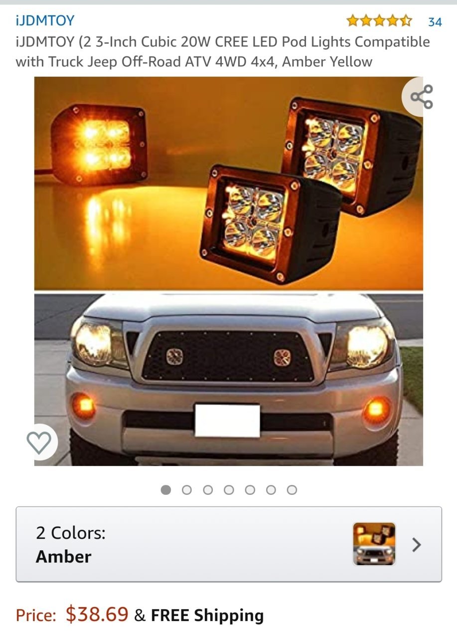

    Sweet. I have some nilights rightnow on mine, those kinda suck. I'm digging how you have 2 pods on each side. Nice I may just have to match, it looks goo .

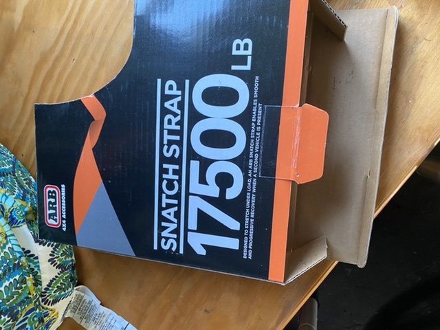

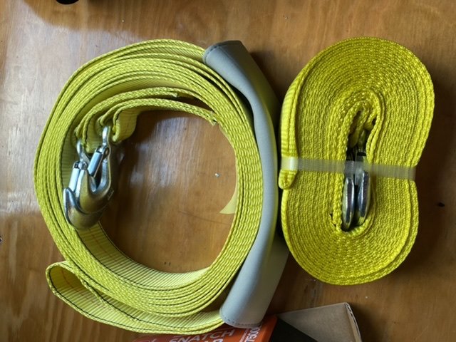

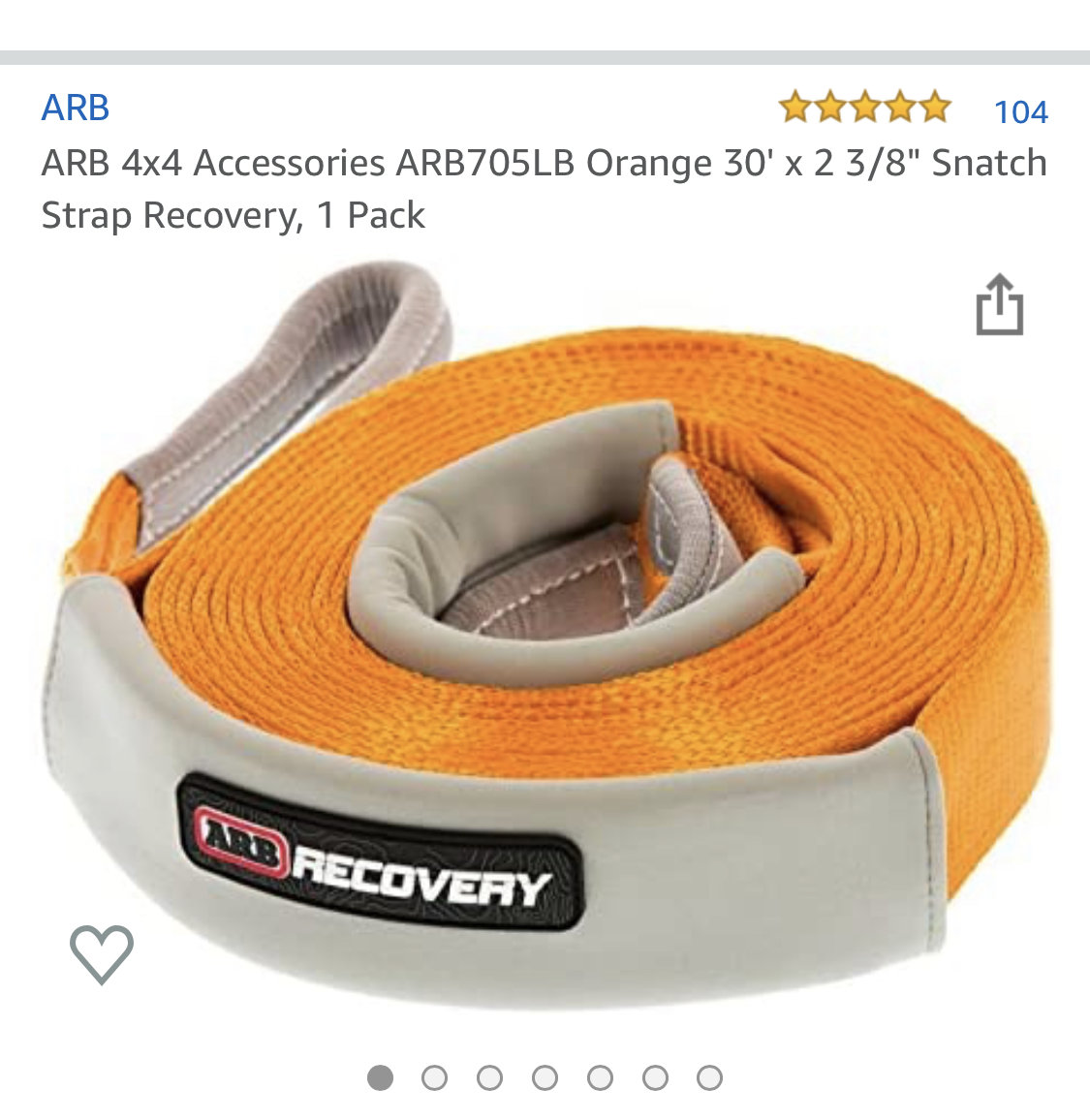

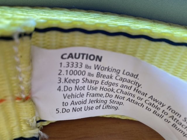

    Ordered an ARB snatch strap from Amazon. Got the right box with the wrong item! :mad:
    it’s not just a scam. It’s fucking dangerous. Whatever company sent them like that should be ashamed.
    Could you imaging if I didn’t know better and used the strap that has about 1/2 the breaking strength and a metal hook on each end to recover myself or someone else and have that thing snap.
    ordered this
    Got the right box
    But the wrong straps

    I know other people on TW recommended this company: https://www.oznium.com/
    That's where I bought them from, good prices and quality.

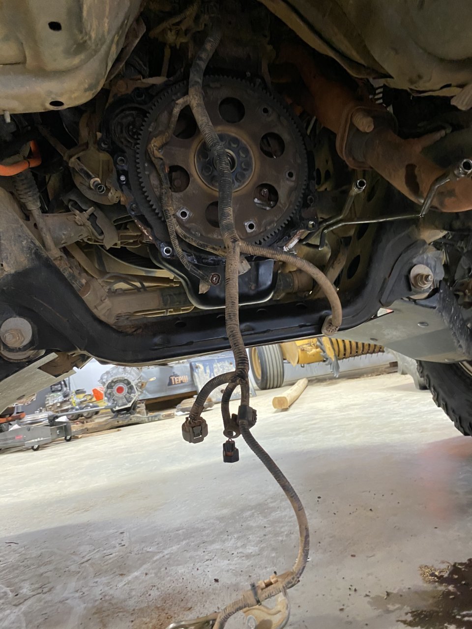

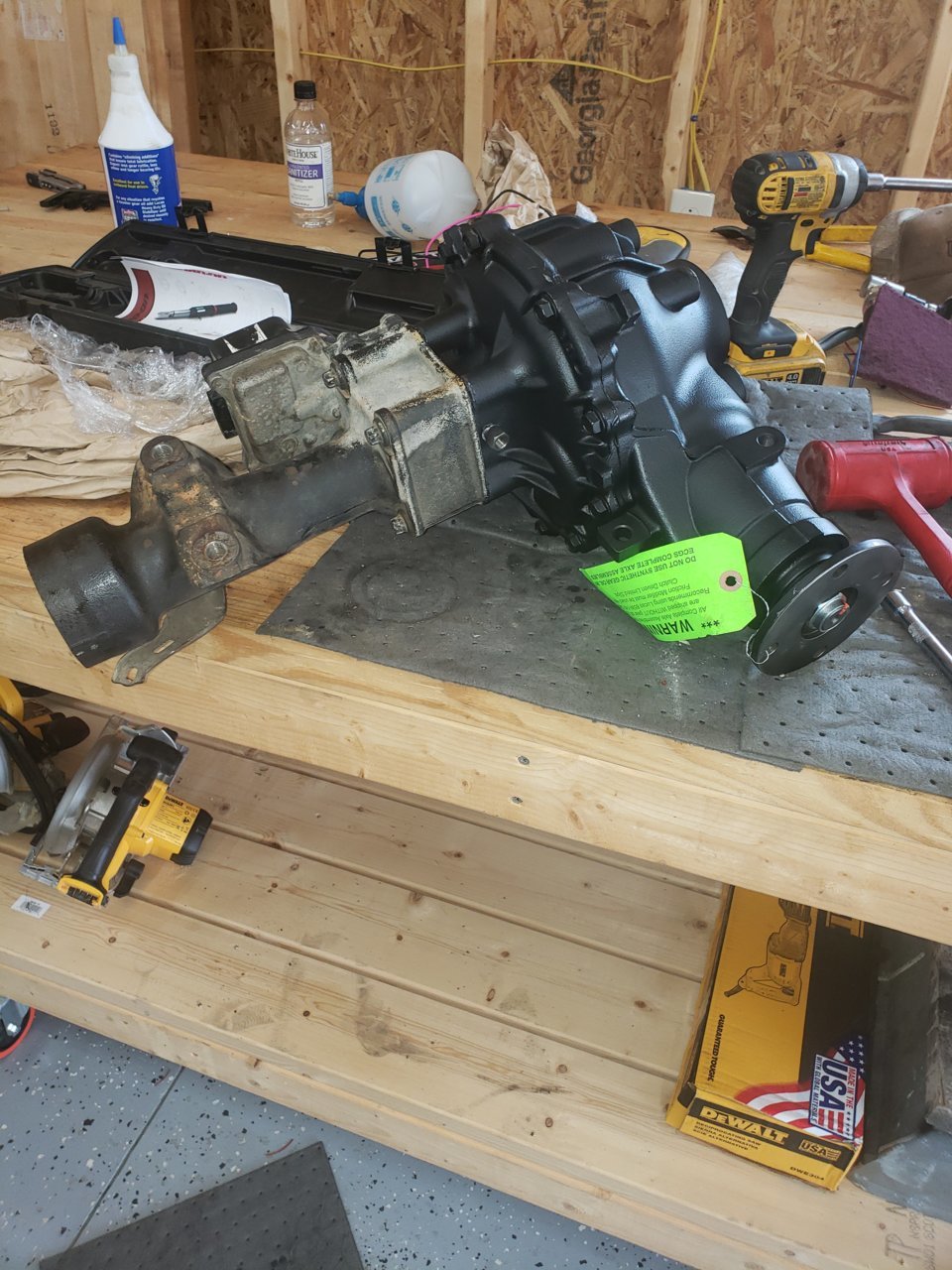

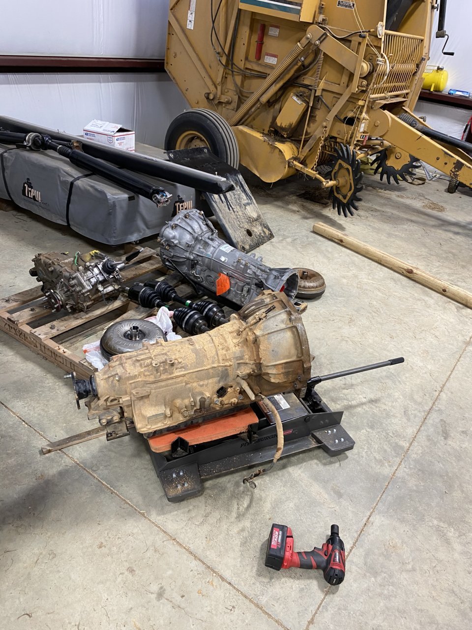

    1st of a 3 weekend project. Pulled my trans for the start of my 4x4 conversion with fj tcase arb lockers and 5.29 gears! Fun stuff! Can’t wait to get it all back together!

    Thanks! Yeah, I have the bar and outside pods wired together. Fogs are independent.

    That's a big project, nice looking rig too, I'm sure you're going to appreciate that 4x4!

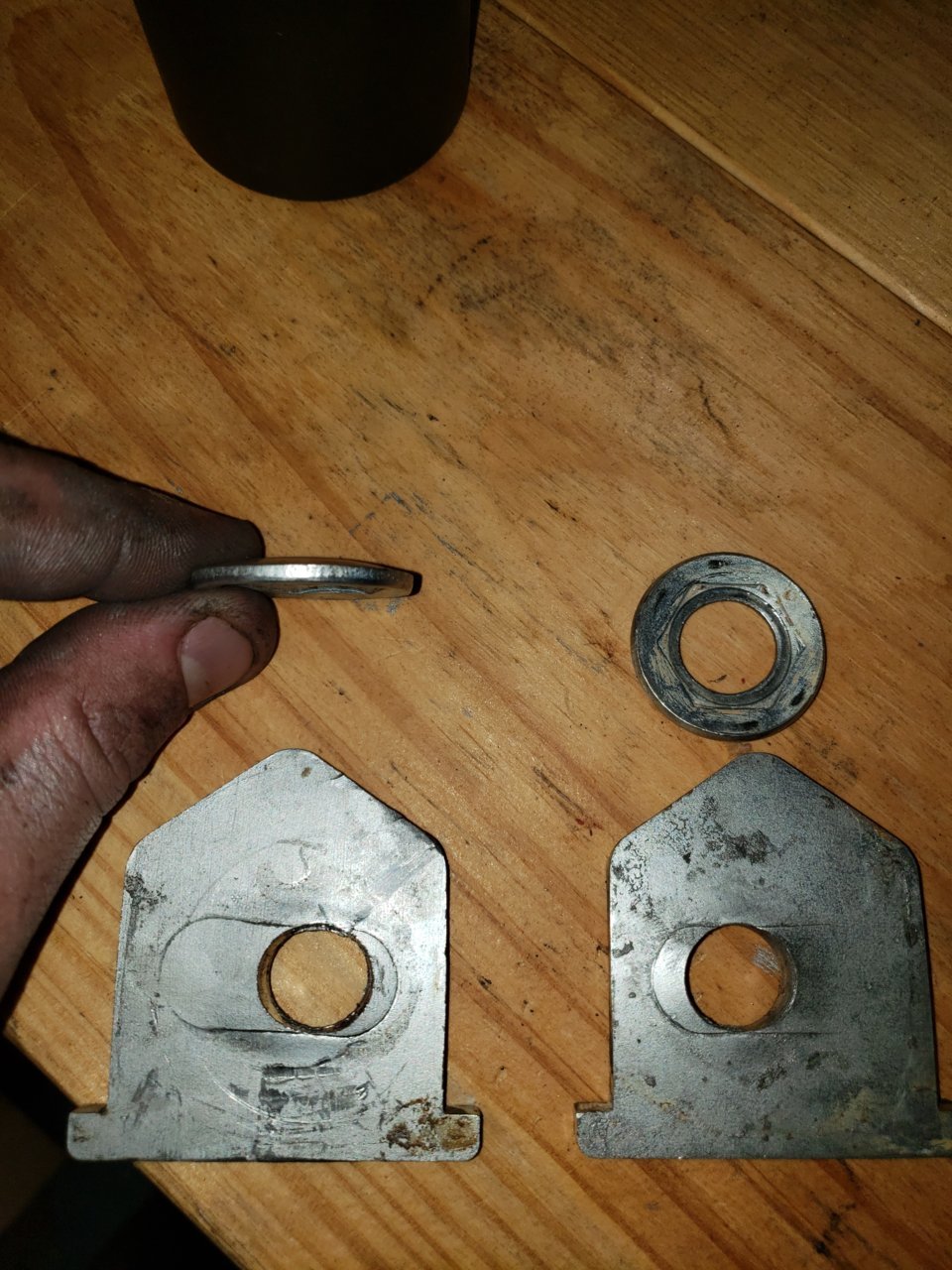

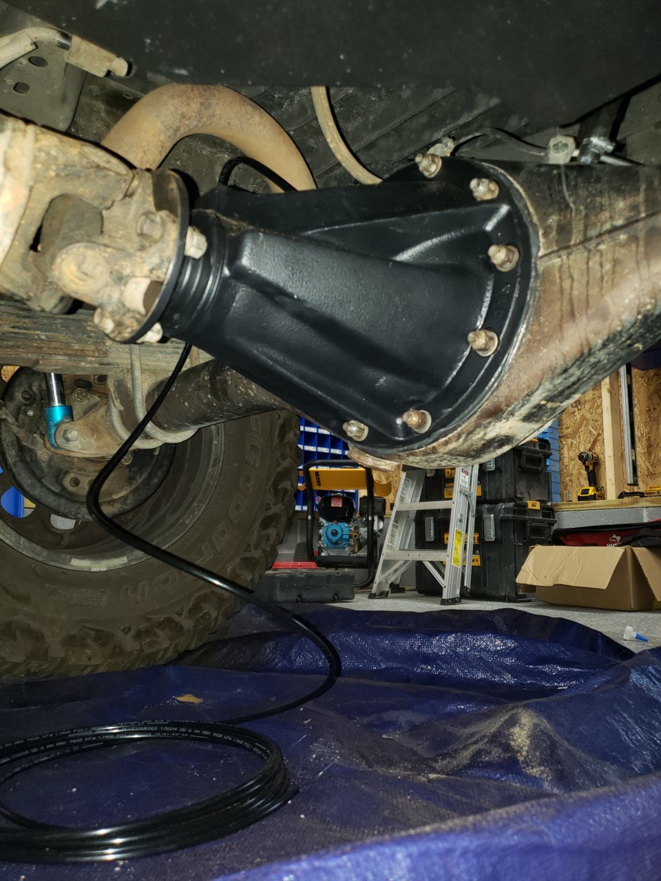

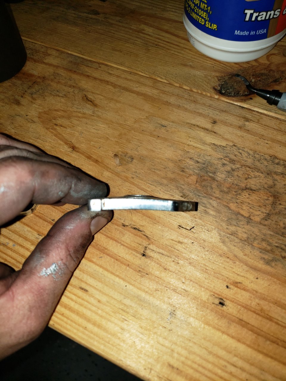

    Swapped in some ECGS goodies.
    4.56 with ARB lockers front and rear. Did the rear axle breather mod to the taillight. Replaced all the axle seals. Gravity bled the brakes. Replaced the rear brakes.
    Found an issue with the Taco Tabs I installed earlier this year. Gotta get a replacement set from Poly Performance. Only the driver side caster tabs are like this.
    Slightly collapsed on themselves o_O. The bushing washers were bent as well.

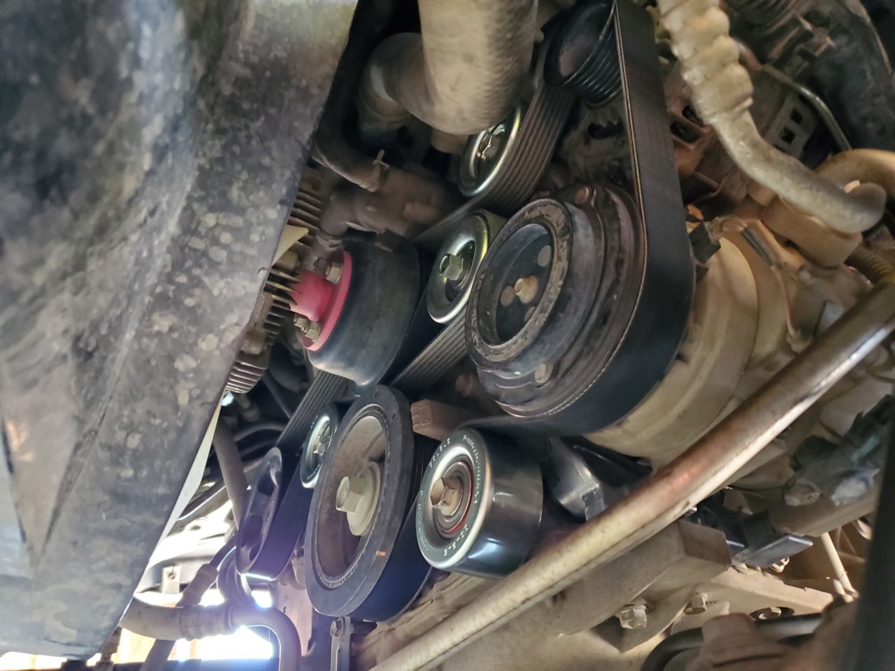

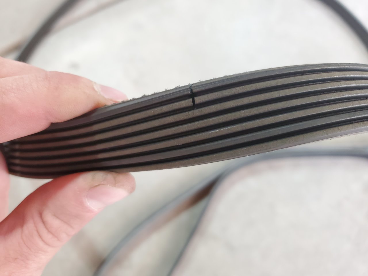

    Replaced my serpentine belt and all the pulleys, the belt tensioner assembly took a bit to install. Truck runs smoother and quieter now.

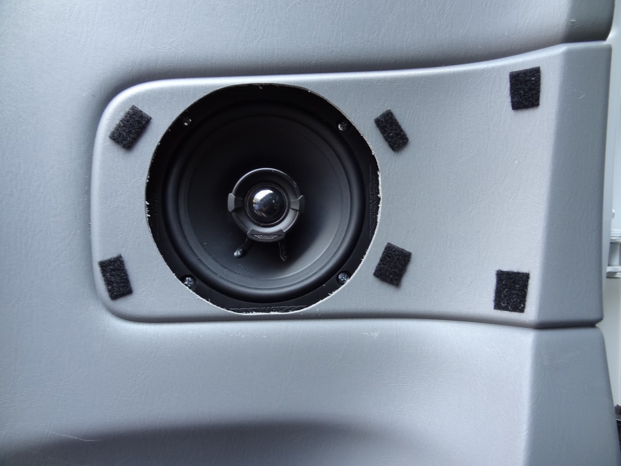

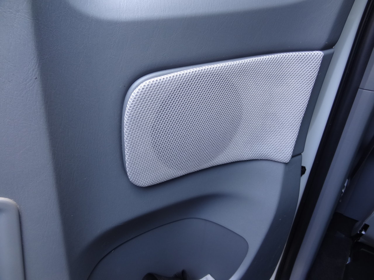

    Idk if your has it or not being mine is a 2015 as well but if you take off the door panel ot has a spot for speakers. Mine is a base model

    Thanks man! Yea I’ve been researching and planning for over a year!
