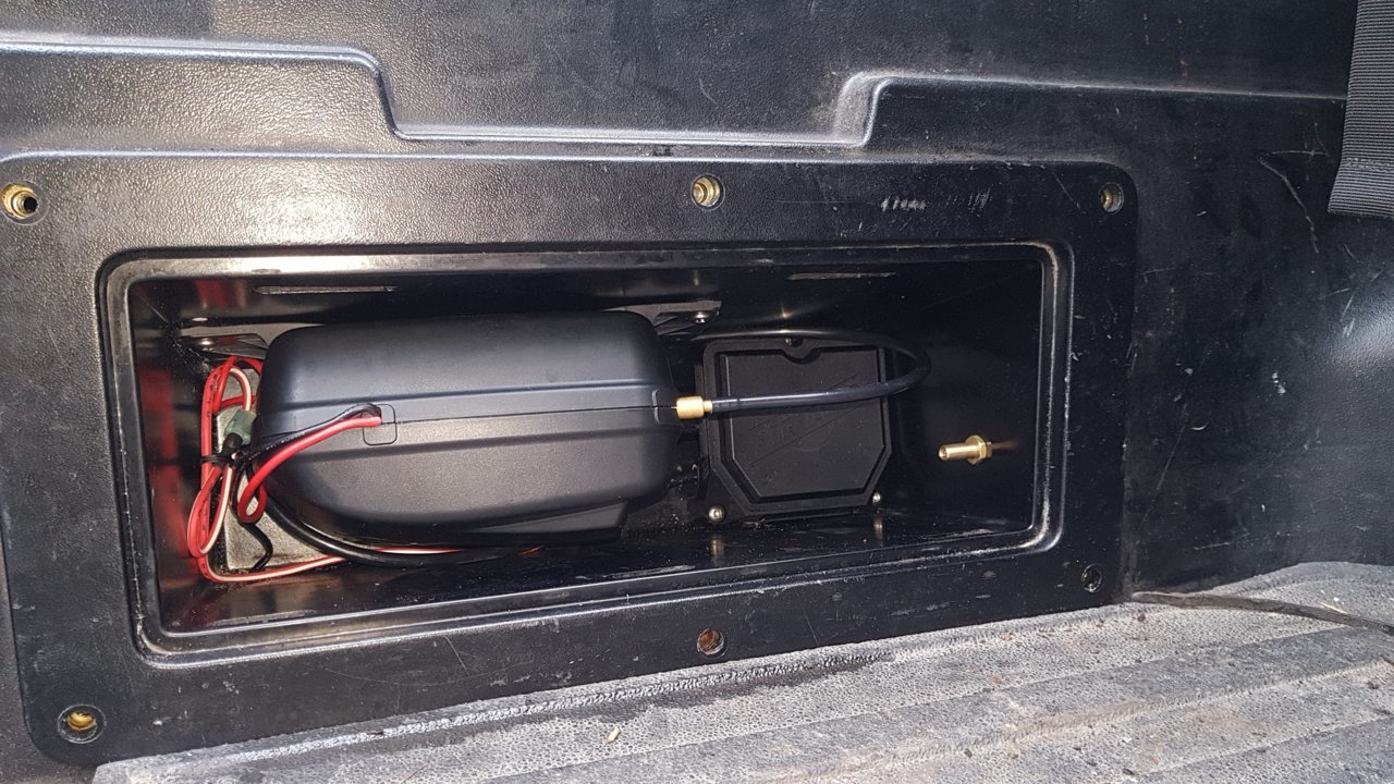

    I installed some bags and the wirelessone kit into my 08. Even though i have the leaf spring recall replacement I still found the ride sat low even with modest weight. The wirelessone hardware fit in the rear cubby and I can controll the ride from my phone or remote and there was no need to wire anything in the cab.

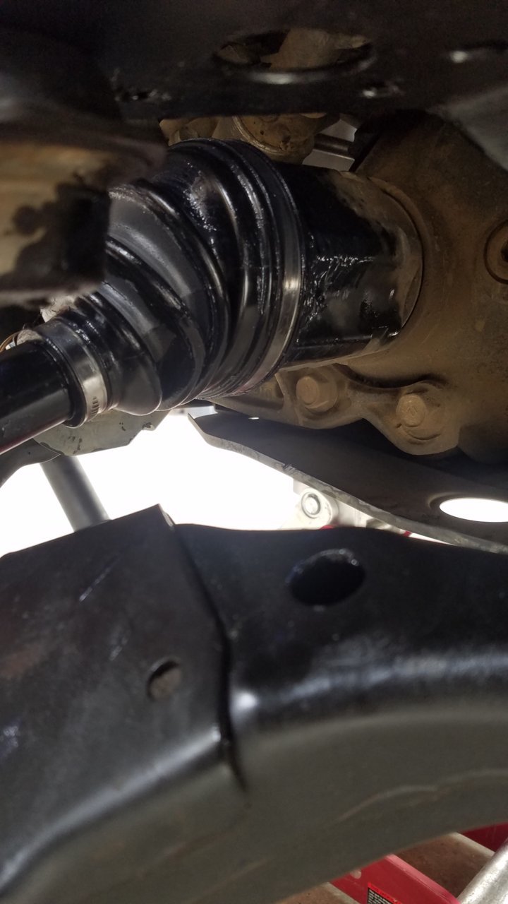

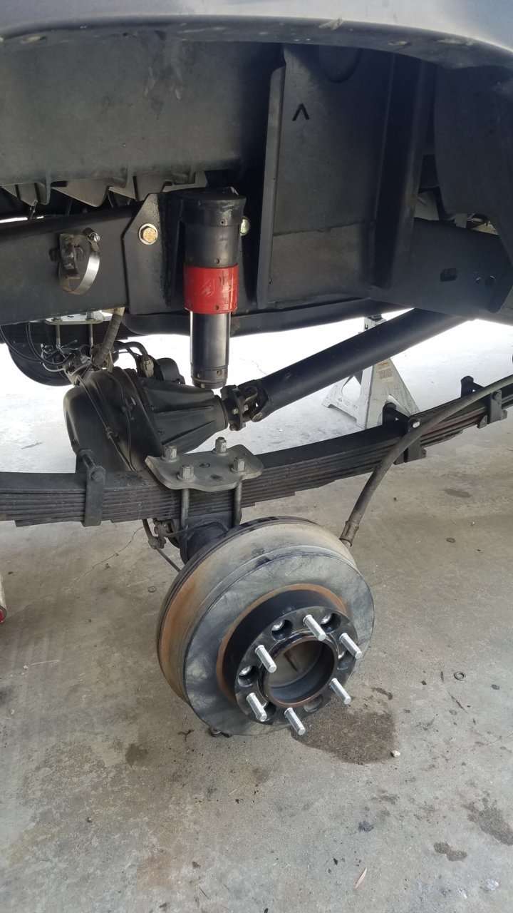

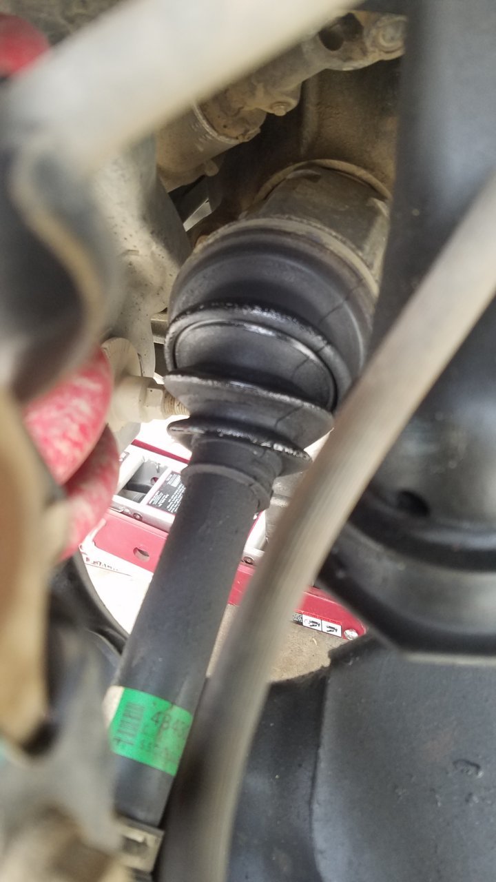

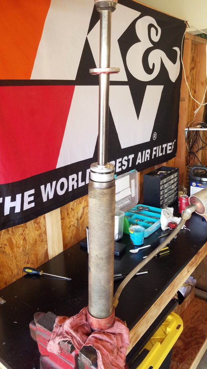

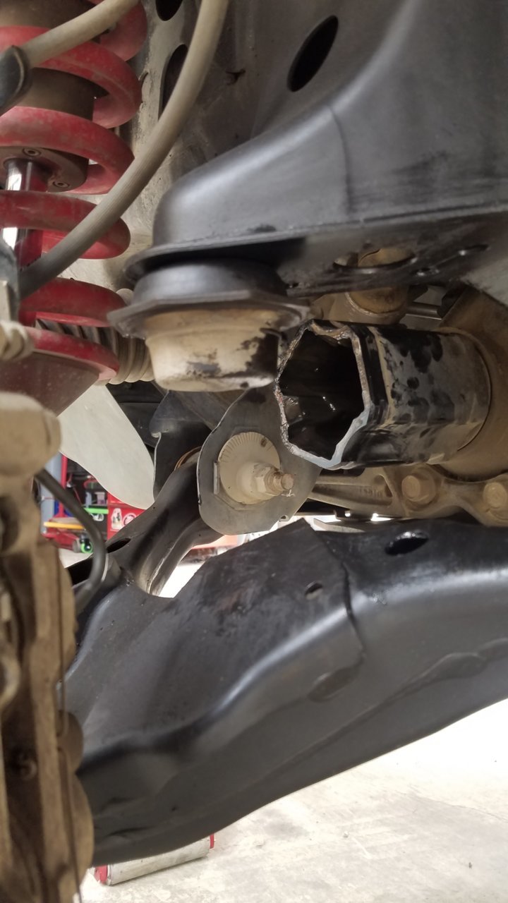

    Had a big day yesterday. Replaced my torn CV boot, gonna hold off on the others for now, they all look good. Did it without taking the axle out of the diff, just pulled apart the inner CV and left the cup side in the diff. Then did some tuning on my rear shocks to lighten them up a bit. Still stiffer than I'd like so will need to pull them apart again and either go down another step on the compression/rebound or do a flutter stack. Also looking at getting some lighter weight oil for them since I only have one more step available to go lighter. The joys of living the race parts life. :anonymous:

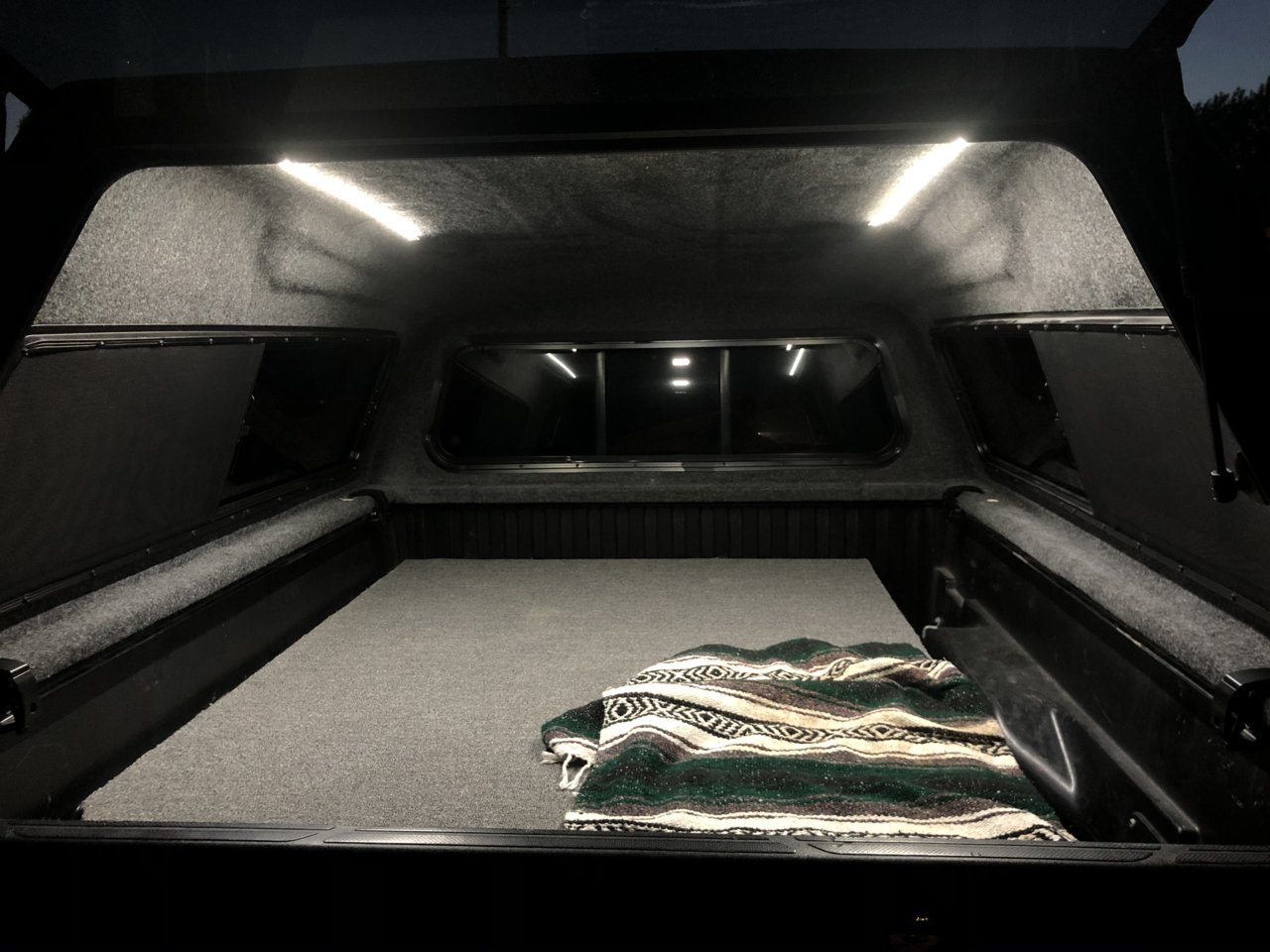

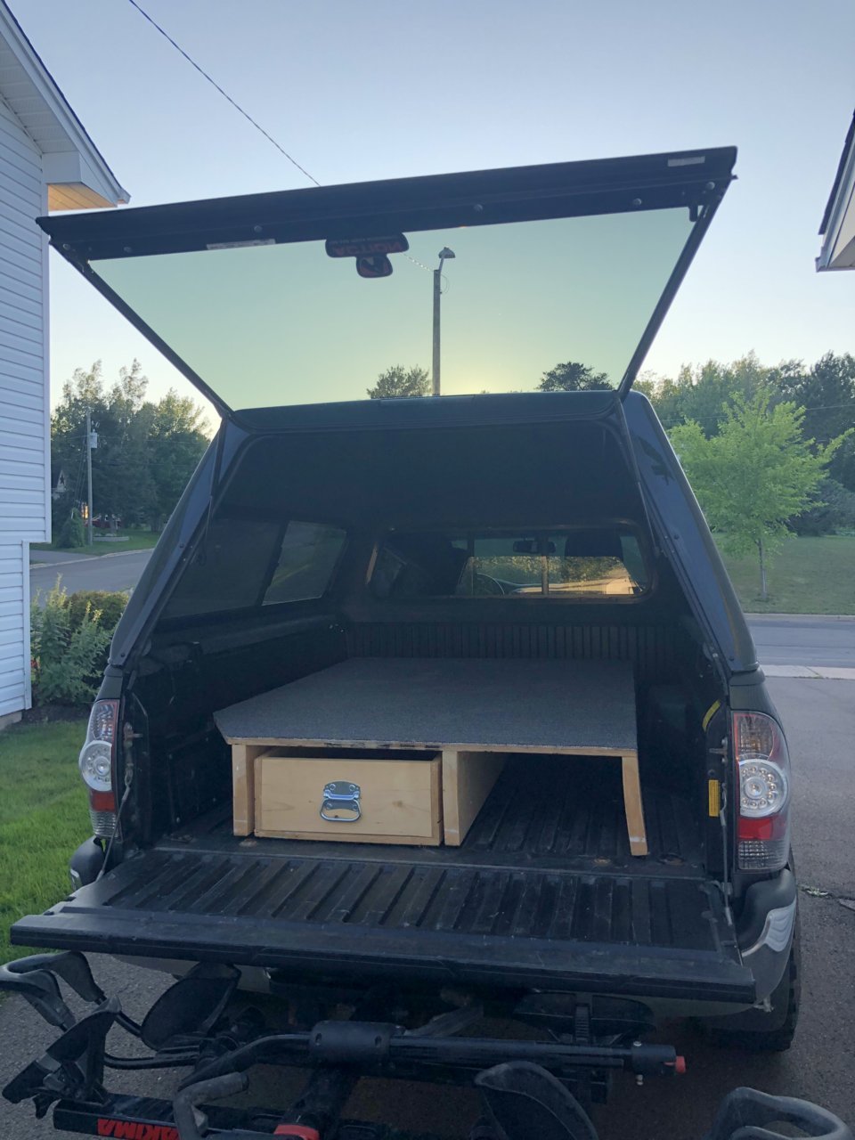

    Got a new mid-rise cap installed, put a layer of carpeting on top of the camper deck I built, new drawer hardware and wired in some led light strips. Pretty stoked how it’s turning out!

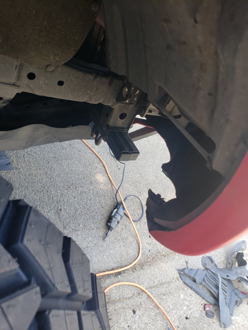

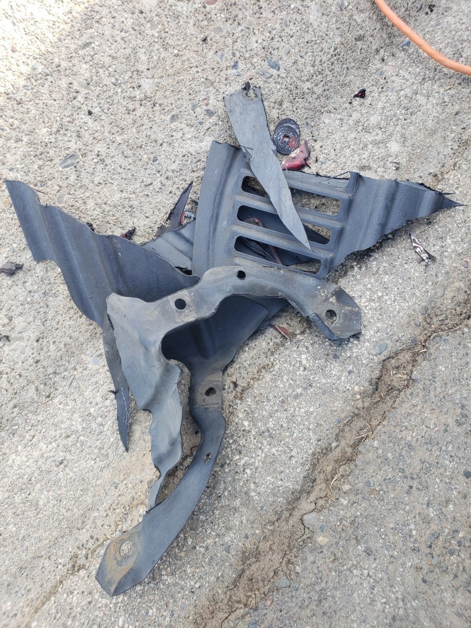

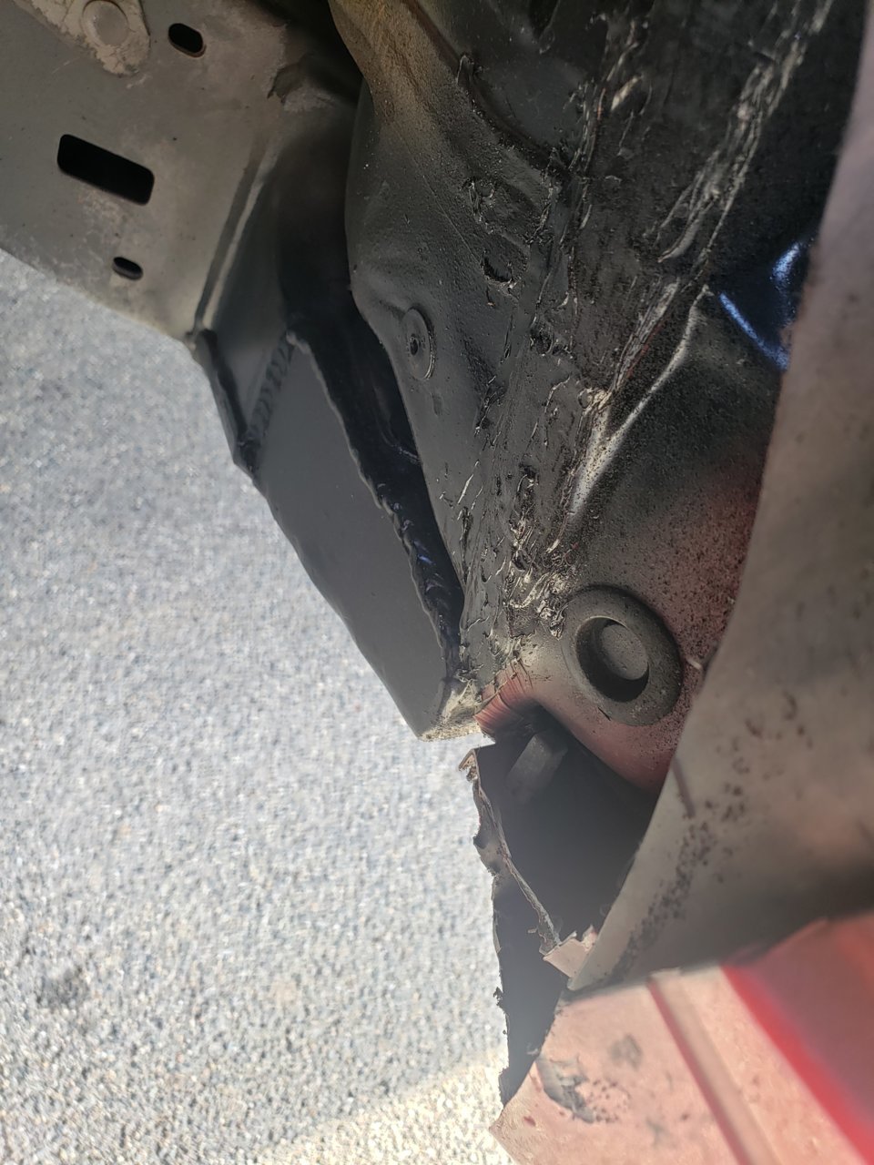

    Tires mounted and fenders trimmed:
    Rubble
    Front and rear trimming
    Finished product

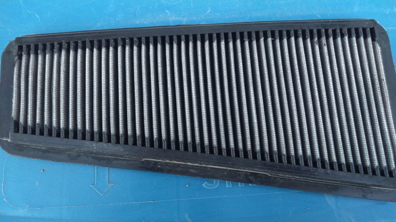

    Cleaned my K&N. All that shit to the left came out of it. This probably has something to do with my recent noticeable dip in power and fuel economy! It only has about 5-6k miles on it. That's what pulling your inner fenders and wheeling the shit out of it does for you. Time for a reroute of the intake or some sort of fix.
    After:

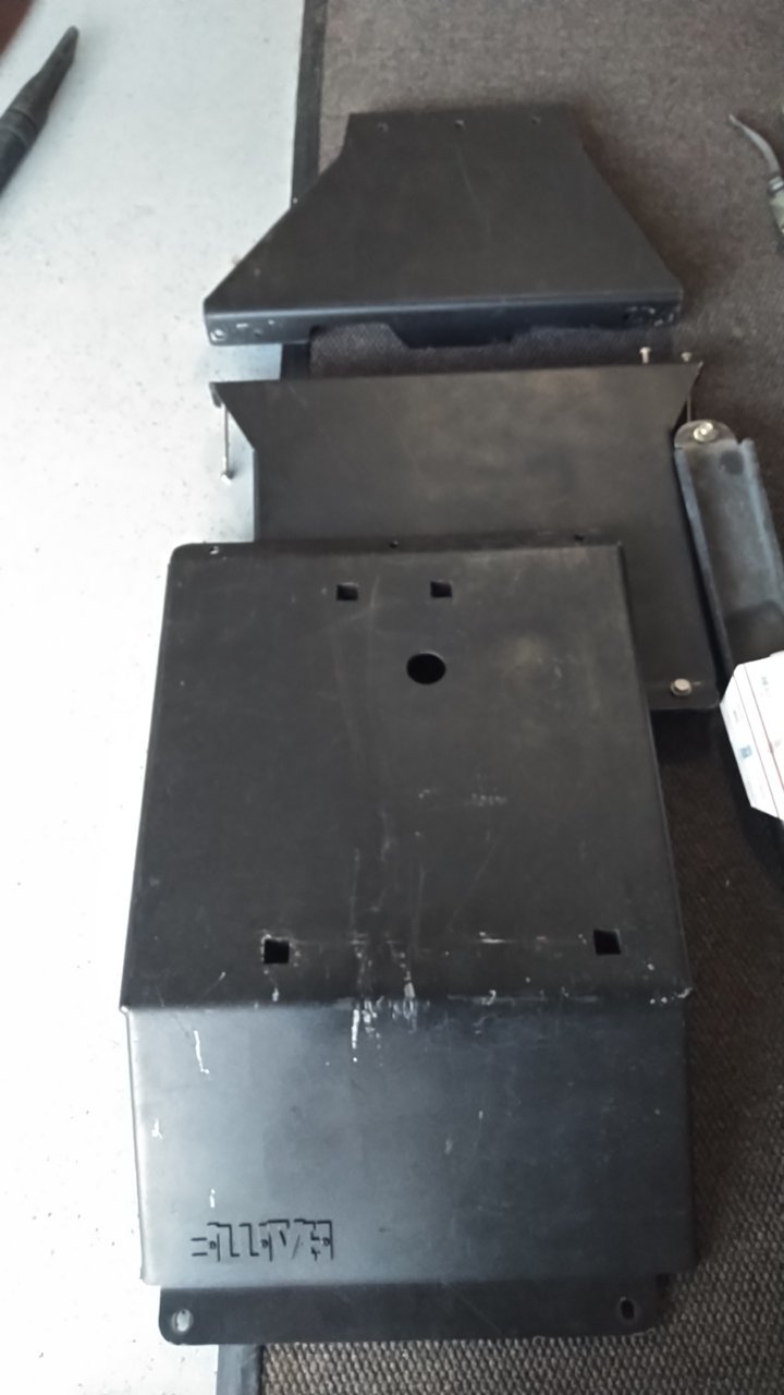

    Picked up a full set of BAMF skid plates from @Kidwidataco.
