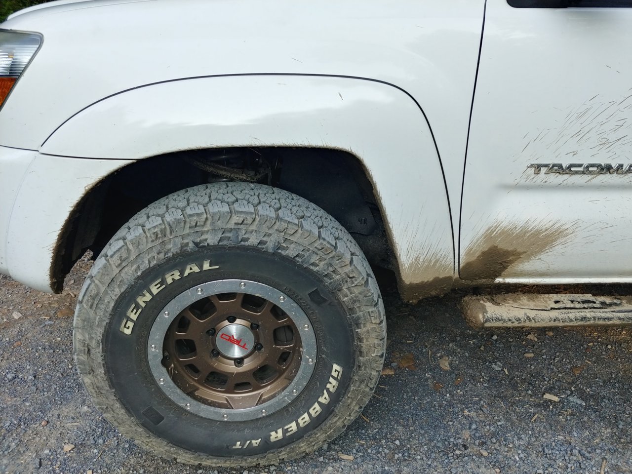

    Finally got some mud on her. Posted here last week about getting my BMC done. Got the invite from our neighbors to go camping on their property this weekend, so we shot some guns, rode some trails, and had a great time! Was itching to do ANYTHING offroad since I got the BMC, so I was lovin life.
    NO RUBS

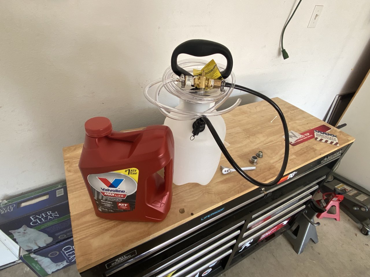

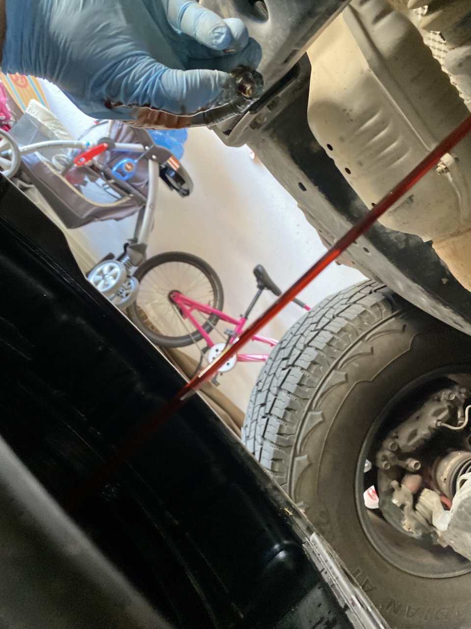

    Drain an fill on transmission this weekend.

    Love the sprayer set up as your pump. Any insight on the plumbing used from sprayer hose to clear tubing transition? Thanks a lot.

    Thanks Jim, it’s a really simple setup.
    1 gallon pump sprayer, cut off the nozzle, attached a 3/8 ball valve or needle valve will work, 5ft worth of 3/8 OD clear tube inner diameter is 1/4, along 2 small hose clamps where to valve meets the black hose and clear. Worked like a champ.

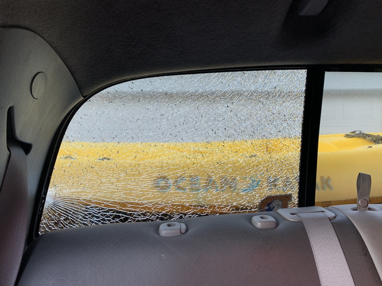

    I prepared myself for a first time rear window replacement last night.... Damn it!
