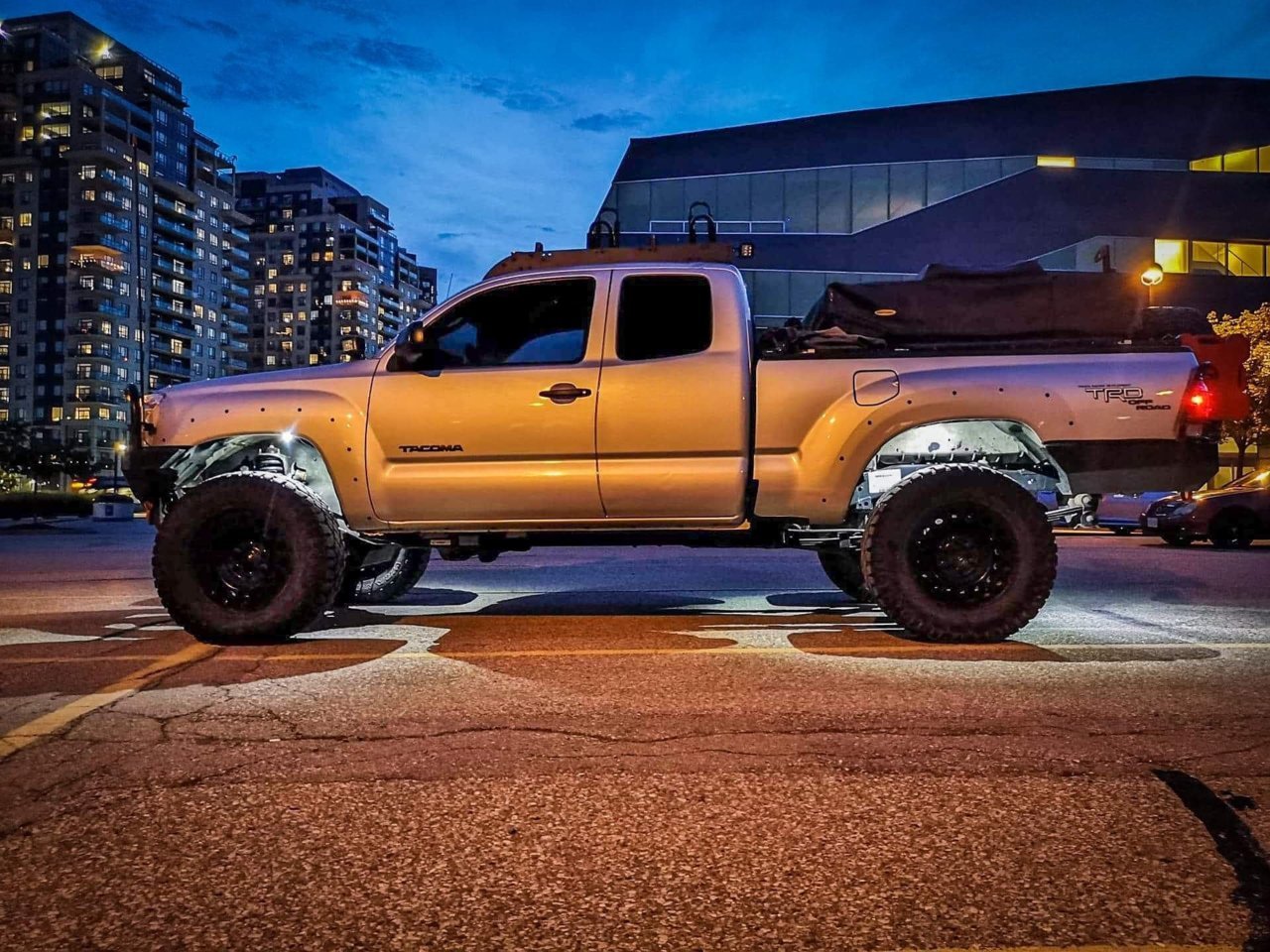

    Installed some rock lights

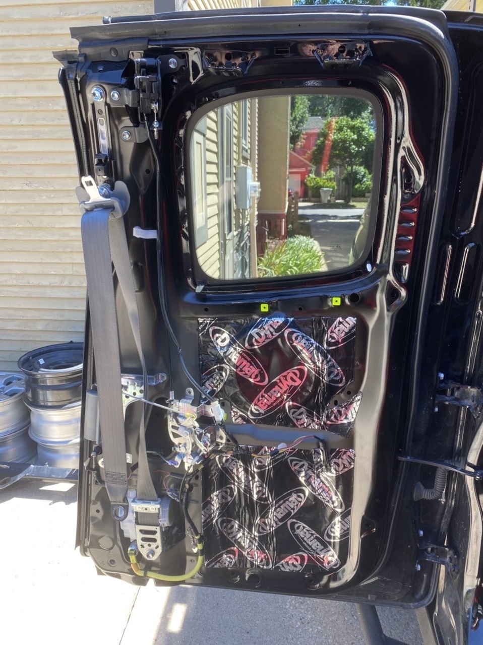

    Sound deadened the suicide doors today. Butyl rubber outer door skin and over the holes on the inside skin. Then mass loaded vinyl, then closed cell foam (not pictured)

    While you have everything opened up, you should run speaker wire and add speakers.

    I didn’t want rear speakers. I’ve got good front speakers in mind. But may hold off on those too to do suspension upgrades. :spending:
    I’m sound proofing cause this truck is so damn loud. Tomorrow is the floor and back wall

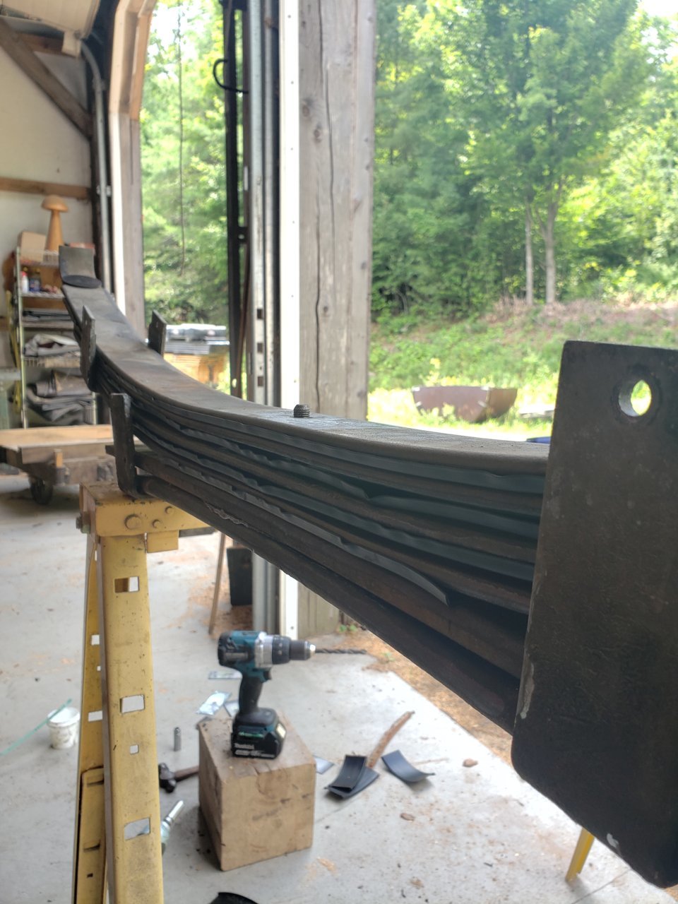

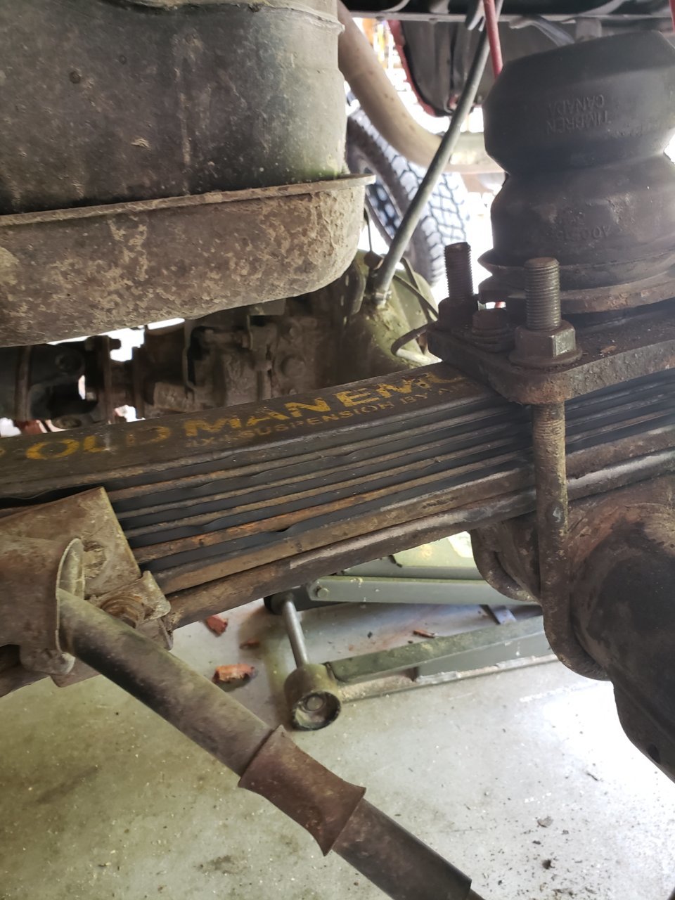

    Tore apart my OME HD Dakars leaf packs and wire brushed them, installed leaf isolators, new spacer discs, and installed dobinsons greasable shackle bolts in the rear. What a pain in the A$$. But the squeak is GONE. For now...

    Haven't even installed my HD Dakar pack yet and already thinking about the leaf "isolators" - but did you need a longer center bolt to make it all work?

    Probably going to do this when I add the HD leaf soon.

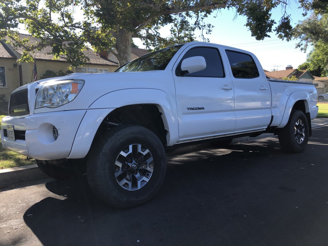

    New shoes today. BRIDGESTONE DUELER A/T REVO 3 - LT 275/65 R18 E
