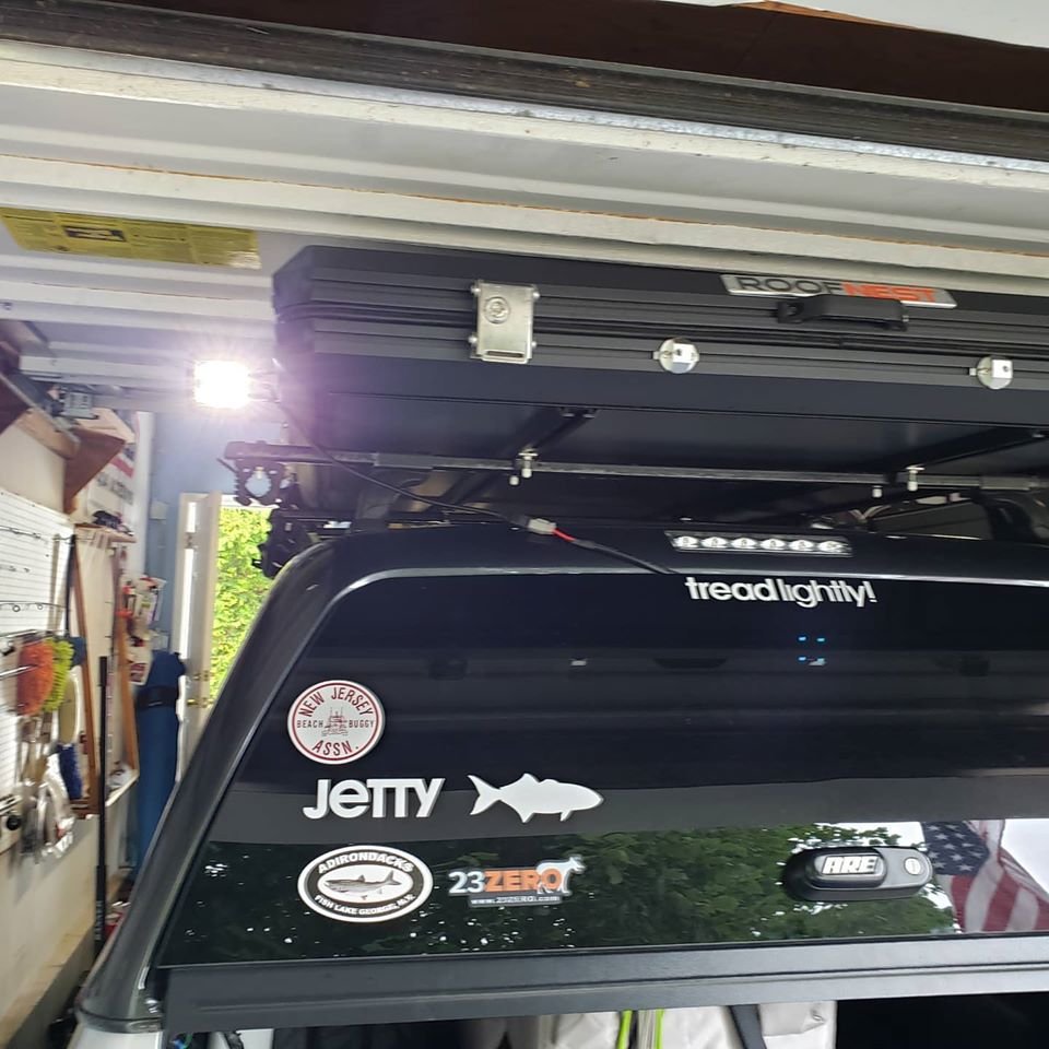

    Wired up the ROK40s from Lightforce. Drilled a hole right into the cap and siliconed around it to keep water out. Then ran the wires to a power source I have in the bed with a switch.

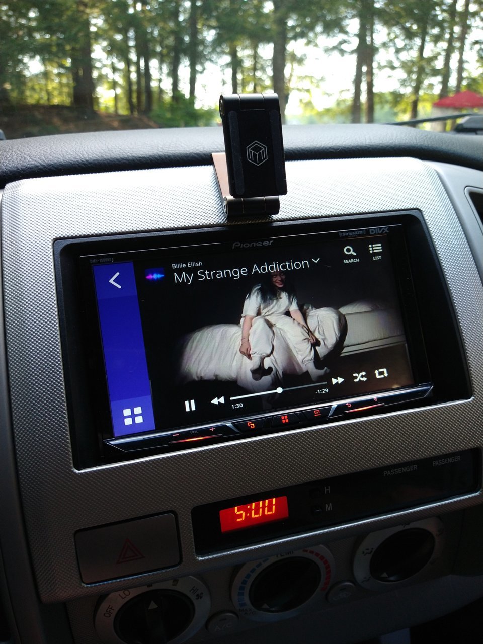

    Installed a new head unit. Now I've got gauges and fader control. The Maestro rr didn't get along to well with my old head unit so it was time for an upgrade.IMG_20200814_170127013.jpg

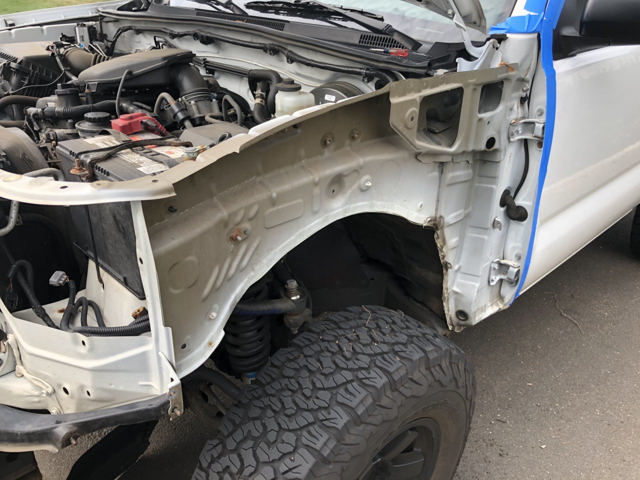

    I think I got dirty more than anything else thanks to the Fluid Film that I had applied.

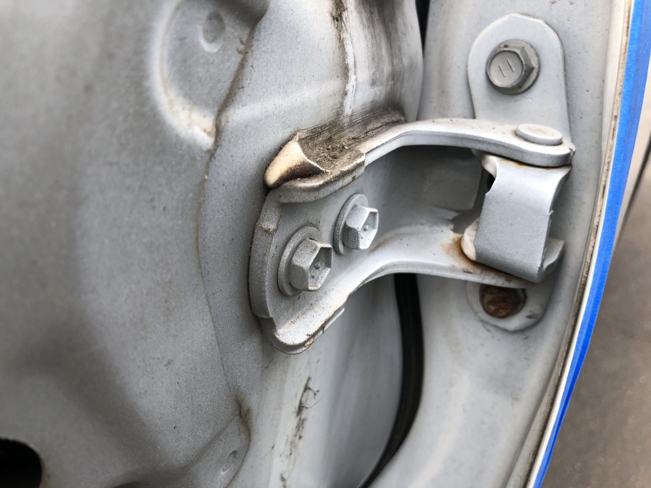

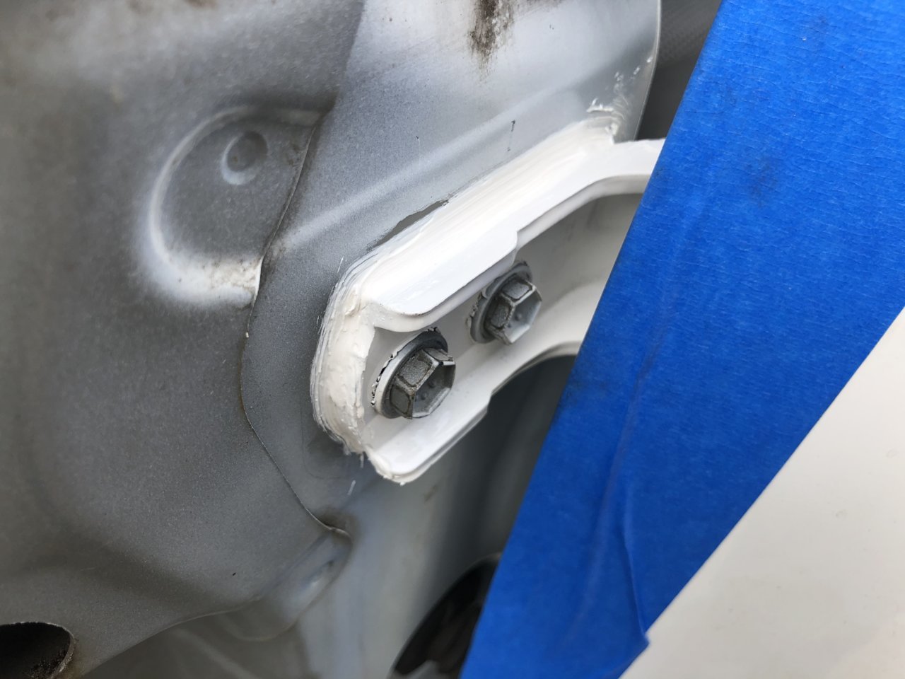

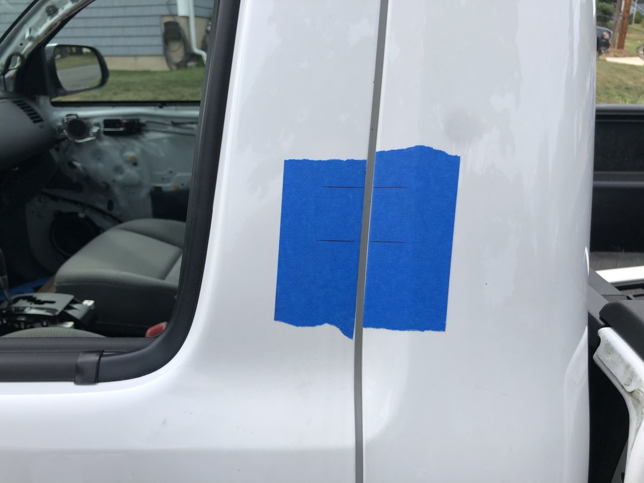

    I replaced my left door upper hinge. I've been trying to get this done right after I bought the truck, two years ago!
    I tried installing my Bushwacker flares but it seemed like they didn't want to fit. I'll try again at a later date.
    I ran the wires for my inverter install. The harness under the seat isn't 100% (still need a clip for the wire protector).
    The harness along the frame fit surprisingly well. There is one part that I need to bundle using zip ties.
    I may try and do more stuff tomorrow depending on the weather.

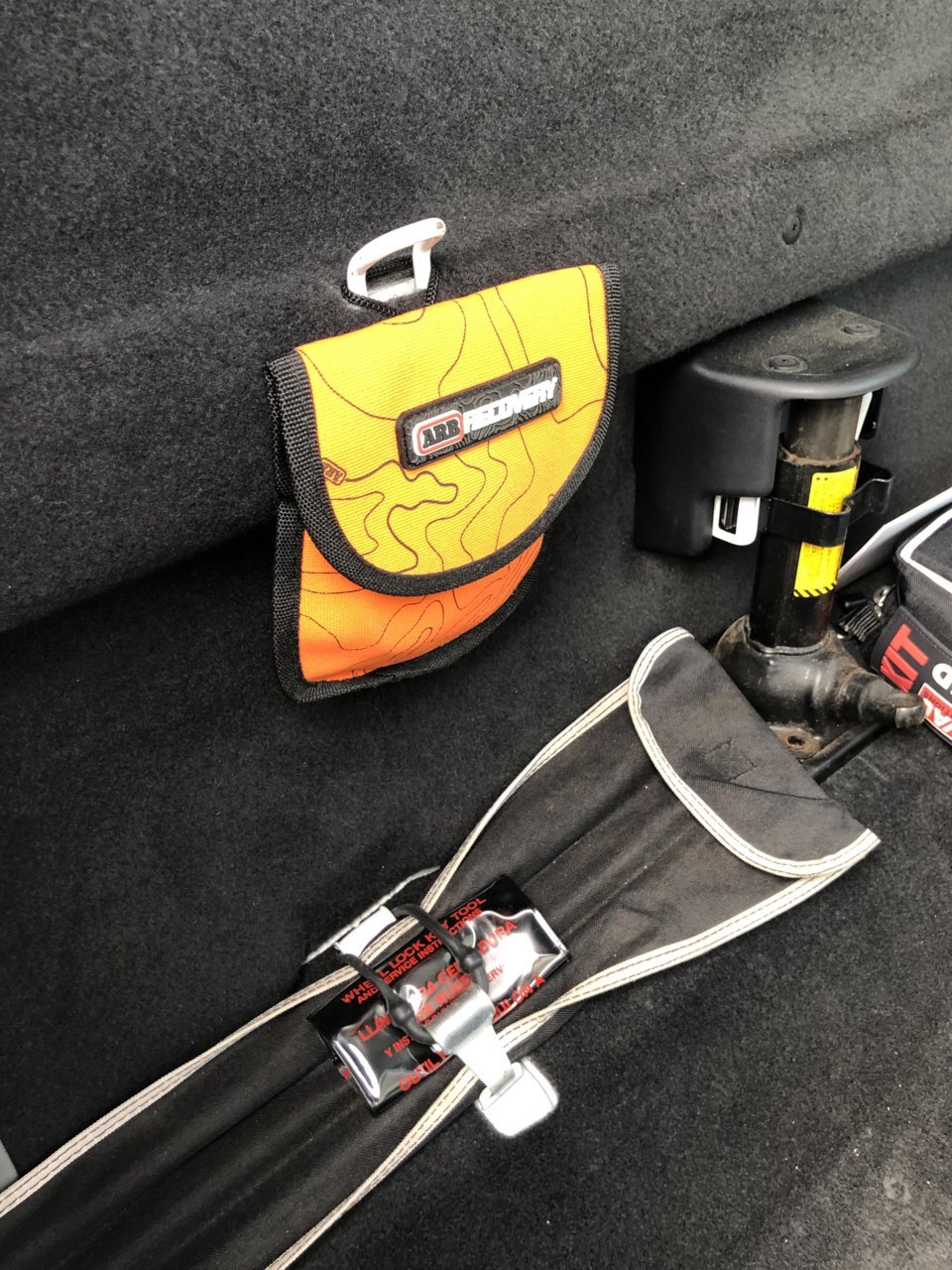

    I also found a use for the child seat tether.

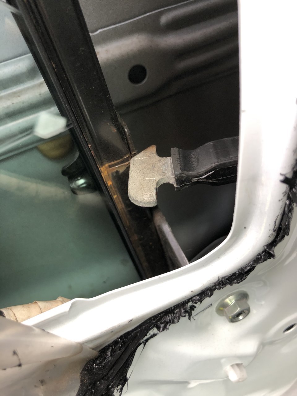

    I also found the source of a noise that has had me wondering where it was coming from. I thought it was the hinge because as you can see, the bushing was shot. I replaced the hinge because the door would drop (when opened) ever so slightly and there was a rubbing noise.
    So after I installed the new hinge I checked the operation of the door and I still had the noise. Upon further inspection I found that the door check is rubbing against the window run inside the door. I do not know why, but it's something I'll have to look at.

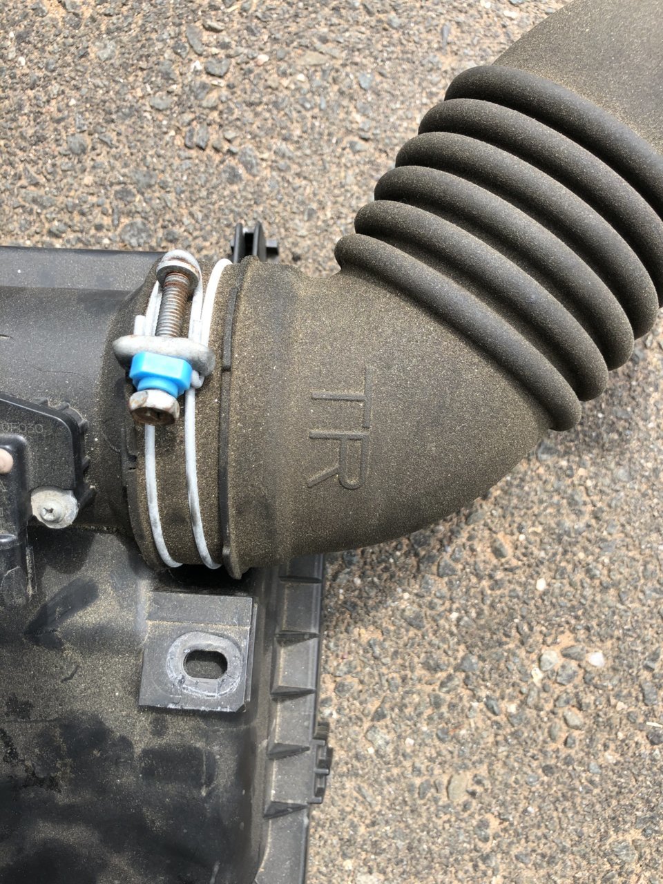

    "TRD" or "TR"?

    ^^ This ^^ Your truck is "SAC" = Sick as Cr*p
