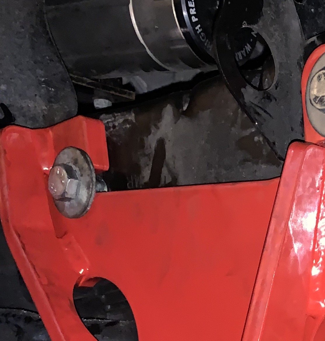

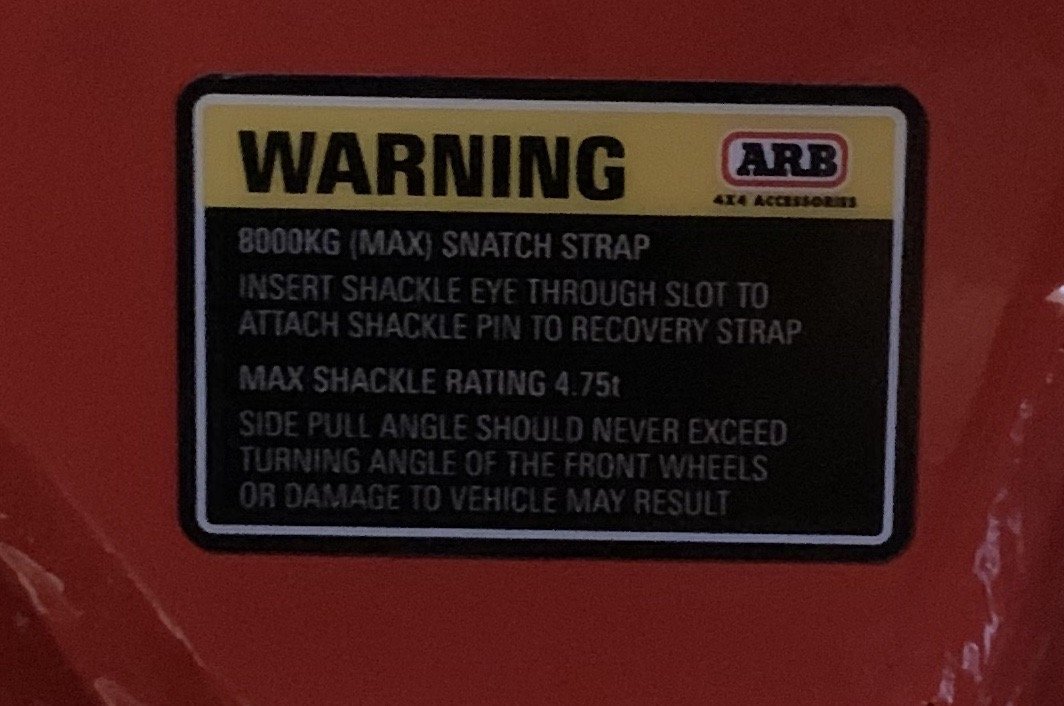

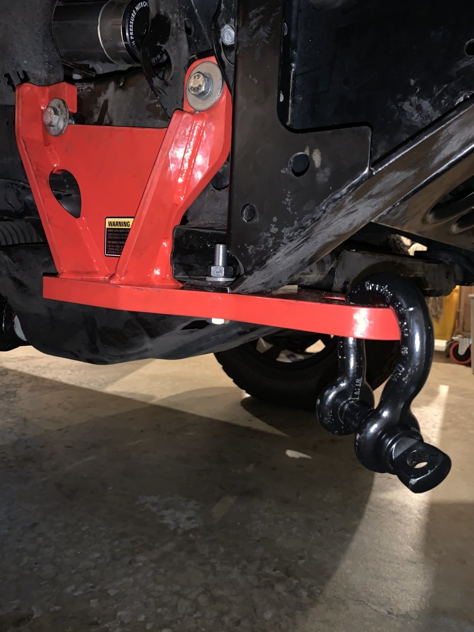

    The website, packaging, instructions, box, etc. say 2016 forward, but it lines up fine. You are required to ream out a frame hole for the rear bolt and will need an 18mm bit, also...
    good luck with the nut ‘inside’ the frame.
    Beefy (five 12mm bolts through two frame members and the main plate is >7/8” thick), good fit, dumb instructions, one fastener that will make a preacher curse.
    (That’s a WLL 4.75t bow shackle)
    The rear bolt is ‘hooked’ through the vertical plate. This appears to be intended to give a solid attachment for this fastener for pulling, but would ‘unhook’ in a forward collision, preserving the crumple zone in the frame rail at this location (the little ‘accordion dimples’ in the frame seen below)
