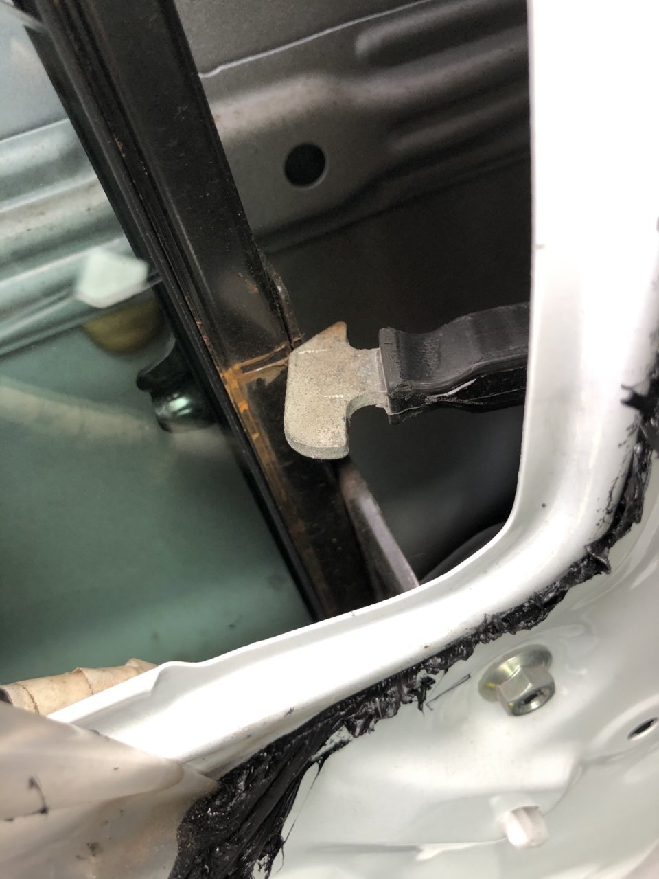

    I finally ordered a part that I've been wanting ever since I bought this truck... a door check :rofl:
    I'm getting a creaking noise when the L/F door is opened/closed. I thought it was the upper hinge because it was bad, so I put in a new hinge and the noise was still there.
    Upon further inspection, the door check is rubbing against the window run channel.
    I ordered a new door check, window run channel, GPS and XM antennas, a couple wire loom clamps, a L/F door wire harness and I think that's it.

    You can see the end of the door check here and where it is rubbing on the window run channel.

    Thanks for the reply.....so you can only hear this with your door open?

    That's odd. o_O Has the door ever been worked on before? In 40+ years of doing bodywork, the only times I've seen that issue is when the check strap is curved and has been installed upside down. The curve let's it move away from the glass channel as it comes into the door. Isuppose it could be just plain worn out

    With the door closed, I can take the check and move it from side to side so I think the plastic bushing inside is worn. Doesn't look like the door has ever been apart but the upper hinge was bad (I already replaced that) so I'm thinking it's from excessive use by the PO.

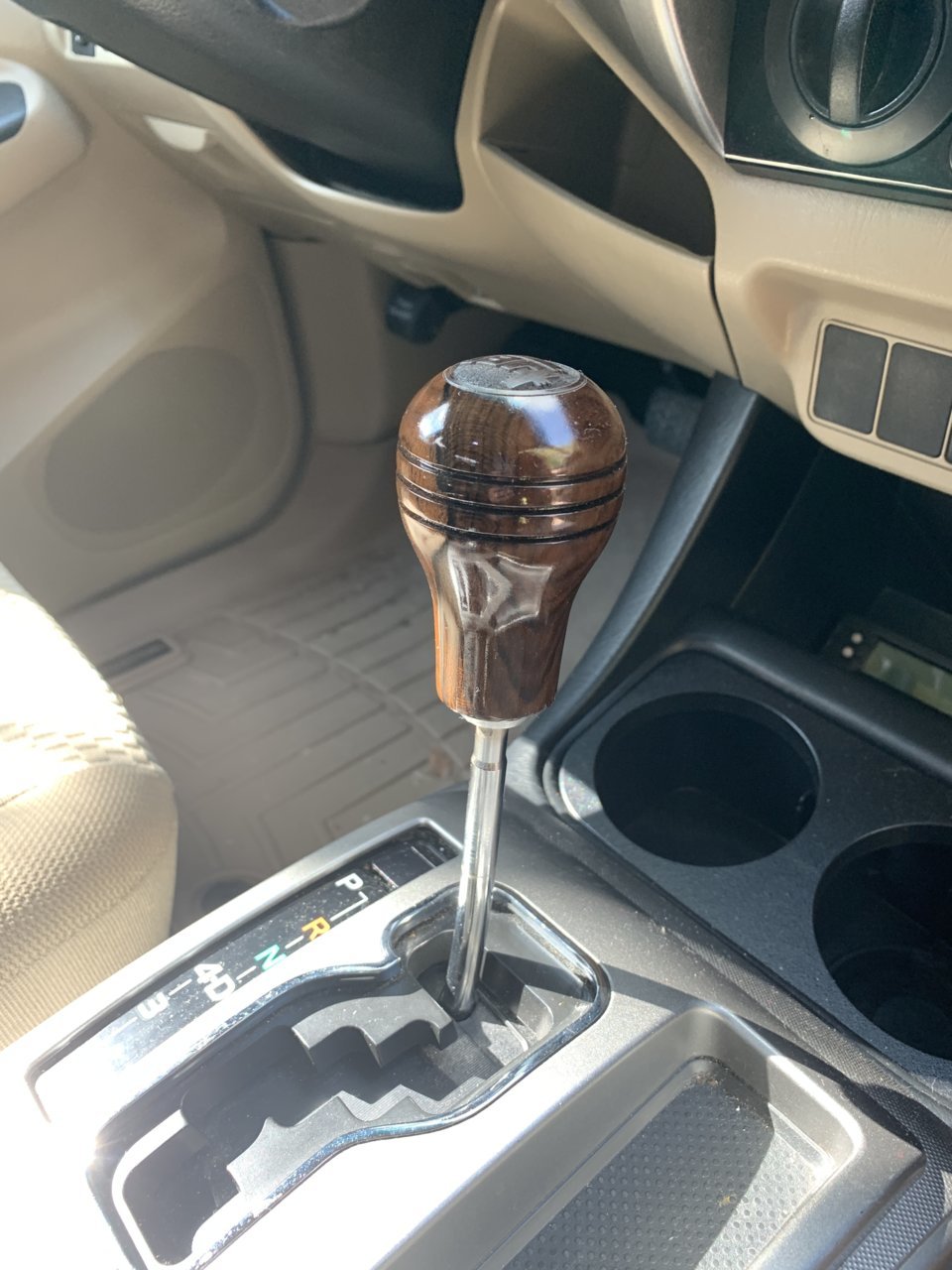

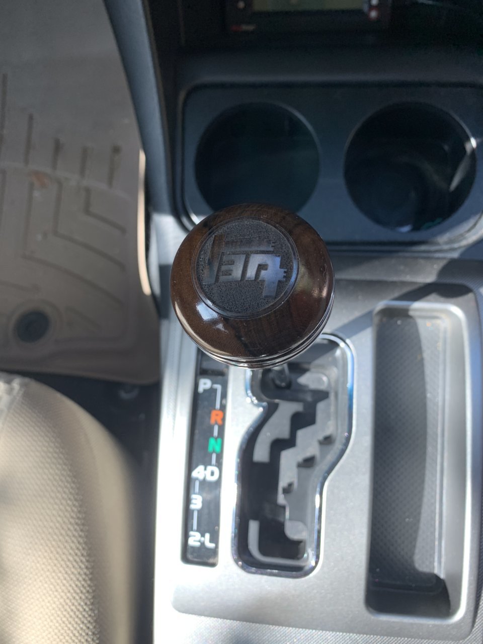

    New shift knob. It’s the little things sometimes, and it sure is pretty in person.

    No, when I open or close the door and it's at the position shown (open about 6") is when I hear the noise.
    The door check moves inside the door causing the noise.

    Well that's pretty. You make that?

    Not me. I do some woodworking but I don’t have these skills or equipment. http://www.nostalgic-grains.com/
