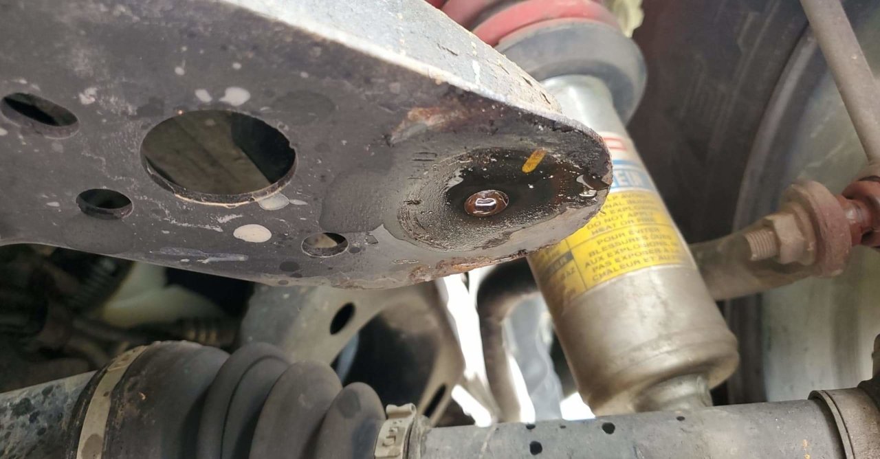

    Planned on changing out the front bump stops to energy suspension bumps. Got the drivers side changed out and the bolt snapped on the passenger.....

    Same thing happened to me.....i had to drill the piece out, then add a long bolt to the bumpstop and put a nylok nut up in there. Took me about 2 freaking hours.

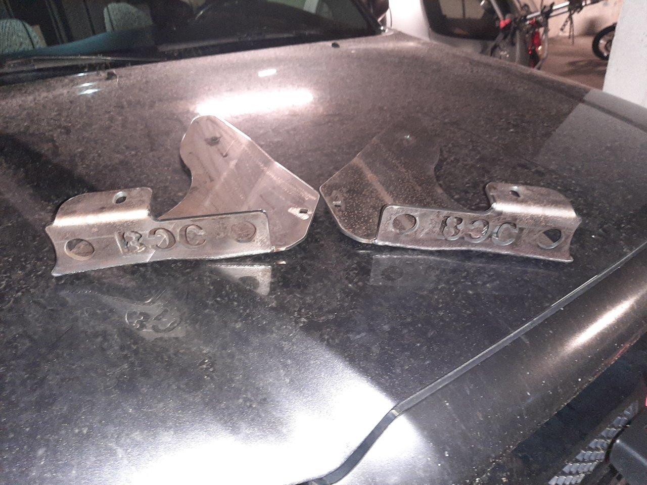

    Picked up some lca skids from my favorite off road shop in bc.

    Mine broke off when I did the lift. I haven't had the time to fix it (running around with no front bump stops). I need to replace the LCA's so that might be the perfect time to do them.
