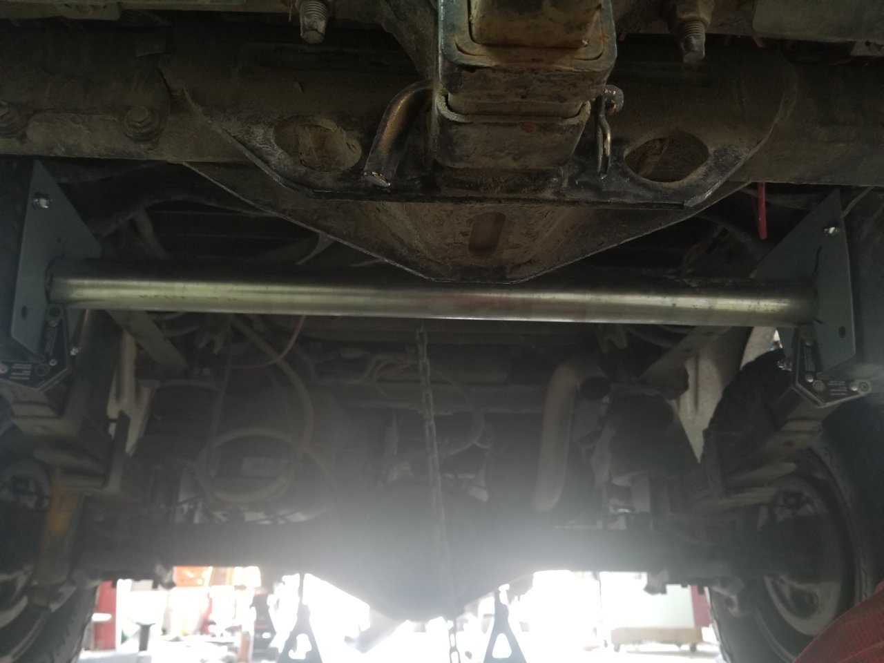

    worked on the hanger crossbar. excited to see how much of a difference this makes but unfortunately the truck probably won't see pavement for another 2 months :playball:

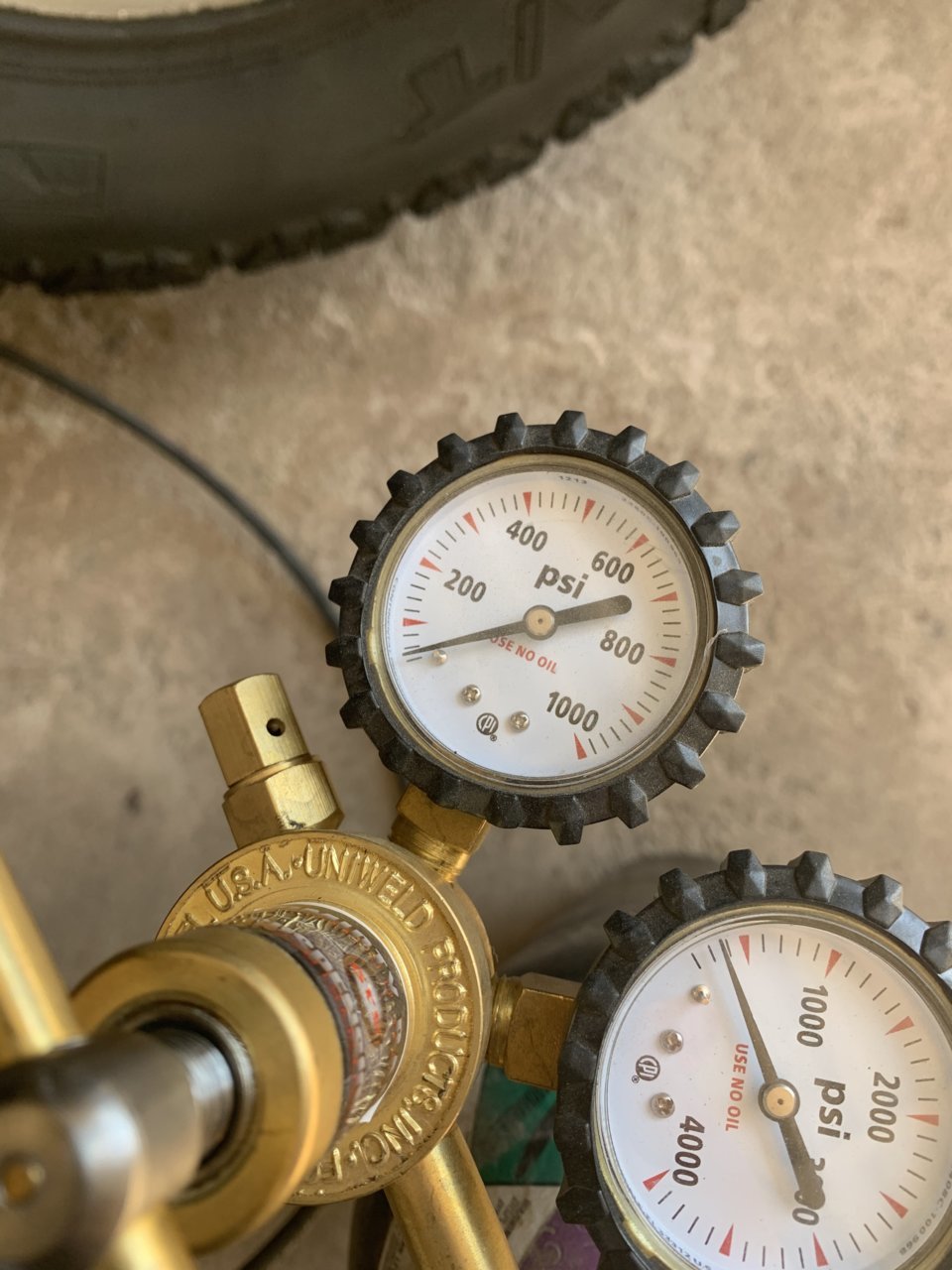

    Went and had local fabricator Ty Snow (Roxtar Trux) help me out by adding some Nitrogen to my EMPTY brand new Bilstein 7100 shock. It had about 5psi in it straight from Bilstein. Per recommendations Ty helped me fill it to 200psi. Hopefully no premature failures in the future. I knew it was low because you could easily depress it by hand & it takes about 30 seconds for the shock to re expand.

    Did you contact Bilstein about it?

    Did you contact Bilstein? That seems really sketchy! Keep an eye on it, it might have a leak or something.

    I contacted wheel every weekend, who is the Bilstein dealer I purchased from. They are working on it. In the meantime this definitely got it sorted out. Not much other choice I have for now.

    Been dealing with Wheel every weekend & they have been in contact with Bilstein. I’m probably going to call Bilstein myself though & see what’s going on with their side of the story

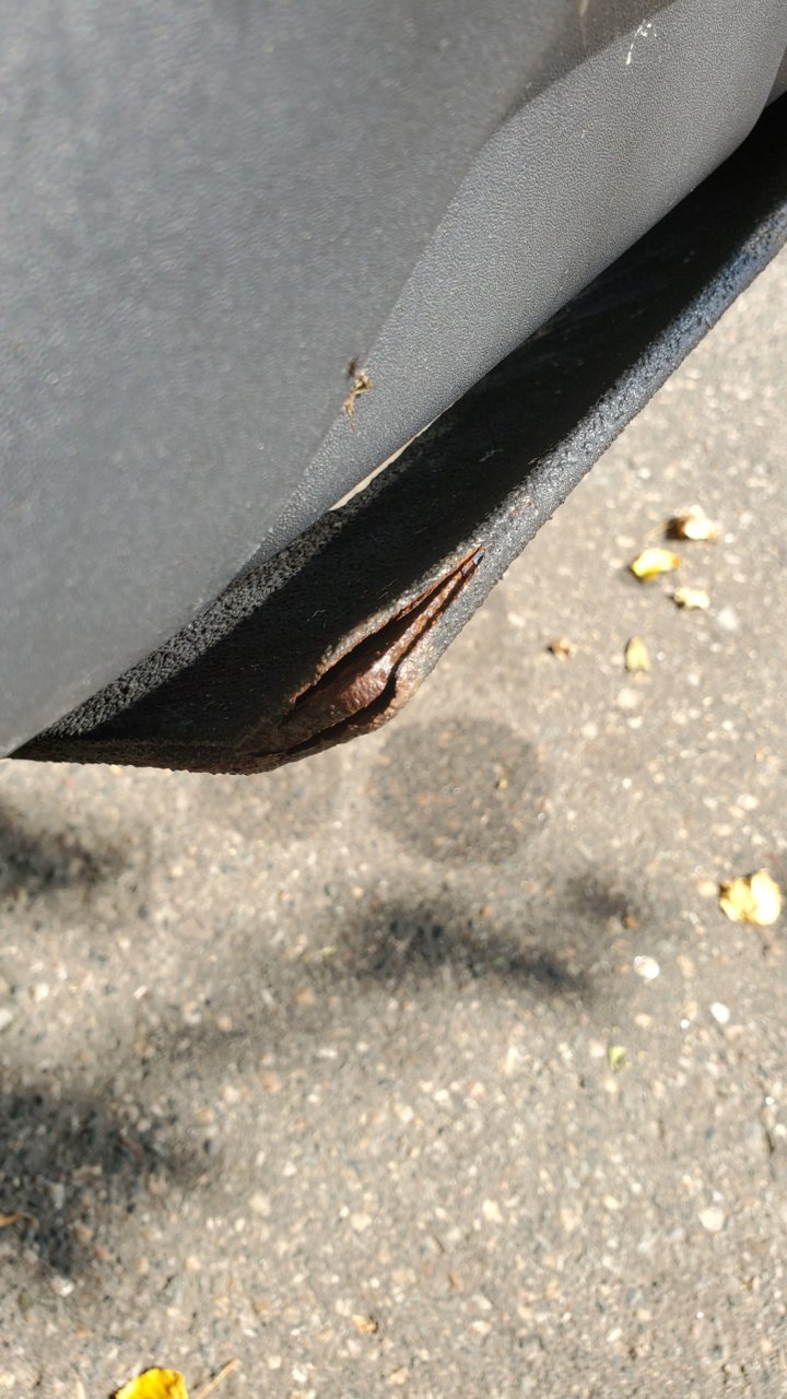

    I had Line-X put on my BPF skid plate a few years ago and just noticed today it's separating. What is a good temporary fix here? I'm thinking black silicone sealant and a spray-over with some rhino liner?

    Do you think that would all come off pretty easily? Looks like it's on its way.

    I see what you mean, just chip off that corner and fix it with rattle can.

    I'll give it a try, that sounds like the best way to go and would make future touch-ups easy. I think the Line-X was $100 when I did. Hey let's trade for a winter, your truck looks like it could use a little rust. It gives it character!! :D:D
