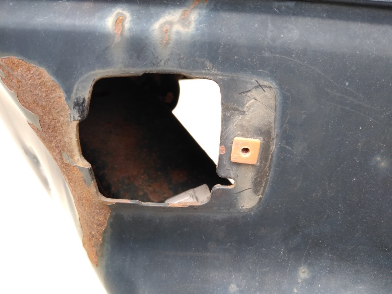

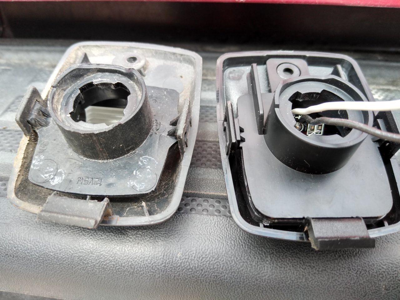

    So about a week ago, came home to a gift to me in my mailbox:IMG_20200919_132100367_HDR.jpg
    You can see why I needed them. They are LED and only like $14 from eBay, so why not.
    I knew it would only take a few minutes to swap, so I didn't even go in the house after pulling them out of the mailbox, I just grabbed a screwdriver.
    But I wasn't expecting that they'd be a bit different than OEM. Which was kind of a stupid expectation, this is like showing up to my college level Italian language class and not expecting the teacher to just start class in Italian. That was a humbling day for me.
    As was this.
    Man! Mother Smuckers. So as you can see, there's one tab on the OEM one and two tabs on the eBay one. What's hard to tell from this picture is that the inner tabs than hold the bayonet mount, press-and-twist bulb socket are thicker, so you have to push it in further before you twist. Which works fine if you take the o-ring off, but yeah, not doing that because I don't want to fry these when water gets in there.
    So it didn't fit.
    The tabs are supposed to fit in these notches because OEM ones are right and left but the eBay ones are not.
    So when I took this picture, I thought, "you know, these are not likely to fit perfect with these rusty dents in here that broke the OEM ones in the first place." So I figured I could pound them out. I climbed under there with a hammer and found, no, that's not going to work without taking off the bumper cover.
    An hour and a half later I wondered what trouble I had gotten myself into. But I got to play blacksmith; brushed off some surface rust and pounded those dents out nicely. The whole neighborhood heard me "massaging" those dents out. I have a straight bumper cover now, guys! The bumper is still a little saggy from probably a previous owner towing too much, but I'm not sure how to fix that.
    A little rust converter paint and we're in business
    It was at this point that I realized my feeling of success was premature. I still hadn't completed my five minute light swap.:(
    Ok, so trim one of the tabs on each housing, no sweat with some side cutters. But it still wouldn't fit.
    I found that reusing the rubber-ish gaskets was making them not fit. Because the gasket needs trimmed around the inner housing, which is bigger than OEM.
    Bottom is trimmed and sits flush, top is not trimmed and shows the overlap. A steady hand and sharp razor blade work wonders. Now press/twist that bulb socket in there, which feels like you have to twist it just hard enough to not break it, but I got it in there with the o-ring.
    I like these because even though they are LED, there's a diode or something in between the contacts, so it doesn't matter what orientation you plug them in, they work both ways.
    And finally, nearly 3 hours and 15 min later, there was light. And I saw that light and saw that it was good.
    I know I probably could have used a couple more coats of paint on those rusty spots, but I was already invested 2000% more time than I anticipated.

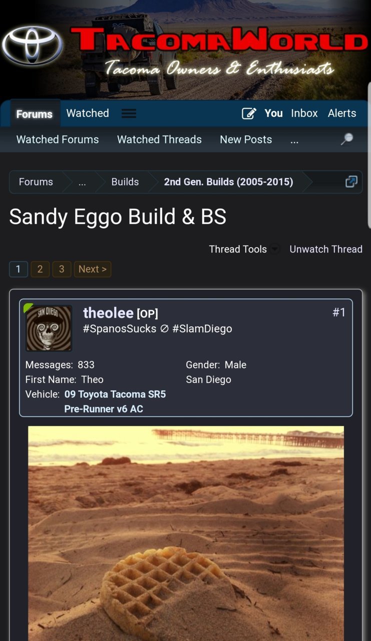

    Nothing to my truck but I modified my Tacoma World viewing. My eyeballs appreciate it.
    If TWs super white pages sometimes gives you a headache, follow these easy steps.
    Step one *Chrome only: enter chrome://flags/#enable-force-dark into your browser.
    Step two: choose "Enable"
    Step three: enjoy
    **It does make every other websites dark. :)

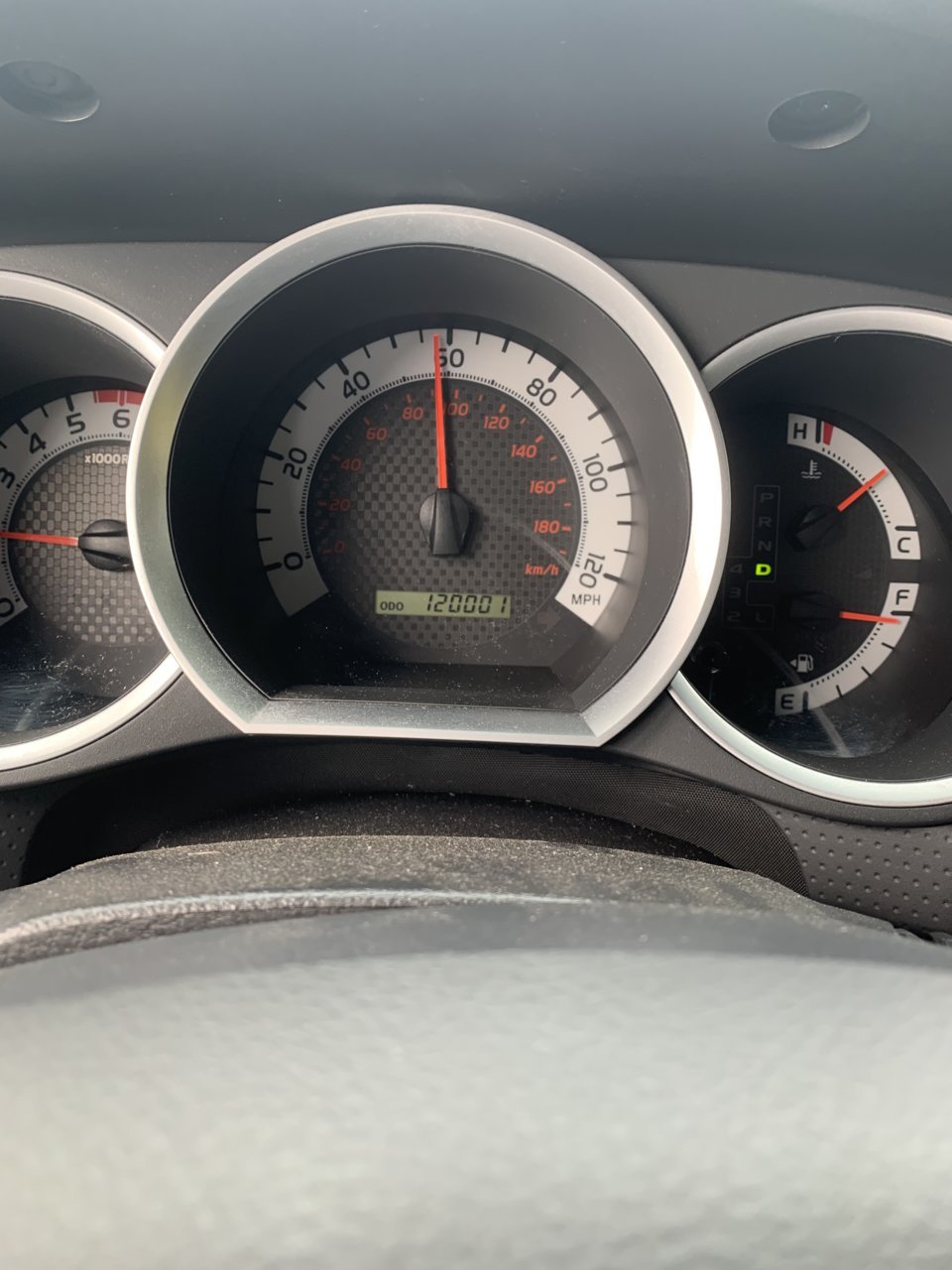

    Damn. Anyone else feel like if they drive slower we won’t accumulate as many miles?
    I know she’s still young but I just wanna leave her in the garage and get a beater.D93C88CA-128D-4CC8-9049-C4D7C56ADB89.jpg
