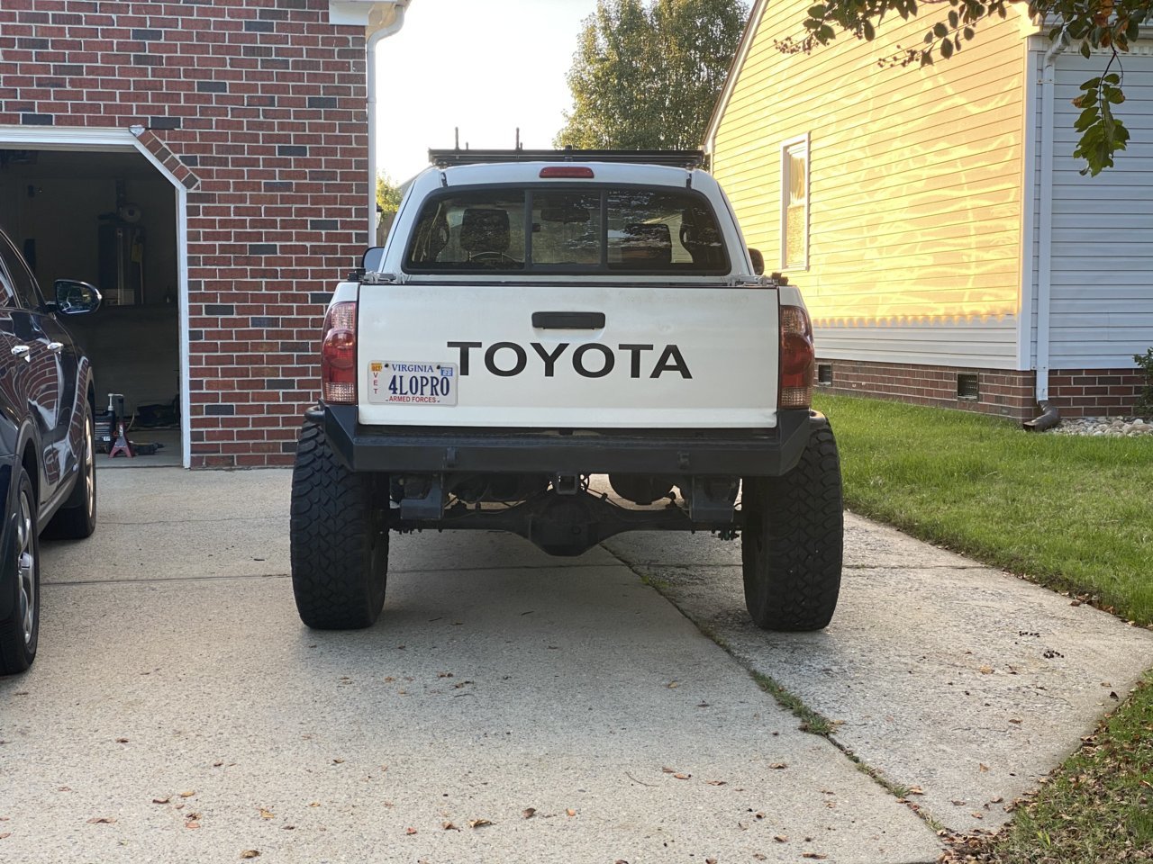

    Shhhh, don’t look too closely under there. :D That's just the excess of the strap. I didn't want to cut it too short in case I ever take the skid off and need to put it back on.

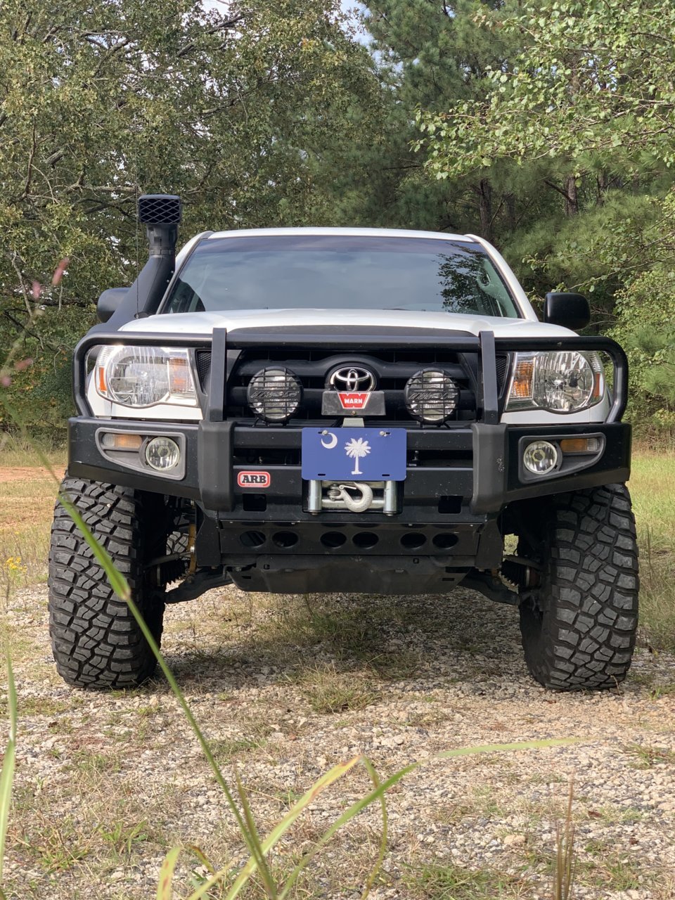

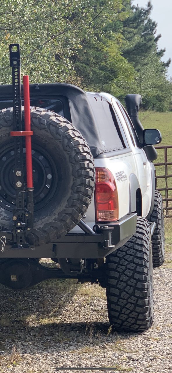

    Fab’d up a mount for hilift to mount to tire carrier and welded it on. Bought my long lost snorkel back and installed it. 97584744-D234-4DB3-A5B1-954CA115B614.jpg

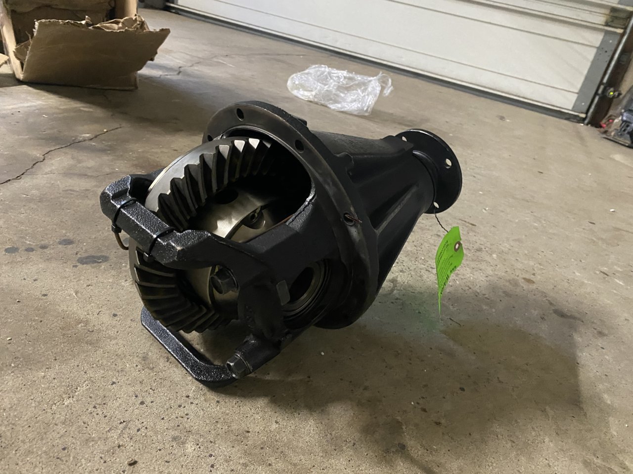

    How difficult is doing the swap from ECGS?
  7. Oct 6, 2020 at 6:30 AM
    EatSleepTacos
    Mar 24, 2015
    #151688
    59,846
    Randy
    West Valley, AZ
    2017 4Runner
    The rear is a piece of cake. I've removed the rear 3rd member a few times now and it's about 75 min for me to get it out and 75 to put it back in. If someone has an e-locker, add another 20 min or so.
    Since the axles have to be pulled out in order to remove the 3rd member, some people unbolt the hard brake line from the hub. What I do is unbolt all the brackets from the axle and the lines will flex enough so I don't have to bleed the brakes. I explain it at 6:40 in this vid.
    https://www.youtube.com/watch?v=p46T5feixYk

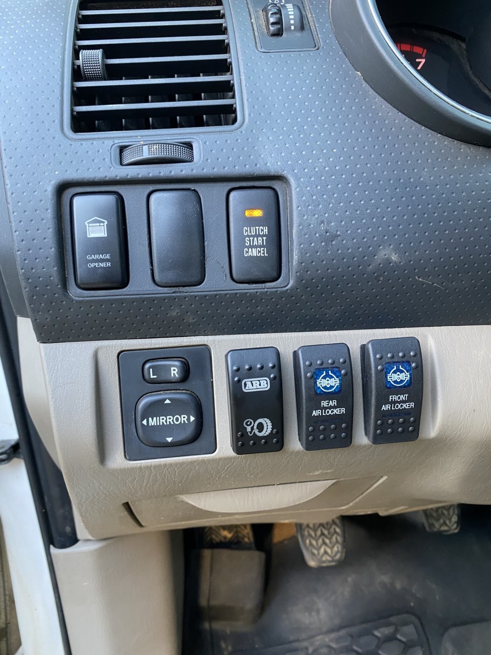

    Very nice. What's the story on swapping to an air locker? Not trying to stir up the debate of eLocker vs Air but give us the quick and dirty.
    EatSleepTacos[QUOTED] likes this.
  9. Oct 6, 2020 at 6:45 AM
    EatSleepTacos
    Mar 24, 2015
    #151688
    59,846
    Randy
    West Valley, AZ
    2017 4Runner
    Well, I had a mechanical locker in mine.
    https://www.tacomaworld.com/threads...lip-aka-lunchbox-locker-in-my-2nd-gen.561142/
    The way that works is under throttle it's locked and off throttle, it unlocks. It's cheap and effective but it's clunky, especially in a manual truck. After a couple years I finally had enough of that so I swapped it for the air locker. My firstborn is coming in a few weeks and the truck will be a street queen for a bit, so I wanted it to be a little more comfortable to drive around. That's why I've been making the interior nicer (sound deadening, carpet, replacing old shitty trim pieces) and I'm tweaking the rear suspension so it rides nicer.

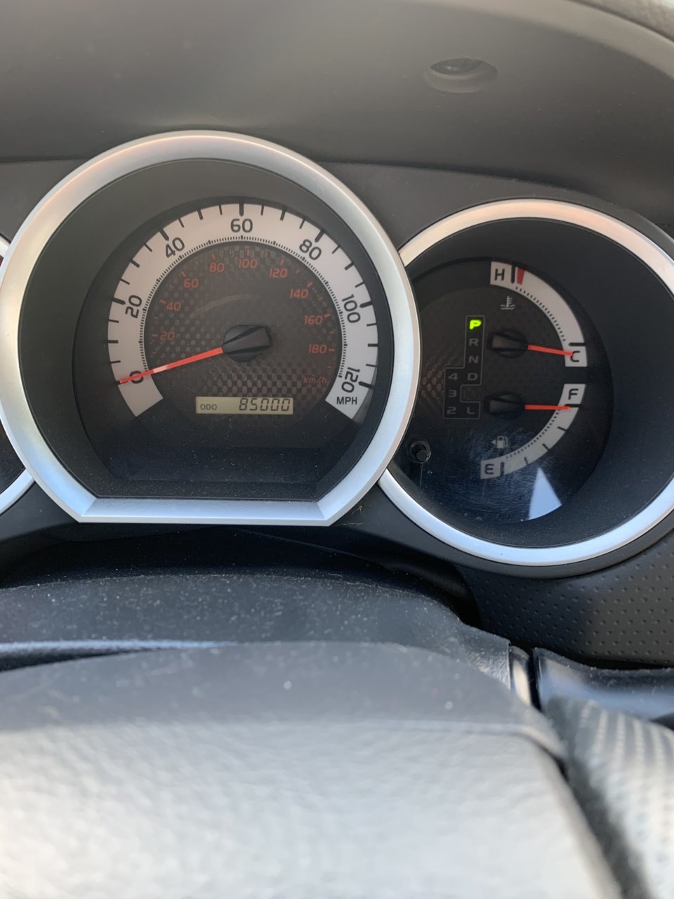

    Landed on exactly 85,000 in my parking spot at work.
    Also Done
    Tire rotation
    Oil change
    Cleaned the air filter
    Also averaging almost 20MPG's since we moved. All state roads home now.
    "Going to the country" Cammp
    To Do
    Grease drive shaft
    Clean MAF
    Clean Throttle Body
