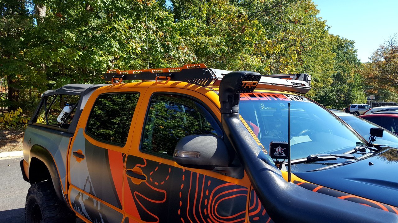

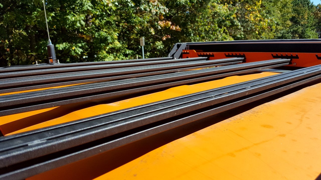

    Raised my roof rack a tad as it had sagged over the past year to where it was touching the roof.

    Well, did it solve the noise?!

    Lol about to go for a drive and see.

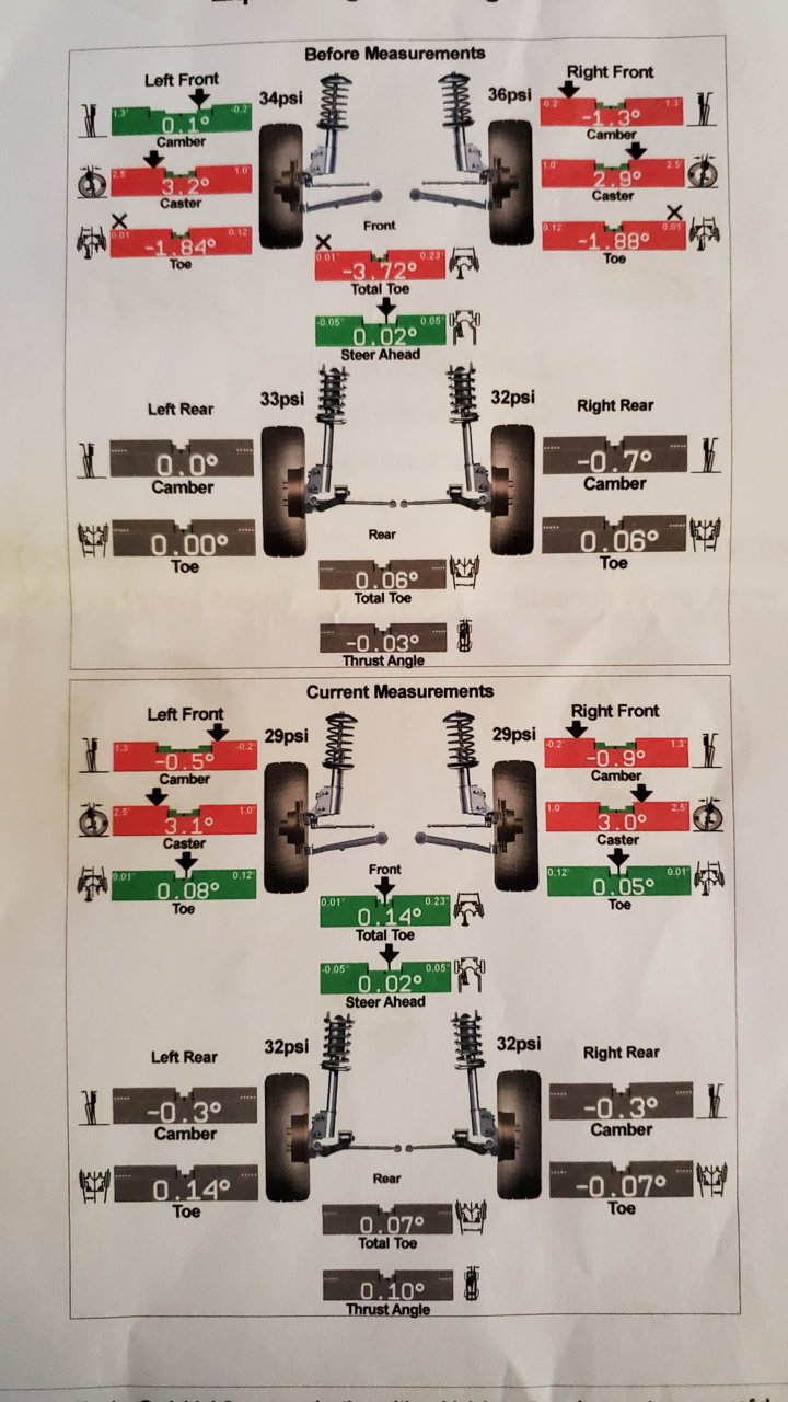

    Had an alignment done after the suspension upgrade. My LCA were so rusted to sh!t they couldn't fully adjust it. It's close but now I need to spend another damn thousand bucks to get that in order. The sheet doesn't look the greatest but at least it doesn't steer like a battleship anymore.

    Sagged? What sagged on it?

    I feel your pain. I have a 2015 also and last year got an alignment and was told 2 of the 4 adjusters were seized. If all goes as planned I'm cutting them out and replacing the control arms and hardware next weekend.

    I guess the 4 bolts holding the rack on the attachments points to the truck just loosened enough so the rack lowered a little at a time.

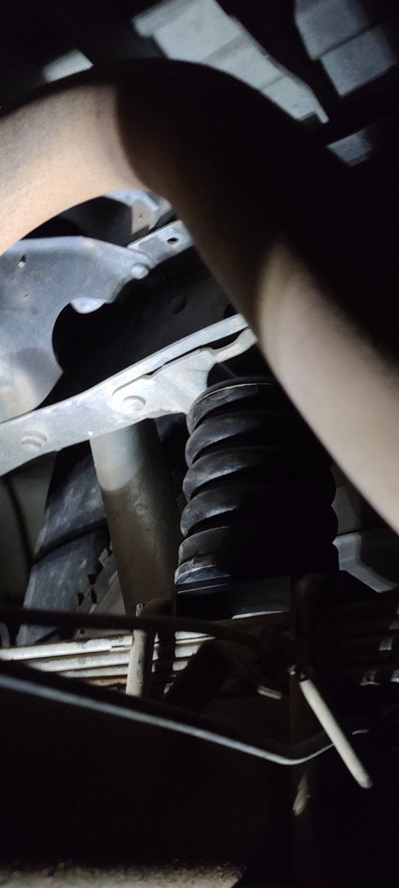

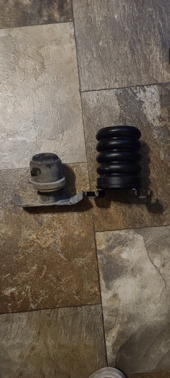

    I’ve had my sumos for about 4 years now. They do relieve some stress on the leaf springs.

    Which # lbs are you running? I did the #1500 ones

    I don’t remember. I believe their the blue/purple ones.

    Those are #500 ones. I went big or go home i do dumb s#!t and hoodrat s#!t with the homies

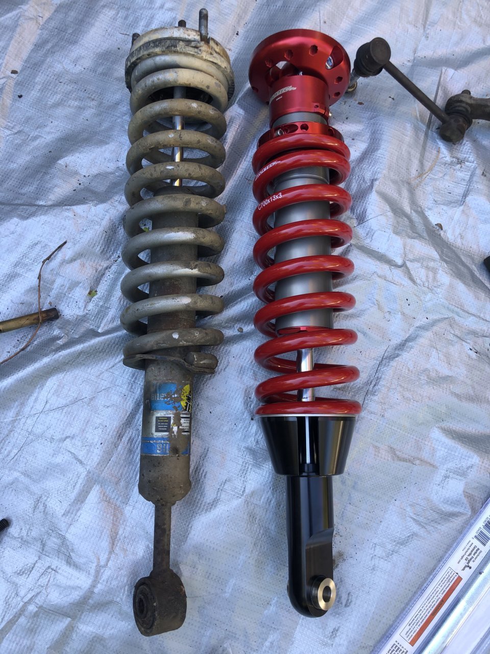

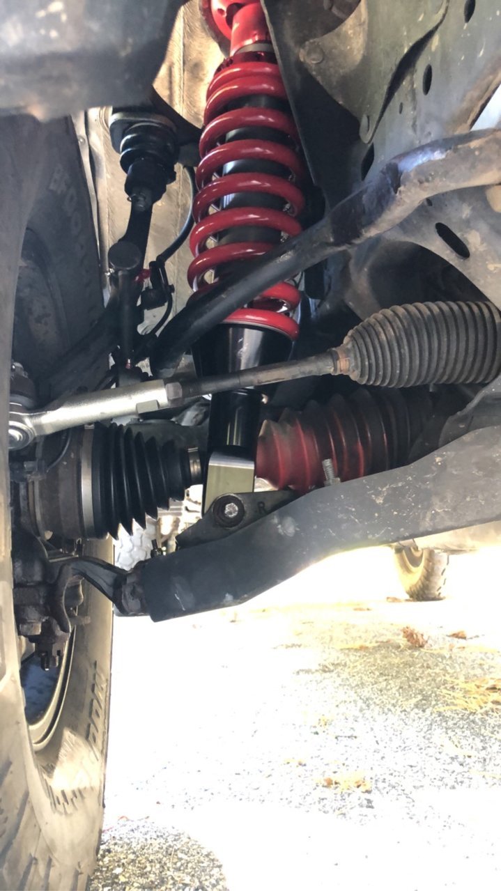

    Installed my aluma 2.5s to replace the junk bilstein set up I had in the front with a broken coil spring. Also replaced the outer tie rod ends with oem and went moog for sway bar links because they were toast when I was taking stuff apart.
    ordering MTRs tonight

    Just toss the sway bar altogether :thumbsup:

    Agreed I relocated mine to Craigslist after I got my kings.
