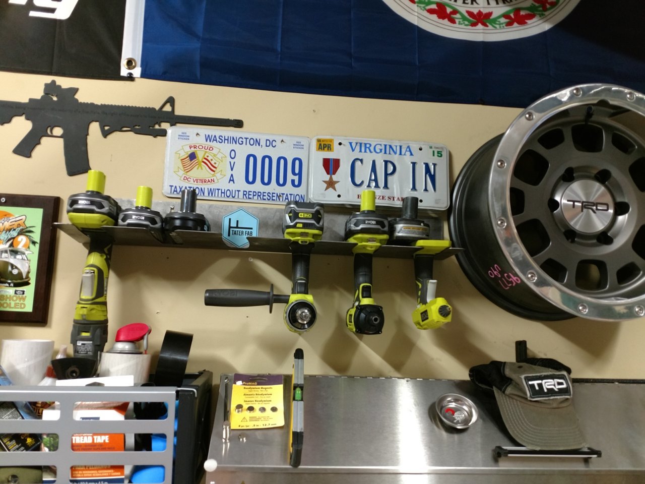

    Installed my new 6 tool rack for my hand tools.....counts as Tacoma related!

    The wheel is a nice touch

    Idk, I’m partial to the AR silhouette on the wall ;)

    How did you mount your wheel to the wall?

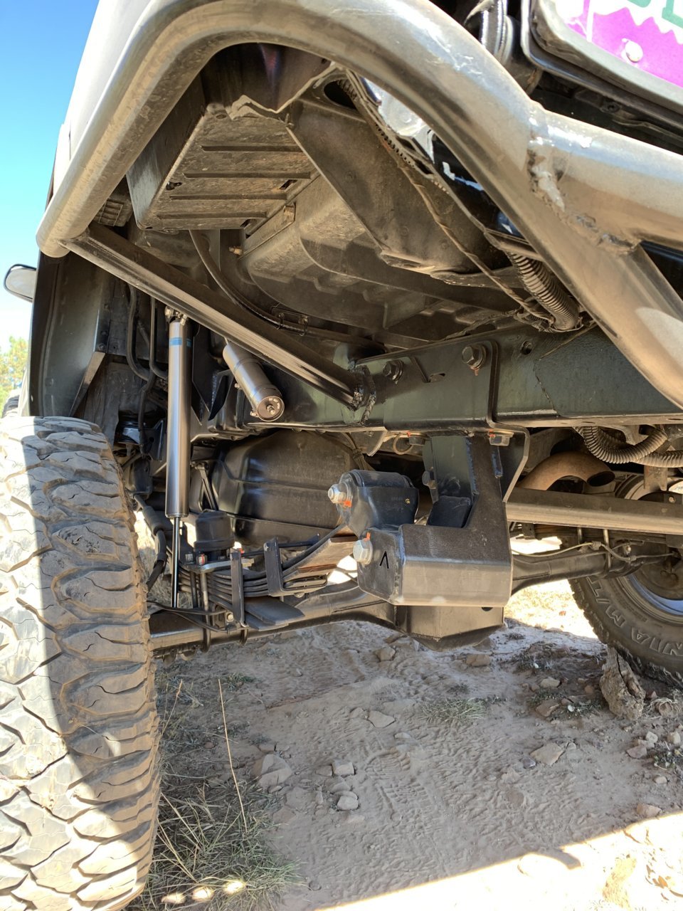

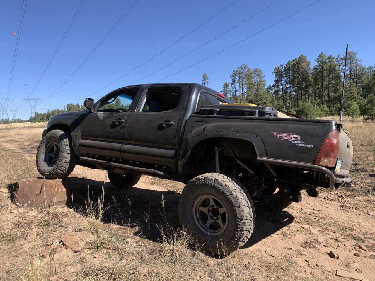

    Stepped up on a rock to check my new rear setup out. I’m going to toss in my 3/8 wheelers superbump spacers just for a safe measure. I know for a fact the DS isn’t fully dropped out, it has more down travel still. The PS is already squishing the superbump and looks just barely too close for comfort so that’ll help. These are 14” short body 7100’s & more weight in the bed than I pretty much EVER carry.

    A wall hook, zip ties and fishing line. And a prayer ha
