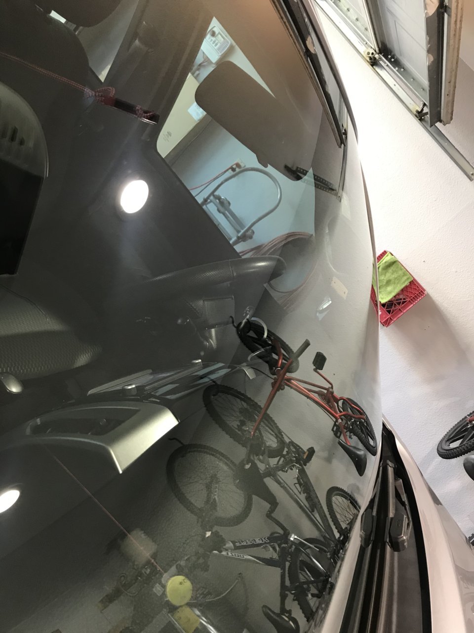

    C4355EBF-3A55-401F-85E5-E480CE38633F.jpg If I get the glass any cleaner , I won’t know it’s there,:D90A67339-AE39-4B7D-81AC-6A2B8775CA26.jpg

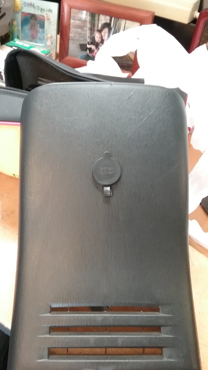

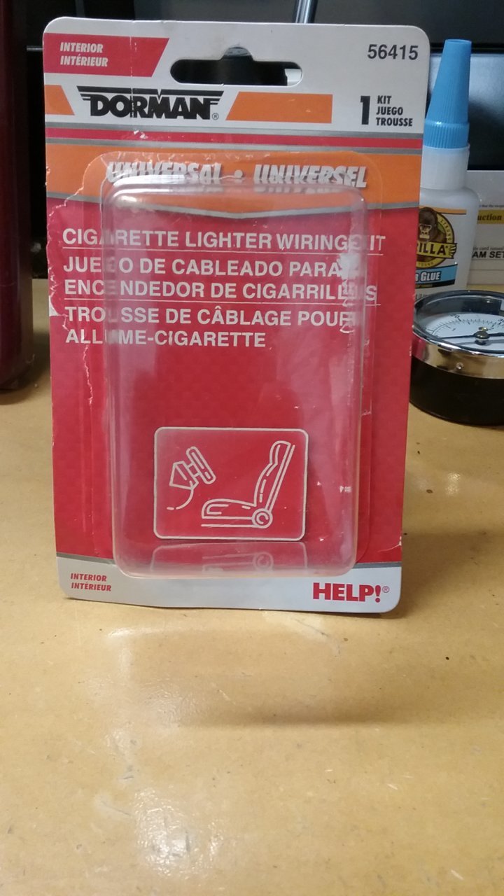

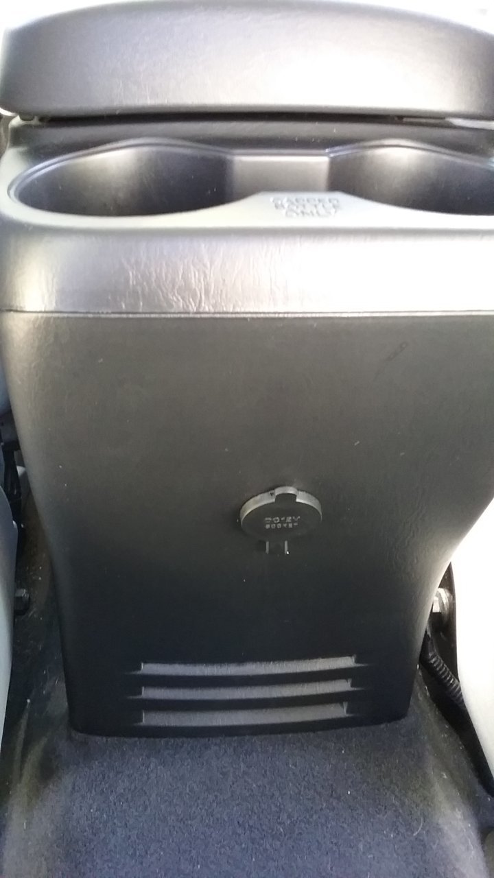

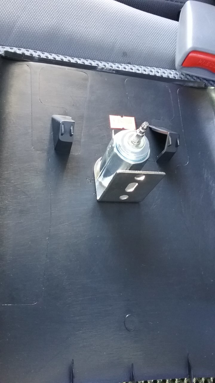

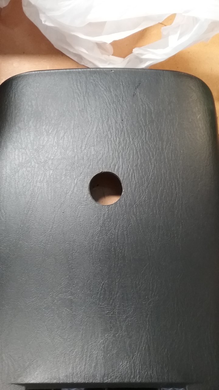

    Something I've been meaning to do for ages and finally got around to it today.
    Added a 12v port for the rear passengers. This can be used with a USB adapter as well.
    Just an inexpensive 12v port from Autozone.

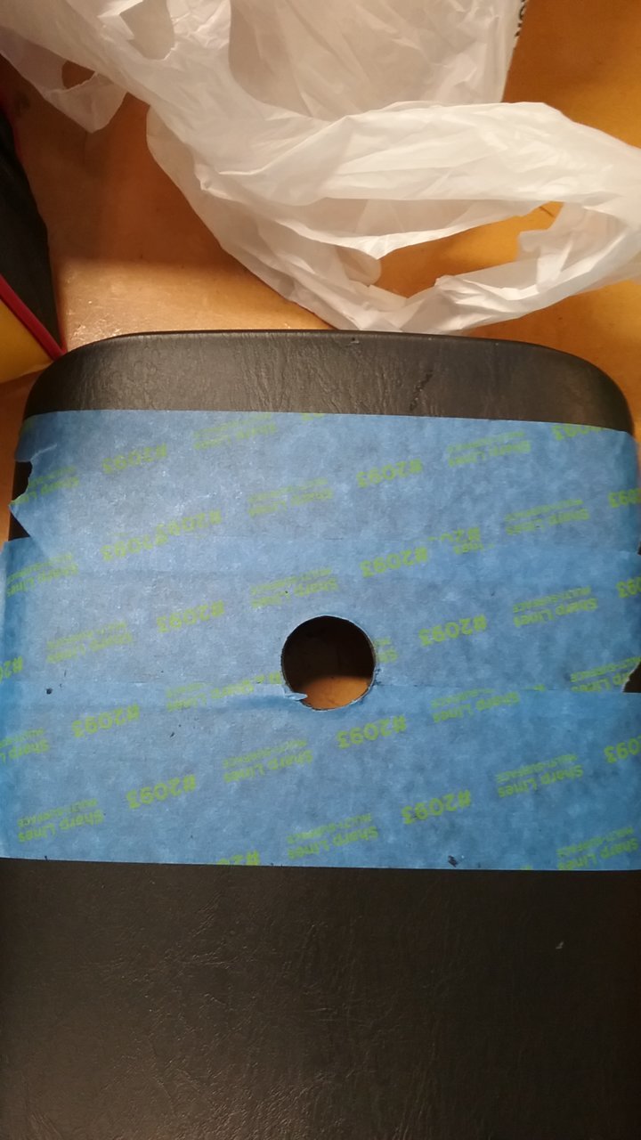

    Measured the center point and down 4" to clear the back of the cup holders. Used a 1" hole saw for the cut.
    Installed

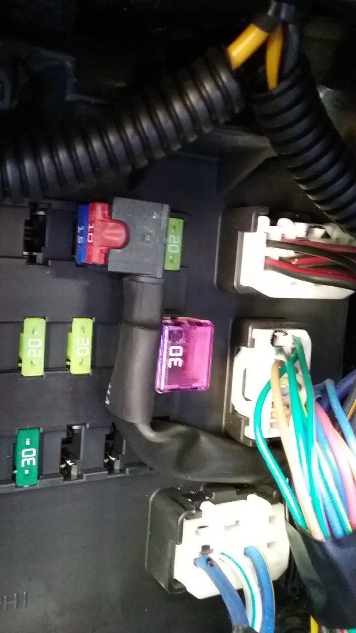

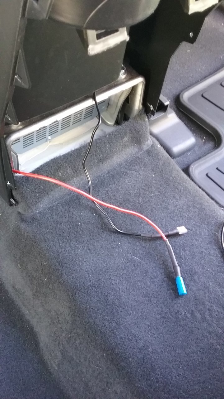

    Used an Add-a-Fuse to power it off the existing power port circuit. I have a 10 amp fuse protecting it. That should be enough to juice a couple of phones, games, etc. I can always go to 15 amp if needed. But you don't want the accessory fuse to be higher than the circuit fuse. So 15 would be max for this setup.

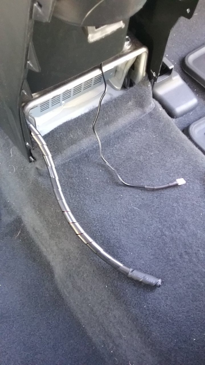

    Hot wire routed to the rear of the console along with a ground secured.

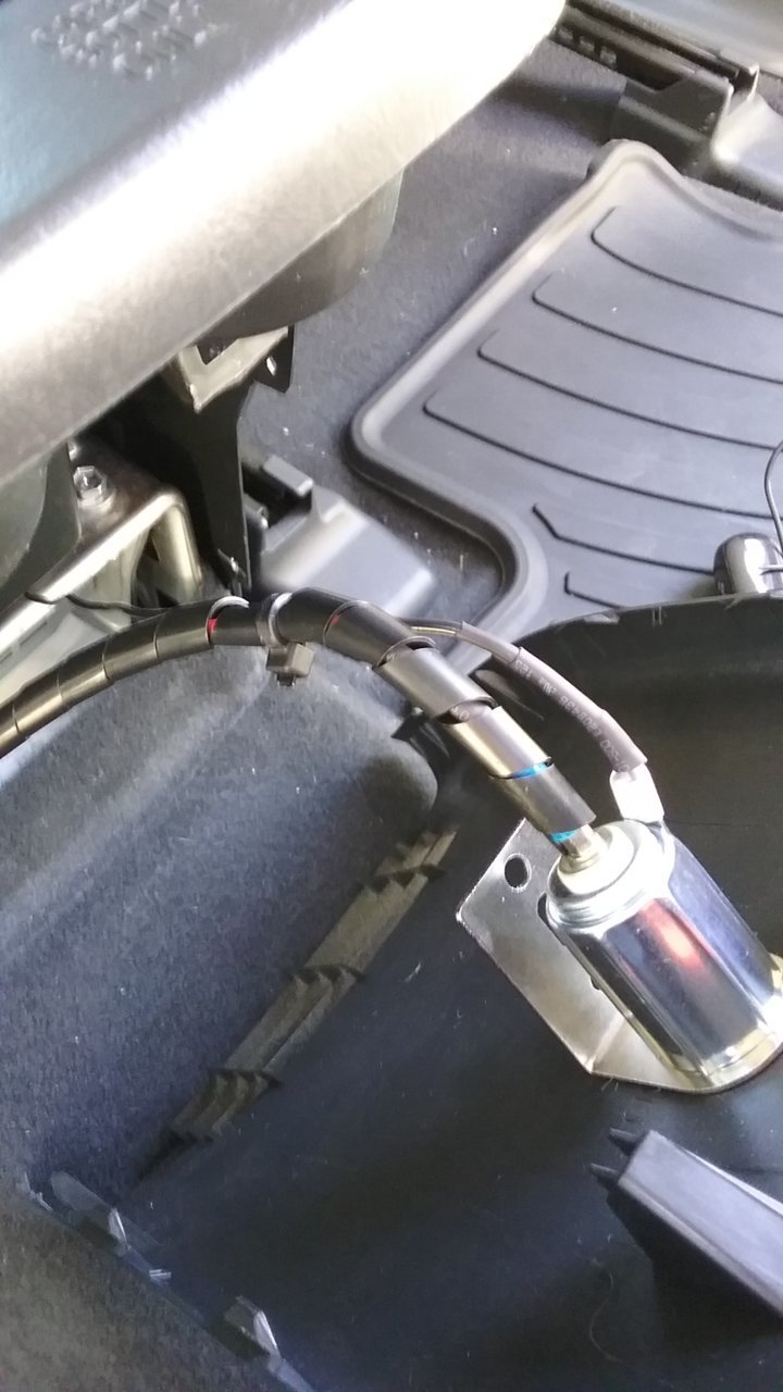

    Hot wire loomed for protection.
    Positive and negative hooked up.

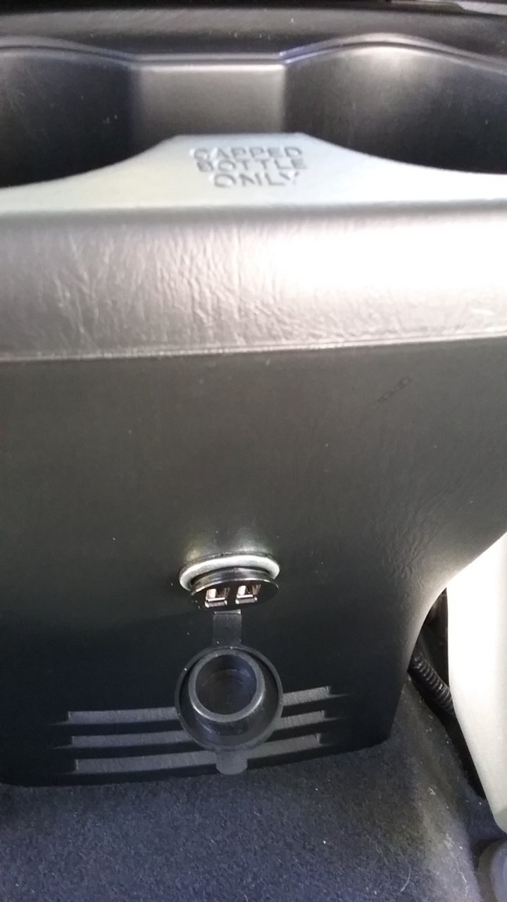

    Final product.
    With dual USB adapter in place.

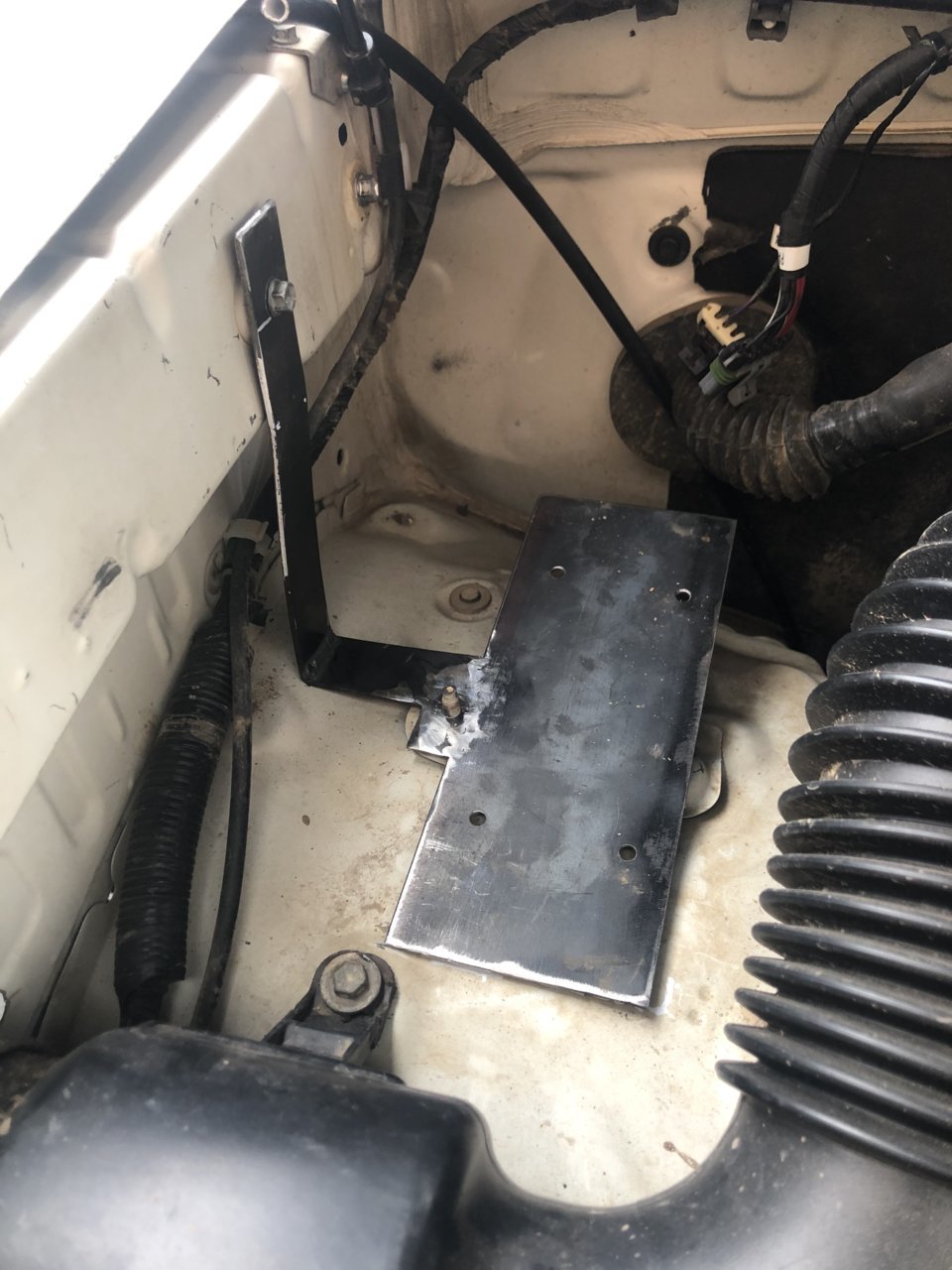

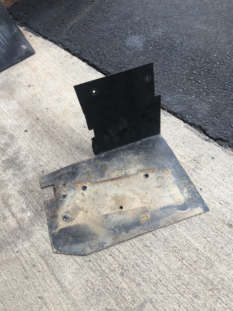

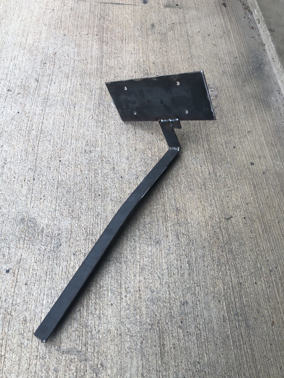

    Remade my arb dual compressor mount. Previous was some thin sheet metal that i bent by hand. New mount is 3/16" base plate and 1/8" supporting arm.
    Old:
    new:

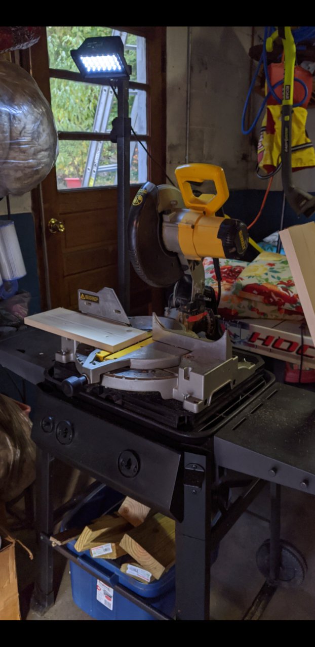

    Just a cheap harbor freight LED light that I took apart and hook it up on my makeshift table saw stand.

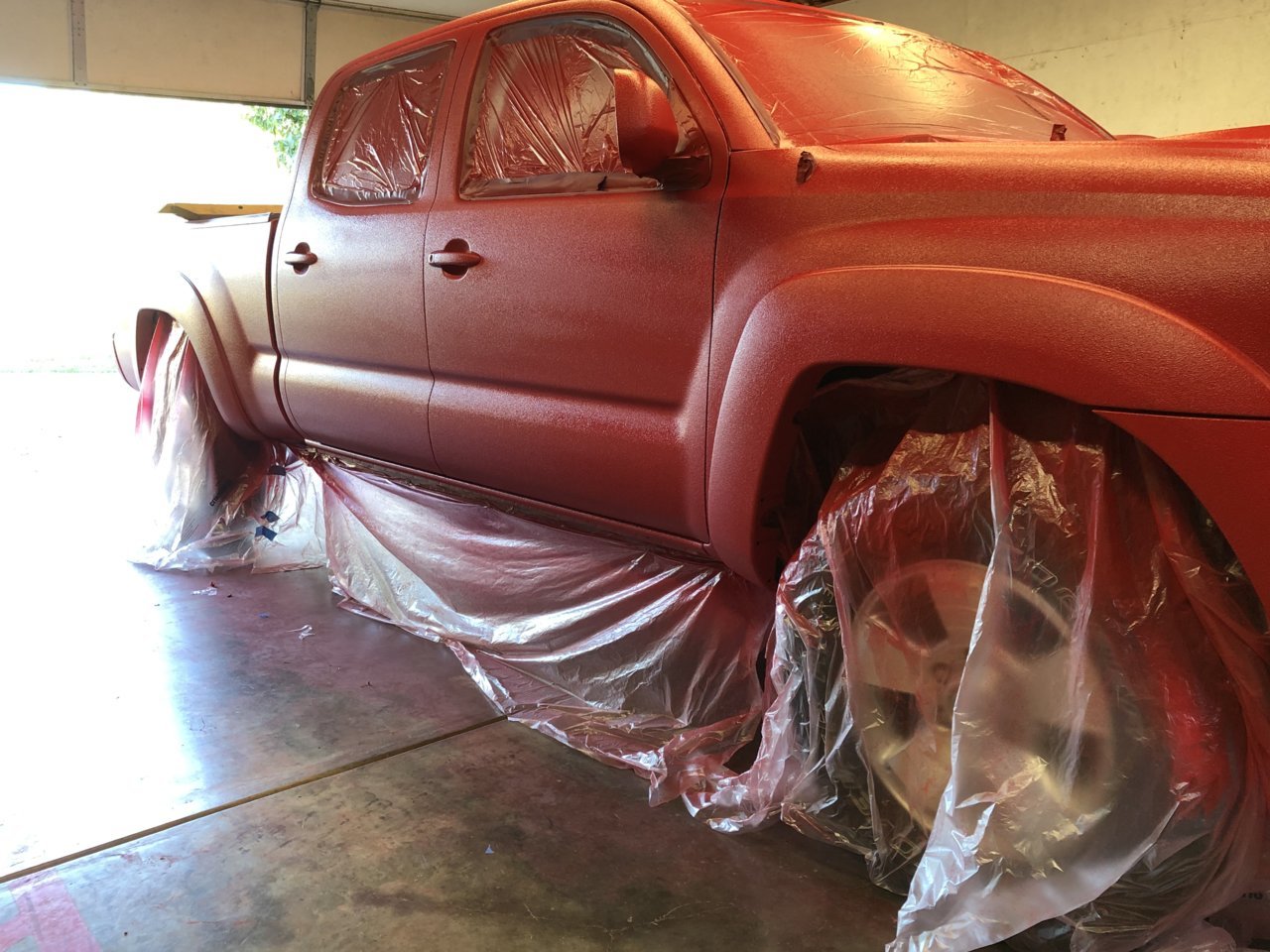

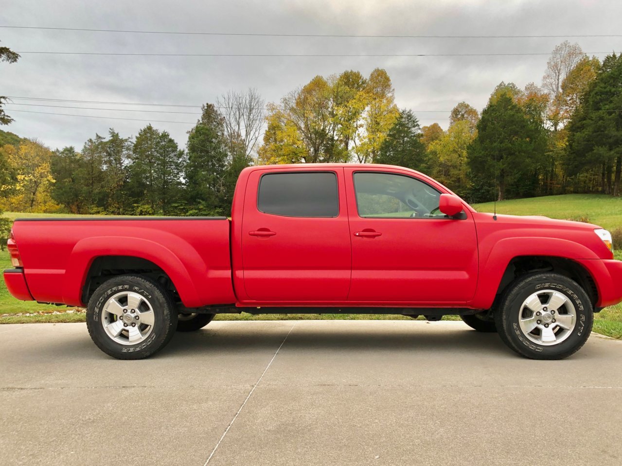

    upload_2020-10-13_19-29-11.jpgFixed peeling clear coat

    Looks good. A lot beefier than the Husky work light from Home Depot.
    Seems like Harbor Freight doesn't sell the light anymore.

    the top picture looks like that raptor liner

    Correct it is raptor liner. Top was before it was untapped.Bottom it all done. Had it priced to paint but couldn’t justify over 5,000 on a 2005 model.

    This is exactly what I am thinking of doing eventually. Mine's got a lot of paint chipping off it and really can't justify the price for a paint job either. Was it fairly easy to do? How long do you have to let it dry for?

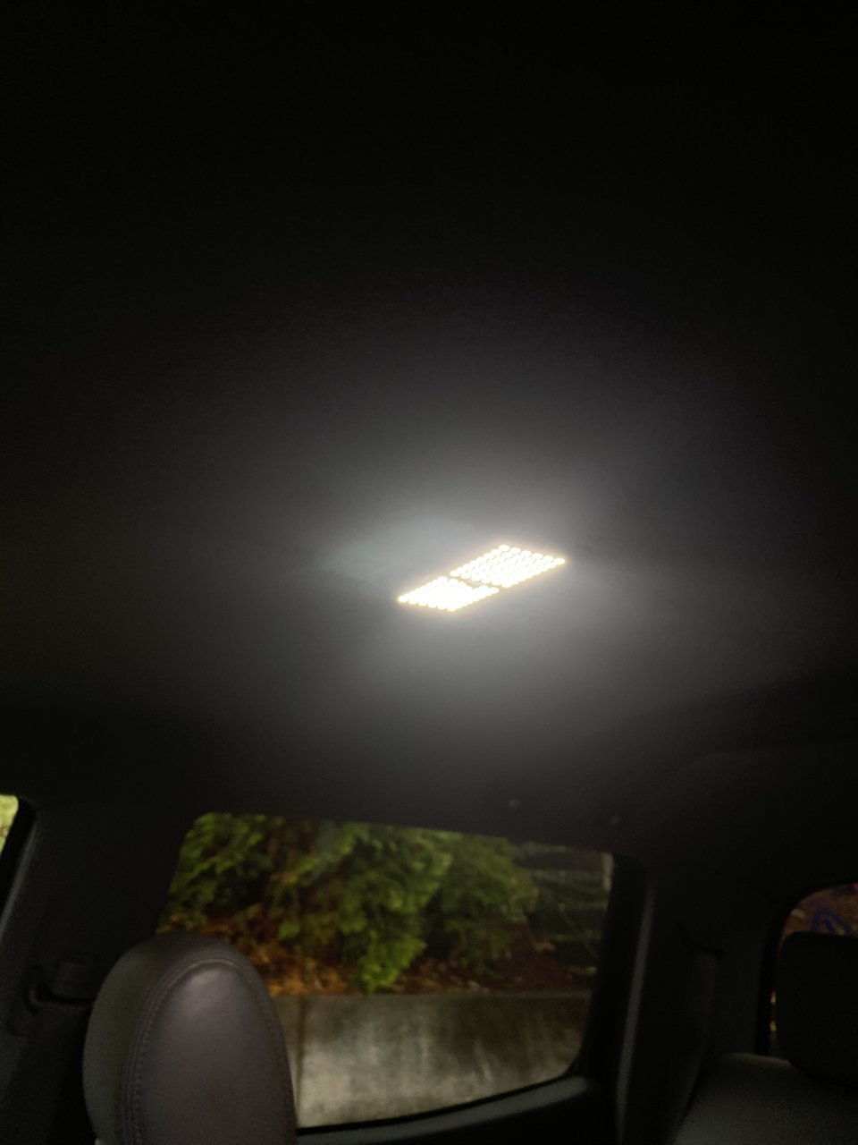

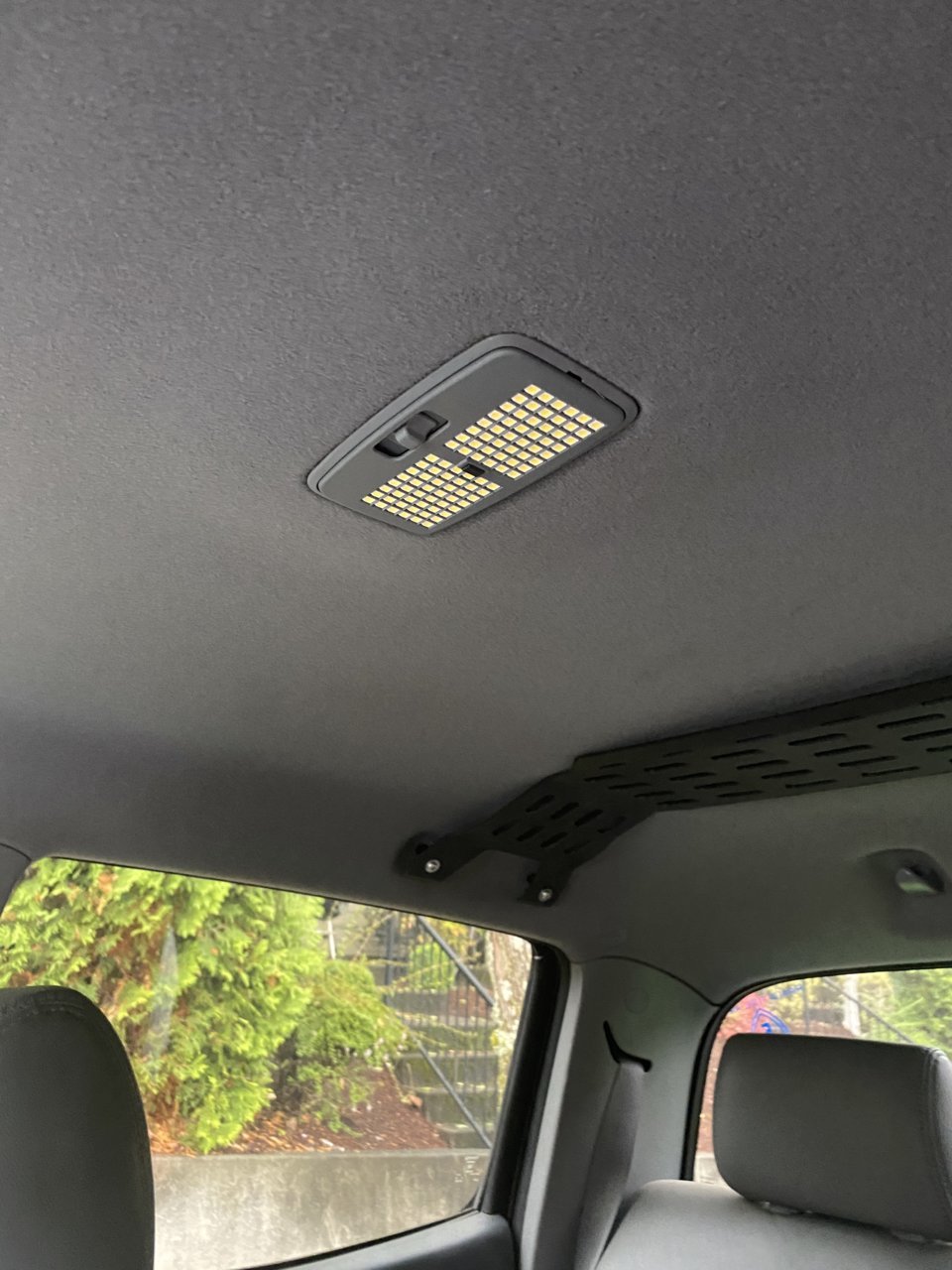

    Installed my @MESO dual brightness dome. Even on the low setting its bright AF.. the pic is altered I took some of the brightness out of it just so you could see it.

    Sanding was the worst part. That took about 3 evenings after work. Spraying it is pretty straight forward. I sprayed it on Friday and let it sit for the weekend. Could have drove it sooner if needed.
