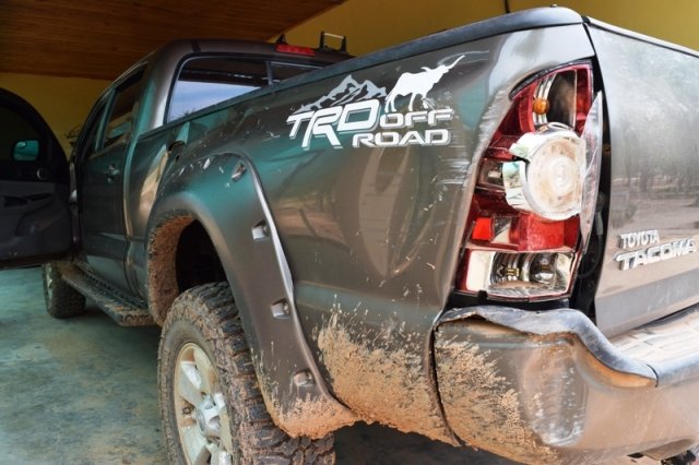

    What have I done to her today ?
    Nothing good ....

    That sucks!

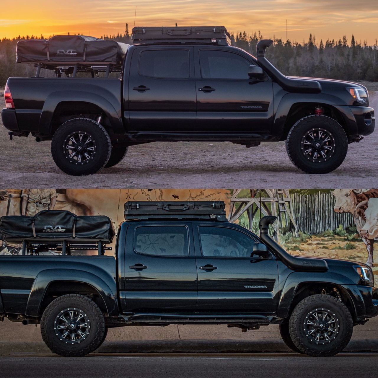

    Had the icon RXT multi rate leaf pack set at option 3 put on my truck on Wednesday. Waiting for the icon delta joints to come in, I’m also having my shocks rebuilt so I’m on toytec boss shocks and coil overs right now but due to the leaf pack I lifted the truck a little more. Kind of hard to tell but top is now and bottom is before. Truck now sits at 3” over stock in the front and 2” over stock in the rear, and I have about an inch of rake. So no more sagging rear.

    Ouch!!!!

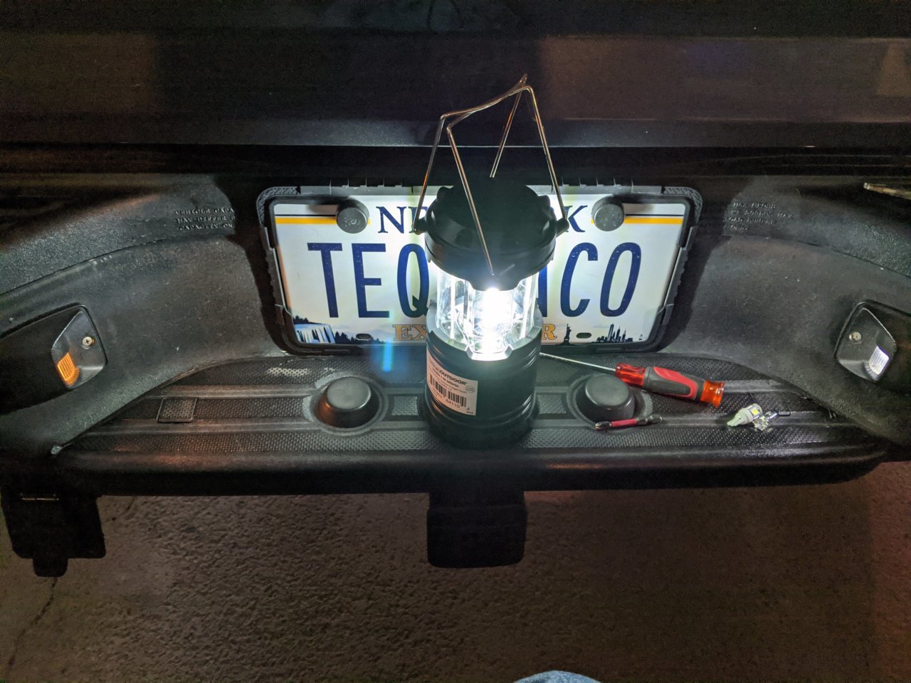

    Replaced the license plate lights with LEDs.

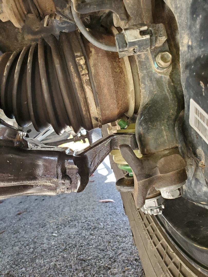

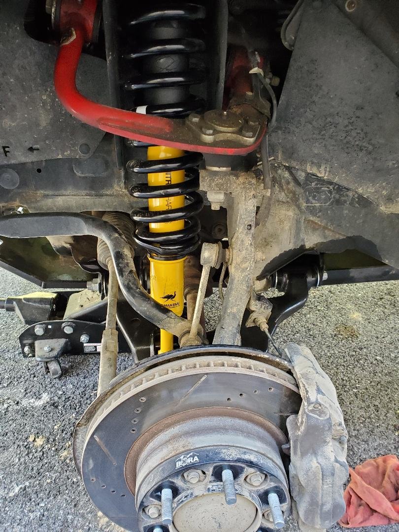

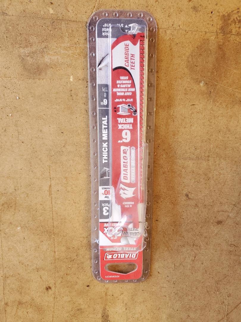

    New lcas with Whiteline bushings and Mevotech ball joints. Also changed out the 5100 Headstrong 2" coil combo (885 equivalent) for 886 and OME sport struts. Gained about 3/4". Took about 6 hours, but I wasn't rushing and also was changing laundry and other stuff in between. Used a Diablo carbide sawzall blade on the 2 front bushings. Like a hot knife through a partial melted pat of butter. Other than missing some paint, it still looks brand new. Only hiccup is that the I screwed up when I installed the ball joints and have the grease zerks pointing in a direction that is going to make them tough or maybe impossible to grease. Hoping a 90* grease gun fitting will fit them, otherwise I'll need to get some 90* zerks and install those.
