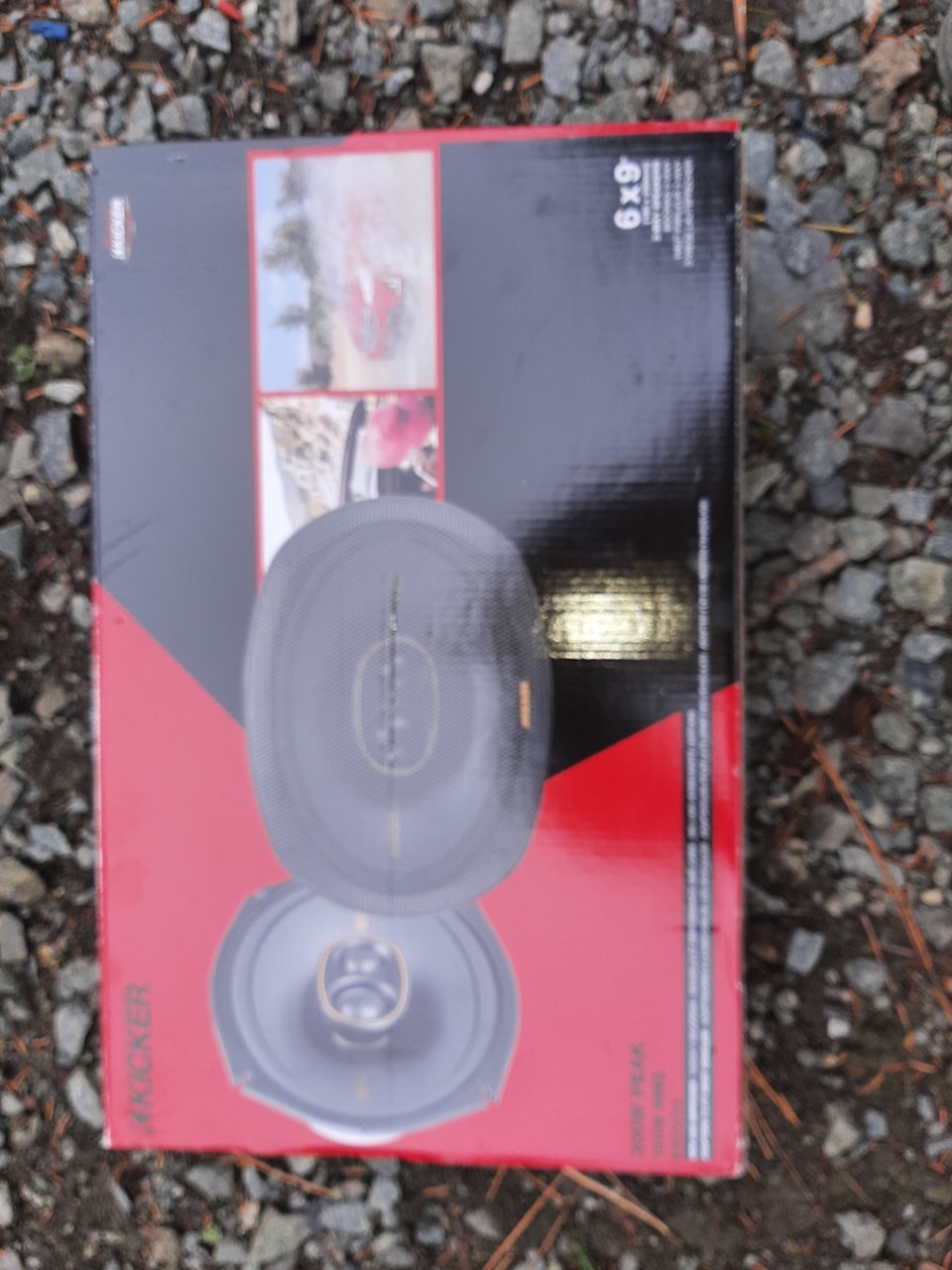

    Installed new front door speakers

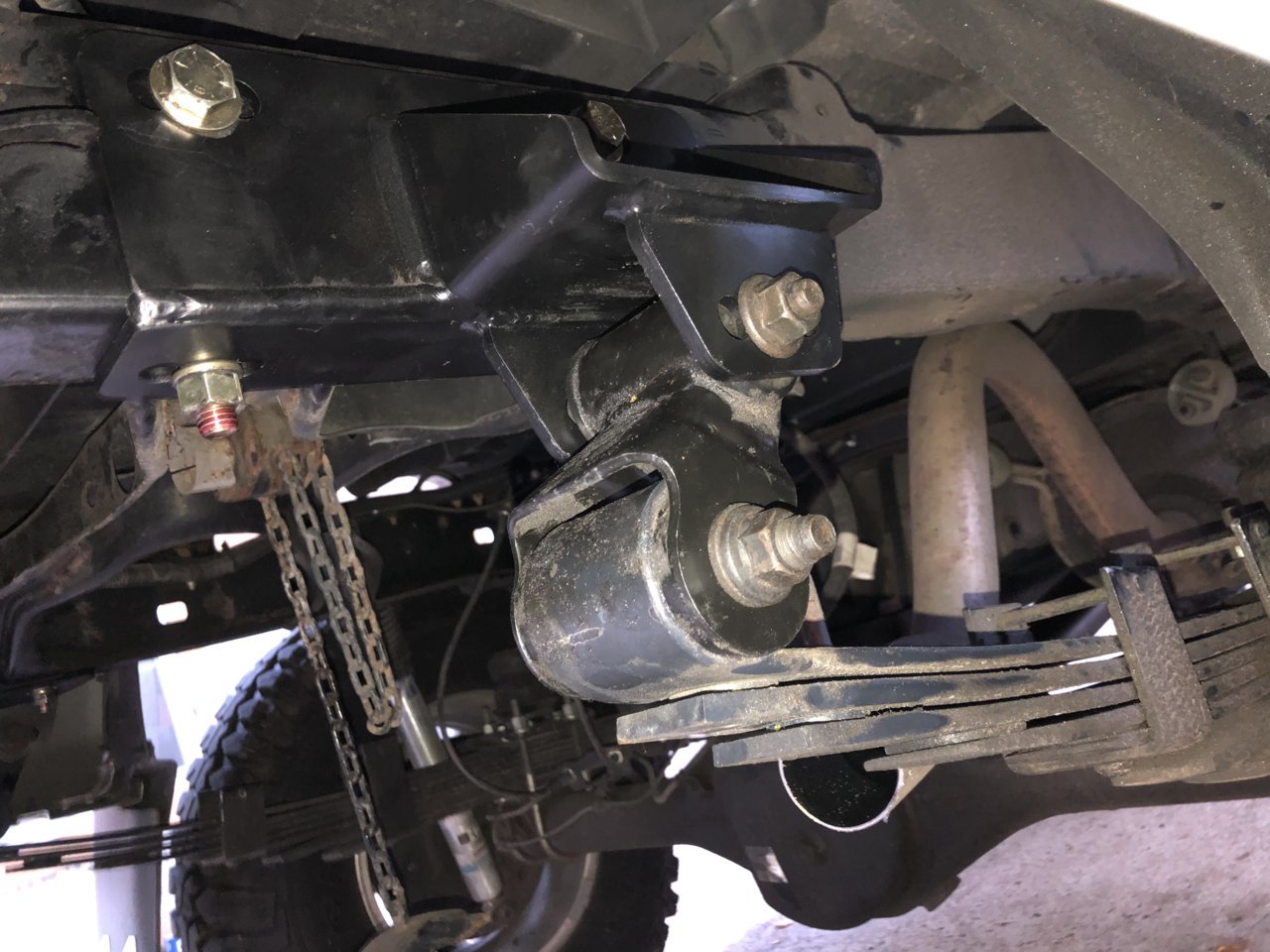

    Looks good, nice and beefy. What are the benefits of a shackle flip though?

    More axle articulation and a softer ride, however a lot of people go back to the stock shackle style because they say the truck leans in turns too much with them flipped.

    Thanks for the info.
    Looking at it, it would seem like the rate of motion would increase and then decrease (if it can articulate that far), while stock only decreases. So a larger range of articulation, but also a changed dynamic rate of articulation. Makes sense for what you described above.

    So far, I’m actually loving the way it handles with the flip, and my Dakar HDs. I was worried about the same thing- but so far I absolutely love it. I figured if it wasn’t the functionality I wanted, I’d change for hammer hangers.
