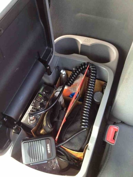

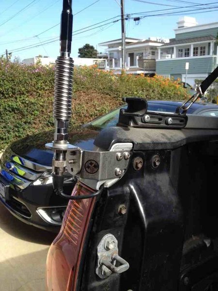

    Finished up my CB install...

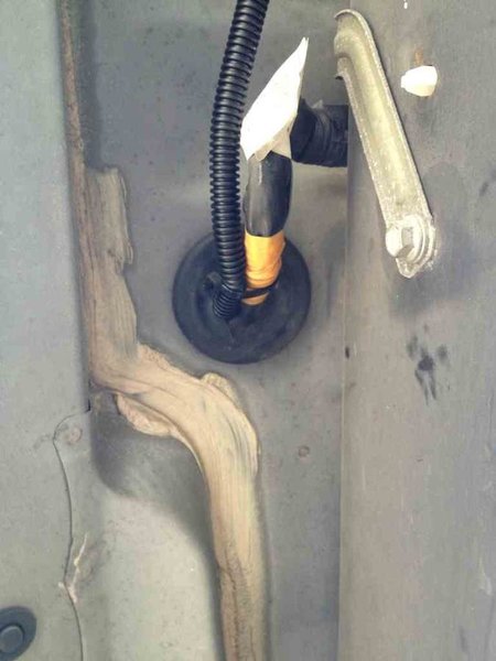

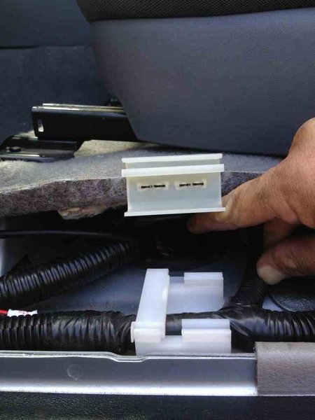

    Ran all the wires under the carpet to the driver's side. The power cable goes forward directly to the battery. The antenna I pushed through the grommet under the driver's seat
    From underneath the truck

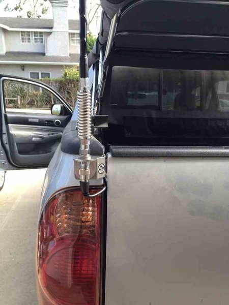

    Covered it with some wire loom to protect it and ran it along the brake light wires all the way back to the driver's side tail light. Used a Firestik door jamb mount to mount it on the inside of the tail gate.
    And voilà, CB radio so I can chat with all them truckers! ;)

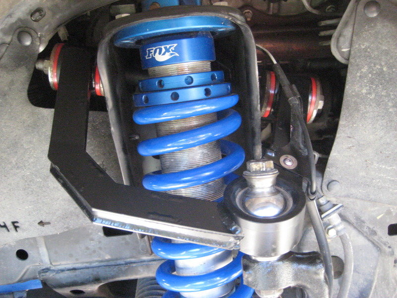

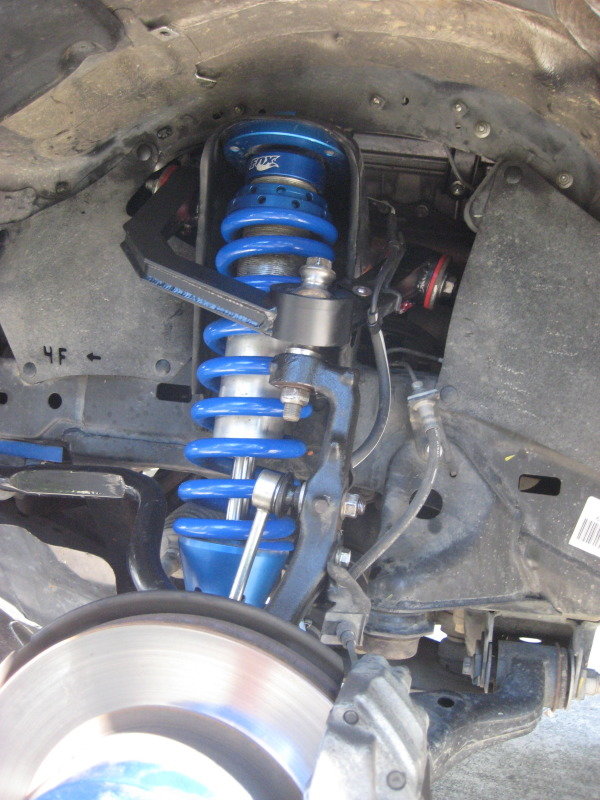

    Bolted up my new (to me) UCAs from Desert Racing Products. :woot:
    Super stoked! Got it aligned yesterday, and everything is in Spec! No more road wander. loving it! Plus the install wasn't really that difficult. (Thanks to TW's awesome write-ups)
    Seriously I was putting this off for a while, and even considered having them installed elsewhere, but I knocked it out in an afternoon.
    Going wheeling this weekend, can't wait to break it all in!
