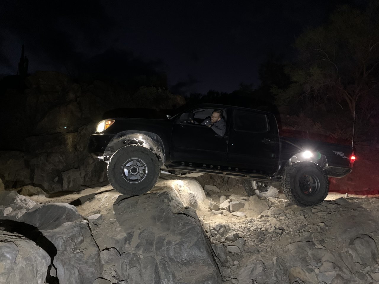

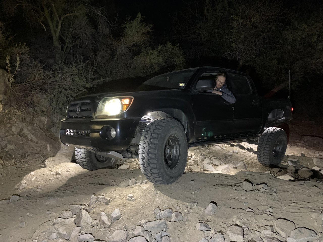

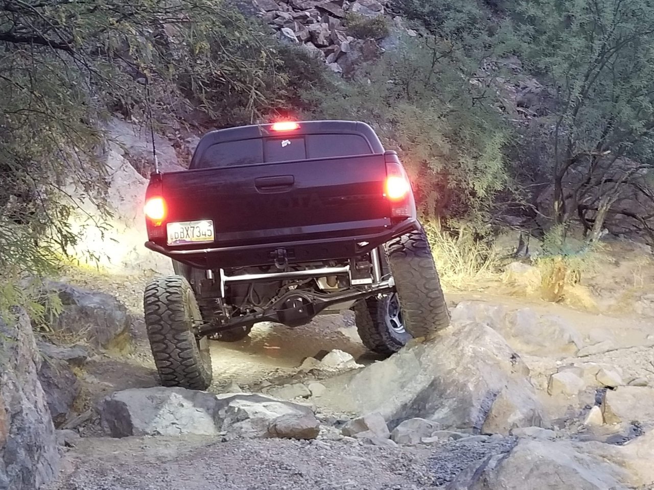

    Elvis trail box canyon. Finally got to fully droop out my shock relocation. Stoked

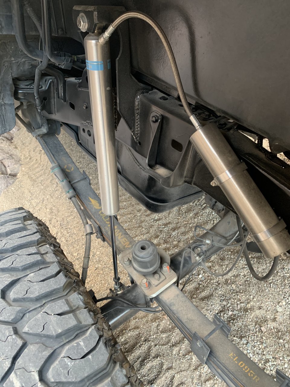

    Which Bilstein Shock did you go with in the rear? I have the BAMF relocation kit but not installed yet and I am looking into shocks.

    14” short body 7100’s. They will require a different upper mount bushing spacer than the typical King smoothie setup but these budget 7100’s ride really great. I got the pair for about $350 only

    14's wow....what relocation kit do you have? What was the big difference between the short body and the other option?

    It’s the BAMF kit, and these are about the only 14’s you can run reasonably because they’re “short body” 14’s meaning overall same can size as 12’s but with longer shaft and a little less fluid inside to allow longer extension. These seemed like a great budget option and after working out a couple of kinks they def are.
