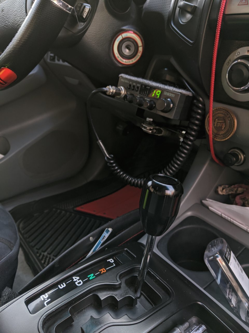

    Relocated the CB radio for the second time. This time I just removed the small tray near the steering wheel and bolted some brackets into it to hold the cb in place. Also, new shift knob. I like it but it's cold as hell in the morning. It needs a cover.

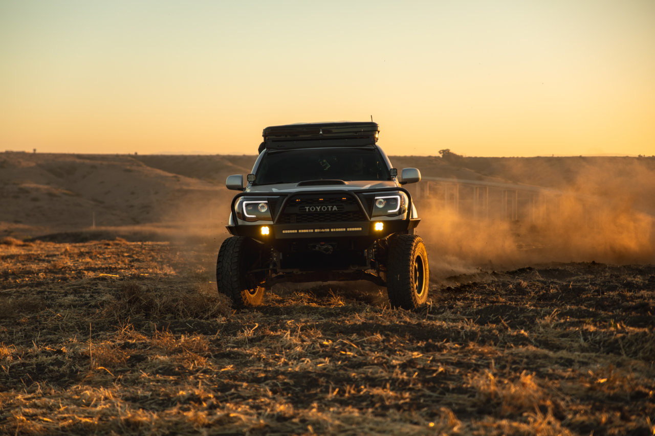

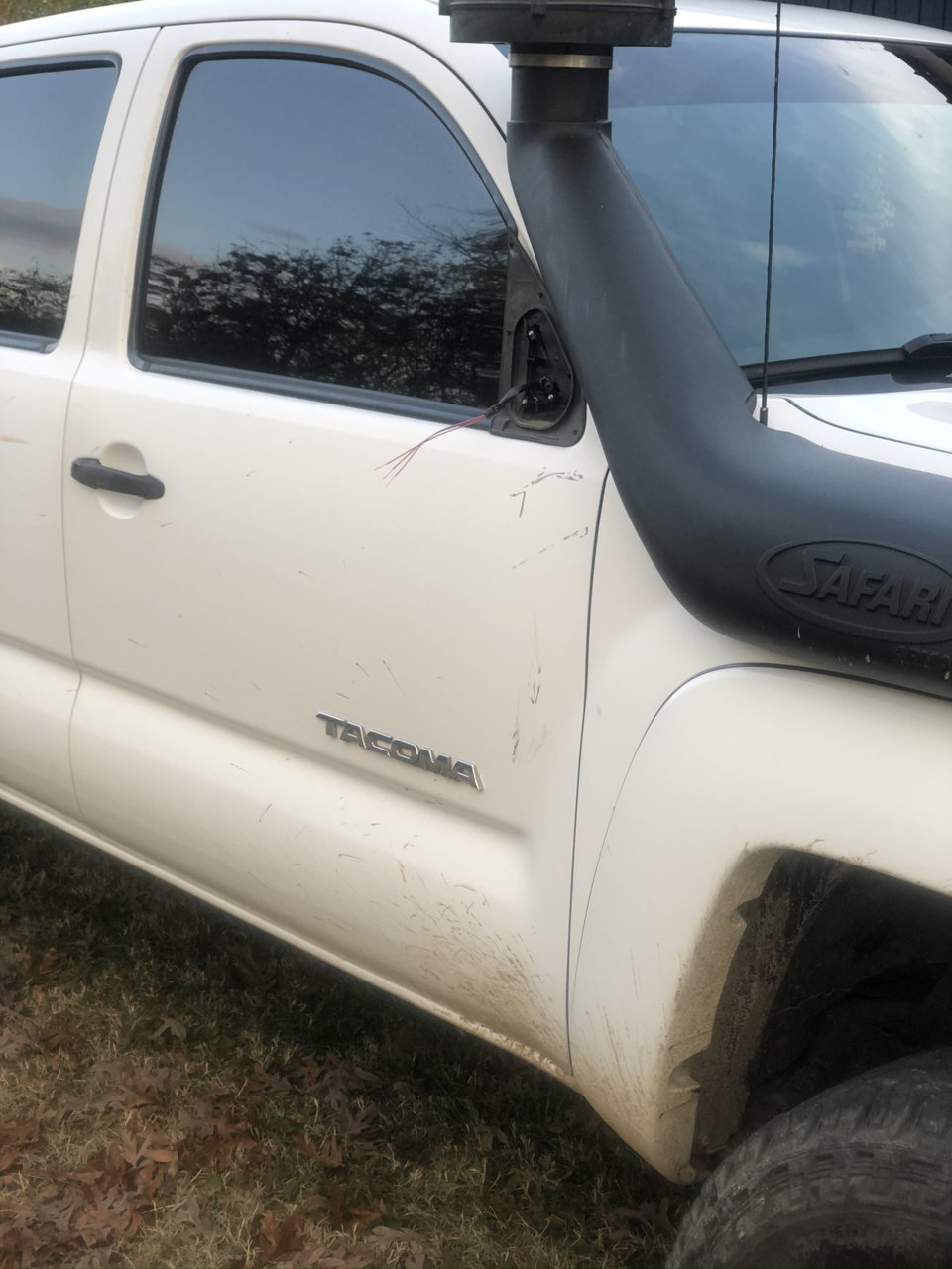

    Took her for a rip

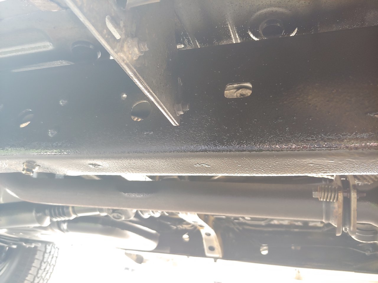

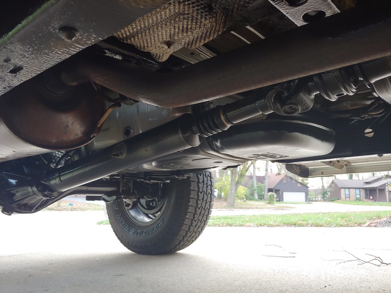

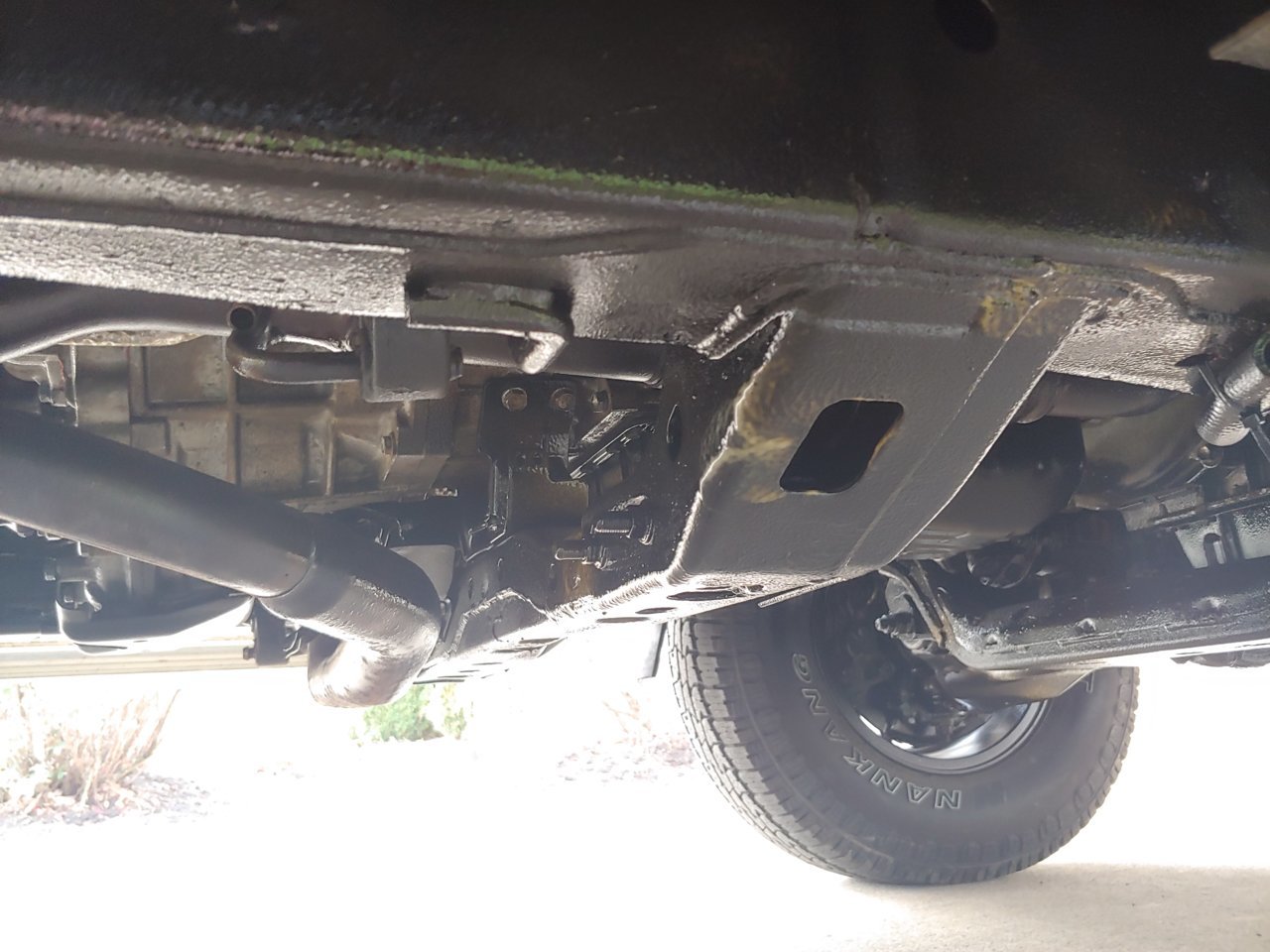

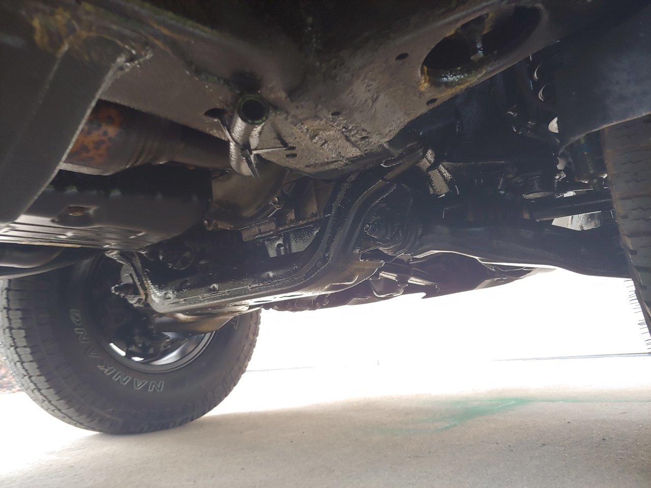

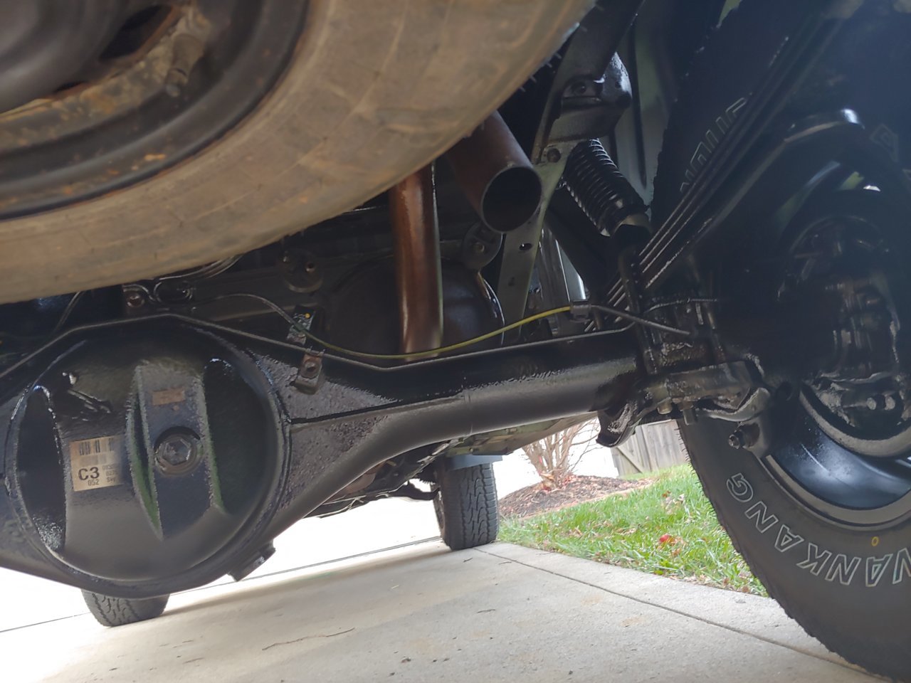

    Double layer, rubberized undercoating applied in a thin coat, fluid film over it.

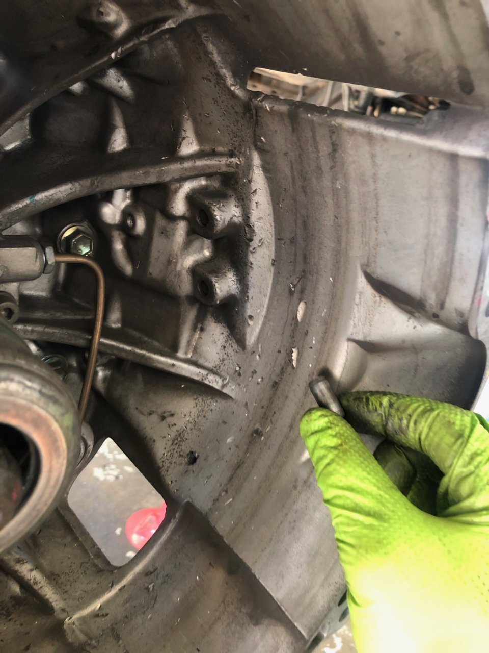

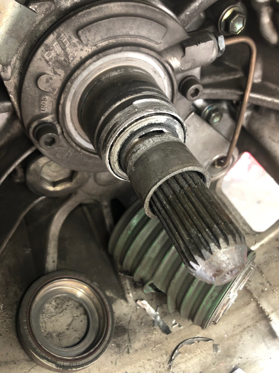

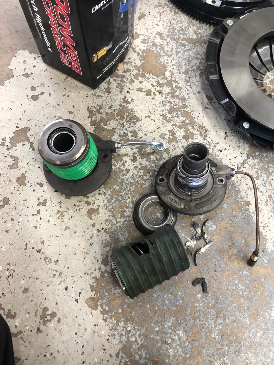

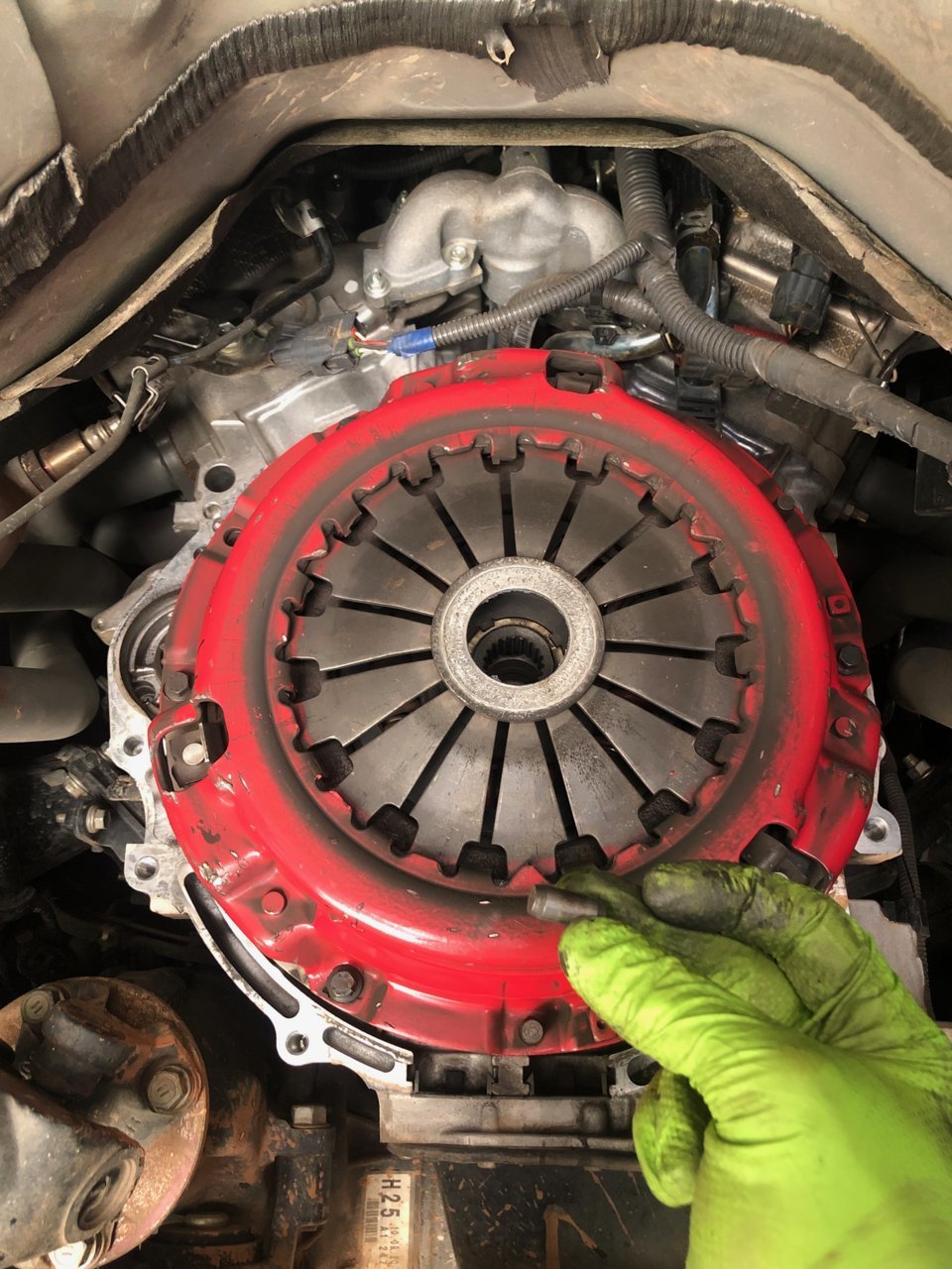

    I’m swapping out my stage2 for stage four and lightening the flywheel. I’m running the URD hydraulic throwout conversion, heavy flywheel and stage 2 clutch. Doesn’t quite hold in 4wd. 2.6 pulley and 275/70/17 compounded with the heavy flywheel wasn’t the best setup. It chirps in third in 2wd and slips in 4wd. Pretty glad I went in. Alignment pin migrated loose and rattled my throwout to death. Eh

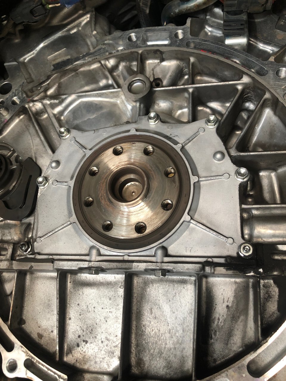

    Clutch only had 20k so rear seal was good

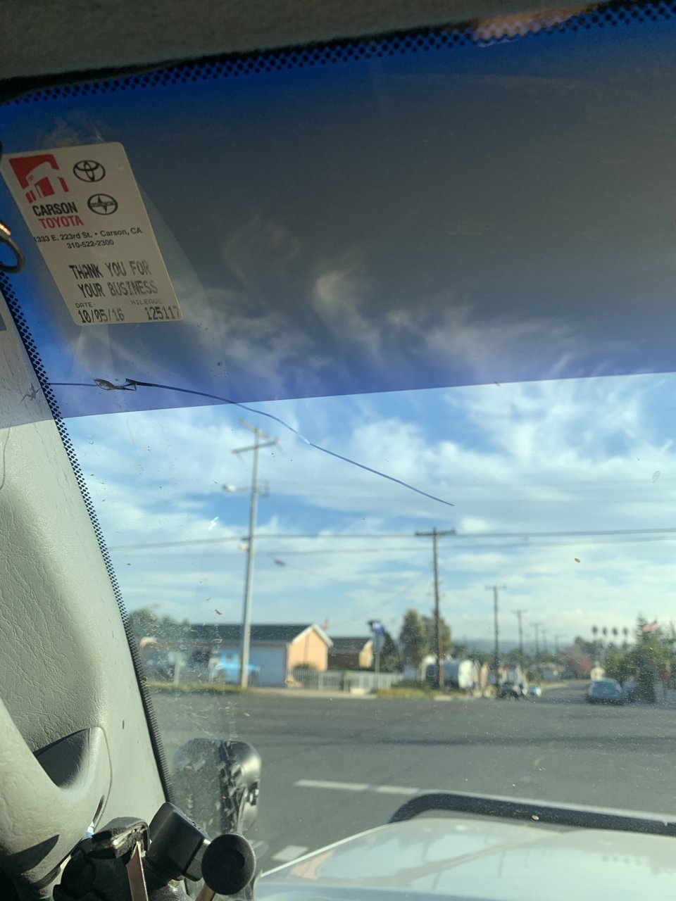

    Took a rock to the corner a few weeks ago from some asshole tundra that cut me off. Its starting to spread...

    I was going to make a joke about drilling a hole to stop the spread of the fracture... but apparently, that is a real thing. :confused:

    hahahaha yeah I just looked it up and seems like a hopefully simple fix

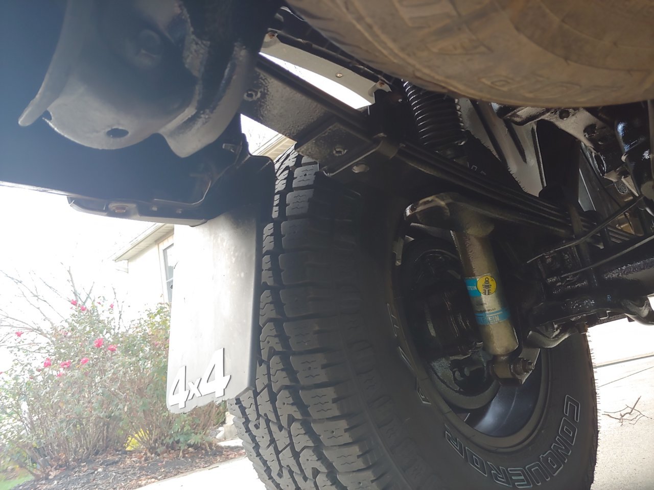

    I removed the stock PreRunner struts and their 3" spacers, installed TRD Bilstein 3rd gen struts, moved brake lines, and installed 4" lift knuckles. The knuckles stick the tire out a lot more than stock so the front tires are rubbing fenders, wheelwells, and mid cab mounts at the slightest turn so tomorrow morning I'll remove the front wheel spacers (I'm very happy about that). When my friend's offroad shop opens at 8 AM it's getting a front end alignment. After the alignment I can better determine what else needs to be done. The camber is way off and the tires are sitting on their outside edges so I think after the alignment the front will be a little lower than it is now.
    As it sits right now, the tire swap and suspension changes raised the rear of the truck 3 3/4" and raised the front of the truck 4 1/4".
    The ball on my 10" drop hitch is 5" too high (LOL!), it was about 1 1/2" too high before all of these changes I did yesterday and today, so right now the hitch is pretty much useless.
    Parking in the garage is no longer possible, before it would clear the garage door by about a 1/2".

    My insurance pays for the repair or new winshield. Did you check with yours? They might pay for new one.
