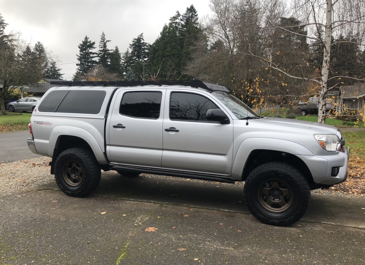

    Dropping in to say hello to the 2nd gen part of TW. I recently upgraded from a 97 to a 2013 DCSB. I've been doing a lot of reading on here learning about the new truck. So I haven't done anything specifically to the truck, but dropping by to say hello. Doesn't seem like there's a lot of crossover on the boards for different gen trucks.
    Here's the new rig:

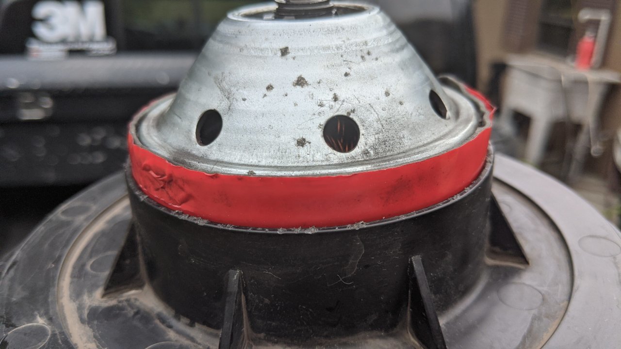

    Cleaned lubed and isolated my blower fan to avoid shelling out $150+ for a new one that started chittering when cold, 2nd more thorough time doing this, next time I'll replace it.
    T-9, super lube oil, and super lube grease, filled the bottom bearing cup with grease after allowing tbe oils to penetrate the bearing with the motor upside down for an hour, you can see it squeezed out nicely. All quiet and with the box filter and fan cleaned out it blows a lot better too, mission successful!
    Cleaned out the fan and the blend box while I was there; was carrying about a pound and a half of the Great Floridian Sand Bar with me between the filter the foam seals and the nooks and crannies in there.
    Wonder how that happened.

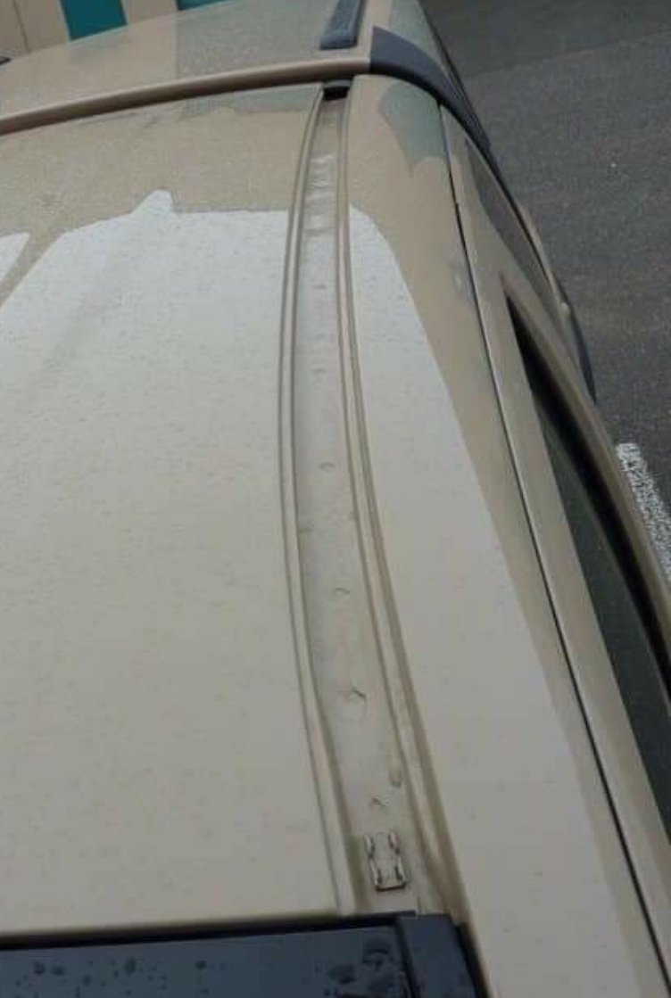

    I stole this picture off of the internet.
    How does the factory roof rack bolt to the roof? I don't see any holes. Thank you.

    That looks like an access cab. From my understanding, access cabs dont have the mounting hole like the DC

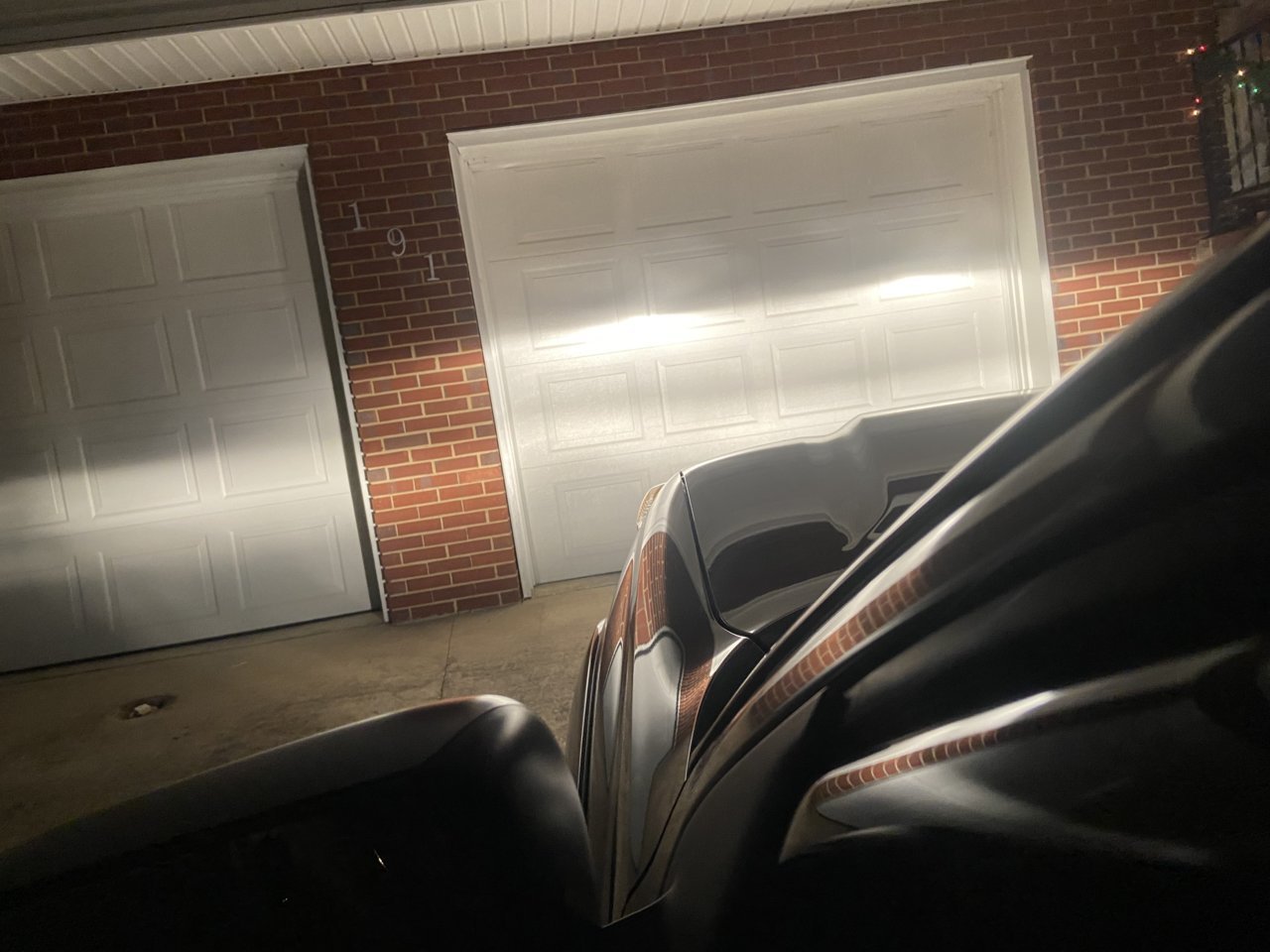

    Really been thinking I may have overdone it going with the Pros. Once mounted, the amount of light and increased visibility was astounding, such that I can't believe I'm not pissing people off, but I got out last night and had zero feedback from oncoming drivers. Happy about that!
    Got to work before sunrise today so I was able to get some idea of my 'throw'. I'm pretty happy with them.
    This is at about approx 20 feet without, then with, the low beams.

    Yep, can confirm... access cabs you have to drill your own holes to install a roof rack.

    Even for double cabs, if the truck didn’t come with a OEM rack, then the holes are hidden under color-match painted foam tape that would need to be removed to access said holes.
