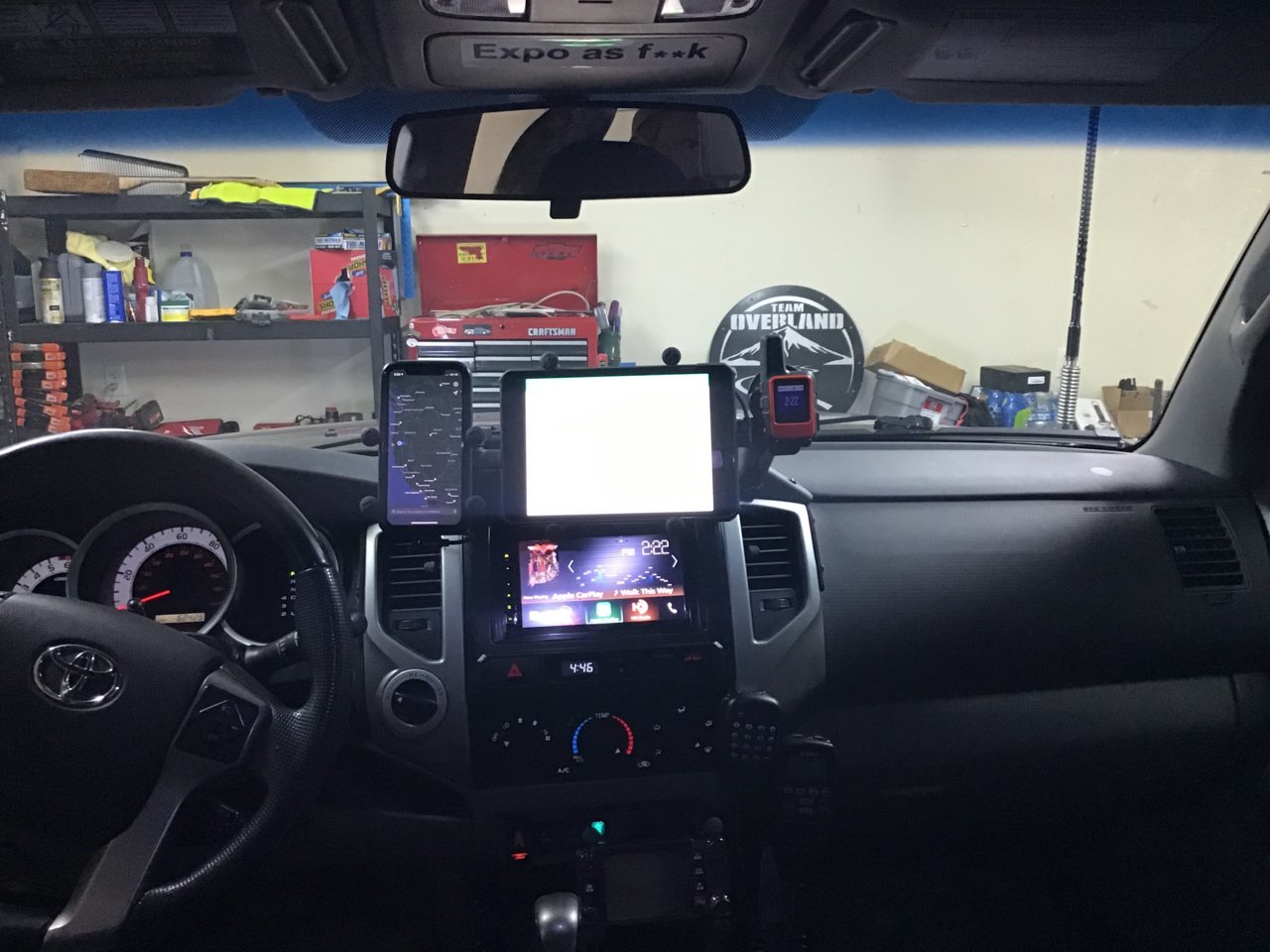

    I run primarily Earthmate which pairs with my Garmin inReach Mini so it can navigate with satellite connection. I can also text message in the app using the satellite connection. I have also used Gaia and Motion-x GPS in the past, but I almost completely use Earthmate now.I like using Truckerpath for interstate driving because it lists all the truck stops and they’re spaced perfectly for filling up. I try to use Travel America’s because they have Popeyes too :cheers:

    Thank you! Good stuff I need to look into. I too have a Garmin InReach - I'll have to do the pairing to my phone and see what's up with that.

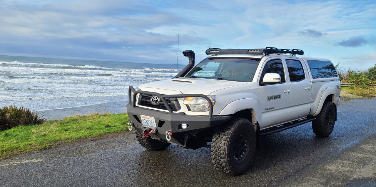

    Took a short road trip with the wife down the cost to Seabrook this weekend. Nice drive with very little traffic at all. The ocean is always a powerful sight to see and hear.

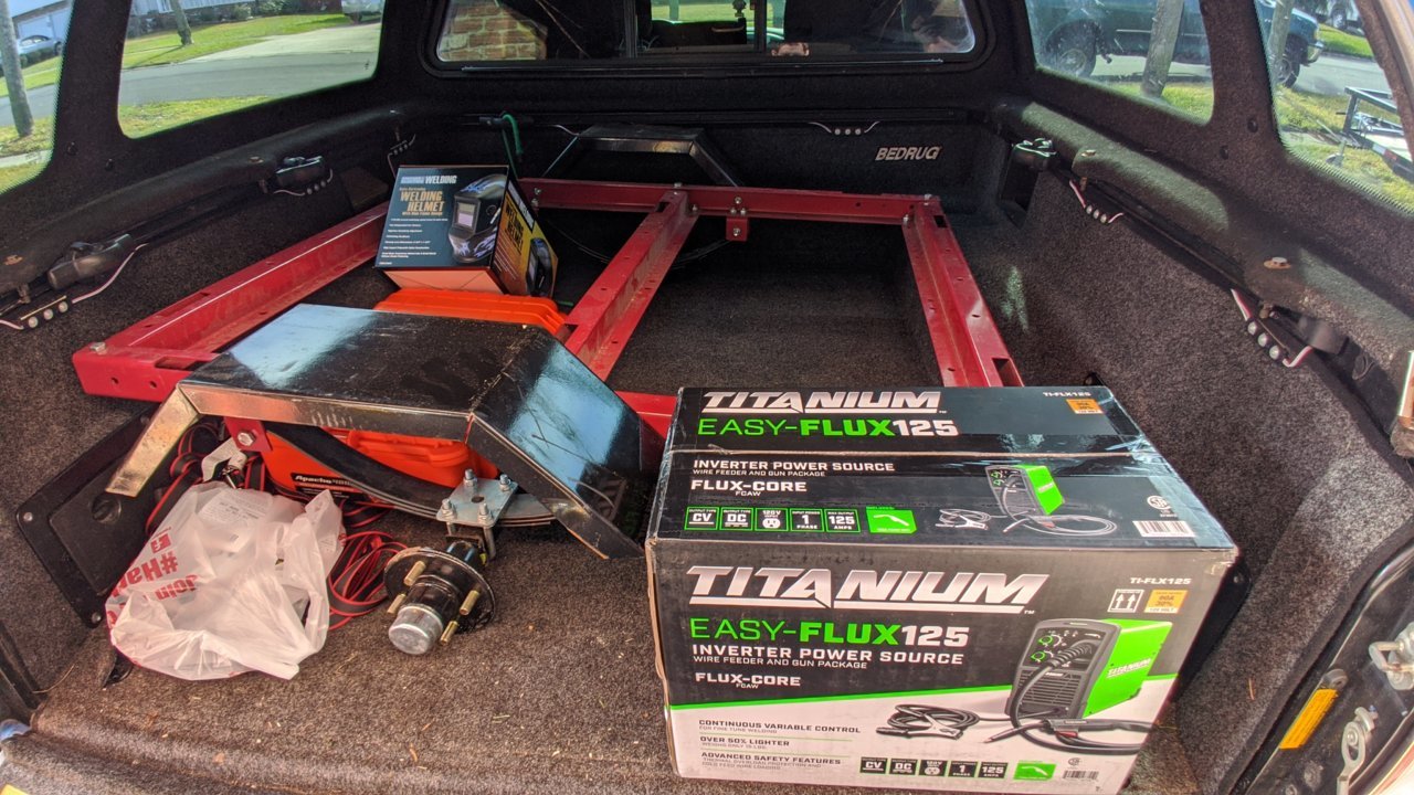

    However, today's purchases included a welder and half of a HF mini trailer for $70, just need a tongue and wheels. Thinking of turning into a small camping trailer to hold some water and other dry storage so not everything is in my truck. Honestly just another project to keep me busy during quarantine.

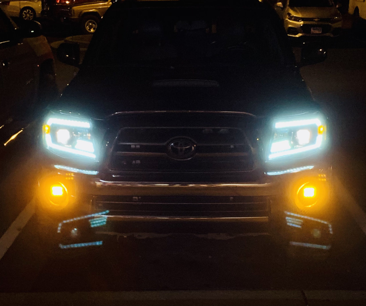

    Finally decided to upgrade my lights after years of having water condensation in my cheap head lights and fogs. Couldn’t be happier!

    Where from....could you post a link.....really like your headlamps

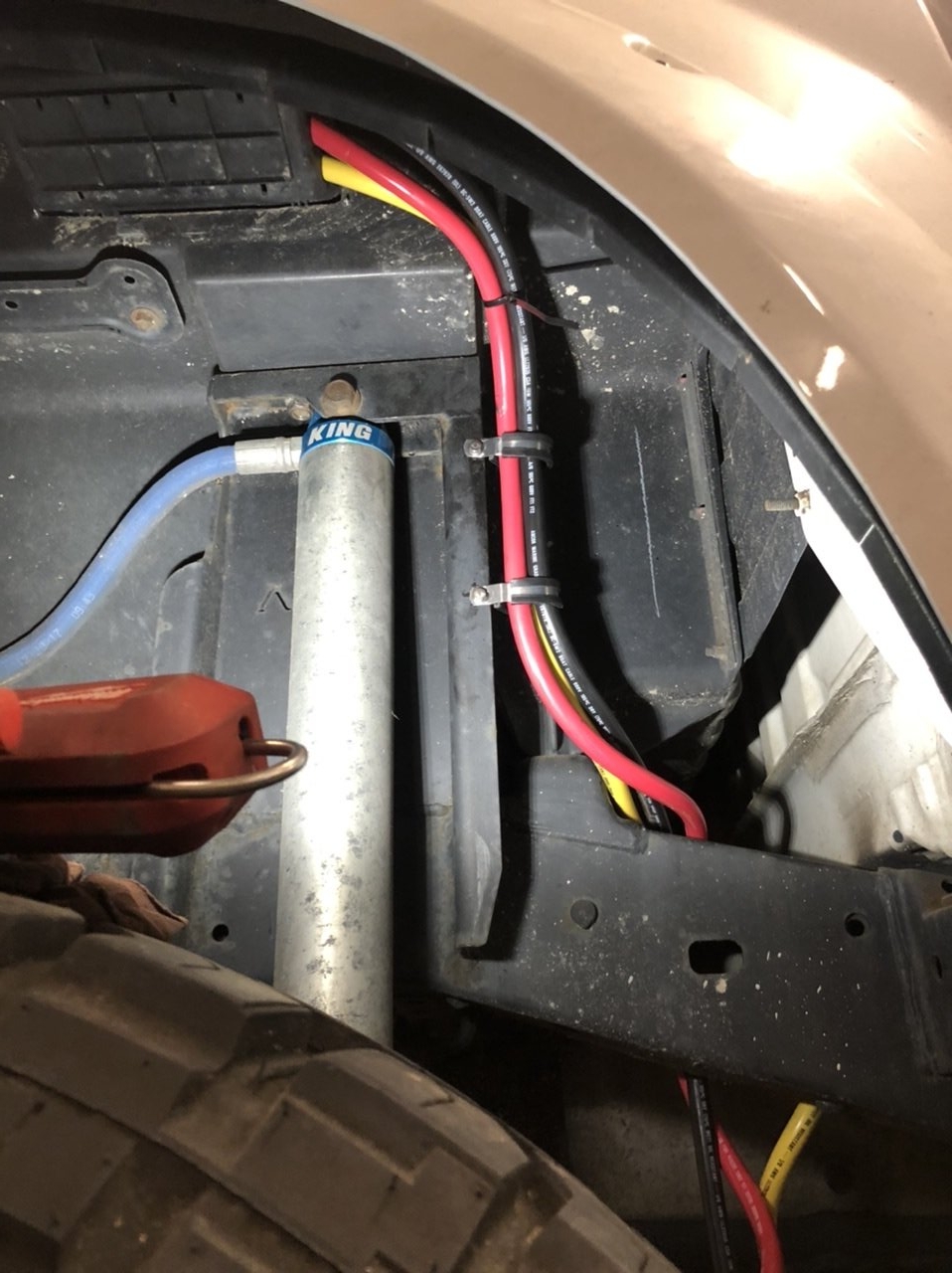

    Mounted my battery boxes and battery switch. then started getting my wires routed.

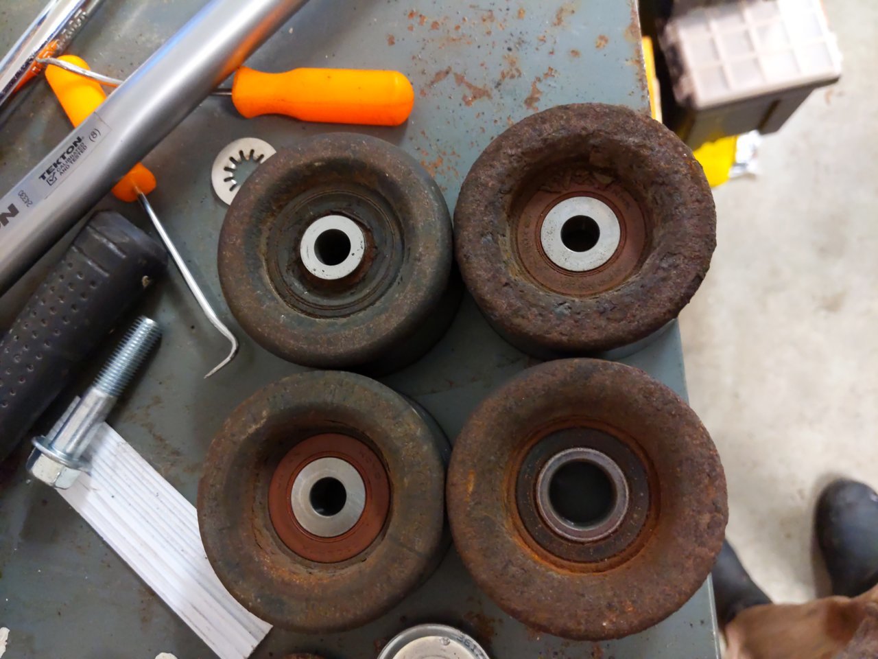

    my belt started to squeal upon start up last week during the cold spell we had.... I just started to research this.... what pulley's did you go with? Were you able to determine that the belt tightener was okay and just the pulley was bad?

    I went with Gates pulleys from @RockAuto and was pleased with the quality. The parts were made in Canada and had good name brand dual-shielded bearings in them. I used
    If you're replacing one, might as well replace them all, and as far as the tension arm being bad, it's relatively rare for the actual arm to go bad as opposed to just the pulley.
    In my case, I checked before ordering by getting under the truck with a 14mm socket on a short breaker bar and torqueing counter-clockwise on the idler pulley bolt to check the strength of the arm, and it was fine. It took two hands (at an awkward angle) to fully exercise the tensioner. I have no idea what the scientific numbers are for that, but I was satisfied that the actual arm was A-OK.
    Beware that the tension arm idler pulley goes on with reverse threads, and also that the GATES 36174 has slightly different dimensions that the OEM tension arm idler pulley. You can source a longer reverse thread bolt if you want, but I (and many others) simply ended up taking the bushing that comes with the GATES 36174 and putting it into the front of the pulley, then re-using the factory bolt. This will center the bolt in the pulley bore correctly, and the factory tension arm mount point has a mating surface that meets the rear face of the bearing correctly for a mechanically sound mount.
    Since the bearing is shielded on the back, it is not of serious concern to not use the supplied dust shield. If you do try to use it, or to put the bore spacer on the back, it moves the pulley farther forward than the OEM part relative to the path of the belt, which may cause issues with the edge of the belt running off the back of the pulley.
    Torqueing it to the correct value was a bit of a pain since my torque wrench wouldn't fit in order to tighten to spec (since the threads are reversed and the tensioner moves clockwise, you're fighting against the travel of the tensioner while tightening), so I tightened with a socket just until the tensioner started moving CCW and then checked in "reverse" (CW) with the torque wrench. It took two tries to get it within 1 lb of spec, and I called that good.
