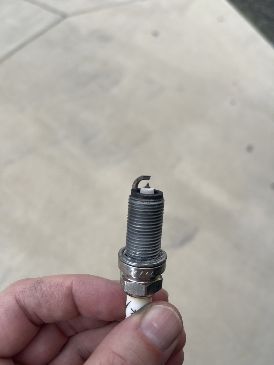

    Just. bought it last week at 120k miles, don't know when last owner changed the spark plugs, so that's what I did today! Drivers side was a little more difficult with the space but thanks to chris4x4 I knew exactly what to move!
    Previous owner used NGK Iridium, which apparently aren't suggested. They didn't look too bad. I replace with OEM Denso.

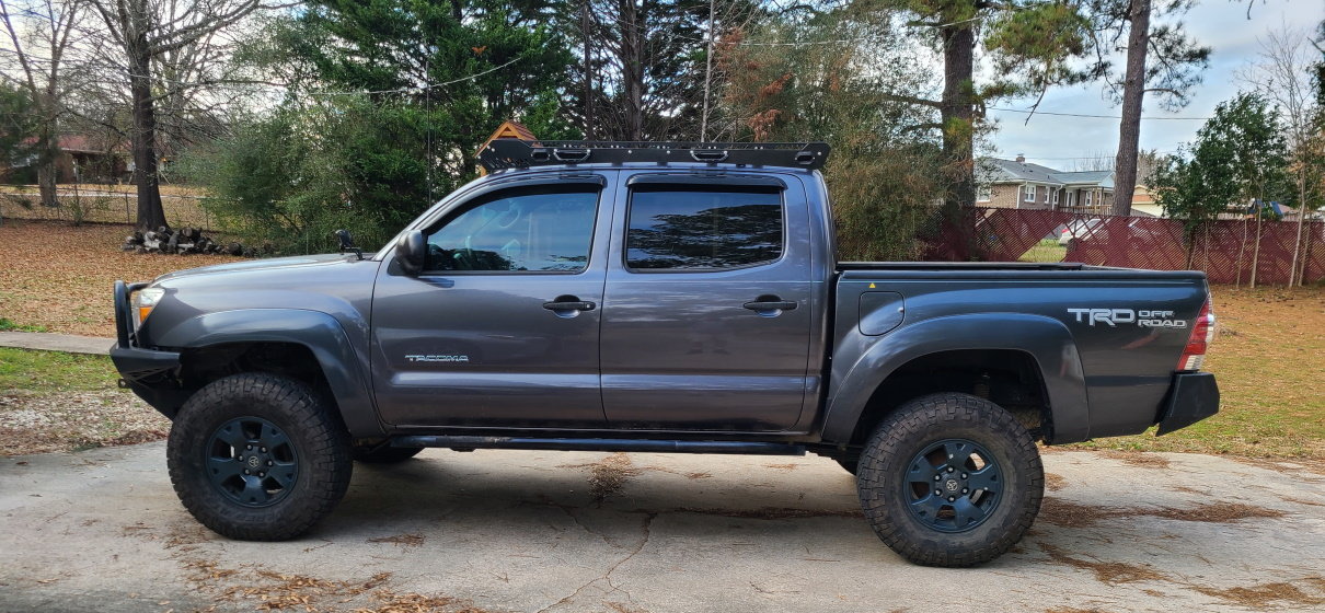

    Fuck me. I'm 4.3 BS on 35s. Shock relocate coming up, and I was hoping to get away with 0.75" boras. I have spidertrax spacers i took off when I jumped to 35s to get me out of my firewall. Maybe I'll just throw those in back. I'm not rubbing upfront now, except barely on my resi when turned and stuffed, but I can live with that. About to gusset up my spindles though and then I might rub on those. I'll try the boras upfront if so and hopefully they don't push my arc into the firewall and require tubbing (I beat back my firewall as far as I could with a BFH already.).

    At first glance I thought you edited the pic with the orange vinyl pieces to "point" at the tires :rofl::rofl:
